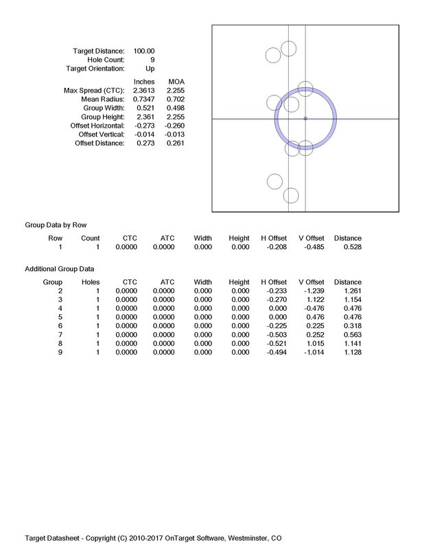

Over the past month, I've been tracking the POI of my first groups of the day/session (cold bore + 2 or more rounds). After I shoot my first group, I put in a correction and carry on with my practice / match. So far I've got ~2.5 moa of left shift built up over a month. My vertical varies quite a bit, but whatever adjustment I put in, I end up taking it out sometime later.

Anyone else tracking their Zeros? Does this type of shifting zero look pretty common?
Today, mid-match, my zero shifted 1 moa low - out of nowhere I started missing low at distance then confirmed on paper, is this normal too?
I'm running an atacr 5-25 F1 in a Spuhr on a pinned rail. I'm pretty confident its more FoM related than equipment.

I'm going to test a few variations of my hold - shoulder pocket placement, cheek pressure, grip pressure, to see what that does to my zero, and if I can replicate the vertical shifts that way. I also want to see what a less than perfect parallax setting does to my zero.
