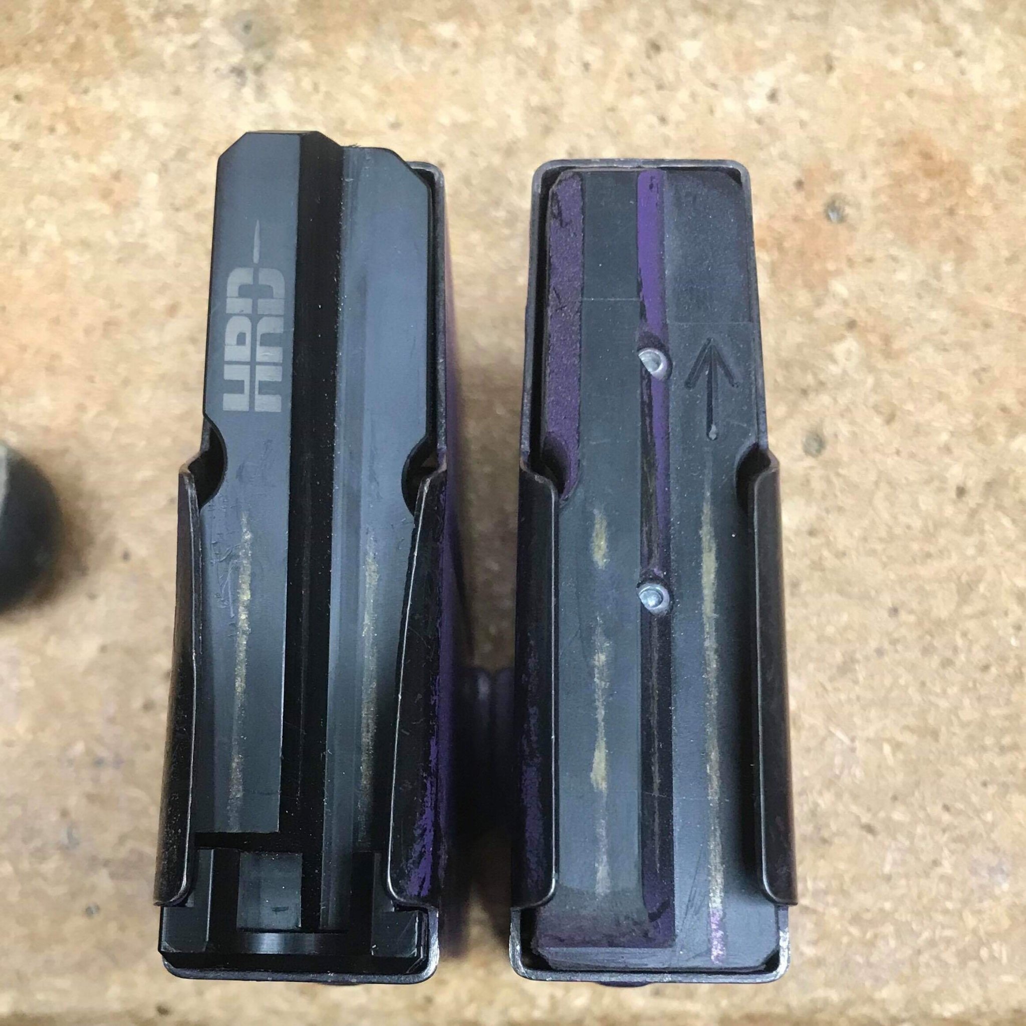

I had to flare out the front of the feed lips on the AW mags to get them to feed 6BR 100%. I’ve got 500 rounds on it with zero problems. Just shot the PRS finale in windy, dusty Texas and it ran perfect.
Modified AW mag left, unmodified AW mag right
