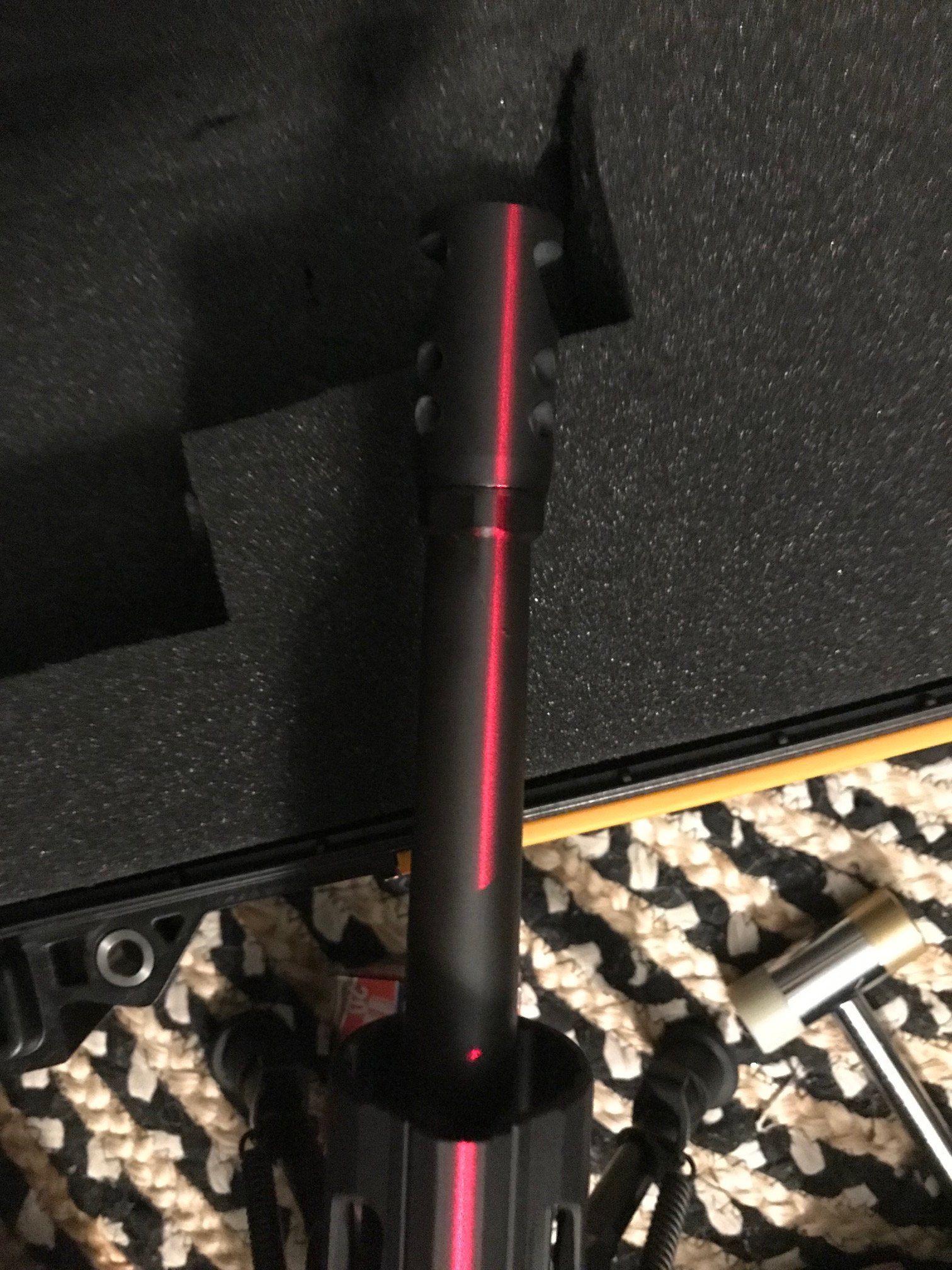

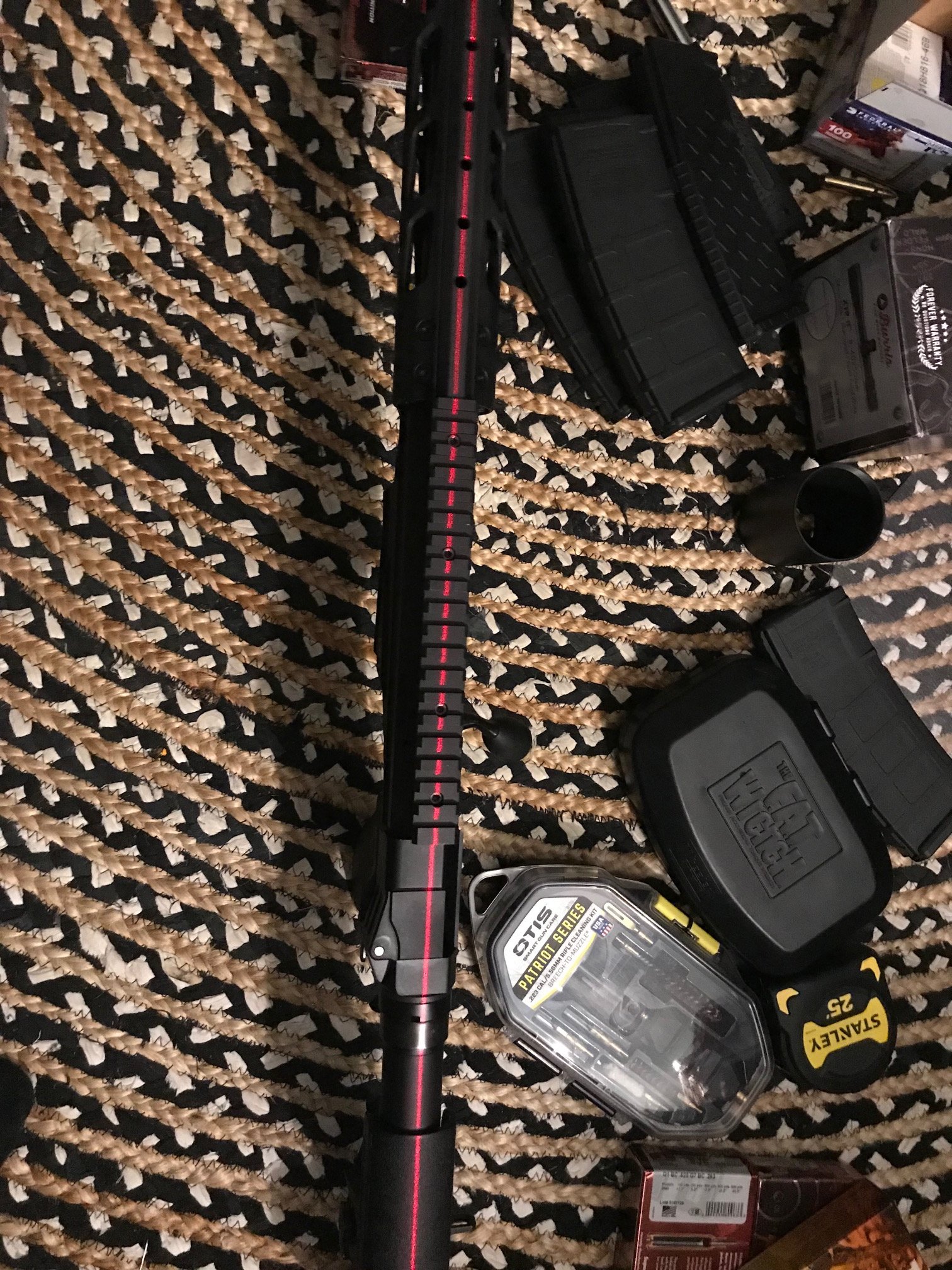

So I used a laser level that had laying down in the garage and passed the laser through the base screws and onto the barrel. To me it doesn't look like the barrel is centered. What should I do about this?

I think your best bet in mounting options would be for the optic to follow the barrel, through shimming or whatever.

3 inches left at 25 yards is about 12 inches left at 100 yards. That is a lot. You shot groups so the gun is apparently tight:
  • barrel tight to the front of the receiver,
  • base tight on the receiver,
  • scope rings tight to the base,
  • scope tight in the rings.
Your neat trick with the laser suggests that the barrel points off to one side. That might happen if the barrel is tight but isn't correctly installed or if the barrel or receiver have a manufacturing flaw. Nobody is perfect but the RPR is a quality piece of gear so the idea that it is made wrong strikes me as unlikely but not impossible. That it is assembled incorrectly is more likely.
