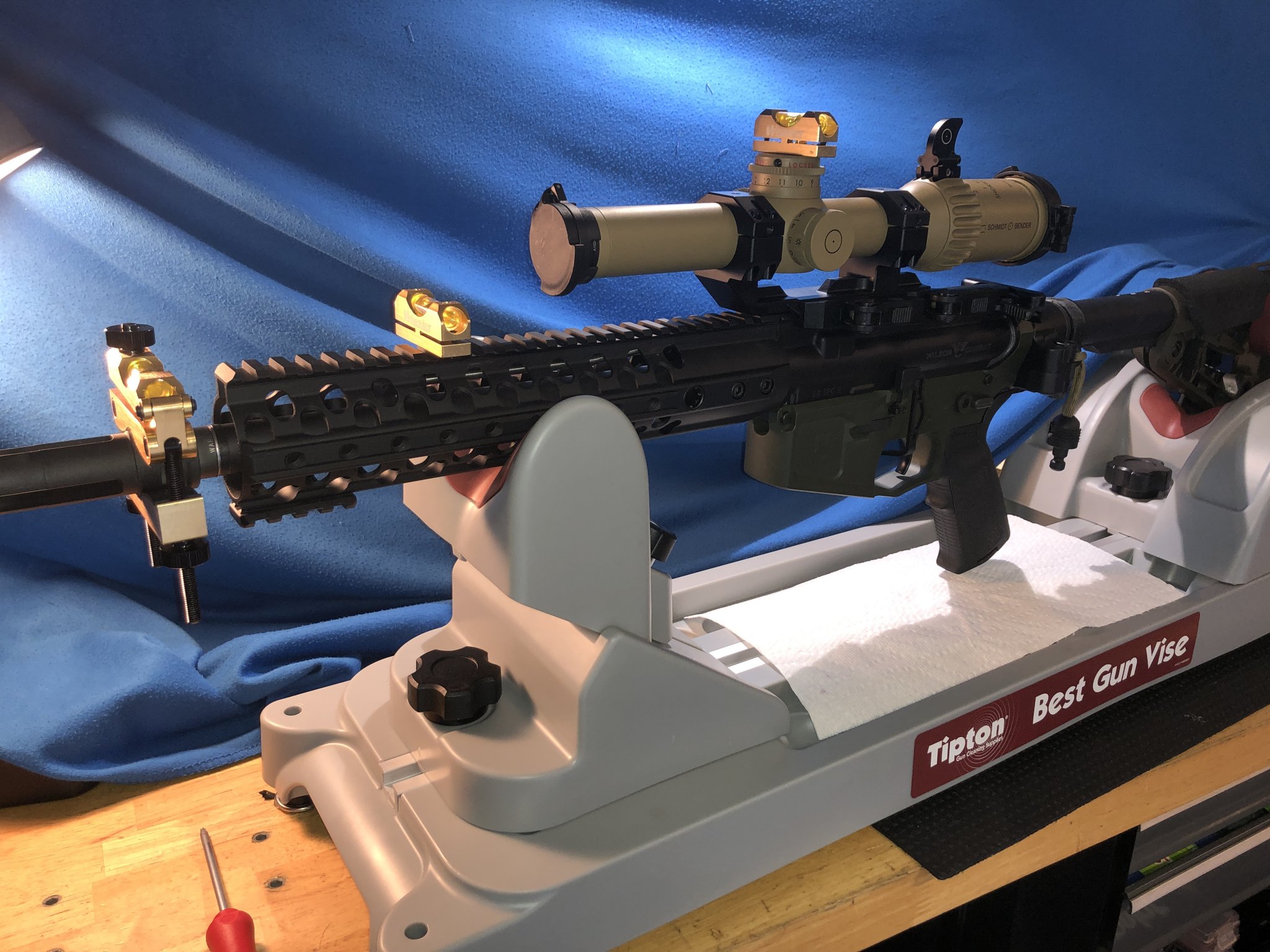

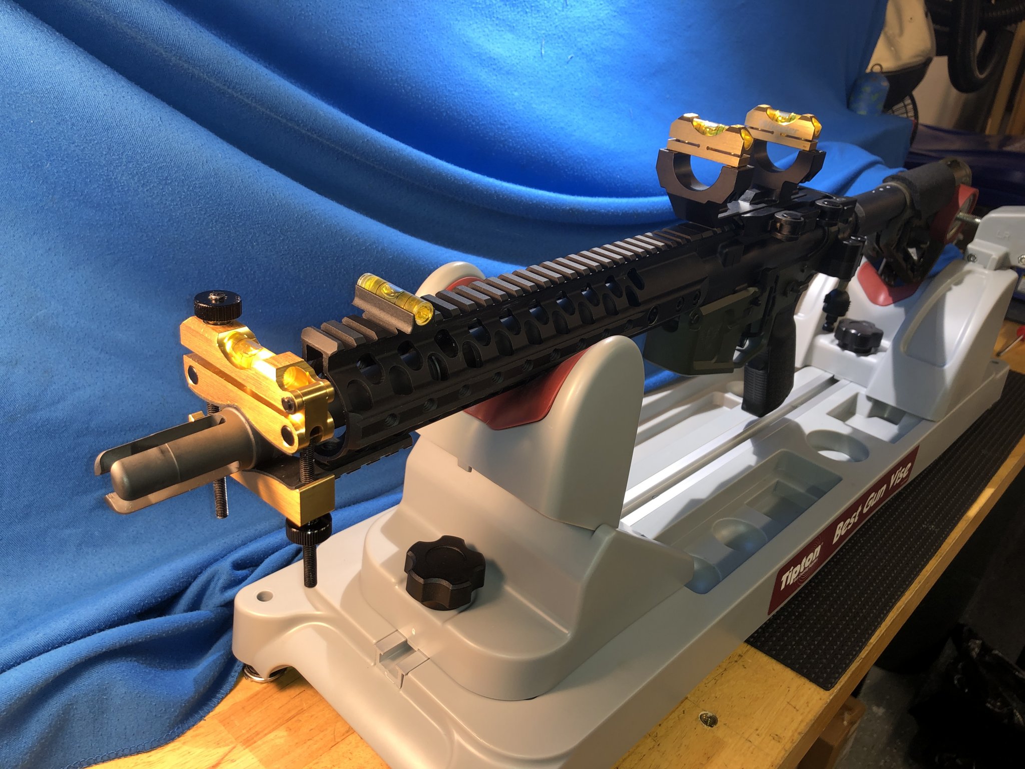

Thanks!!! I set up my scopes by leveling the scope mount front-back then side-side in a Tipton vise. Once its levelled in all planes, I install a barrel level and level to the mount level. I remove the mount level (making sure not to bump the barrel level!!) then remove the elevation turret and level the actual internal adjustor of the scope. I check with a plumb bob to make sure I have a straight reticle. This is all after I adjusted my eye relief standing, kneeling, and prone. I use tape to mark the position. I like to have a full forward eye relief in standing position so when I lay down, I am just at the rear area of my eye relief. No scope eye and plenty of room to relax. Relaxing is the key!!!! Shooting should be fun...… OOh Rah!
azpaleo
May 2, 2018
14
1
2
people actually use 4 levels to set a scope up, and 99% of that stuff has no bearing on the accuracy of the optic in the mount.
And it's an AR...
OMG !
That is just crazy
OOOHHHHHHH!!!!!!!!!!!!!!!!!!!!!!!!!!!!!!!!!!!!!!!! You mean the photo above!!!!! Duhhhhhhhhhh……………… Yeah, not at a that range...… At 1,000 yards and beyond...…………………. Oh yeah. matters..... Canted reticle. But really only out at serious range.

I just installed a S&B 1-8x24 Dual CC scope into a precision GDI quick disconnect mount and experienced similar observations. It was hard to rotate the scope in the not-yet tightened rings without the whole gun moving. I triple bubble-leveled the rifle / scope during installation but when I was done, the gap between the upper / lower rings on the right / left side where not symmetrical.......drove me nuts, I am pretty sure it doesn't make a bit of difference however released the screws and incrementally tightened them so the gaps where equal when torque setting reached. I chalked it up to just really close tolerances of parts.View attachment 7074344View attachment 7074345
And its all level...…… So what's the problem??????? Say...… say it with me now...…… C'mon Frank...….. Nice rig!!!! expensive scope. You really take pride in your work!!!!! How does it shoot??????? What range are you shooting at, what load and how are your groups..... Welcome to the site!!! Let me know if I can help at all. Do you compete????? So now...…. I ask...…… How hard is it to be nice?????? It is a nice rifle by the way... I always mount my scopes tis way minus the forward rail and then double check the elevation reticle with a plumb bob for straightness in the scope. I just never level the cap, but the elevation erector because it's more accurate as the scope cap is manufactured. I'm waiting to be kicked off this site...………...………...…. cmon…...………………. hurry...……...…...…….. How do I get out of here...………………...……………...…………………......…...……...……...…. I'm a ROCKET remember!!!!!!!!!!!!!!!!!!!!!!!!!!!!!!!!!!!

Wow. Yikes. A lot of discourse over a photo with a few bubble levels. It was just the first phase of setup for me. Whether an AR or bolt gun I take it through my own little process that works for me. I don't do much of the plumb bob in the garage but often rather look across to a house at 200+ meters and see if my reticle is square with several door frames etc. then off to the range for further validation, including tall targets and such. This will be a 300 - 400 meter max range gun, no transonic ballistics no Coriolis or Saturn gravitational spin drift. IF it doesn't seem to be setup correctly after my range visit maybe I'll send it off to a vertical gravity expert for calibration certification. Just a happy photo. Good night.

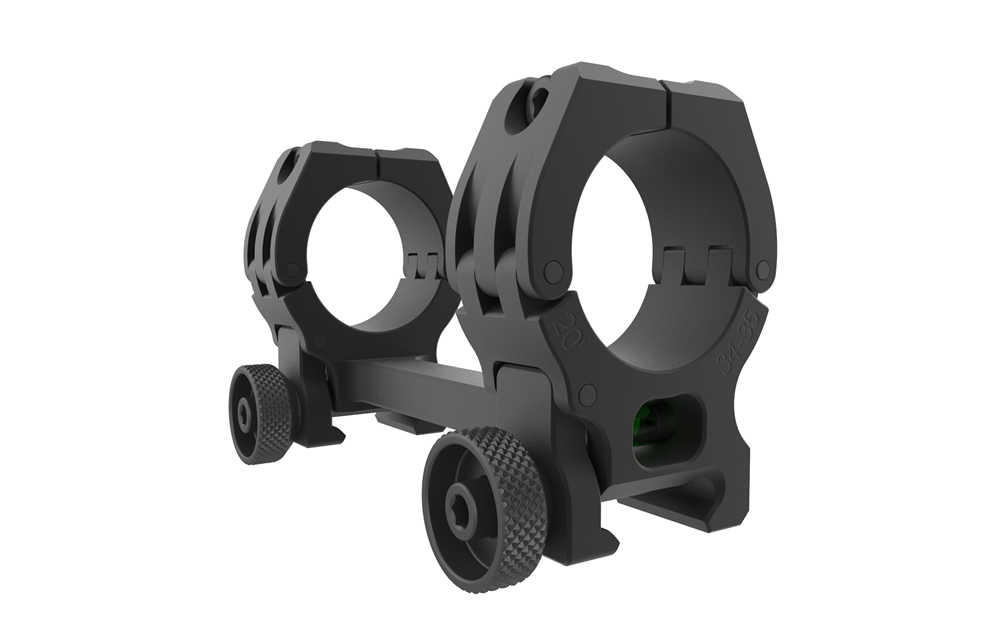

You bought the wrong rings.
Solution: American Rifle Company.

It's cool you mention that, because I have the Wheeler bubble level mount kit and it's nice enough and quick enough, but honestly all that's really needed is a set of clean feeler guages! That's what USO recommended back in the day, to use feeler gauges and align the flat of the scope to the flat of the rail and the guages stay in place while mounting, scope won't move. It's certainly a much faster way and super solid, so thanks for making me remember that.
