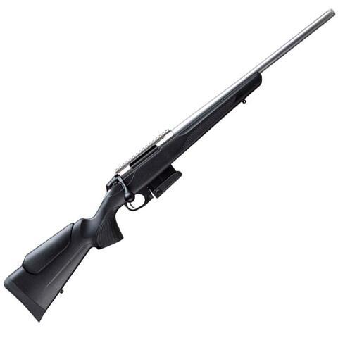

Do it all Rifle??
OK. Here's some spec's of my ideal Do-it-All rifle:
Stainless Barrel and Action
Threaded 5/8'sx24 so you can add an APA Gen II Lil Bastard or Area 419 Hellfire Brake..
20" barrel
10 Round Detactable Magazine
Synthetic Stock
Crisp Factory Trigger
No more than 8 lbs. unloaded without scope, mounts, bipod et al.
Chambered in 260 Rem or 6.5 Creedmoor
If you put those spec's into a computer, this is what it spits out: A Tikka T3X CTR Stainless. Hard to do much better unless you order a custom Rock or Gladius from GAP.

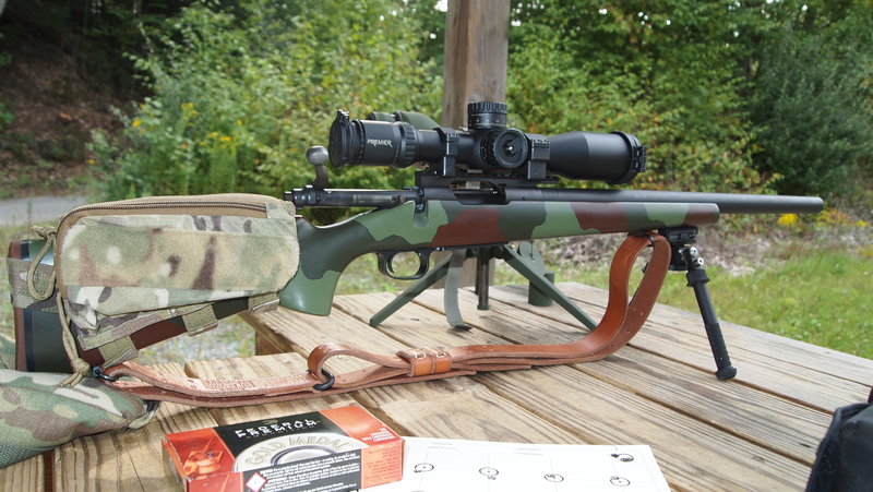

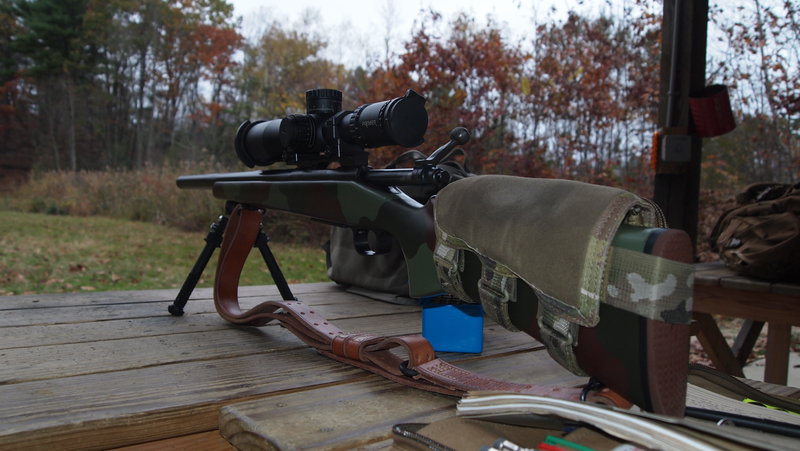

This is what my do it all rifle was on paper....
M40/A1/A3/A5ish Rifle Build
1. McMillan HTG stock. Pillars to be installed by builder. Action to be bedded using USMC PWS spec bedding compound to M40A1 spec build.
2. Bottom metal is DD Ross A3 guard/floorplate. McMillan has cut stock to accept this metal.
3. Magazine box welded to receiver per A1 spec. **** if you think this is a liability toward accuracy I agree to modify this requirement. Remington mag box, spring and milled follower supplied by me.
4. Barrel Kreiger 5R stainless. I want gun to be 4 inches shorter than A1 spec. I think 20 inch from lug or plus/minus 21 inch from bolt face is a good compromise on overall rifle length and still not cutting into velocity. Aesthetically the rifle will look balanced rather than barrel short. I went with an 11.25 twist and will likely shoot more 168s out of it than any other bullet. Willing to discuss if you see problems with my barrel choice or length. I defer to your builders knowledge. Chamber for FedGMM 168s or USMC M118LR spec. I would take suggestion on best chamber to go with. If I have enough barrel left over after cut and you can make a chamber gauge that would be neat. I want to be able to fire a 175 on occasion and have it chamber without issues.
5. Barrel crown. Im liking the early Atkinson barrel crown (picture included). Ive asked Mescabug for dimensions If he doesn’t reply with any Im pretty sure you can wing it and make me happy.
6. Reciever cuts. Lug slot per A3 spec for a DD Ross scope rail. Rail provided is a TwoManAttack sourced part.
For rail cuts I want the right side to be pretty much spec A3 spec at the ejection port/thumb cut. I really like A3 cuts that smoothly transition the radius of the port opening into the radius of the receiver rail. It’s a critical look to me.
On the left side rail Id like to harken back to the original M40 cut by bringing the left side receiver rail cut back to where it would meet and transition into the radius of the DD Ross scope rail. Its fantasy and I think it will be a pleasing look, almost making the scope rail look like a monolithic part of the receiver.
7. Scope rail as mentioned is a TwoManAttack copy of the DD Ross item. Open up the factory mount holes to the larger USMC spec 8/40 mount screws.
8. Receiver, true up and blue print the receiver /bolt please. Check lugs for maximum contact.
9. Finish will be a delicious black oxide USMC spec job.
10. Last four of Serial Number stamped on appropriate places as per A3 build i.e. barrel, bolt , bottom metal, scope rail, Badger lug, anyplace Ive missed.
11. I don’t need fantasy PWS stamps on the gun. It doesn’t meet any spec but mine. I think you deserve recognition as builder. Please tell me what your builder mark is before applying. Tastefull not billboard I assume. I like your Raven logo. My son is named Odin. Is your Raven Huginn or Muginn, Thought or Memory?
12. I wanted an M24 trigger but never came across one. The 1968 trigger will give a tribute to the M40 with its date of manufacture and tombstone safety. This trigger supplied is light in my opinion. I don’t have a problem with light because I don’t hunt and primarily just shoot paper. Still a 3-4 pound trigger is more what I am used to. Go with the provided trigger and adjust/job as you think best. Maybe in the future Ill get an M24.

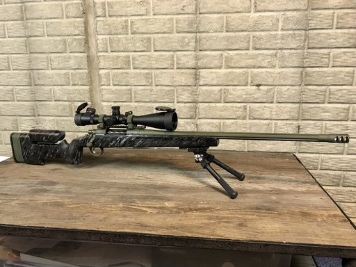

I tried to build one on a budget but with a little more of a hunting a hunting focus so I went with 300 win mag. To really drop weight, I would highly recommend a proof research carbon barrel. I have one on a 6.5 creed more build I did and it’s very accurate. Here’s the specs on this one...
Remington 700 5R 300 Win Mag
McMillan A3-5 Stock Bedded
Barrel & Bolt Fluted
OD Green Cerakote
Leupold Mark 4 Scope
Badger Aluminum Rings & Bases
Timney Trigger
Holland Muzzle Brake & Level
11.4lbs without Atlas Bipod

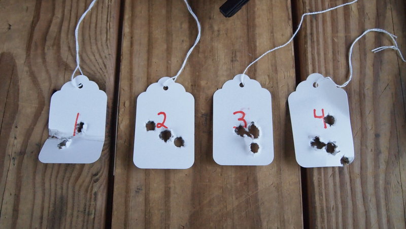

Another vote for the CTR. My 20" 6.5 has been printing a lot of .5MOA groups recently from 100-300yds. It's also under 10lbs scoped and loaded with 5rds for hunting.
I have always wanted to build a custom 308 but recently I've been leaning towards grabbing another CTR in 308 when that time comes.

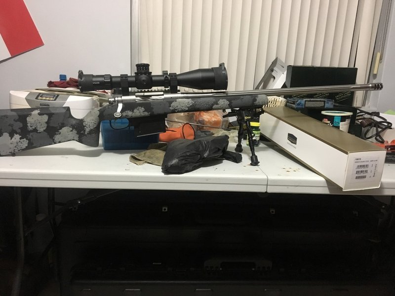

I'm currently trying to do the same thing. Maybe not 1200 yds but 1000 if I needed to.
6.5 Creedmoor
Surgeon 591
Manners T5A Elite (Carbon to keep weight down)
Hardy 24" Carbon Barrel (Again to cut weight down)
Surgeon DBM for AICS mags
I'll put my Vortex Razor AMG on it and it should weigh around that 10 pounds with a bipod and loaded.
I plan on using this gun for my primary coyote rig, whitetail, antelope gun, as well as enter a couple local PRS shoots. My current coyote rig is 14 pounds which is a little too much for lots of walking.

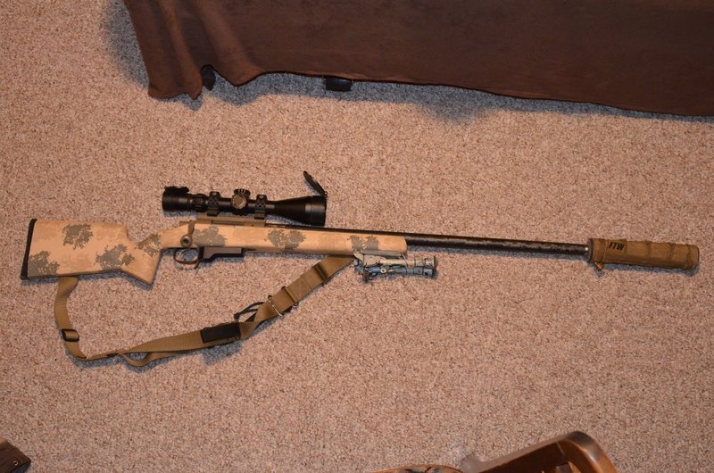

M5 Mausingfield Short action
Proof Research 28" 6.5 SAUM CF wrapped barrel
PTG DBM
Manners EH1
March 3-24x52mm
Comes in around 13lb with a can and bipod, 10-11 without those things. Have shot it with reasonable results out to 1600-1700yd. It's a little on the heavy side for a pure hunting rifle, but it works, and with the right sling or pack it's not bad to hike around antelope/deer hunting. It's just heavy enough, and the can reduces recoil enough that it's still a viable PRS style rifle. I've shot it in a couple local matches and done well with it. A 6mm would be better suited to that game. Overall it's capable, and I don't feel like I give up too much in any direction other than length.

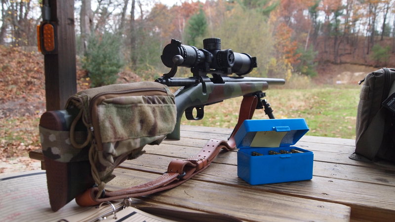

I just went this route and give another vote for the CTR. Just finished mine and really happy with how it turned out.
- .308 with a 20” barrel
- Manners EH1A
- Vortex AMG
It prints .5 moa, rings steel at 1K and comes in right at 11lbs so it’s not too bad hiking around for deer. What more do you need?
Likes: 308220
- Manners EH1A
- Vortex AMG
Sounds pretty nice. Have any pics?

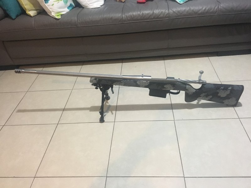

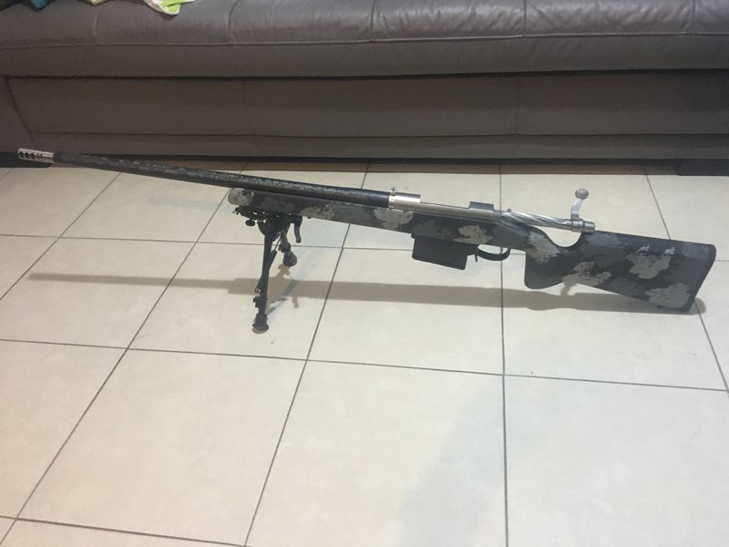

knuckleballz
Elk Hunter
Belligerents
Dec 12, 2013
196
90
34
#25
I'm getting older, and walking in the mountains isn't getting any easier. I broke down and bought a tikka superlite in 6.5 creedmoor with a 24 inch fluted barrel for 750$. The rifle weighs 6 pounds. I also picked up 5 round magazines from beretta for 31$. It is my go to rifle for hiking. Closer to the truck I use my jplrp07.

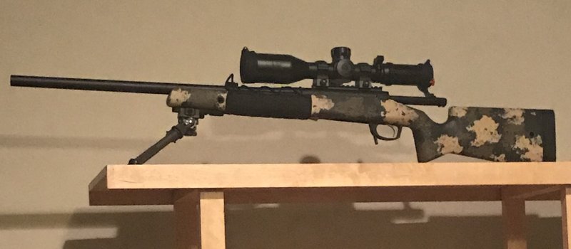

#29

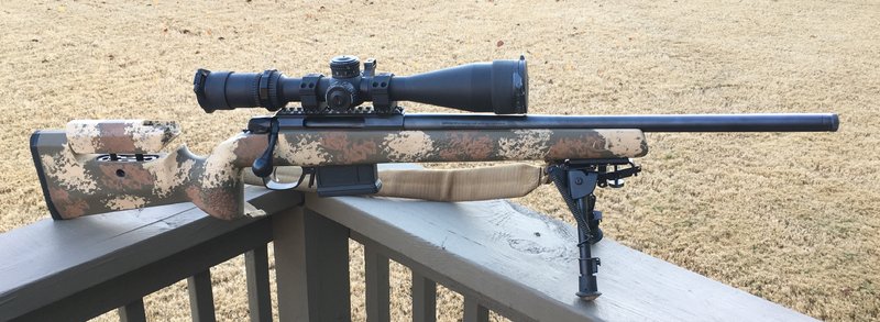

This was my attempt. Krieger rem varmint in 6.5 Creedmoor, manners EH1 with mini chassis, surgeon action. If I eventually change scope to Vortex AMG it'll help weight but right now it's about 14lb as you see it with loaded 10 Rd mag. I'm very happy with it, but it's not something I'd take into the mountains if if I could avoid it.

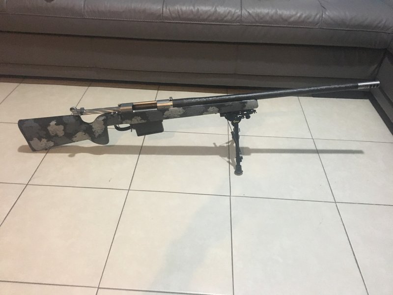

6.5x47, Surgeon, 23.5' Shilen = 13lb less the bipod
<a href="https://imgur.com/tfTauTy"><img src="https://i.imgur.com/tfTauTy.jpg" title="source: imgur.com" /></a>

my 6.5x47 is my do it all rifle. I regularly shoot it out to 1000-1200yds...and also hunt with it. Groundhogs, coyote, white tail deer. Weighs about 10lbs.
BAT VR Repeater action
Krieger light palma barrel 25in
Jewell trigger
Manners T3 stock
Badger rings
Leupold Mark 4 4.5-14x50 TMR
Minimal recoil. Slays white tail. Not bad to carry. Laser beam accurate.
This is what it turned out to be....
Video here......
https://youtu.be/5U2Hm4tA6n0
Results 15 for 16
Not high tech, not the latest caliber but its my perfect rifle.
What brand target is that in the last picture?
thx,
Baron

see if this works, right click and select "save image as..." and save it to your computer and see if it will print correctly. if it doesn't work, then PM your email, or anyone else for that matter that wants it.

Closest thing i have built to a do it all rifle is a 6 creedmoor with following componants
Manners EH1 folding carbon stock
BAT short action
Proof carbon wrap barrel
Jewel trigger
Hawkins trigger guard/bottom metal
Currently NF ATACR 5-25x56 but this will to change to ATACR 4-16x42 or NXS 5.5-22-50
TBAC 6.5 Ultra 7 A Ultra 5 will replace the 7
I built the rifle with couse deer hunting in mind
Except for the BAT action, I have the exact same build in a 6.5x284 for longer range deer and elk.

<img src="https://i.imgur.com/dsqD1kq.jpg">
20" 700SA 6 Dasher, 12lb 9oz plus the weight of the can now with a LRTSi 4.5-18x instead of the pictured 4-16x PST
Going with a Rem Varmint contour vs. HH Marksman would have saved me a little weight; I also could save some weight going to a non-adjustable cheek stock.
For comparison's sake, a Bergara HMR 6.5 Creedmoor with the same scope/rings/base is 12oz lighter.
