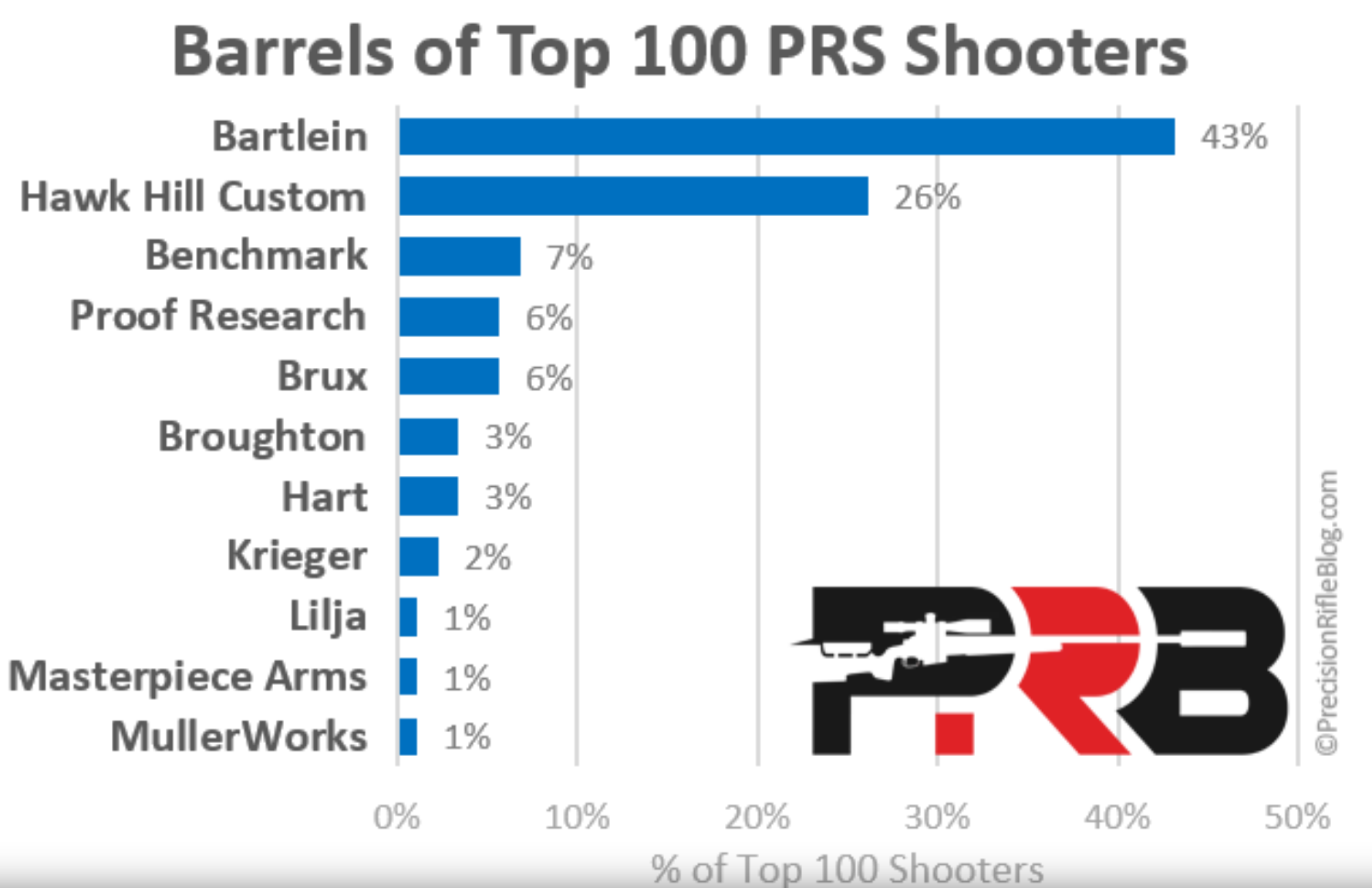

You do realize that the PRS is a bit of a self licking ice cream cone? I mean just about every discipline is a bit of circle jerk, they tend to ebb and flow with what’s trending. If you forced those top 100 PRS shooters to run button barrels, I doubt the standing would shift much. There can be a lot more that goes into making barrels than just the way the rifling is made, take JP for example, they use button barrels but I don’t think you’ll find too many complaints. Same goes for hammer forged barrels.

Yes it's about 90% / 10% of the top 100
Well, as far as AR-15's go, if ya wanna be like Mike, Compass Lake will machine a Bartlein blank if you have the coin for it; they'll do a Kreiger too. Both are cut rifled.
+1
Gotta love the "because all the top dogs use one" window lickers who can't articulate any technical knowledge on why some material or process is better than the other.
Self licking ice cream cone........LOL, perfect.
Accuracy, no difference. See various reviews and comparison tests I've done here on the Hide. I've tested hundreds of barrels from all the big and small names over the years.
First off, your quoting PRS bolt gun stats/info in the semi auto section. Doesnt apply to this discussion.
Second, the button vs cut has to do with barrel life, has Jack shit to do with accuracy. I've tested PVA Rock button prototype for them that is being used on the John Hancock. It hammers. I've tested Keystone Accuracy green mountain barrels for them in 6.5x47L. They shoot LIGHTS OUT. Buttons just generally crap out earlier than a cut rifled.
The top PRS guys typically use what their sponsor gives them. They also want the longest life out of them before spinning on a new barrel and having to recheck load data.

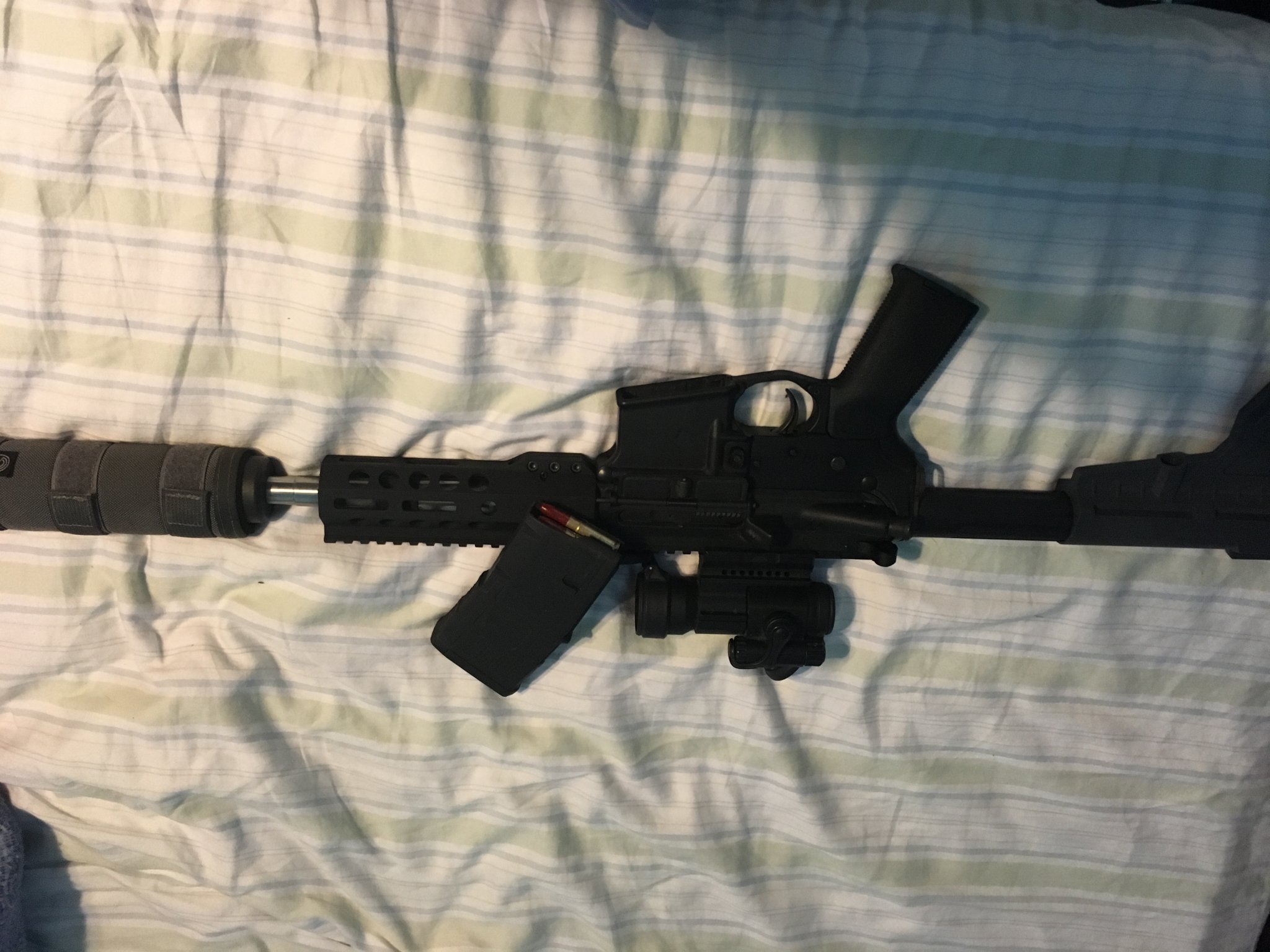

I too use Noveske as a "go to" but for SBR's. They make a tough as hell barrel and it's fairly accurate. They ain't cheap either, but are generally 1MOA barrels, some do even better. The LMT 14.5 M4 barrels are about 1-1.5 MOA. So is the AAC 16" .300 BLK pencil barrel.
