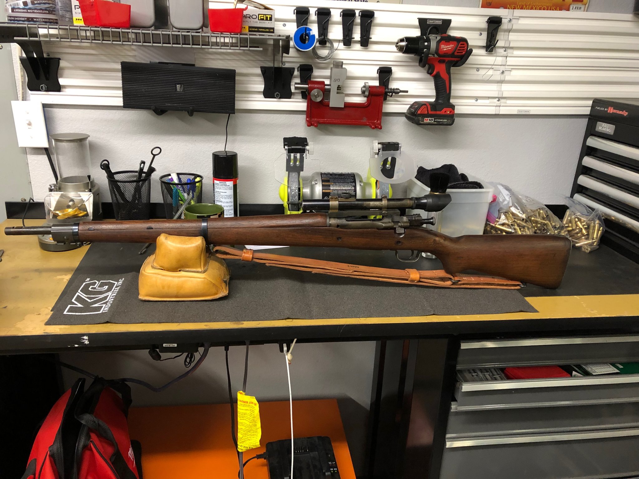

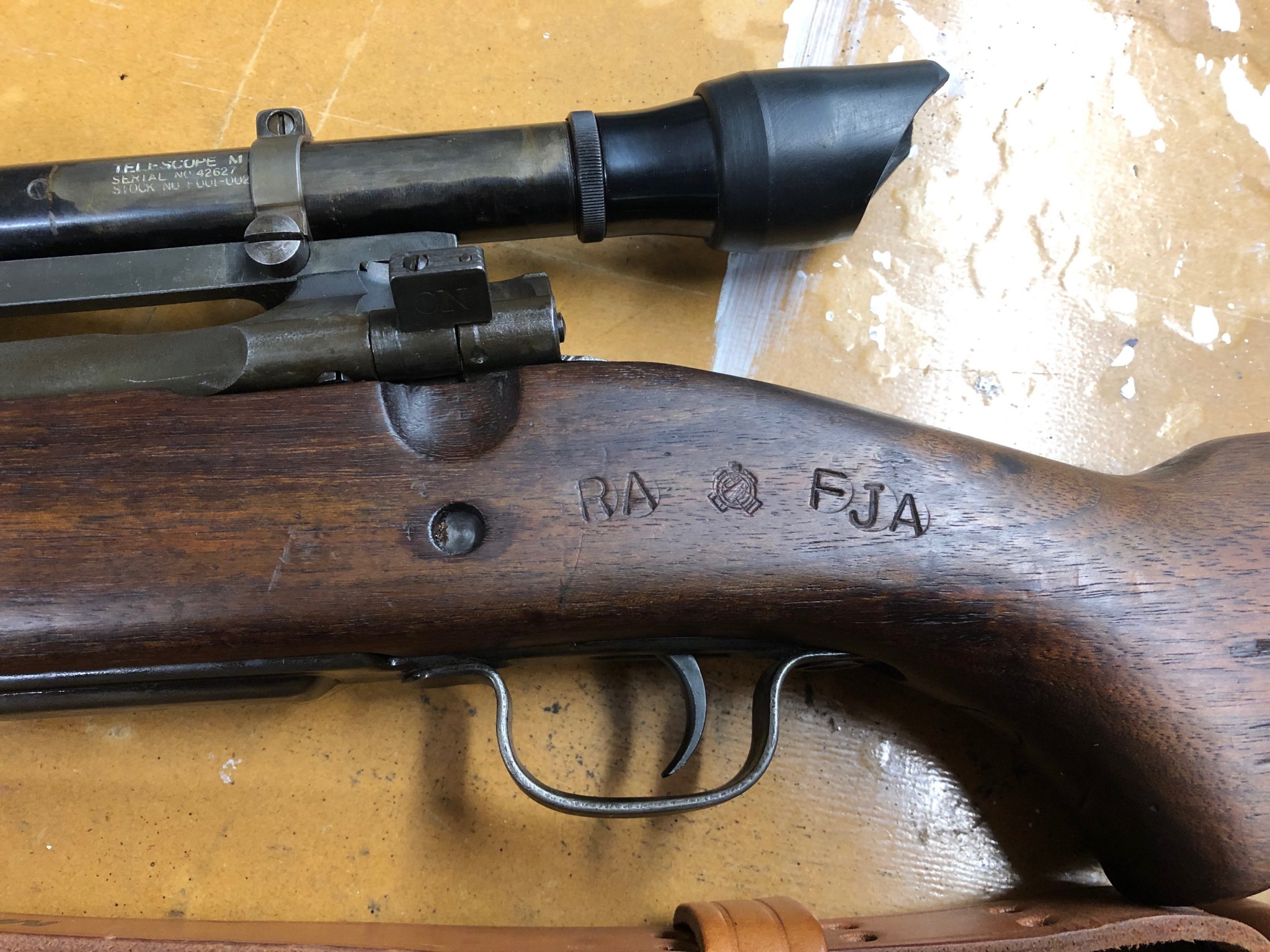

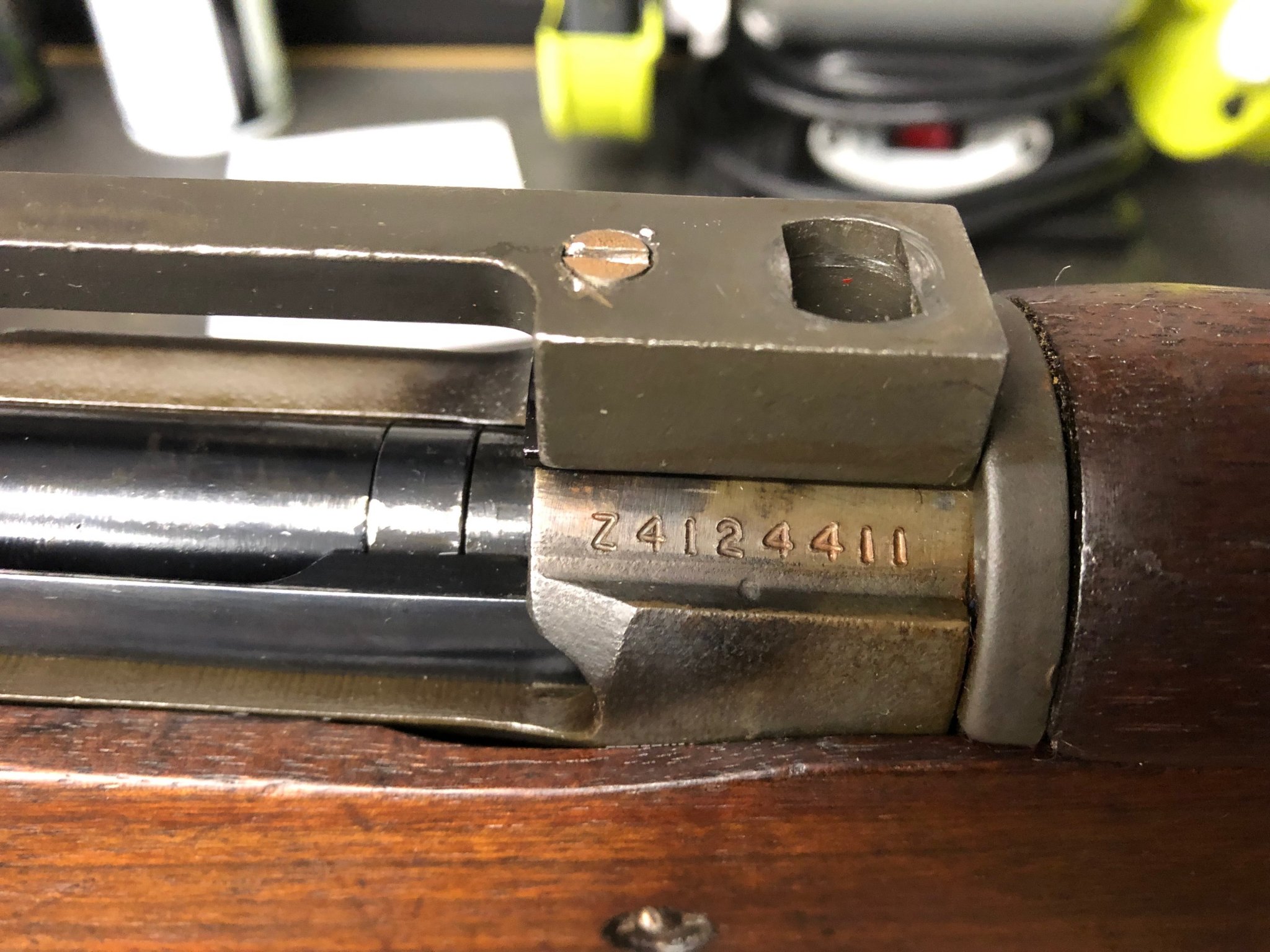

I have another addition to my 03 collection. What baffles me is that the markings and serial number are positioned to that of an A4 and are reduced in size compared to a standard A3. However, the research I've found indicates that all of the "Z" prefix A4's should be in the 4,001,083 - 4,002,980 range. This one is 4,124,411. Whatever this was I'm pretty confident it was rebuilt at some point. The fella I picked it up from said he got it from his father-in-law's collection and couldn't provide any details.

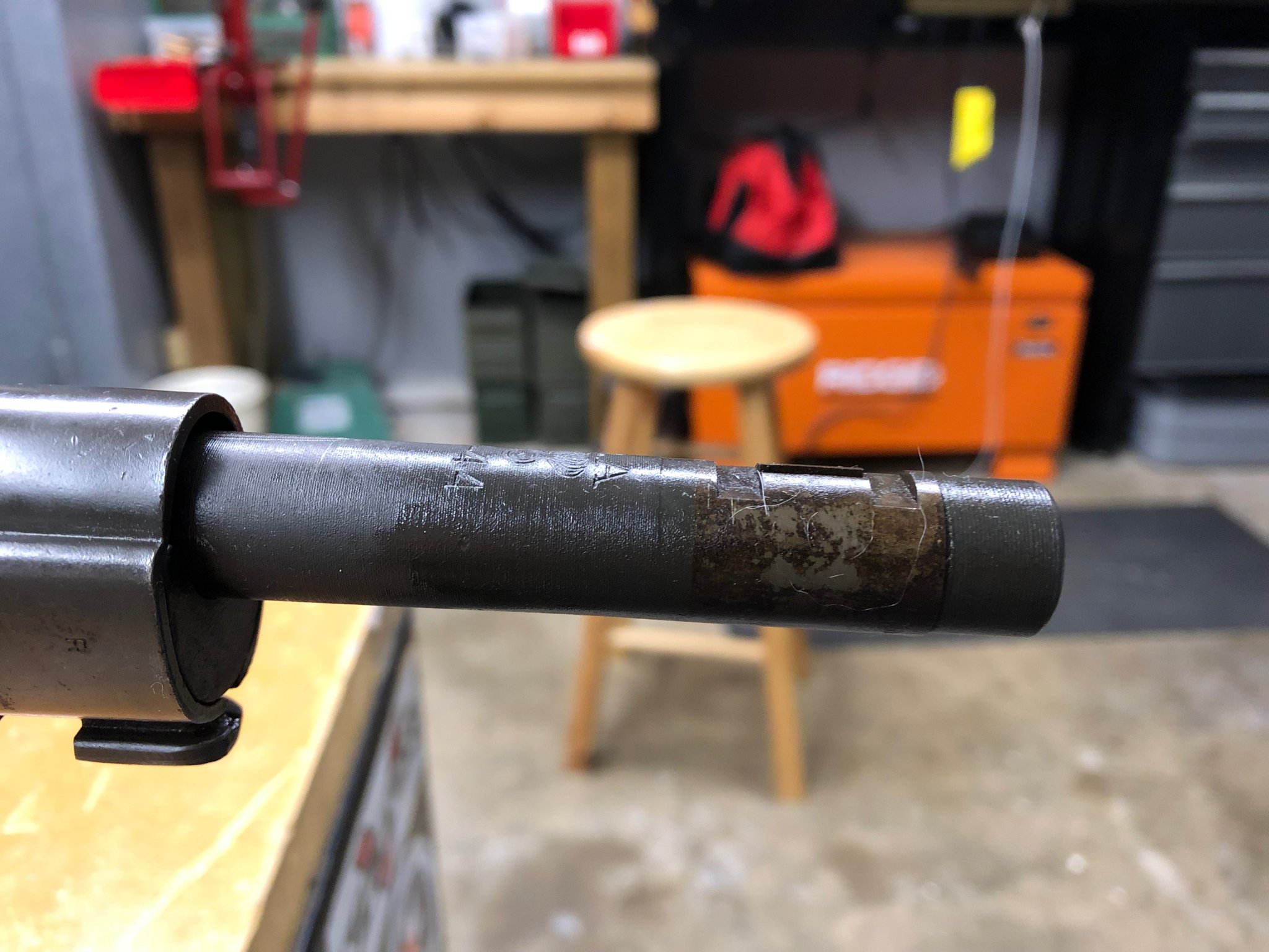

The barrel appears to have had the front sight on at some point. As you can see it was not parkerized underneath and has rusted. I assume this must have been an A3 barrel.

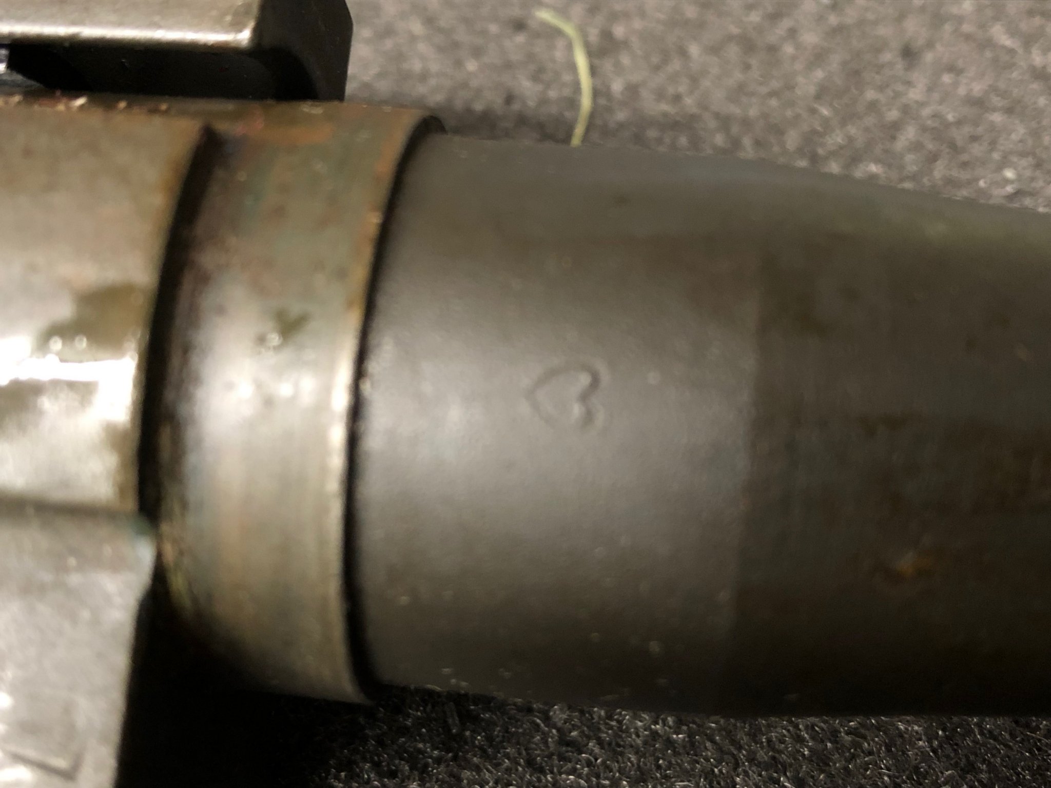

The barrel also has a heart stamp near the chamber.

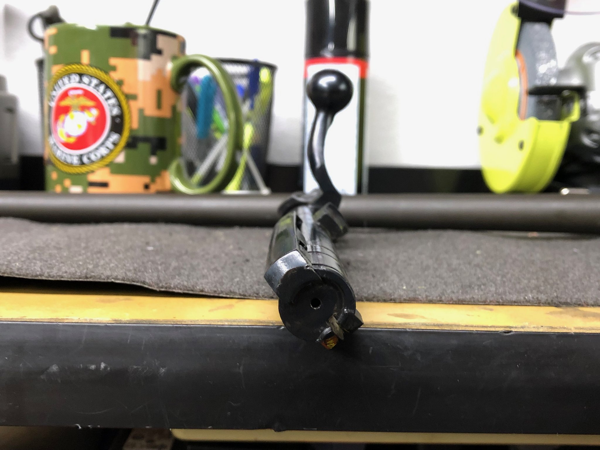

The bolt has been blued and appears to just be a modified A3 bolt.

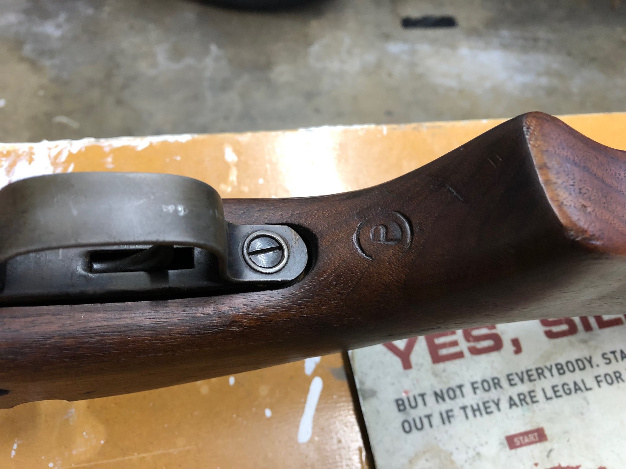

The stock is beautiful and doesn't appear to have seen any serious service but has all the proper markings.

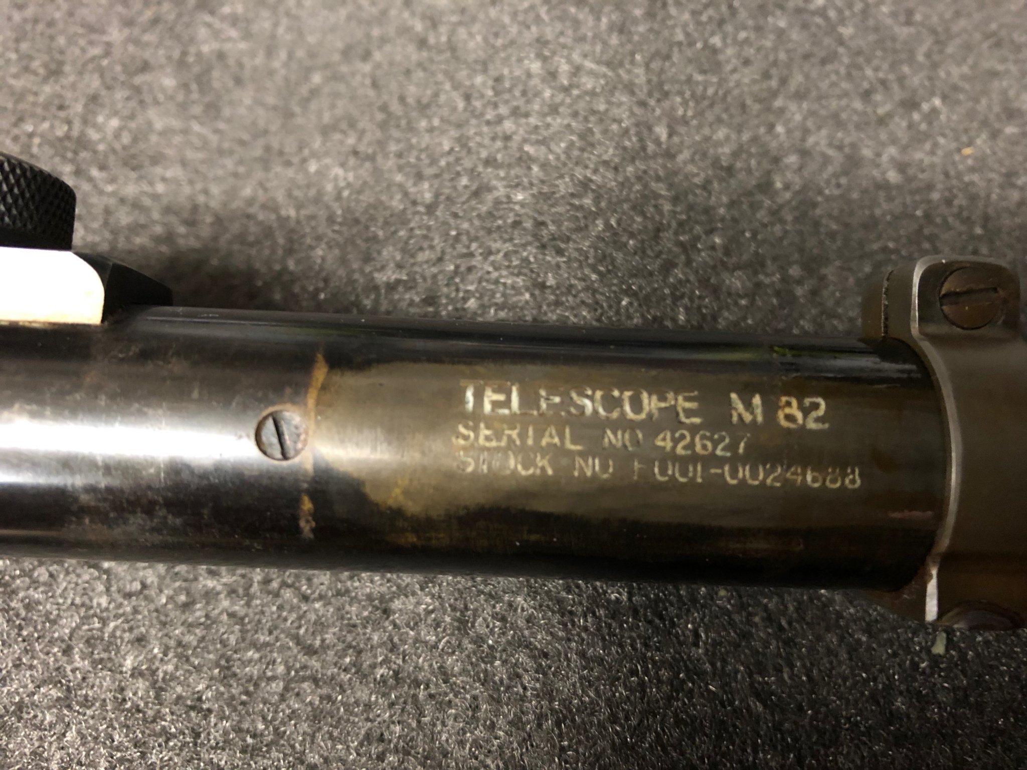

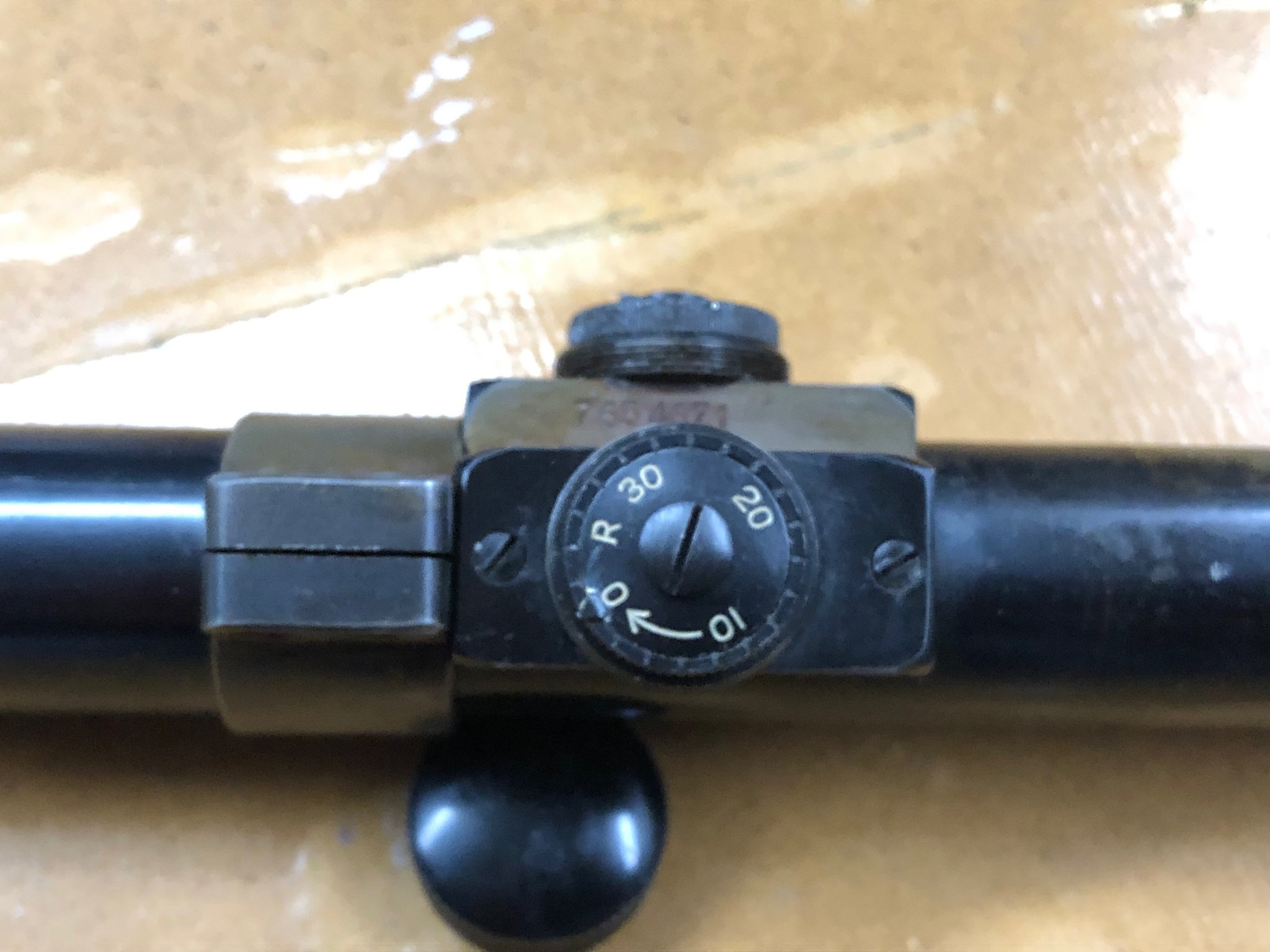

The scope appears to be a legit M82.

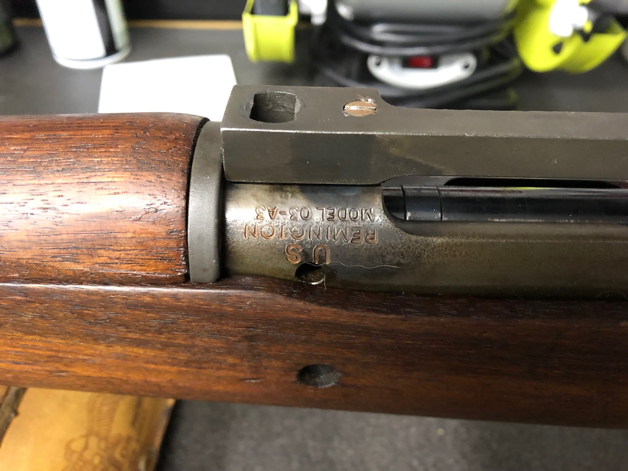

Not exactly sure what is up with that rifle....the S/N has a lot of displaced metal around the digits....as to the barrel, any rifle that failed targeting as a sniper rifle was completed as a standard 03A3 service rifle with iron sights.

Looks like the receiver and scope have been re-engraved to replicate a A4 receiver and M-82 scope. Stock has also been remarked with the wrong inspection cartouche(s). Serial number is out of range for a "Z" prefixed 03A4

Dang, your right. That's the wrong "J". I agree this one is not in the "Z" range for an A4. The seller sold it to me as a "scoped A3 and never tried to pass it off as an A4. I was curious as to how the serial number ended up on the side. The top of the receiver is clean and the same thickness as my other 03a3 but he engraving looks pretty sloppy.
The stock has a great feel to it though. I'll see how it shoots this week. If it doesn't shoot decent I'll see what I can trade it for the next time the gun show comes to town.

I would guess that it is a build done by a non mil entity based on a couple of things.
Bolt is blued and does not look like the military finish. It looks very much like a commercial type blue.
displaced metal around stampings is not normal for mil guns
barrel bands are blued and not parked
shows evidence of having front sight installed, left for a while, and then removed.
Scope base screws are buggered, and most folks who have an A4 aren't going to be that incompetent with removing and reinstalling their scope bases.
SN out of range

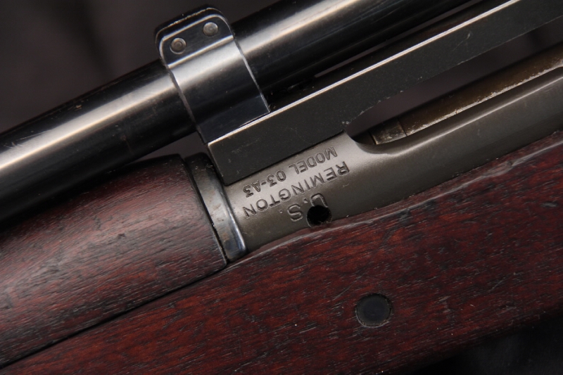

The stock is definitely humped... Ordnance escutcheon and Atwood stamp are fake. I first looked and the photos on my iPhone... on the desktop monitor you can see where the top of the receiver has grind marks.

Glad you guys all spotted that. I thought the position of the lettering was off(?), And, the numbers looked funny, but couldn't push it through my brain what exactly was wrong.

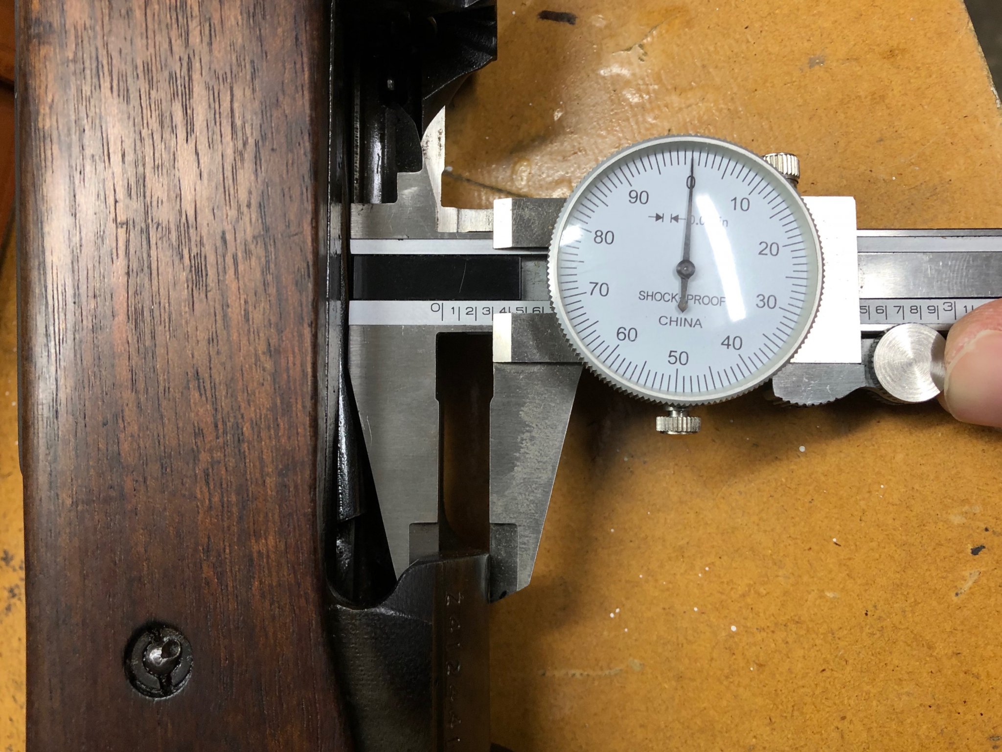

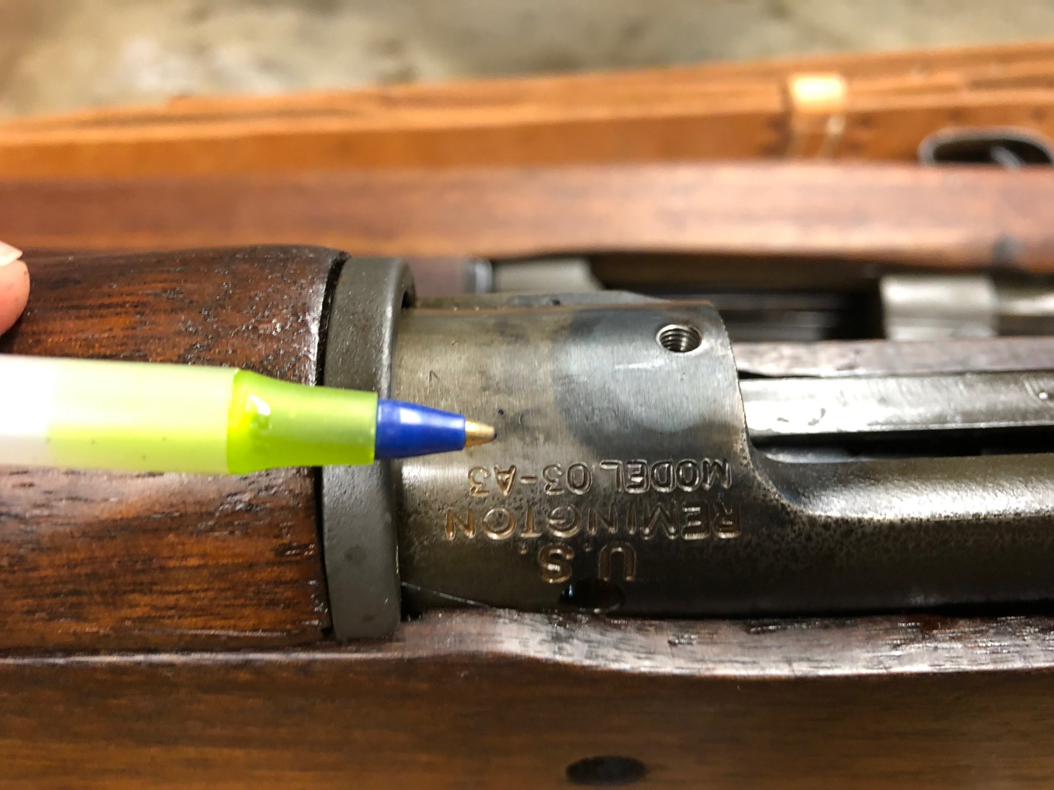

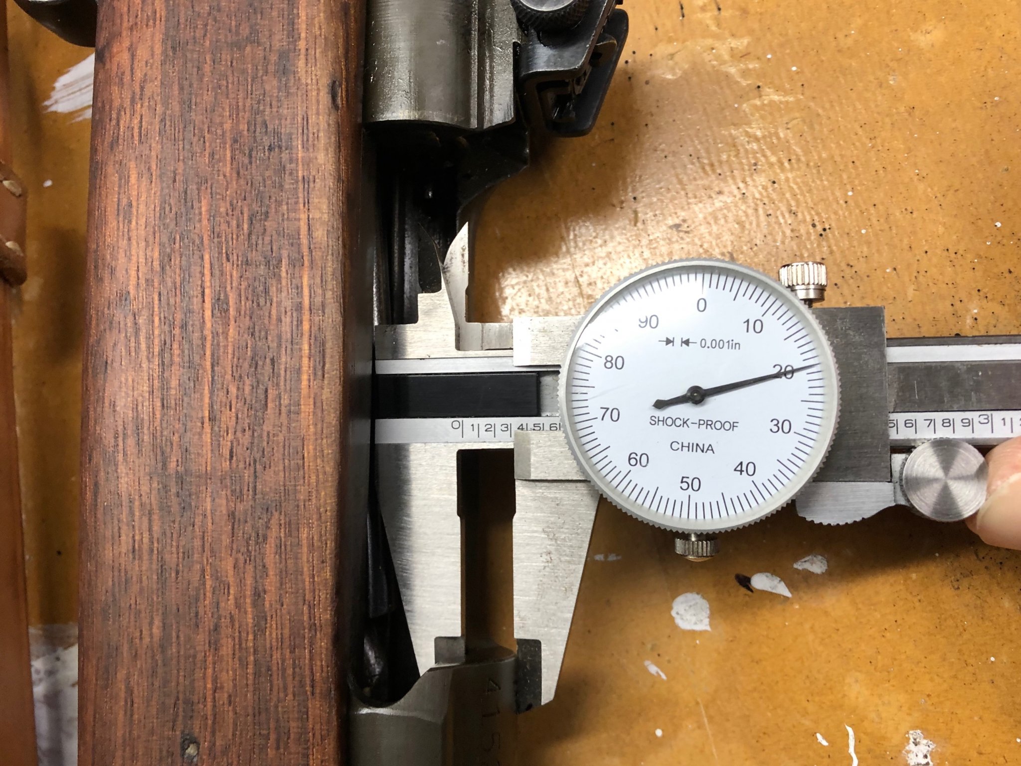

Looks like it may have been sanded down and restamped. On closer inspection I can even see the original "S".
The receiver is also two thousandths thinner than my 1903A3.
I don't care if someone refinishes, rebarrels, or rebuilds a gun. But when they go to great lengths to counterfeit it really pisses me off. I contacted the seller and of course he's being a prick about it. I paid with a money order so I'll see about filing a fraud claim with postal inspector.

Wow, what a mess.
Receiver looks like it may have been badly pitted and perhaps later filled and ground down where it was originally lettered and numbered, perhaps.
Letter/numbers look maybe strange to me, I'd like a closer look. It sort of looks like all the letters and numbers are engraved or redone? Do you think Bubba engraved a new serial number on it?

In the image with the pen point directed to the letter S, you can see the vestiges of the letter N above the pen from the original Remington 03A3 markings that were ground off. Also, the T and O in Remington looks off.
ETA- the E in Remington is cockeyed... handstamped. A real 03A4 is marked as follows.

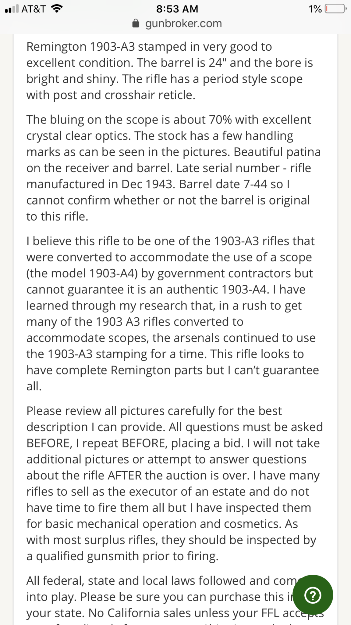

The old saying is "buy the gun; not the story". He's got a pretty vague and hopeful description to go along with that rifle.

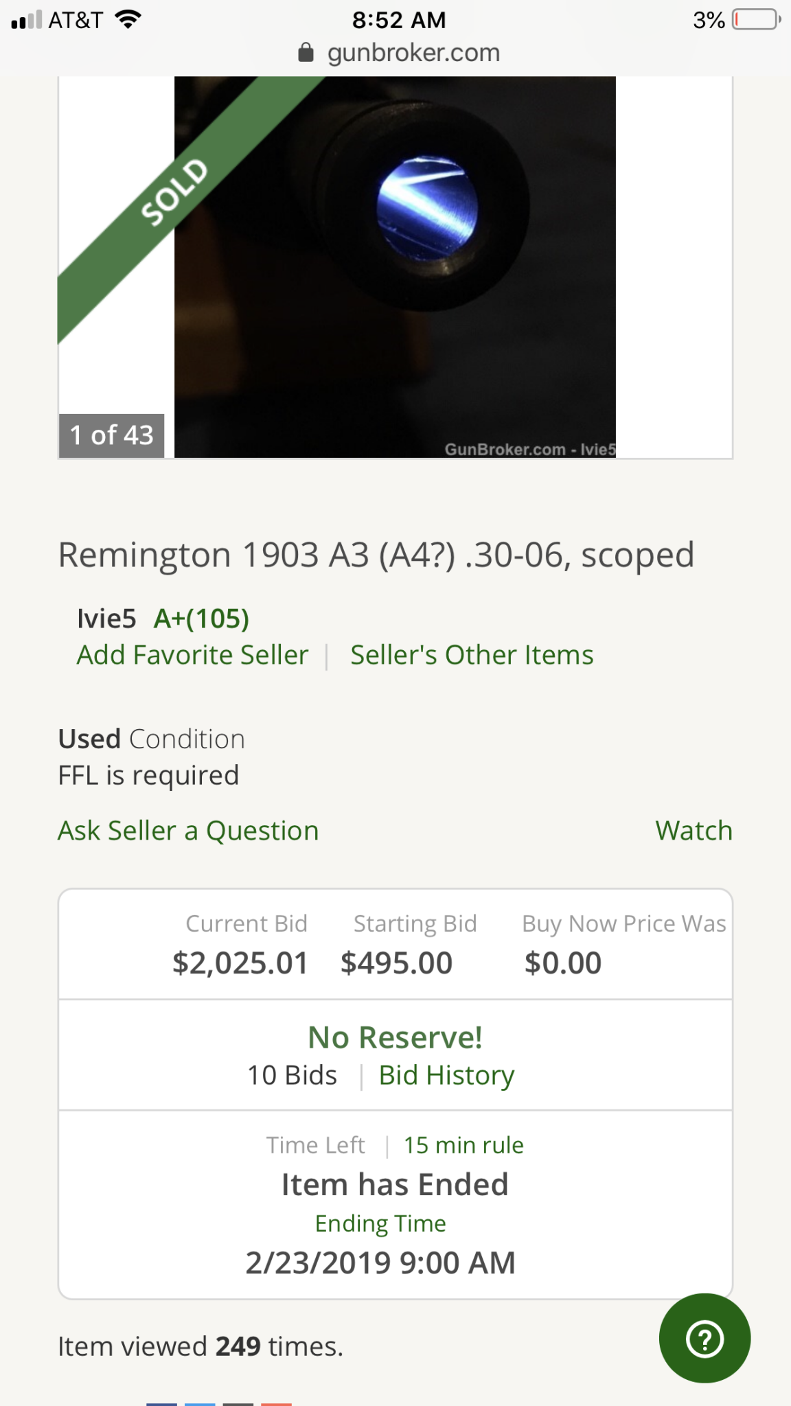

You have a FAKE AS FUCK, 1903-A4. It was fake on Jouster.com and fake as hell on ODCMP.com and it is probably fake on ar15.com and a few other places,,,,,,,,,,,,,,,,,,,,,,,,,,,still fake as shit.
I'm lost here. You bought an A3. You said the seller never tried to pass it off as a 4, but then get mad you didn't score a deal on a gun that hopefully he knew nothing about that was possibly worth way more than you paid? Then the wagon train circles and everyone yells fake A4 and you tell him him sold you a fake (that was never advertised as being anything other than what it was), but seem surprised he didn't want to give you the money back. Is this about the gist of it? What part of the story am I missing?
caveat emptor.

You are missing the part about the 26 USC 5861 (g) and 18 USC 922(k) violation.
ETA- This turd of a rifle has been floating around for years after a cursory search of Culver’s Shooting Page and the CMP Forum... the seller knows it is fake and it keeps coming back. He knowingly sold a rifle with an altered serial number.
