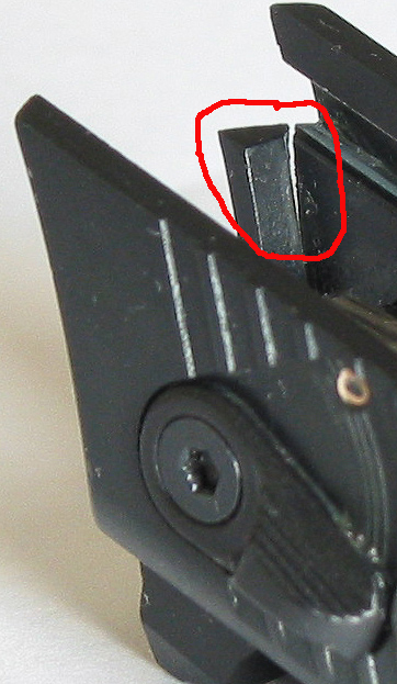

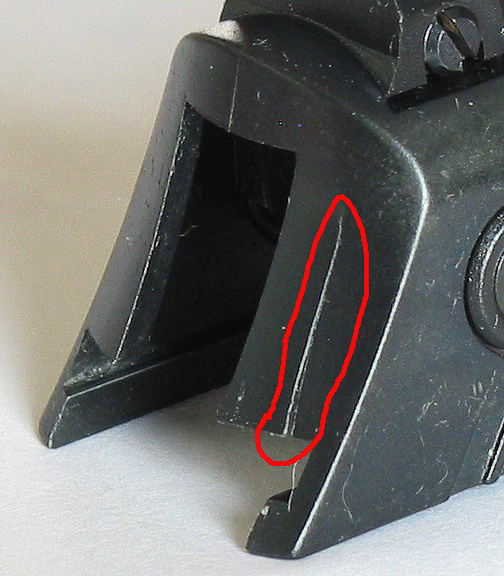

I just received a used SIG Mosquito I got in a Gunbroker auction. While thoroughly cleaning it before taking it to the range, I saw that the back of the slide is cracked.
My first step was to tell the gun shop in Florida about the problem, and emailed a couple pictures. I'm awaiting a response.
The second step was to call SIG and ask about repairs. The answer is $155 (including shipping) and they don't have any more black slides available; just some camo job. They insist that the complete pistol be sent because slides have to be fitted. (Huh?)
While awaiting answers, does anyone weld an aluminum-zinc (I believe) crack? (I suspect not, but have to ask.)

Aluminum zinc alloys aren't weldable. That would be the 7xxx series of Al . The other non weldable Al alloy is the 2xxx series alloyed with copper. They can be braised or soldered. 7000 series Aluminum is the strongest of the group and stronger (but more brittle) than some mild steels.
1xxx, 3xxx, 4xxx, 5xxx and 6xxx series Aluminum alloys are weldable.
Sorry for your misfortune, hopefully there is a means of correction back at the seller. Good luck.

Thank you for the informative answer. This is what I suspected.
I had considered brazing, but feel it would heat too much of the slide and destroy any heat treatment it might have had. Or just melt the discouraging alloy.

That repair would be a no-go even if the alloy was weldable. With a standard 50% de-rate due to heat input and HAZ, it would fail sooner than later. That's not even mentioning warping. AL loves to heat warp and shrink and pull all over the place.

Oh I forgot about that, whatmeworry is correct, aluminum loses around half it's strength when welded. That's why vehicles made out of aluminum are riveted together instead of welded seams. Welding is the process of taking your perfectly machined parts and destroying them with heat. Can't recall the number of parts I've destroyed through either heat-treat or welding ops after machining.

Does the crack impact function? Can you drill the end of the crack to keep it from spreading and then repair when the budget allows?
