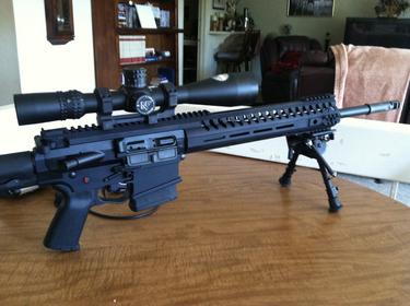

Mixing and matching .308 pattern receivers = asking for trouble
Unfortunately the only option I have for now.
I found 2 .25 ACP brass to bushing my front and rear pins. Will post a picture as soon as I get them ready.
Without bushing DPMS Upper on POF lower:
