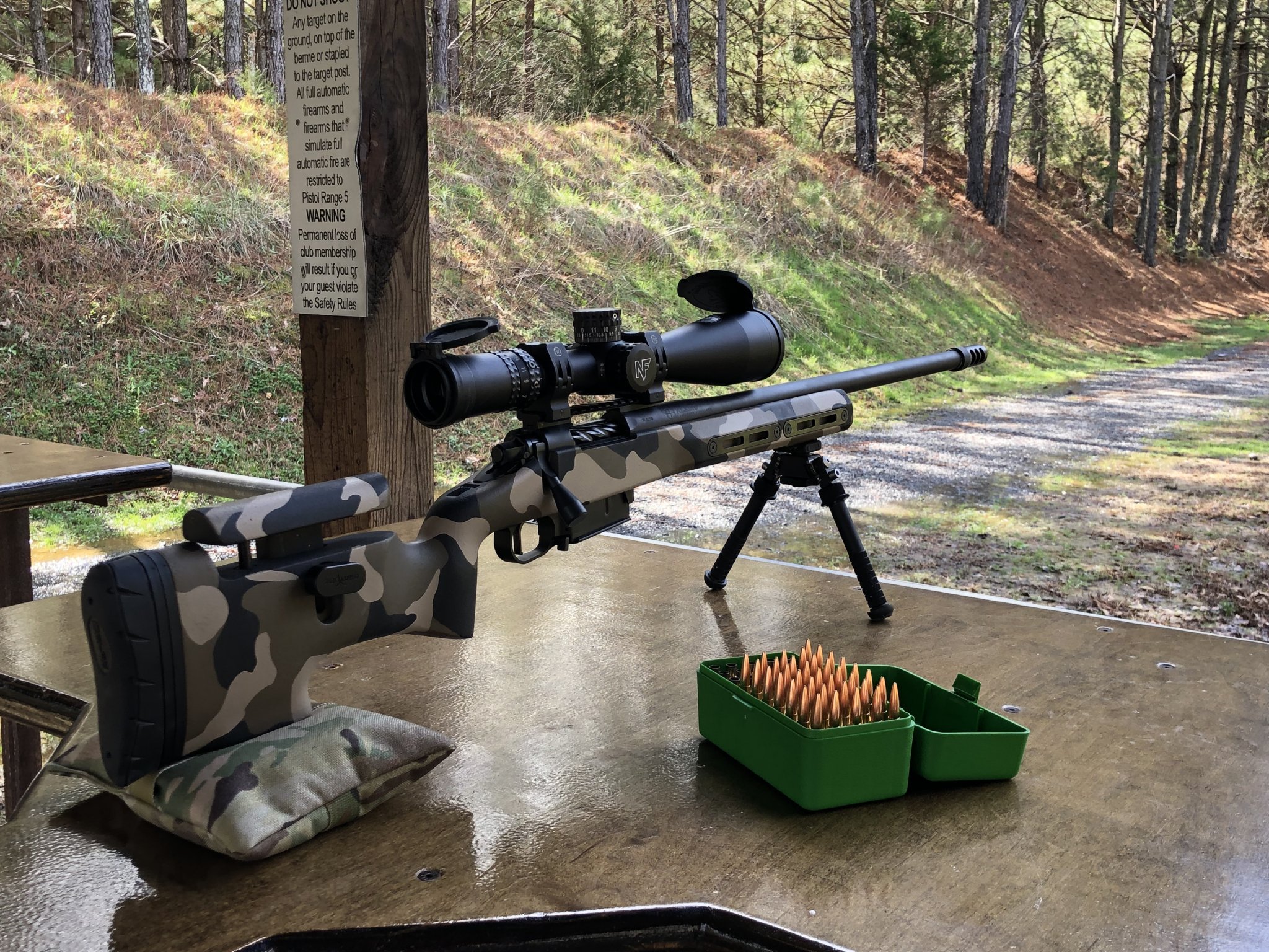

So, I am pretty new at the precision rifle game and I have a newbie question concerning triggers. Not a terribly long time ago, I made a shotgun purchase of a Ruger Precision Rifle and ended up loving this style of shooting and went out and bought a much nicer rifle. This particular rifle came with a Triggertech Primary Trigger and I am going to be probably the only person in the world so far to say this, but I hate it. A little background on me, I'm a Grandmaster USPSA competitor and use to high end 1911 style triggers, my RPR had a two stage Timney that I absolutely loved.
My question is,...I've read on here that the ignition timing, whatever that means, is worse on Timney Triggers and has inherent accuracy loss over triggers such as the Triggertech. Is this really a thing and is it enough to matter on a PRS style rifle? I guess my concern is that I spent a pretty significant chunk of money on a dream rifle and I don't want to make it"less" of a rifle by switching to a Timney Trigger.
Show and tell of the new rifle, because why not. :D
