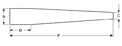

Hi,
Is the Mod5 barrel profile different than the Mod7 barrel profile of A, C, D and F
7038572
Mk13 Mod71.250″.800″4.0″26.0″6.13 lbs.
Sincerely,
Theis

Mark, perhaps this guy has that info?...not sure if this data included the KA suppressor profiling data, but worth a shot:
https://forum.snipershide.com/thread...6343157/page-4
User: Triggered
"If anyone wants to get saucy with barrel options (Mod 0 / 5 / 7), Carson Lilja has supplied me with the links to their technical specs for the barrels on their website. The wait time on the Mod 0s and 5s are about 12 weeks, whereas the 7s are kept on hand.
Besides a 0.5" increase in the chamber surface and a slight taper in the last 2" of the barrel, the Mod 7 and Mod 0 are virtually identical. I may opt for the Mod 7 so I am not waiting 3 months for the barrel, depending on Alan's approval of it working in the stock."
Good luck, hope you find it...
