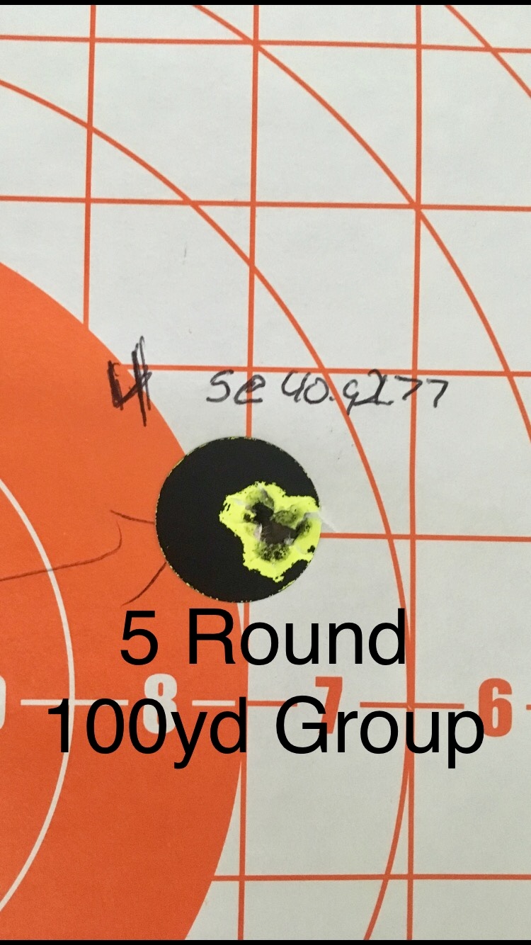

Nothing wrong with a prefit. I re-barreled my r700 .308 to 6.5 with a Mcree Precision pre-fit and it shoots 5 round dimes at 100. I've got over 900 rounds through the barrel and its still going strong. They may not be as "sexy" but you can do it on your bench with a barrel vice, action wrench, go/nogo gauges and a torque wrench in less than an hour.
They all shoot, but with a shouldered prefit you just need the same tools less the gauges, so even easier.
