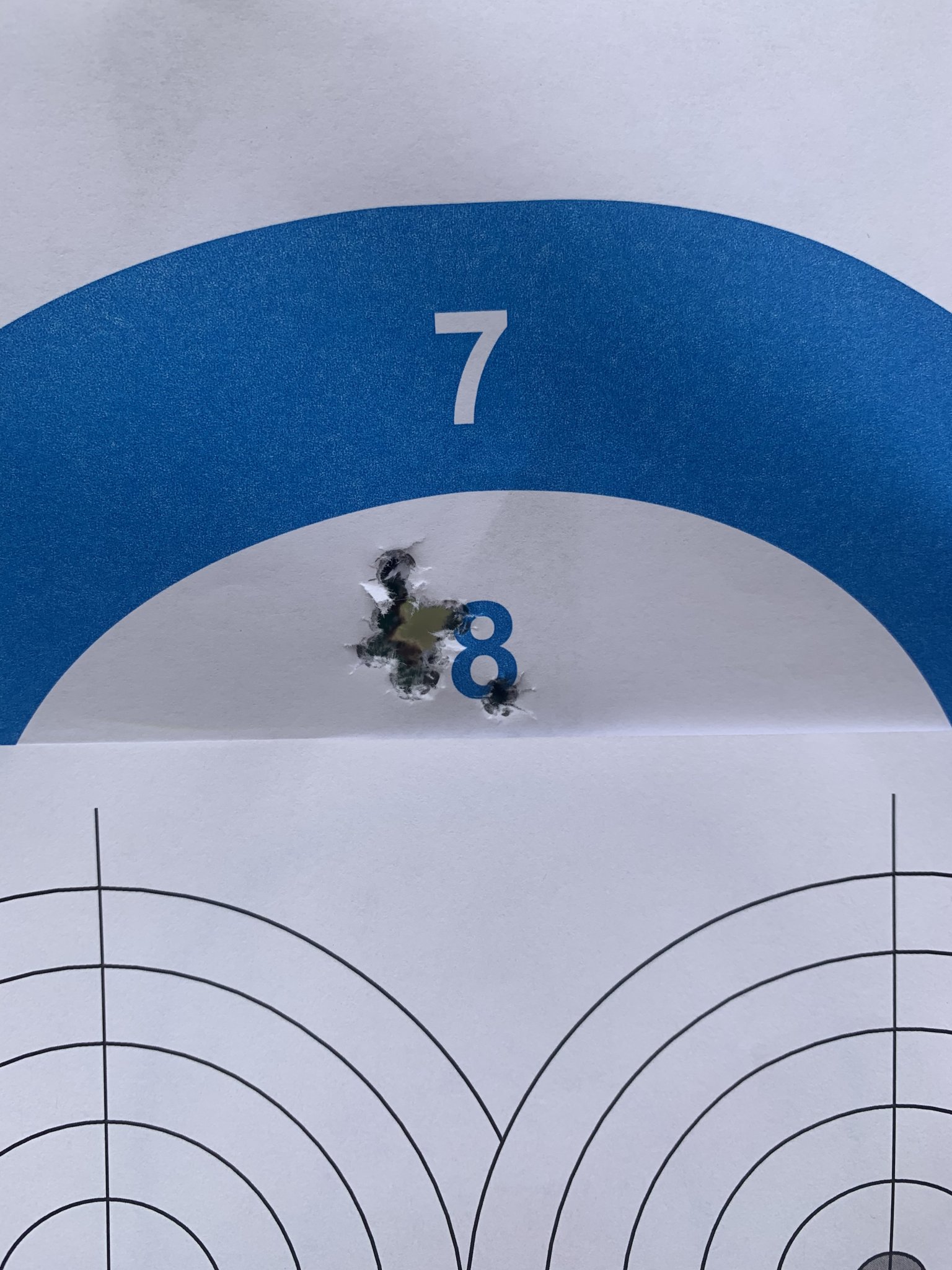

Before I bought my bricks of 22lr ammo I did quite a bit of searching online to see what budget priced ammo people were getting good results with. Almost every sight I went to had the CCI SV performing close to or better than the budget match ammo they tested. It did seem like the really high end rifles didn’t shoot it as well for some reason. In fact one of the articles I read the guy tested with 5 different rifles. If I remember correctly it was a Savage MKii, a CZ455, 2 different 10/22’s and an Anschutz 22. Tha ammo results across the board were similar for all the rifles except the Anschutz. It like the match ammo the more expensive match ammo the best. Anyway almost all of the places I looked had the CCI SV shooting sub MOA at 50 and if it wasn’t MOA at 100yards it was darn close. Now after 100 it starts to show that it is cheap ammo but inside 100 yards it is hard to beat for the money. If I can find the review with the different rifles and ammo again I will post it
Just found it. Interesting results. http://www.dayattherange.com/?p=4691

Yeah, you're right about match ammo typically being under 40 fps. I feel the better one's will be under 30 and at around 25.
220 shots of CCI SV's through my custom RPRR and recording 10 shot sets, I've averaged an ES of 36 and this was for a few different lots. Likewise in number of shots, for comparison, with Lapua Center X I've recorded an average ES of 26 and for Federal Ultra Match the average ES has been 31 (the Center X's and Ultra Match being of the same respective lot).
Interestingly to me, while the CCI SV's performed better than expected for it's price point, the CCI Green Tag did not.. . . as it only gave me an average ES of 39. So, it's SV's over Green Tag for me for sure.

It is interesting to follow the link to and look at the pics of the groups. Gives an idea of the true ability to hit a target.
I found it interesting that some groups had 4 shots close together with one round completely outside the group. That would probably skew the results. If that one round was closer, what would the final results be??
That is typical of rimfire. Cartridge defects that cause strays.
Primer amount differences, irregular brass dimensions, asymmetric bullets, irregular seating, lube amounts.
It's why small samples are not useful when testing ammo.
Odd strays lose competitions.
