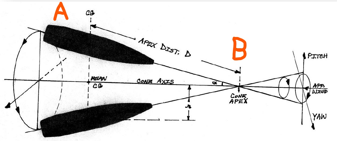

Theis' analogy of a spinning top is the best example to explain it. It's purely about rotational, or gyroscopic, forces. The top "dances" for a bit then settles down. Bullets don't "dance" as much when they come out of the barrel because they are held in one vector line through the length of the barrel. Think then of starting a top with a container around it, such as a plastic tube. As soon as that bullet finds freedom from the barrel it will vary some. No bullet is ever 100% stable. 99.999~something % stable, but never perfect. The bullet is then affected, more in some cases or less in other shapes, by the oncoming air. Take a thin square of wood and hang it out the window directly into the oncoming air as you drive. Some resistance, but not a lot. Turn the piece slightly and it wants to move the whole board in that direction. The body of the piece of wood is deflecting off the wind and pushing that way.
So, as to the "bullet going to sleep". It's not a theory, it's a scientific proven fact. The difference in forces of the oncoming wind and how gyroscopic forces react to that. If the nose of the bullet is off by a tiny, tiny margin, the oncoming wind will want to deflect that bullet. When the bullet is deflected gyroscopic forces tend to push the bullet 90 deg. from the angle of deflection. That is called gyroscopic precession. Precession never pushes the bullet out of place as far as the original deflection force, as it's spread over a larger area of rotation than the original deflection. Therefore over time and distance precession decreases. As, it becomes smaller and smaller, the bullet appears to go to sleep.
Now, each precession movement in reaction to each deflection movement is at different angles. So, those forces offset each other....mostly. And, remember that movements start very small to begin with. A bullet coming out of a barrel sideways isn't ever going to stabilize. But, tiny movements will flatten out.
Group sizes: You need to separate angular size, i.e. moa and mil vs. physical size. At a bullets most unstable region of flight, you will have a large spread, both physical and angular. As the bullet stabilizes in flight more it will mostly remain on the angle it has taken. But, it's not going to physically spread from that angle. Because of a difference, bullets will take slightly different angles. That will obviously generate a larger angular group. With a good barrel and load however, the angular difference will be minimized and the physical difference will be minimized. Meaning the quicker a bullet goes to sleep, the more accurate your physical size is going to be. You can have a wide angular measurement at short range and the bullet stabilizing (deflection and precession forces balancing) creating a situation where Angular measurement will decrease while physical measurement slightly (less than angular) increases.
That's it in the smallest nutshell I can put it. Feel free to burn the wagon down and continue to shoot the way you always do.

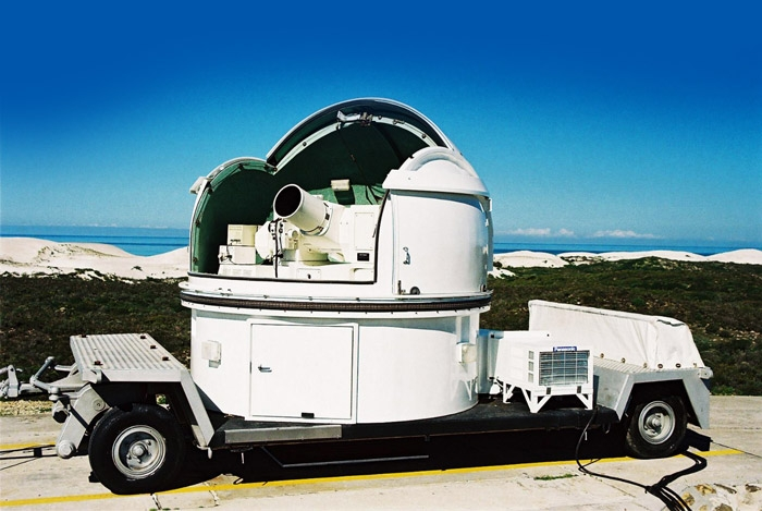

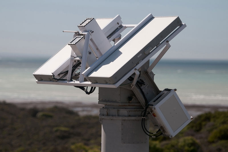

I have a little more respect of results from say:
A continuous wave Weibel radar such as this one:1549914537030.png
Or a Cinetheodolites machine as this one:
Both of those test units are available for use at Overberg Test Range.

I think the idea of bullet stabilization being any sort of "improving" factor is a bit far fetched. Whether the bullet is wobbling or flying straight and stable the center of gravity of that bullet is going to follow the predicted trajectory. The only external factor is the aerodynamic interface as it flies through the air.
I don't think of a wobby bullet as a corkscrewing bullet. The "wobble" is SOOOO much faster than the trajectory travel of the bullet. The bullet is spinning at 250k RPM or thereabouts or roughly one full turn for every 7 or 8 inches of travel. Compare that to a football where it is maybe 600 RPM and travels 5 feet or more per revolution. Even if the bullet nose doesn't point perfectly straight it's spinning so fast that any sort of "corkscrew" effect is not going to happen where the bullet comes back onto target like a controlled curve ball from a pitcher. Rather I'd see it as a bullet that flies in less than predictable fashion due to the aerodynamic effects of unstable flight, particularly since the nature of the "wobble" from shot to shot is likely inconsistent.
The most common sense argument against the idea that angular improvement in group size due to bullet stability is possible is this..... A reduction in a destructive factor (bullet instability decreasing as the bullet flies) is NOT the same as an improving factor. Chaos does not lead to order.
Some other things to consider are this... the starting point of the trajectory of each shot is NOT fixed. The barrel moves during firing, and there can be a different muzzle exit position from shot to shot. Secondly, velocity can be different from shot to shot, and these two factors can be intertwined. That's why something like positive compensation can be possible while the bullet stabilization theory is IMO implausible.
It's clear then you don't understand gyroscopic precession, whether it pertains to bullets or not. It pertains to ANY spinning mass. It's reaction is very predictable. And, it doesn't take a lot of side force to create movement in a general 90 deg direction from the direction a force was applied.
Yes, the bullet wants to follow it's intended trajectory. External forces, i.e. deflection, WILL move it. And while it's spinning fast, the force will still act. And, the precession will still be a result.
I think the most misunderstood part of this is when bullets go radically unstable. You aren't going to get a super group @ 1k from a keyholed 3" group @ 100. But, pull your targets that you zero with @ 100 using uber VLD type bullets and measure the hole each bullet makes. If they make one hole, take five of them and shoot five individual holes. You might need to blow them up a number of times, like benchrest records are measured, to see the keyholes. They are there. You just don't see them on a big scale.

Hi,
Lets try and simplify this concept a little more.
I think some are thinking that we are saying a 3" 100m group can turn into a 1" 500m group..That is NOT it at all.
What we (Well ME) are trying to say is that as LL said it all can be a wash when we add human factor but that does not mean the concept does not happen :)
Think of it like this:
In the image below we have a projectile that is 1.25" in length.
Location A is 100m
Location B is 300m
Factor in the length of the projectile and the rotational cone area; is the group size at location A larger than location B?
YES I am aware that we are not bringing in any environmental conditions into question; but rather simple question based on distance of achieved full stabilization.
YES I am aware the image is not to scale and exaggerated to highlight the subject in question.

the problem is, these out of scale images in part, the coning stuff is microscopic. This wobble is so small, it's not like a crossbow bolt where you can see the back end spinning.
When this stuff grows to a noticeable portion, the bullet is usually out of sorts. You can see the tips and how they hit even on steel with a Hornady bullet, the plastic makes a visible indent that you can see on the plate. We are really talking about one side of the center or the other, and not so far off center that it causes the bullet to hit sideways. You'd see random oblong hits on paper or steel.
The best way to see what is going on is not from group size, that is all about the shooter, but the BC values. You have to actually do the math and see if the BC goes up or down. then you have to look at the various results of a BC Test. That is why people will say, show me, because they know it's so small you can't actually demonstrate it without keyholing the bullet.
if you see it, it's you, that is the easiest way to put it. If you have a flyer you can almost point to this, but with flyers, you see it in a random way and not a consistent group value way.
It's like when guys talk about canting the rifle, they use 5 degrees which is huge and very user noticeable. That is no our issue, it's the .5 degree variation we put into each shot that messes with our group. to the point, I can notice a progression of canting downrange at the target. There is a pattern and I can see that pattern on the paper.
For the coning theory information to be considered, I highly doubt you are seeing it unless you can repeatedly put down .25" groups or better. And by repeatedly, I mean every single time.

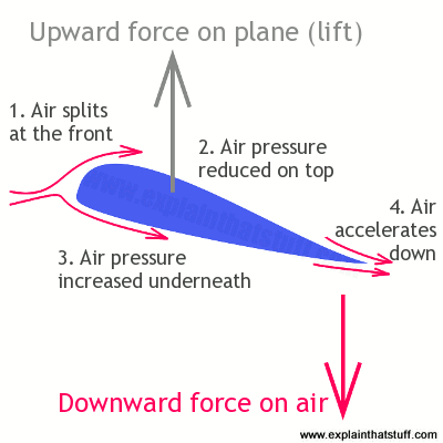

Who is this fucking retard Joe Calamia retard that pretends to know how airplanes fly. They DON'T push air downward, The camber of the wings creates a low pressure above the wings. A propeller moves a plane through the air by creating a low pressure in front of the prop. It's the camber over the top of the wing that provides lift.
As to the bee, it flies just like a plane or a bird. It flaps it's wings so that the camber over the top of their wings provides lift. They change the angle of the flap to hover or fly forward.
You are mixing up the writer of the article, with the writer of the published scientific study he is writing about. Written by "Michael Dickinson, a professor of biology and insect flight expert at the University of Washington."
"An airplane's wing forces air down, which in turn pushes the wing (and the plane it's attached to) upward."

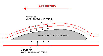

There is a pressure differential. I take issue with the dumbass saying the wing pushes air down. It's the low to high pressure differential from the top of the wing to the bottom of the wing. It's called Bernouli's principle. It's the low pressure over the wing that creates the lift.
What you are showing is a wing during climb, which pretty much equates to drag. Or, an elevator lifting the rear of the aircraft so it will descend.
Read this.
http://www.csun.edu/scied/4-discrpeant-event/Bernoulli_effect/discrepant_event.html
