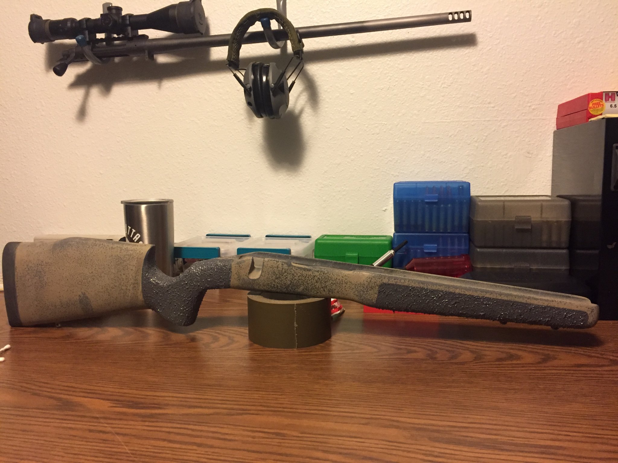

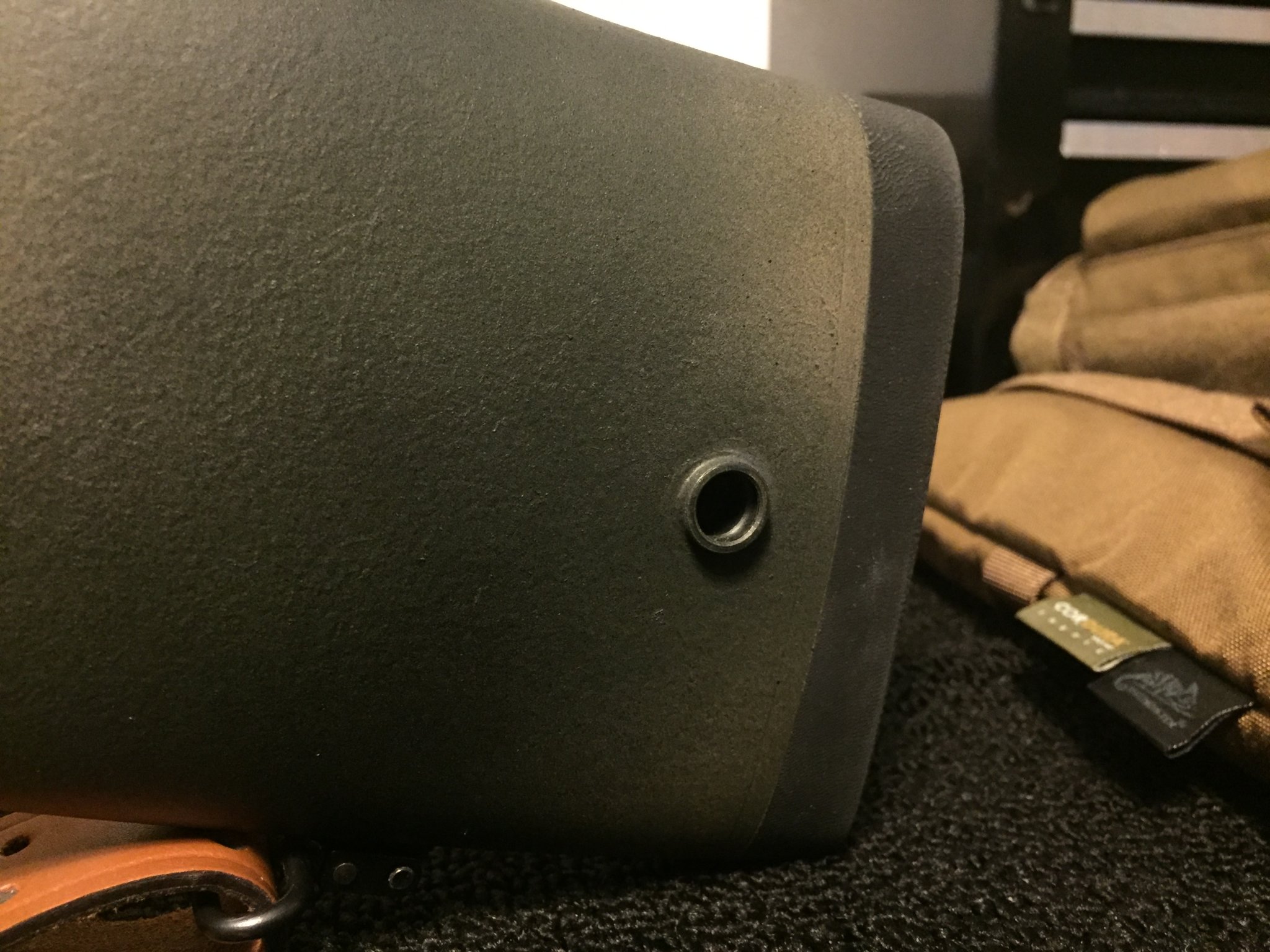

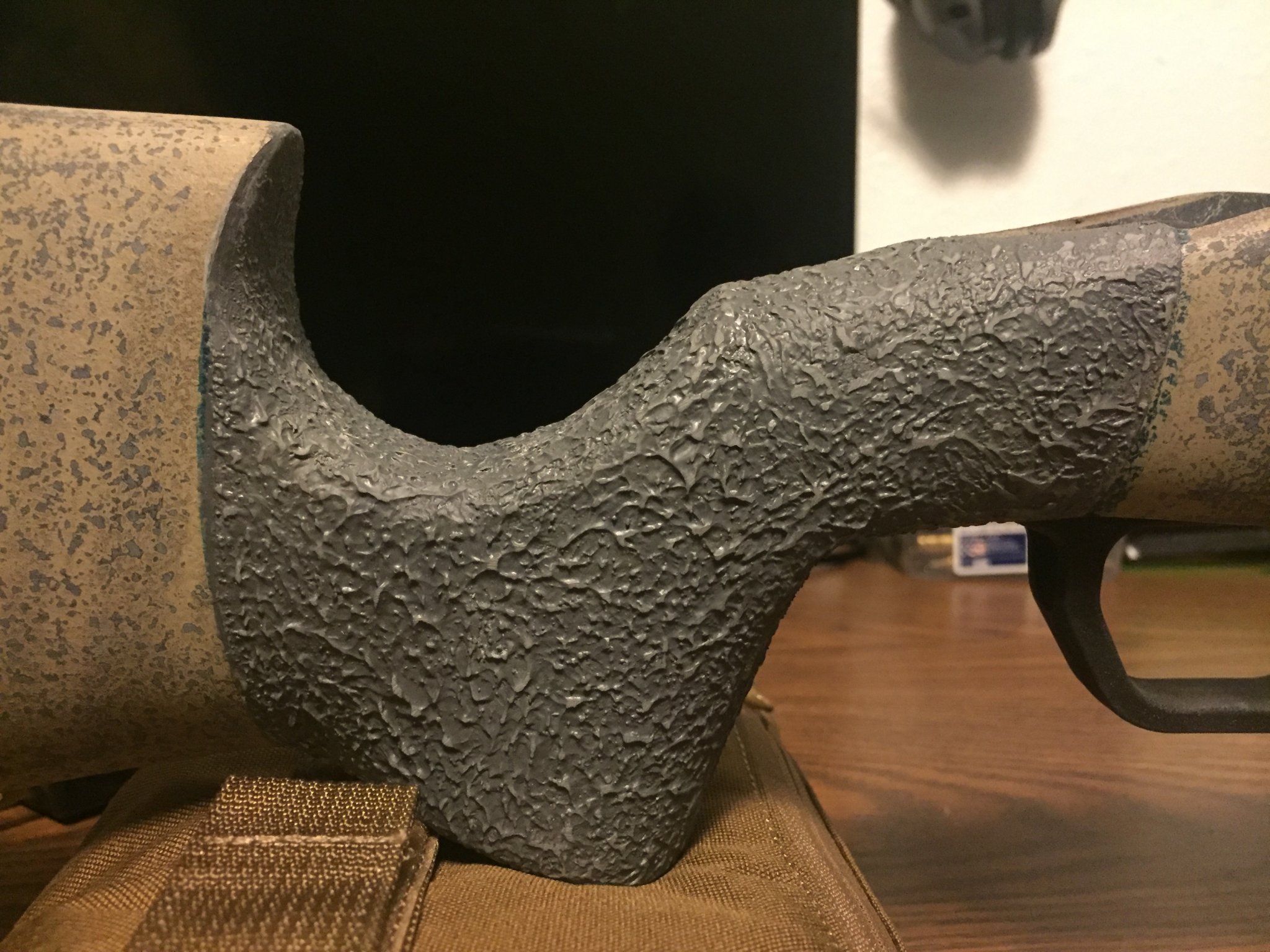

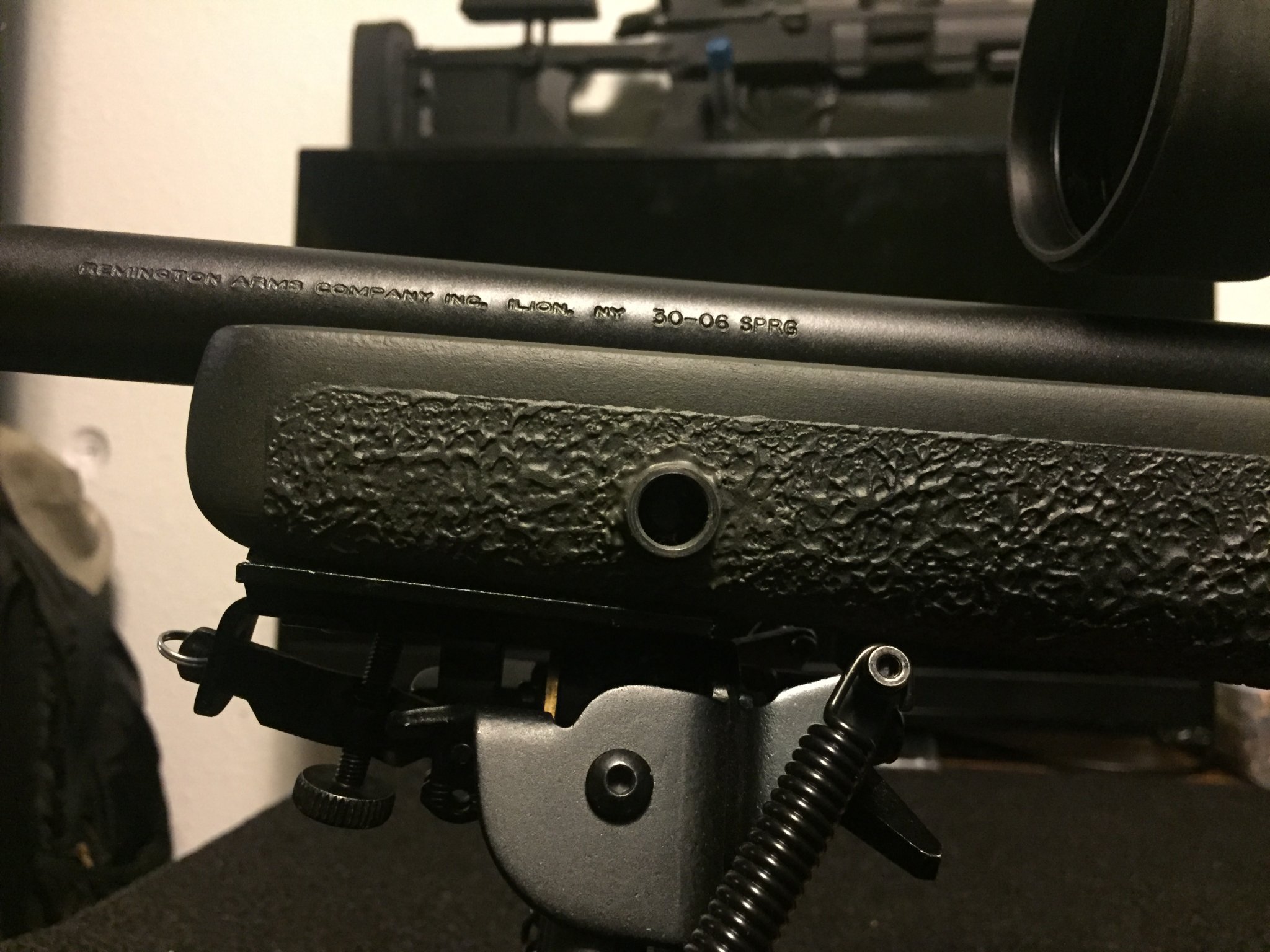

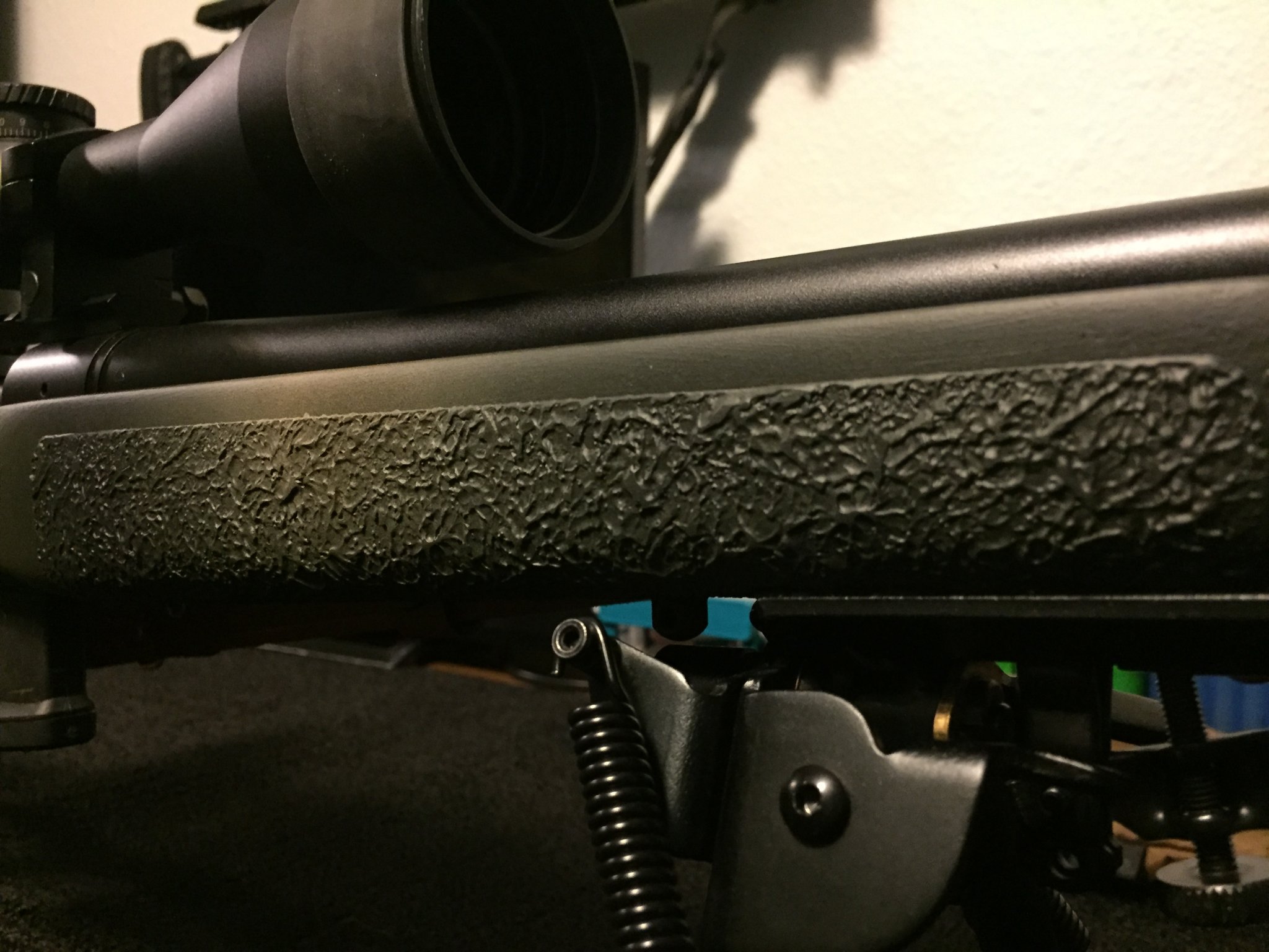

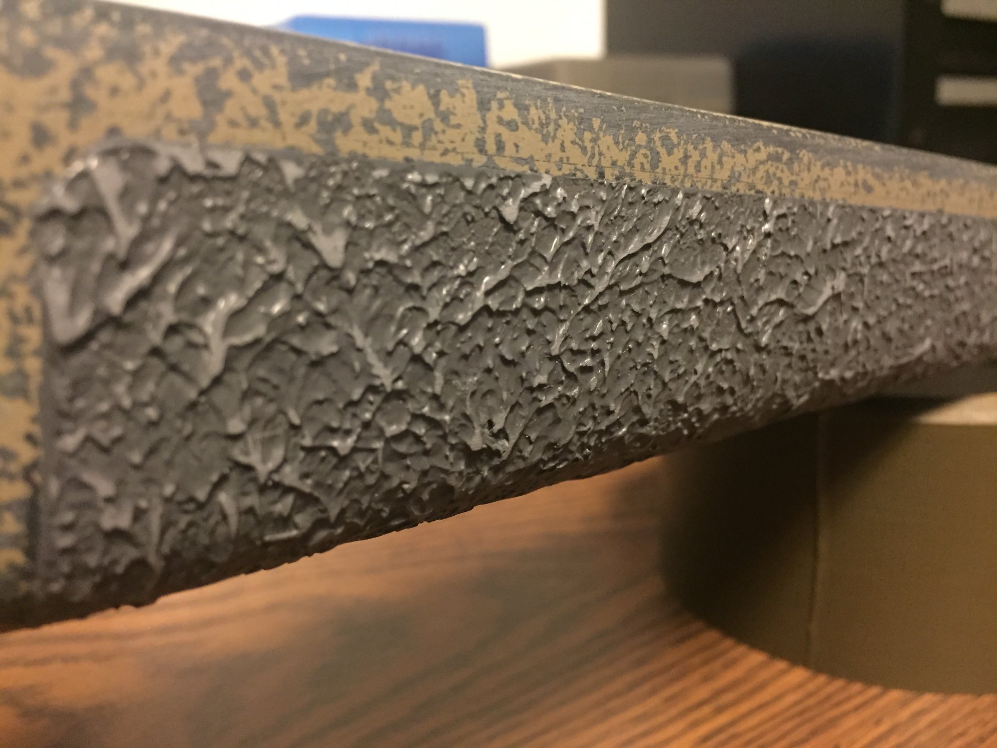

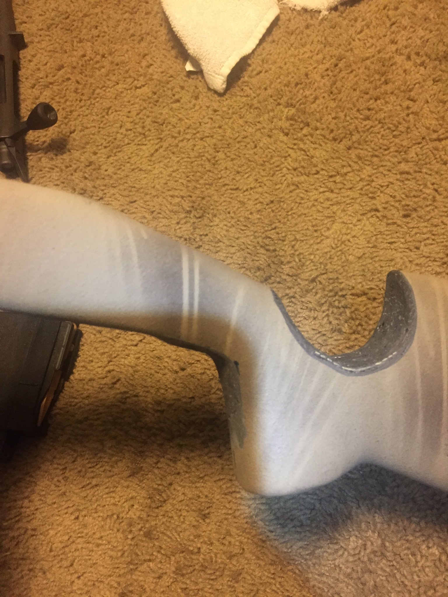

Alright guys, well ive had a R700 long range sitting in my safe for awhile collecting dust. I decided to go ahead and make it into a project gun, as i was thinking of setting the barreled action into a new stock anyways. So basically i took the factory B&C stock, cut it up, textured it, and repainted the whole deal. Let me know what you guys think.
Before all hell broke loose:

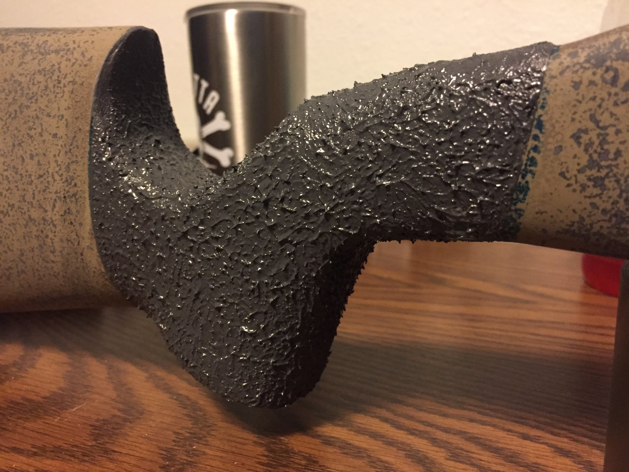

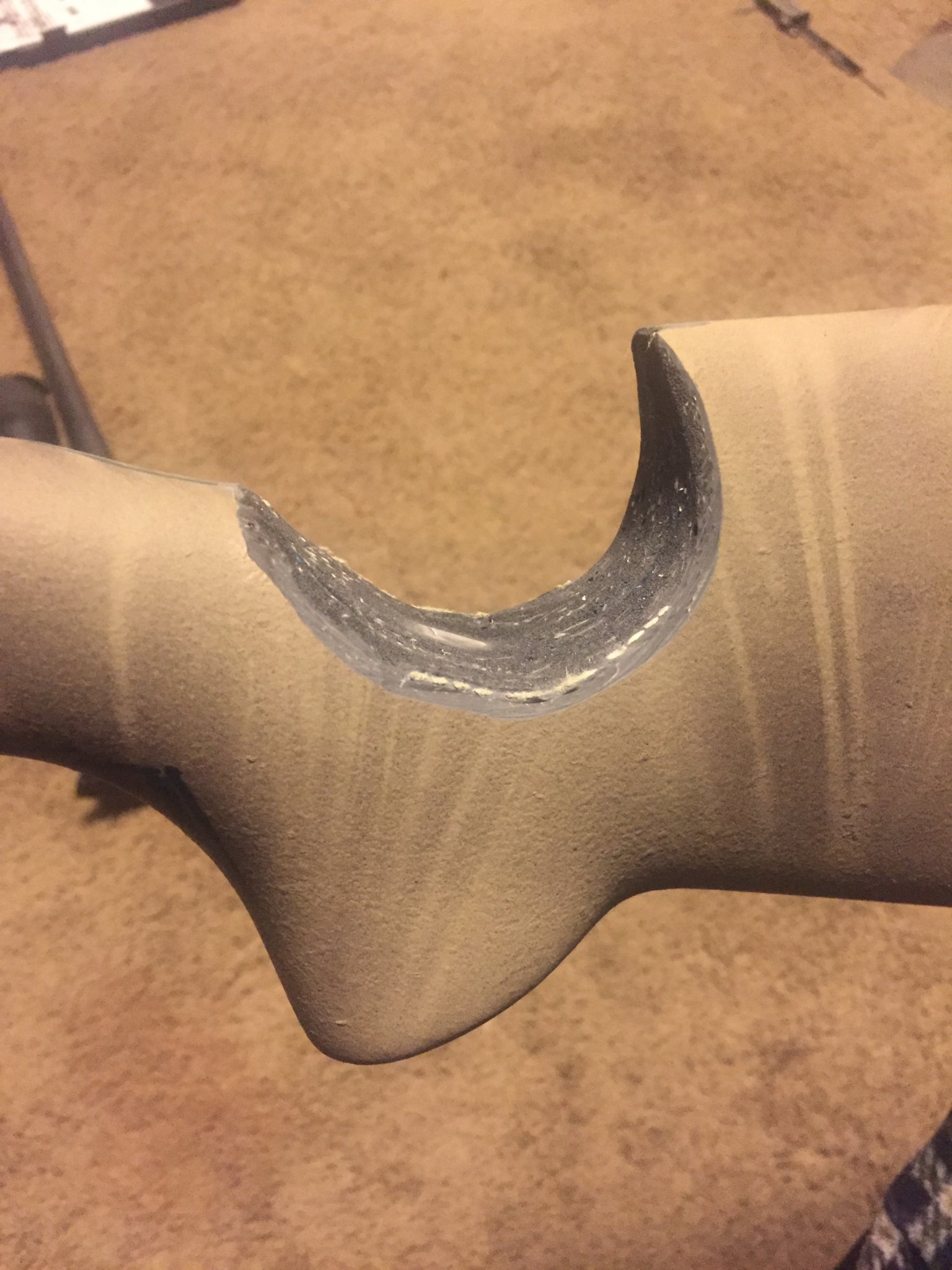

I pretty much cut the large chunks out of the grip/comb with a hacksaw, and finished it up with a dremel.
Then came time for the epoxy
After sanding down the peaks/sharp areas.
QD flush cups

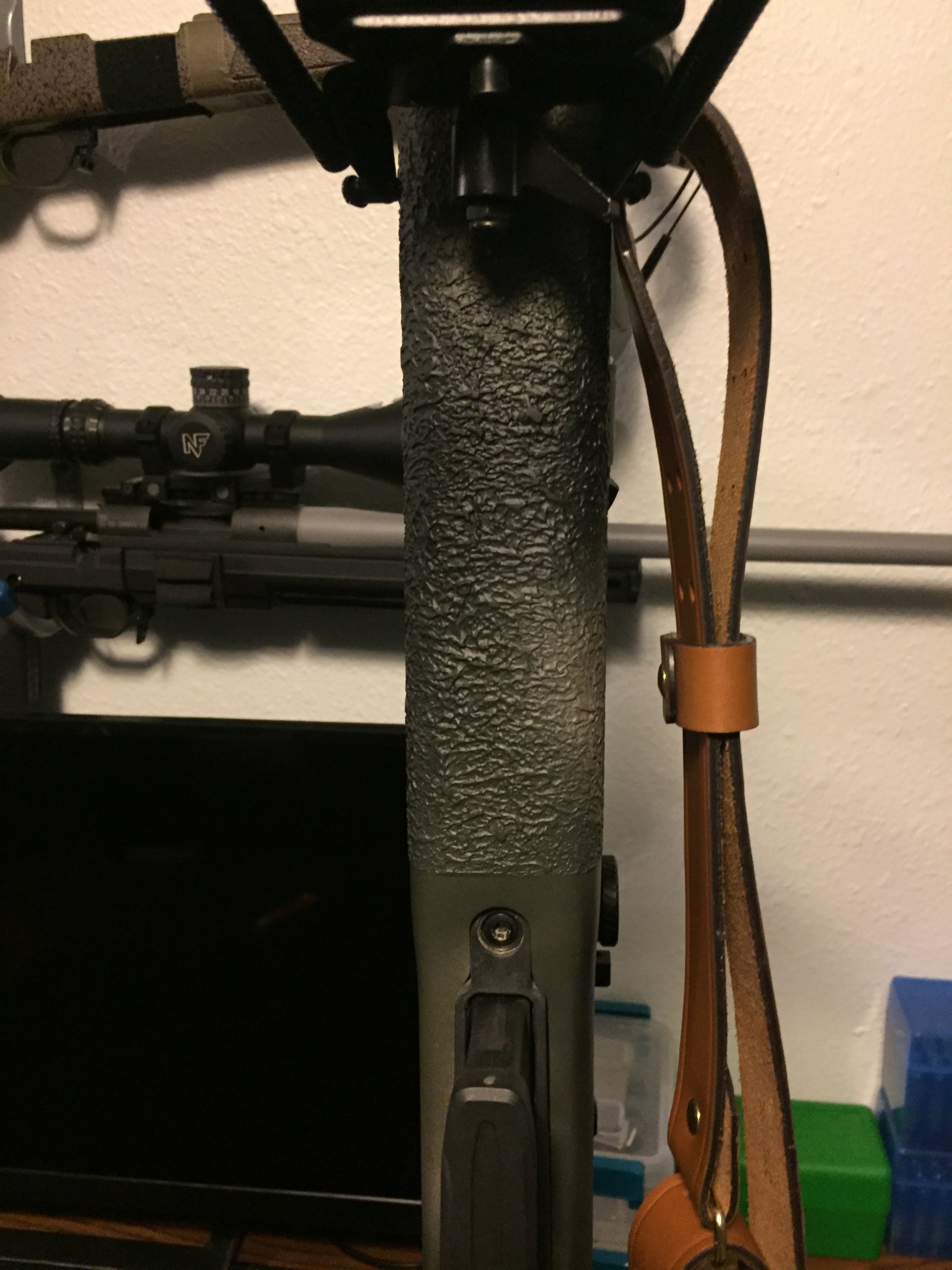

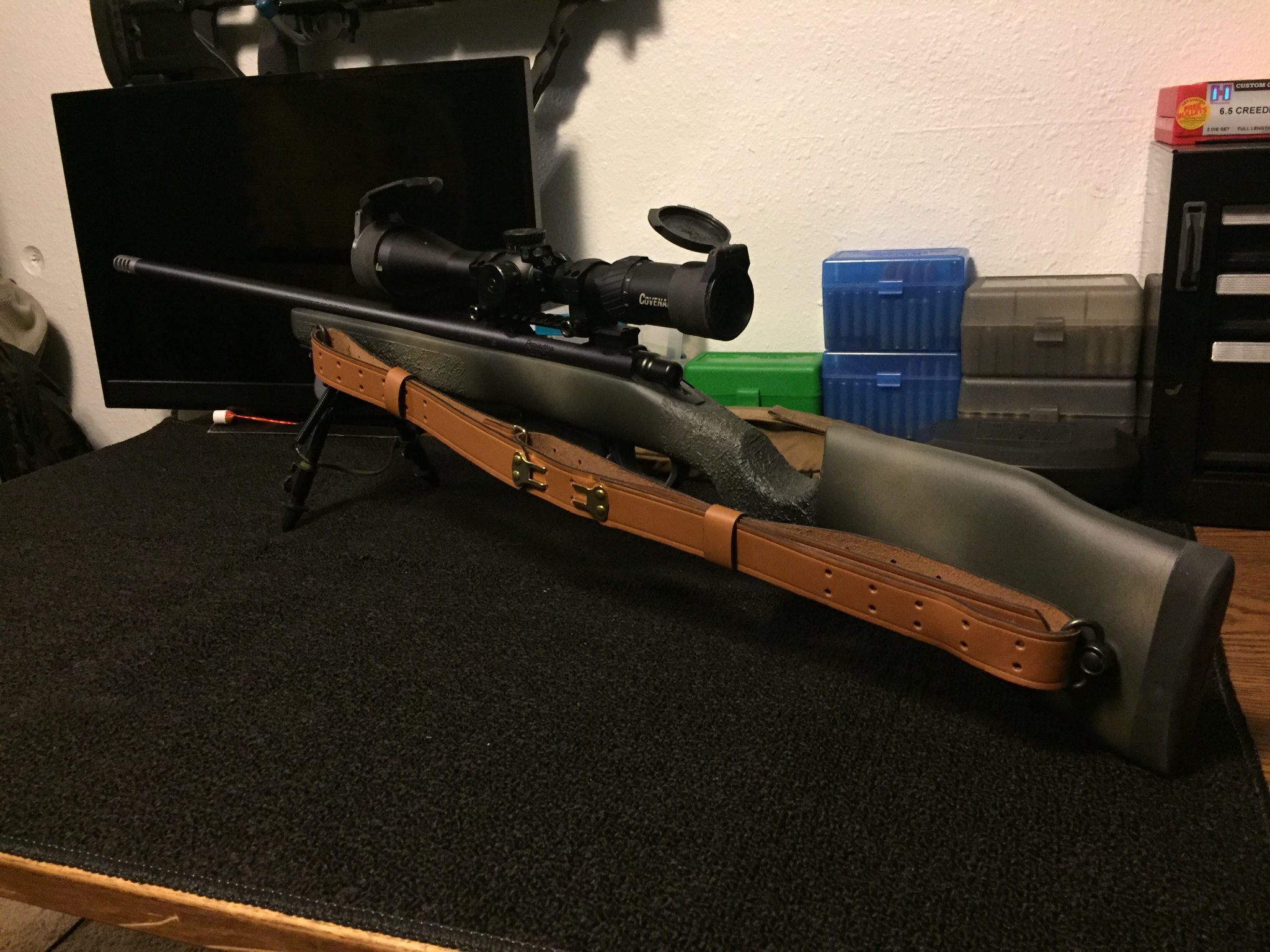

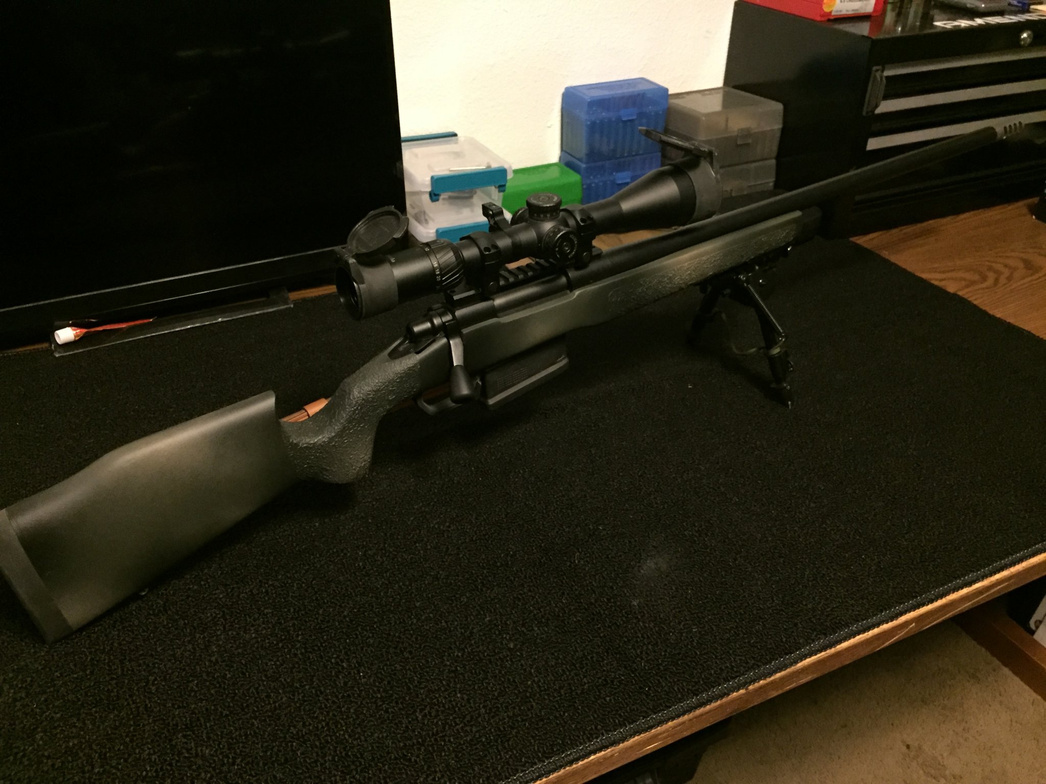

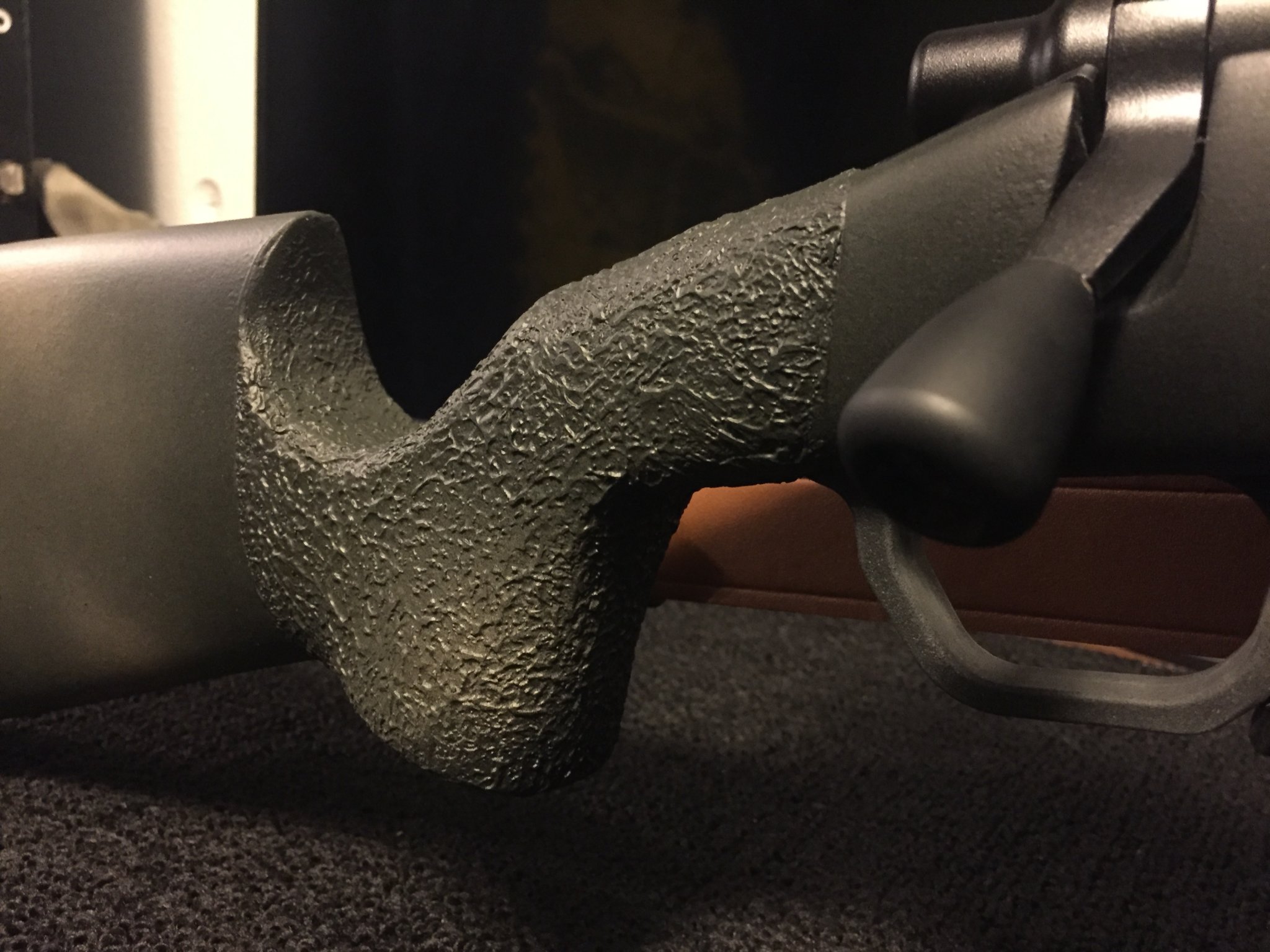

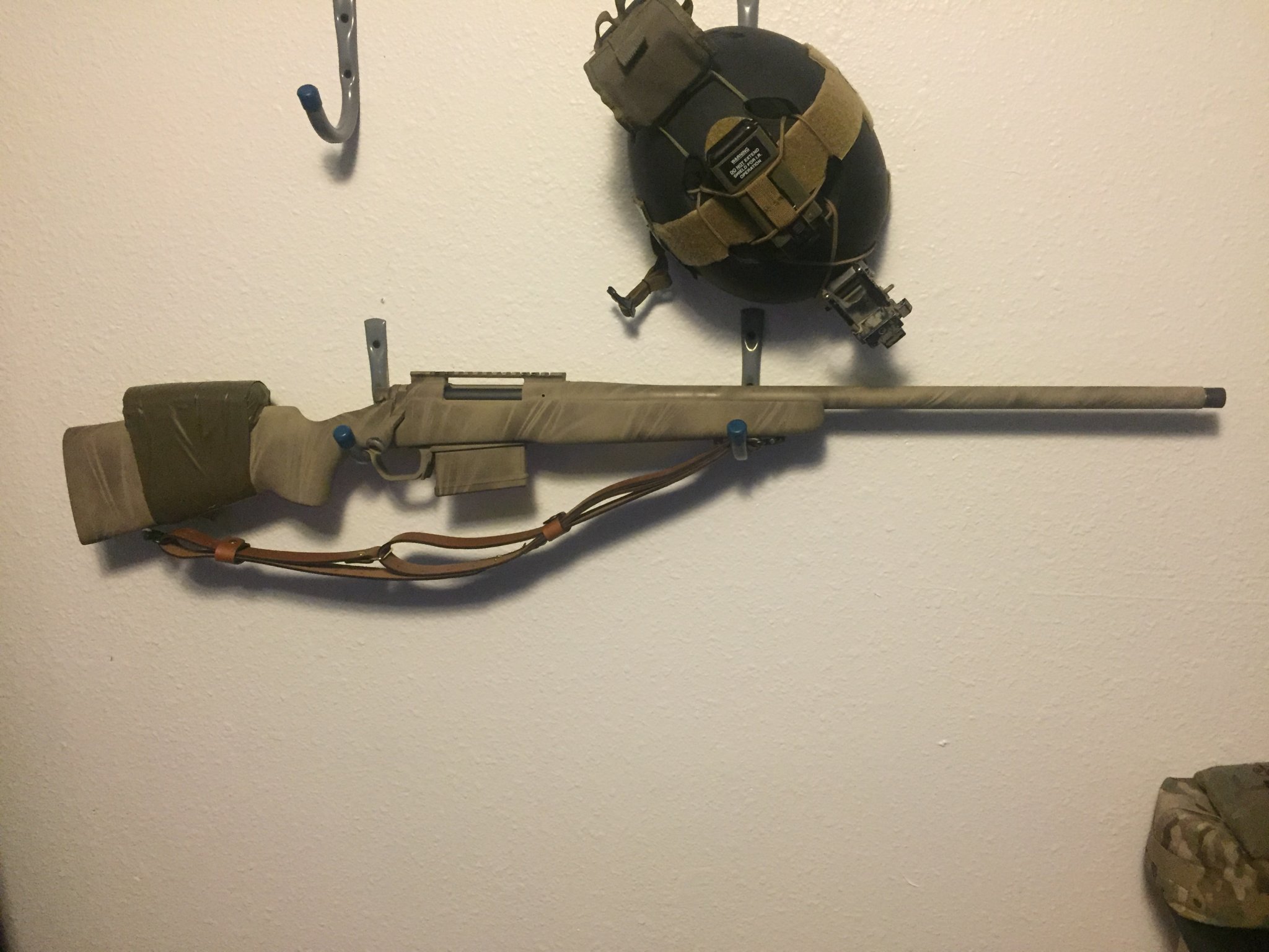

The finished product, so far. Missing is triggertech trigger an a kydex cheek riser. 6127454F-BDB0-4B5D-8CEC-4E5A57A50256.jpeg674AB279-08CD-4AAC-AB57-9379505ED2AA.jpegFC89FF44-DC13-40E9-836D-337AF9A4ECE3.jpeg19B1D954-FECC-4FB1-9CEE-6D784614B0AB.jpegDA02C2CB-E46B-4902-BC60-2ADF3700443B.jpeg4AE66A81-6340-46C9-A94D-888A41C0B2BC.jpeg

Holy cow man that's awesome!! What did you use for texture? I'm looking seriously at the m40s stock for my Savage and it sounds like the cheek Weld may be insufficient based on you wanting a riser? Do you like it otherwise?
GN2
Nov 16, 2018
5
5
6
I used JB Weld for the texture and yes, it needs some sort of riser. I do have a stock pack that i had previously used and just built up the comb with some sleeping pad material and 100mph tape. But a kydex riser would be more permanent/durable which i am adding next. Overall it is a decent stock, especially after bedding it. It came with the gun originally, but it i were looking to buy a stock, i would be looking for something with more options/adjustments without having to modify it.

Love the texture. took some time to do all that I am sure.

may I ask what technique you used to get the texture? sponge or something similar? awesome job sir.
