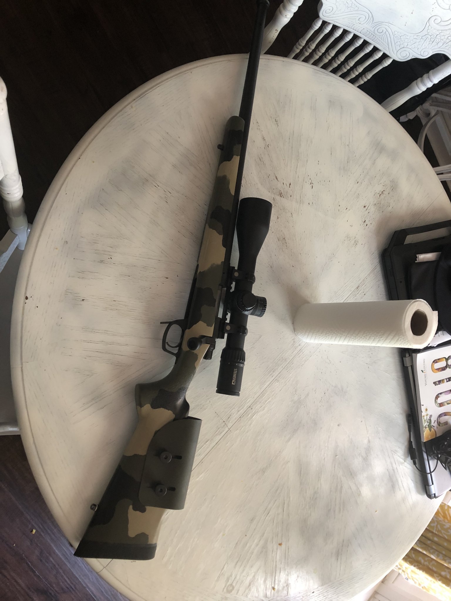

Great review, after buying two of these myself from the guys at cameraland, I too feel like it’s a steal. Initially was worried also after reading some of the issues the EARLIER scopes had.
Today ironically enough I compared mine side by side to an xtr 2, and also an older nightforce nxs 5-22x56. Multiple shooters at the range today all looked through each, and we all favored the glass in the Steiner.
My turrets seemed to track true out to 935, and match my StrelokPro calculations after chronographing loads on the magnetospeed.
I was really surprised at the clarity, and how little magnification was really needed to make solid hits. Furthest hits were 935 on a 24 inch (I think) piece of steel. Also made solid consistent hits on a known 8 inch plate at 800 yards. These hits were made at only 12 power, as down here in south Louisiana, anything much higher than that and the mirage gets you.
Also to give guys an idea, I mounting this on a 700 SA with a zero MOA base, and after zeroing still have 15.5 mills of elevation. I am shooting a 168 grain hornady eld m, and only needed 9.7 mills to get to 1,000.
The FOV on this scope is great!
Edited to add, on the bolt gun it’s sitting in nightforce ultralight mediums, and on the gasser an adm recon qd mount.

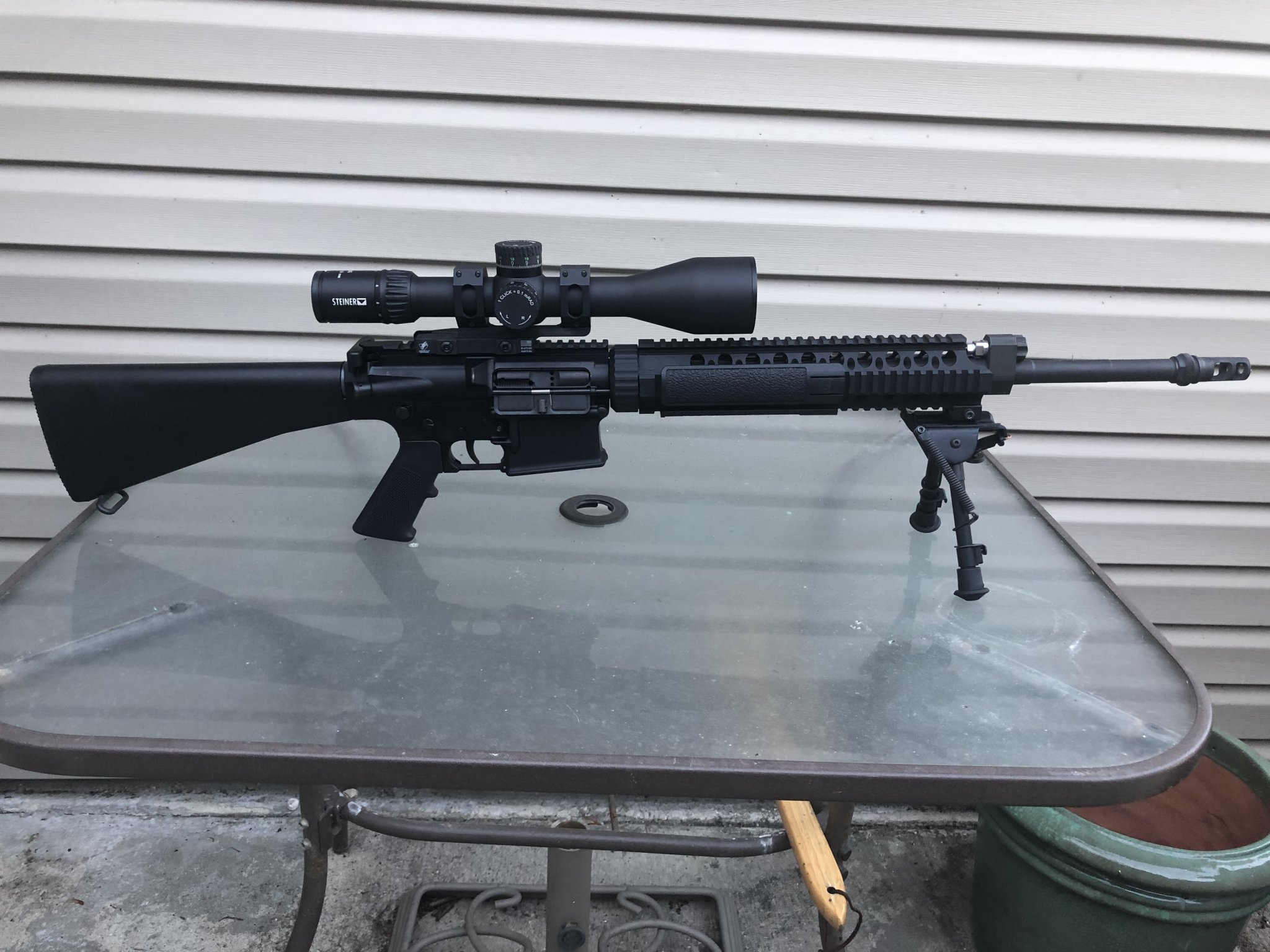

Update:
I was able to take my 224V out to the field today and do a little more evaluation on the scope.
Glass- the optical clarity was good. Much much better than the XTR2 without even having to look through them side-by-side. Looking at terrain features off in the distance I can still see details in the terrain, logs, stumps, and etc no problem. Mirage was visible but not distorting the image even on full 16x.
One thing I did notice was I used the SH advanced marksmanship target to zero the scope at 100 yards. I did notice some CA looking at that target around the black dots. I had another target to the right with white dots and no CA visible to me there. On 16x I could see my 224v holes no problem, I could read half inch sized letters at 100 yards no problem. The CA visible on the SH target at 100 was the only time it really stuck out to me that it existed. If it was there while glassing around the terrain at varying distances, I couldn't detect it.
I wanted to perform a tracking test, but I forgot my tall target at home along with my wallet and sunglasses. Figures. When I was zeroing the scope, I would measure a previous impact with the reticle and make the adjustment. It seemed to line up, but that's not enough travel nor is that an accurate enough test to see if it was off a tenth or not.
The bad:
Someone please tell me if I am doing this wrong, but after re-zeroing the turrets to set my 100 yard zero my lines on the turret and scope body do not consistently match up. I lined up the turret with my 0 dead on the line and evenly tightened both screws transitioning between the two incrementally tightening them. It is dead nuts on and then is off a little, back on track, and then off at the top of the elevation.
I have 15.3 mils of travel left after zeroing with 0 moa base and 0 moa rings on AR15 224V 88gr factory ammo. By the time it reaches 15 mils, the line on the scope body is halfway between the lines on the turret. This was consistently repeatable. I tried multiple times loosening and tightening the screws. I will link a video.
