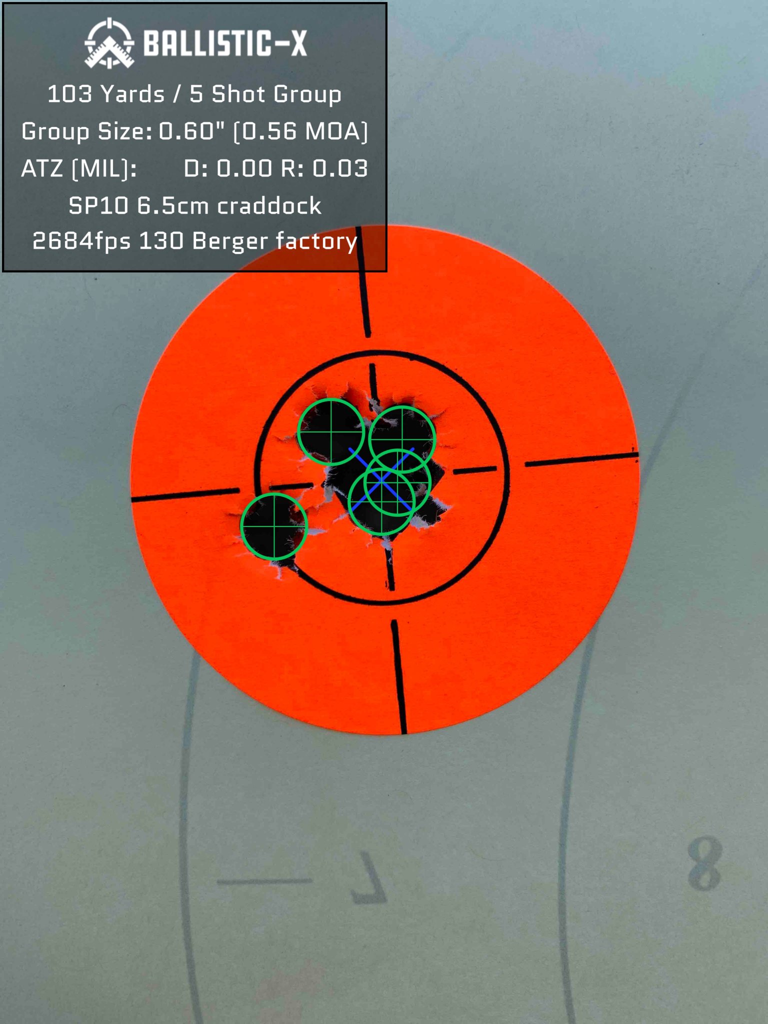

What about Craddock Precision barrels? They carry a premium, but from what I can tell they're supposed to be very accurate?

I’m down with that. As such I called craddock and told him what I have and what I want. It’ll cost a few pennies compared to something off the shelf, but I like knowing my gear isn’t the problem when I miss.
