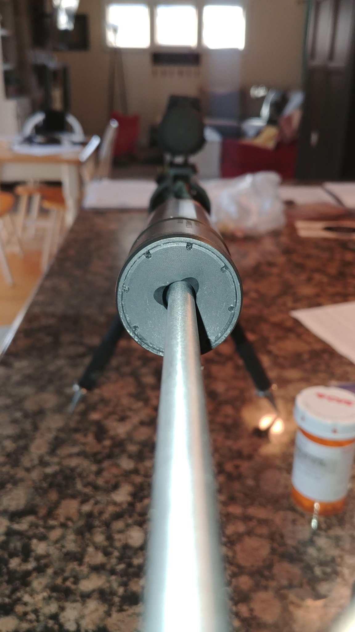

Got the 19/64" rod today and the suppressor is definitely not concentric to the bore. Once I get the new keymount brake, I'll take a look again. I'm hoping it's the mount and not the barrel...but I guess we'll see.7043538

Got the new keymount brake from Dead Air, tried it and still got the same misalignment. Fortunately for me, Dead Air has an office in UT, so I paid them a visit. They took the silencer and test mounted it on several rifles they had there, used their own alignment rod and found that there was an issue with the silencer. Right then they packaged it up and shipped it to their manufacturing facility to get it fixed. I was able to chat with Mike Pappas and his guys at their office. They are a bunch of good dudes and didn't hesitate one second to get me taken care of. Once the silencer is fixed, they'll test fire it and get it back to me.

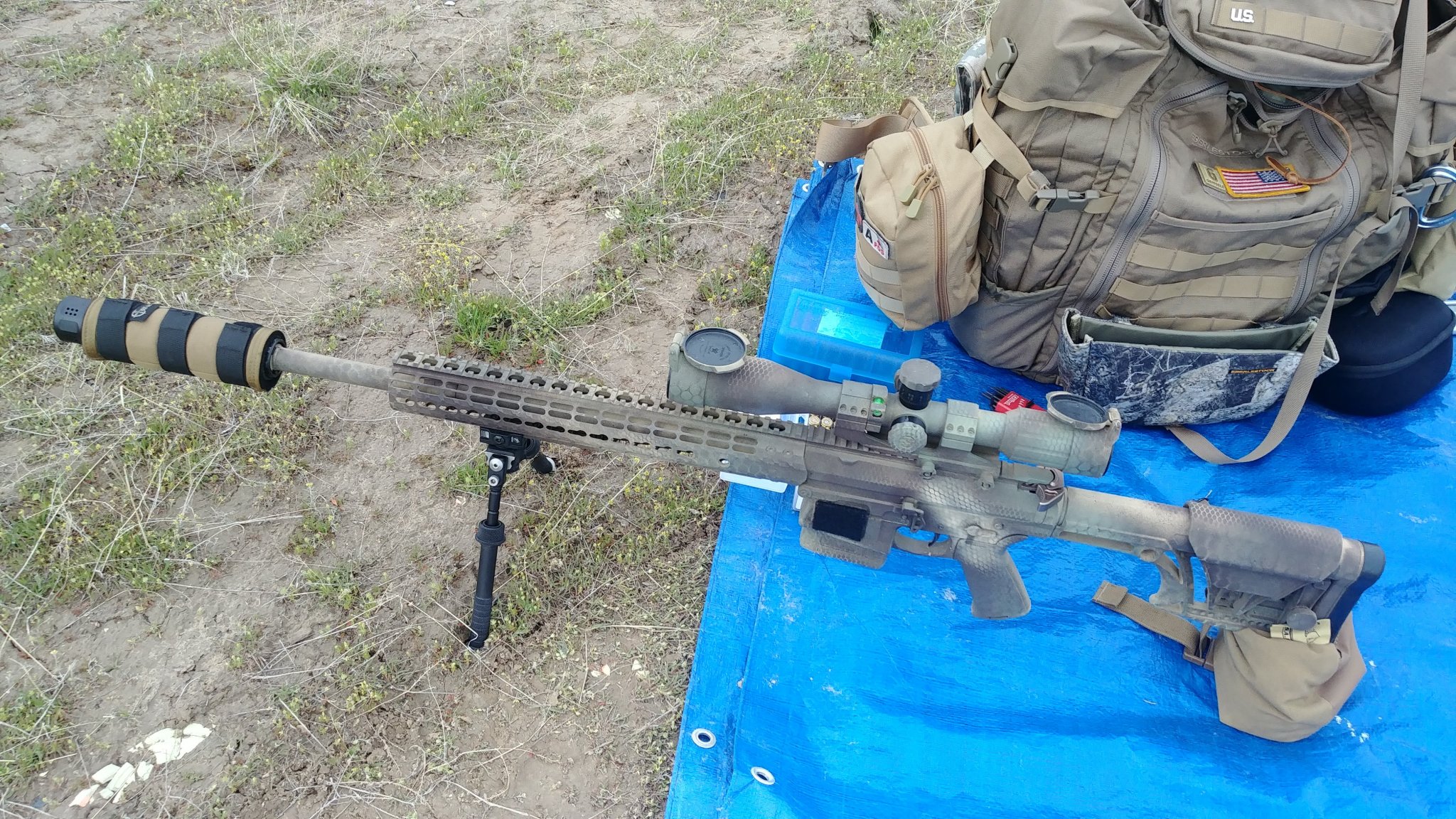

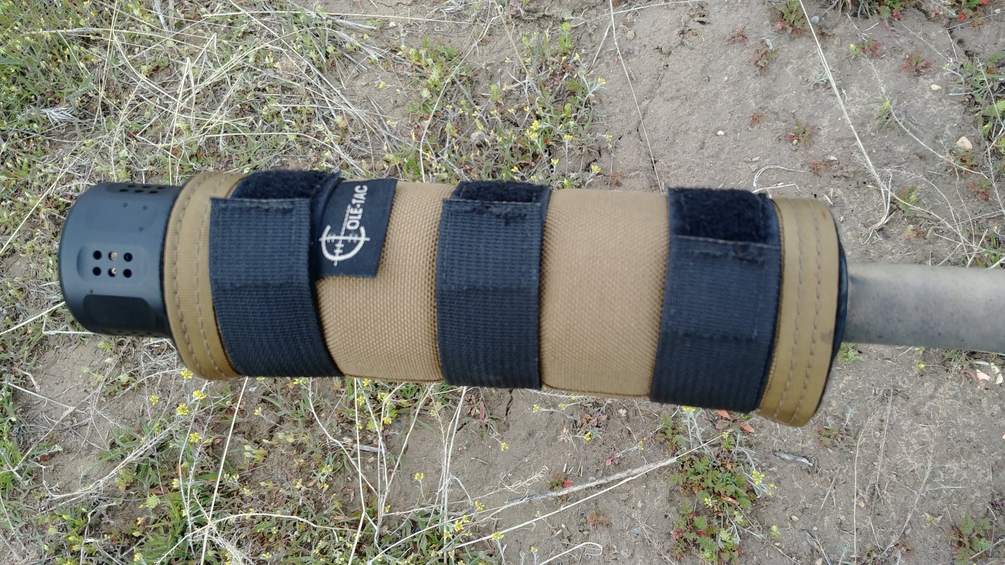

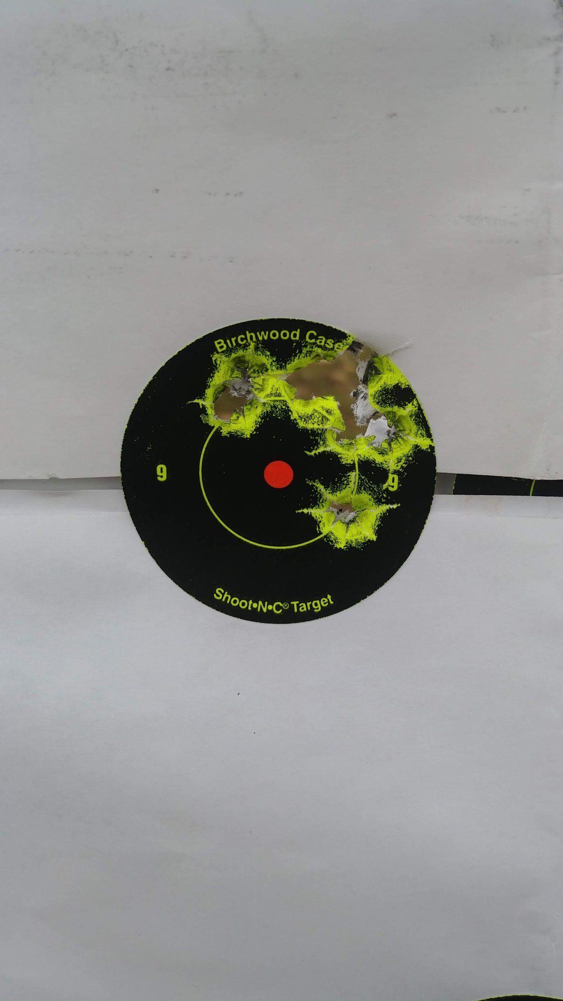

One last update. I received my Sandman S back from Dead Air after being repaired. I was able to take it out last night to test it with my .308 AR10 and .224 Grendel AR15. I'm happy to say everything is working as expected. The POI shift on the .308 was what I would expect, about .3 mils down, and it was about the same on the .224 Grendel. Both rifles shot great and now I can get back to tuning the handloads when shooting suppressed.

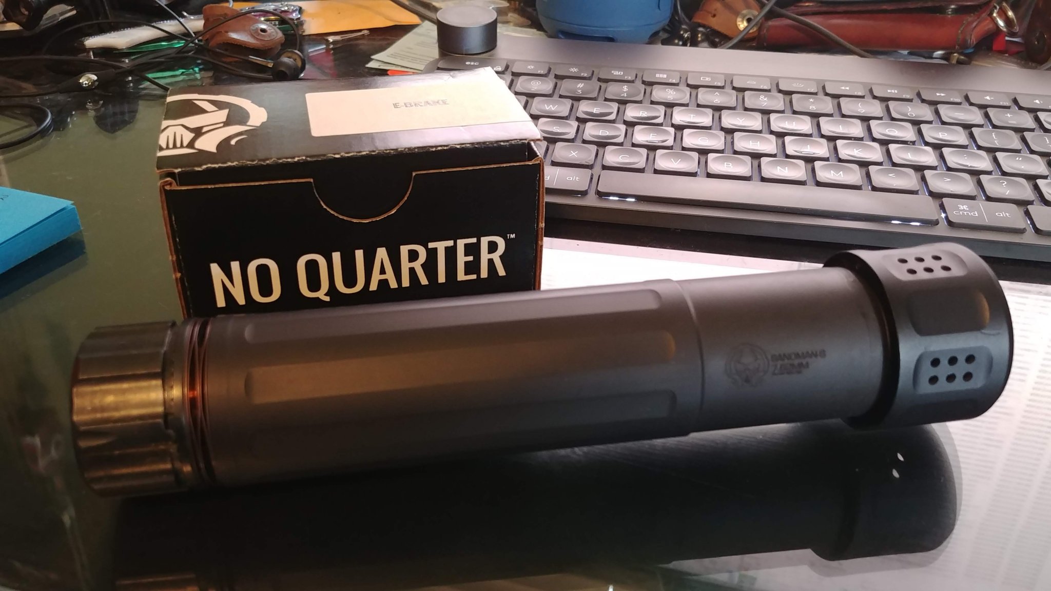

I'll also mention I added their E-Brake to the Sandman S and I'm very pleased w/ the recoil / muzzle flip reduction it provides. Going from an Area419 Hellfire brake on the .308 to just the Sandman was definitely an increase in felt recoil, but with the E-Brake, it's definitely better, but still not as good as just the Hellfire.
Thanks to Rodney and Mike at Dead Air for getting my Sandman S sorted out. Great guys and great customer support. I also ordered a Sandman K before their price increase took place at the beginning of April. It'll be fun to see how the two compare side by side.
The target is 8 shots with the .308 @ 100 yds, 3 w/ just the can and 5 with the E-Brake added.
