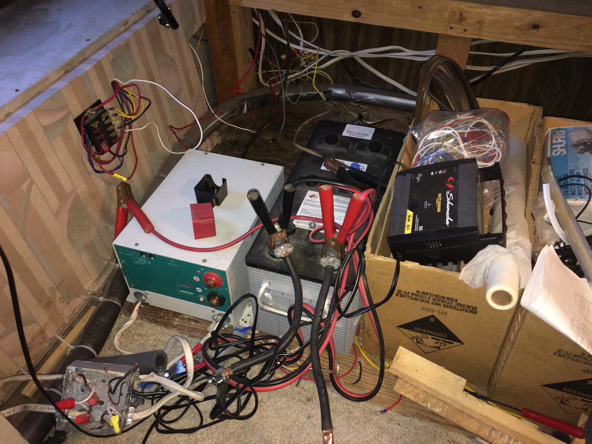

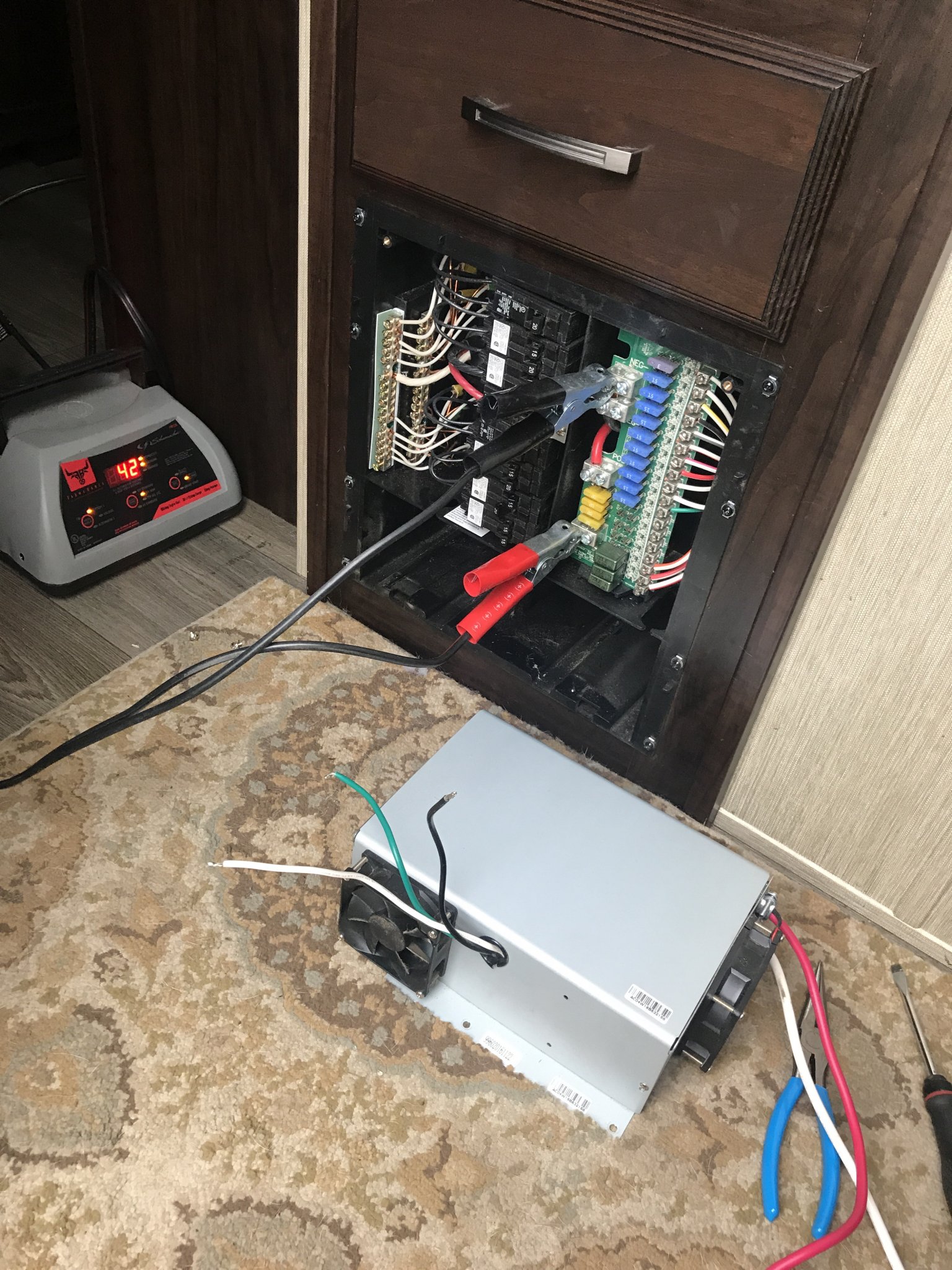

image.jpgYou fucking jinxed me!!! My converter took a crap today. Using a little battery charger until they get the new one shipped in

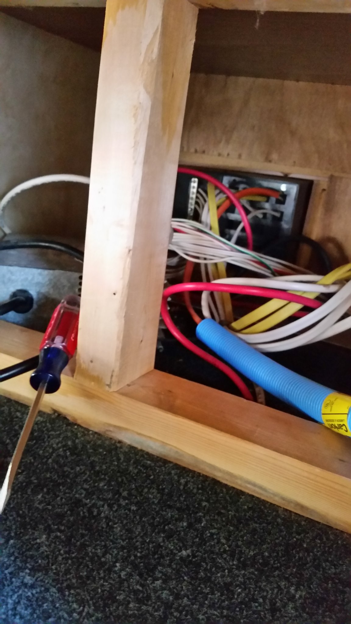

Geno, at least your wiring doesn't look like this. I'll be out of this place in 2 weeks... not complaining, at least I don't live in a big city any more.
