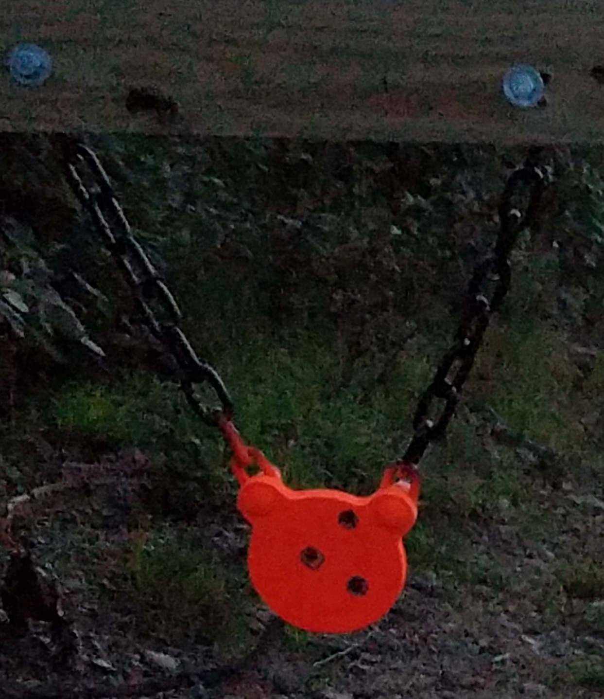

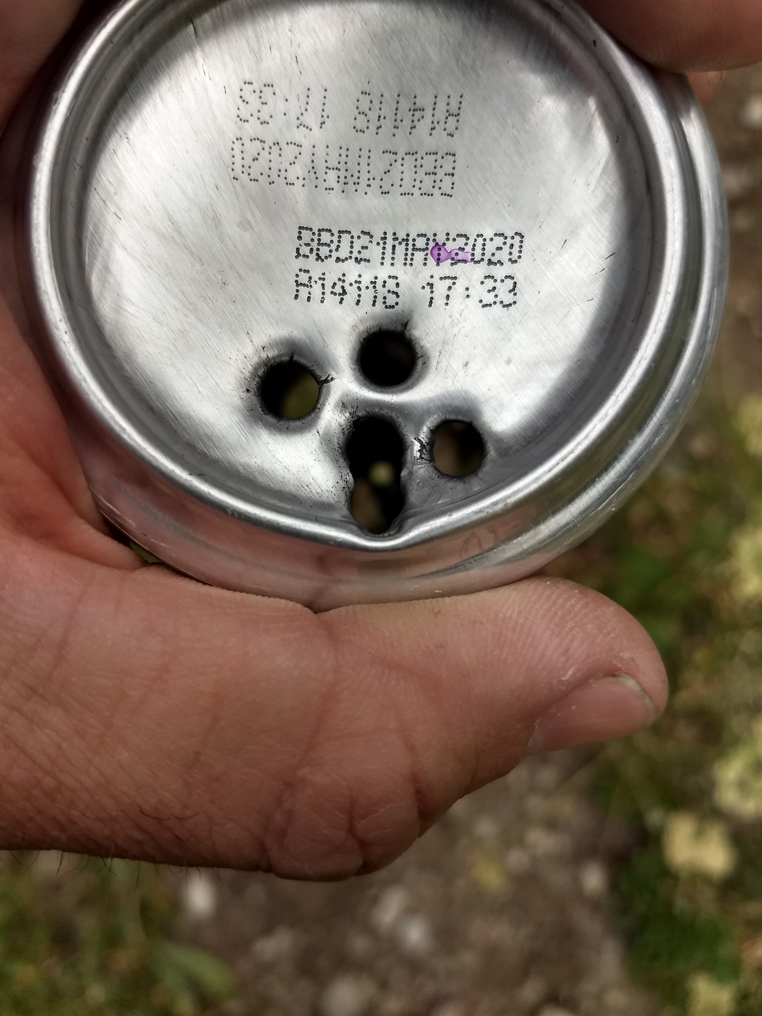

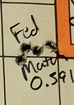

So far accuracy on my factory RPRR has been great with most all 50yd groups between .5- .6in. After zeroing at 100yds I shot this orange colored 4in plate @ 200yds with 3 shots about 2 1/4- 2 1/2in.
Here's some 50yd pics and the 200yd steel plate.
Bushnell Engage 4-16x44
Burris Extreme Rings
30 moa factory rail
Shot off sand bags
30 moa factory rail
Shot off sand bags

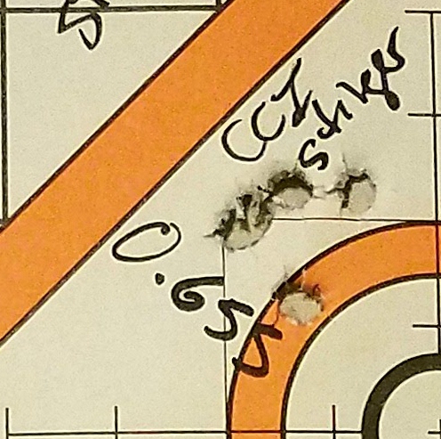

What are your thoughts on the cci stingers?.. reason i ask is that if you read through the manual it specifically states not to use "stinger" ammunition in this rifle.. not sure how much of a difference it makes.. but its there..
kgc54
Jun 5, 2018
59
25
24
Troy, MI
I wouldn't shoot stingers out on any barrel that is not chambered for them. The stinger's case is longer with a smaller bullit that allows it to be shot from a .22LR. The longer casing may damage the throat of the barrel. Additionally the 1 in 16 twist rifling is too fast; I'm sure that you would shoot the barrel out much quicker than if you use standard or HV rounds. That's why GM produces a barrel for the 10/22 chambered for specifically for stingers with a 1 in 9 twist rifling. That's my $.02 worth :)
Nice man thanks for the reply.. i didnt know about the longer case in the stingers.. makes complete sense.. is the problem the case dosent sit properly in the throat or does it protrude into the barrel itself?..
