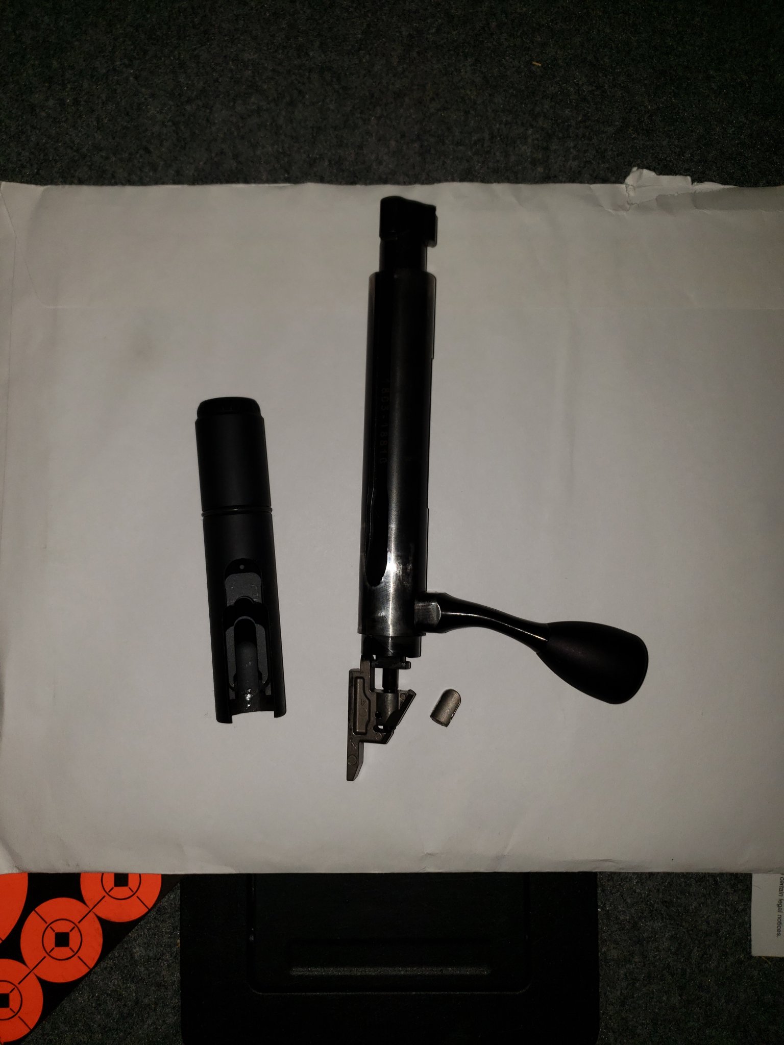

This happened Saturday in the middle of a match. Sending the whole rifle to ruger for warranty repair. 1100 rounds and 7 matches in....
Unfortunately that is a common issue with the RPR. Mine broke too. Anarchy Outdoors sells an aftermarket one now that is much stronger. Also, when I talked to Ruger I convinced them to let me only send them the bolt which was much more convenient. If you have aftermarket items on your rifle I have heard they will replace them with factory parts, which is why I convinced them to let me only send the bolt. It would probably be best to just order one from Anarchy Outdoors.
This is a much better option! Thanks for heads up man! I didn't even think to check them.
