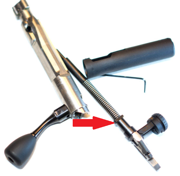

With 2700 rounds through my RPR 6.5-CM, I thought I should try to break down the bolt and give it a cleaning for the first time. :) I've had some light primer strikes out at the range recently. I thought maybe cleaning the bolt and firing pin might help.
I watched Ruger's video on Youtube. Easy enough. When I pivoted the plastic firing pin removal tool, the two tabs broke! On the very first use! That's pretty pathetic! So, I just ordered the titanium shroud and tool from Anarchy Outdoors. There goes another $100! LOL!
That blows! LRI sells one for $34.99. Everyone should just buy one now lol

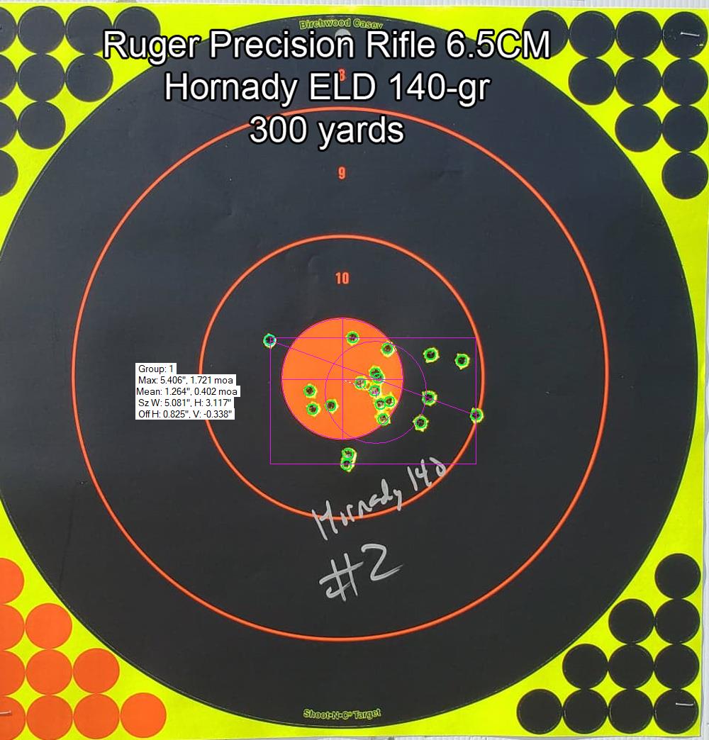

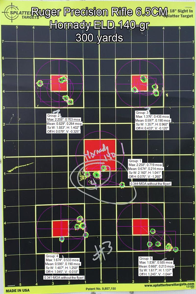

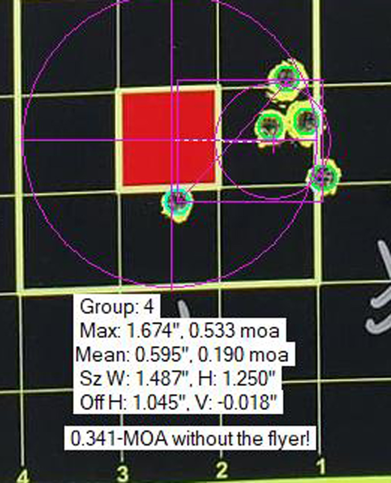

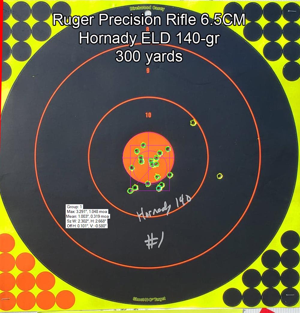

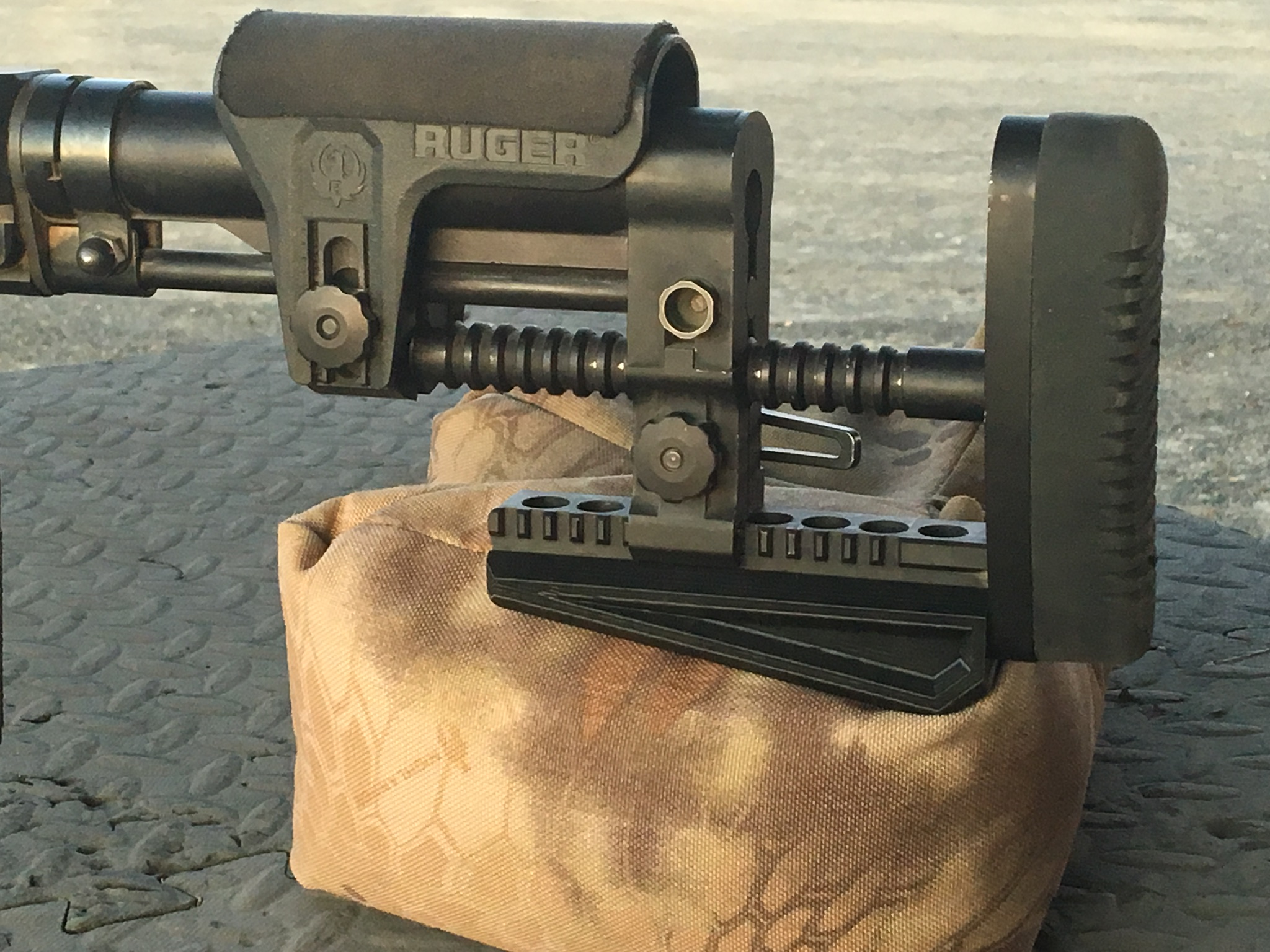

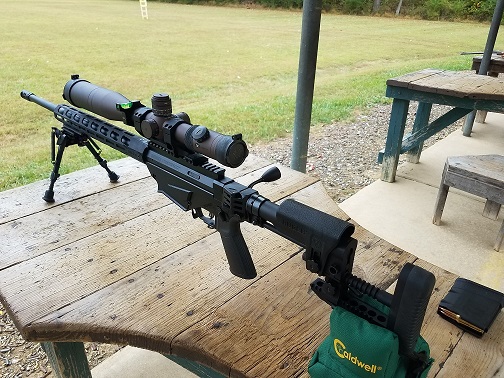

@REL1203 Is that how you have the rifle set to actually shoot? I Got a RPR 6.5GenIII for my son and he says that he needs the stock set just about at the limits, like yours is. It seems waaay long to me, but he is 6"1' and I'm 5" Worked it out to 550yards and are pretty happy with the accuracy.
RPRIII with Hornday 6.5CM 147gr (20 shots)
I was surprised that the 140s weren't faster.
I am 6'5 so yeah, it feels best when its maxed out like that for me. I will update you if you like once I get to shoot her this friday finally. I am generally a Benchrest shooter (not a prone shooter), so longer works for me. I am still not 100% sold on this stock though, I have a spare Magpul PRS that might find its home on this one next month if things dont go well.
The factory stock works well for me. Especially since I don’t really adjust it much. I guess a little more weight would be nice. The only thing I don’t like about it is how many smaller pieces it’s actually made up from. This part has come loose. That part has come loose. I’ve ended up blue loctiting the whole thing.
cgobeli
Apr 6, 2018
28
7
6
I haven't had any real issue with the factory stock. I really like how I can fit it to me and shrink it down so my 7 year old can shoot it. Its not the best looking stock, but it is very adjustable.

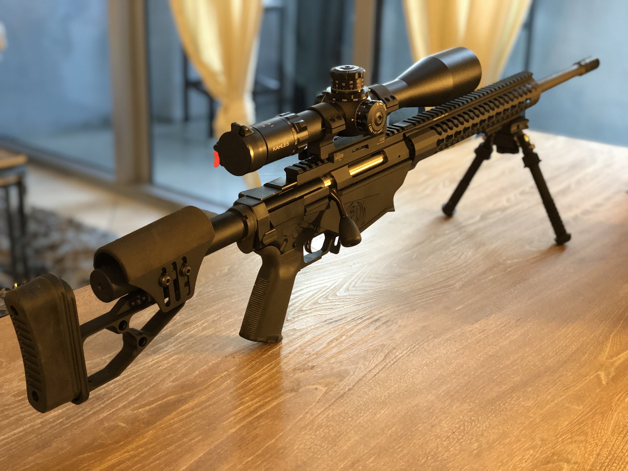

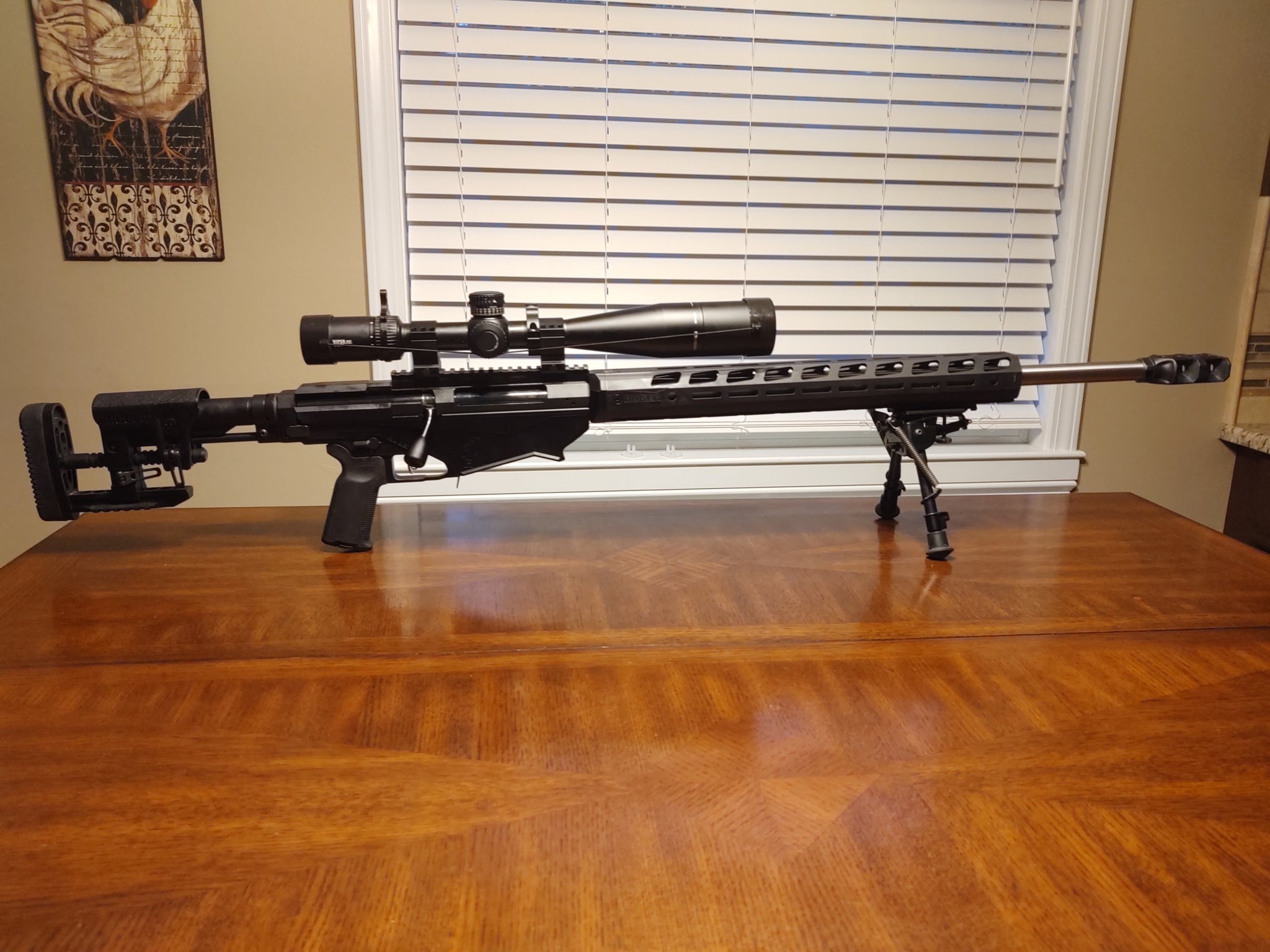

I am looking at changing the Buttstock on the RPR to the XLR industries Tactical stock. Aside from the stock what else do i need to purchase to swap it out? Also will the folding mechanism stay in place?
Thanks!
LongRangeLefty
Shoots heavy loads..
Belligerents
Feb 13, 2017
783
289
69
Thanks!
XLR will provide you with everything you need and since the buffer tube threads into the RPR’s folding mechanism, the ability to fold will remain in tact. I had an XLR stock on an AR15 and they are the bomb

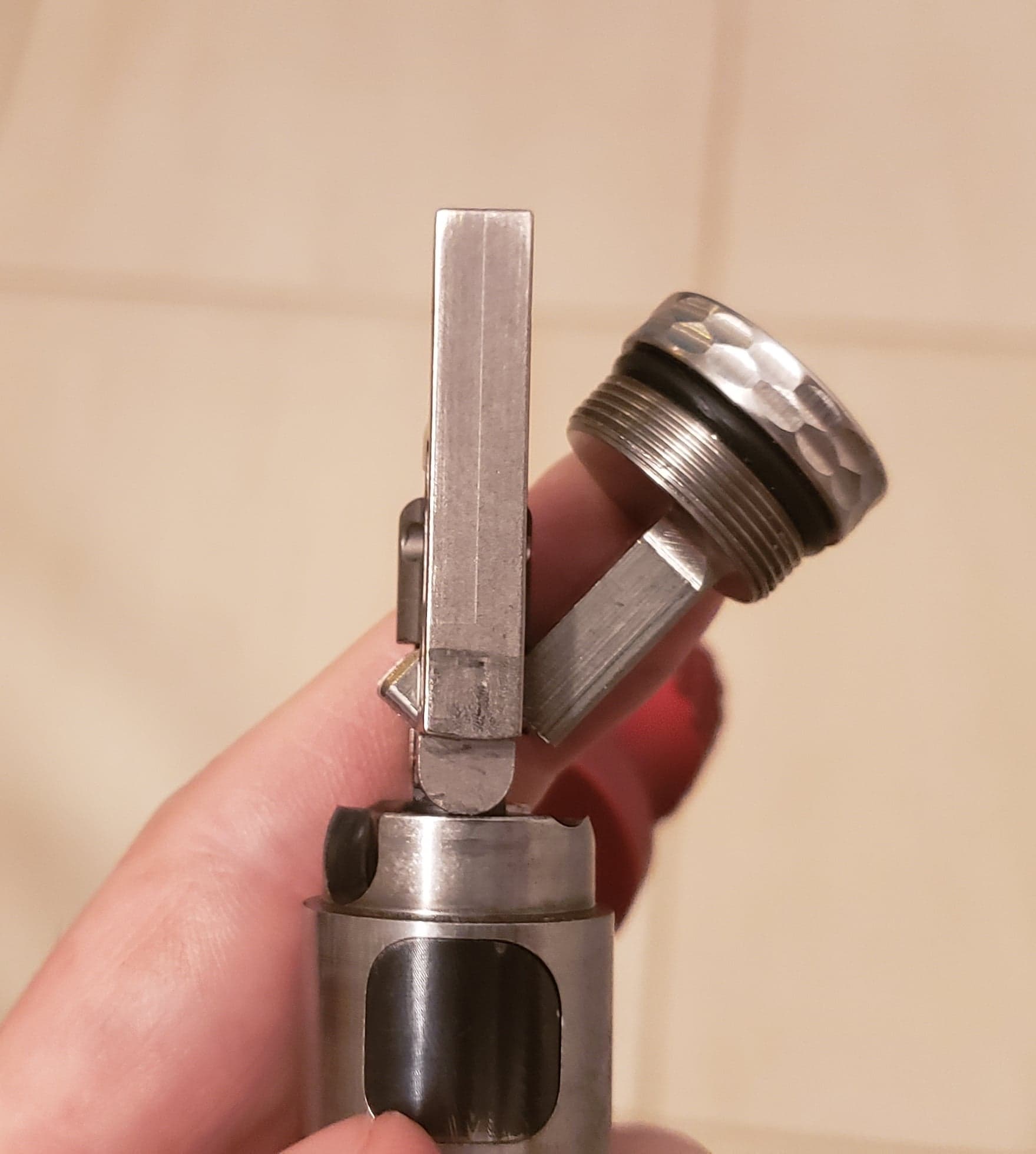

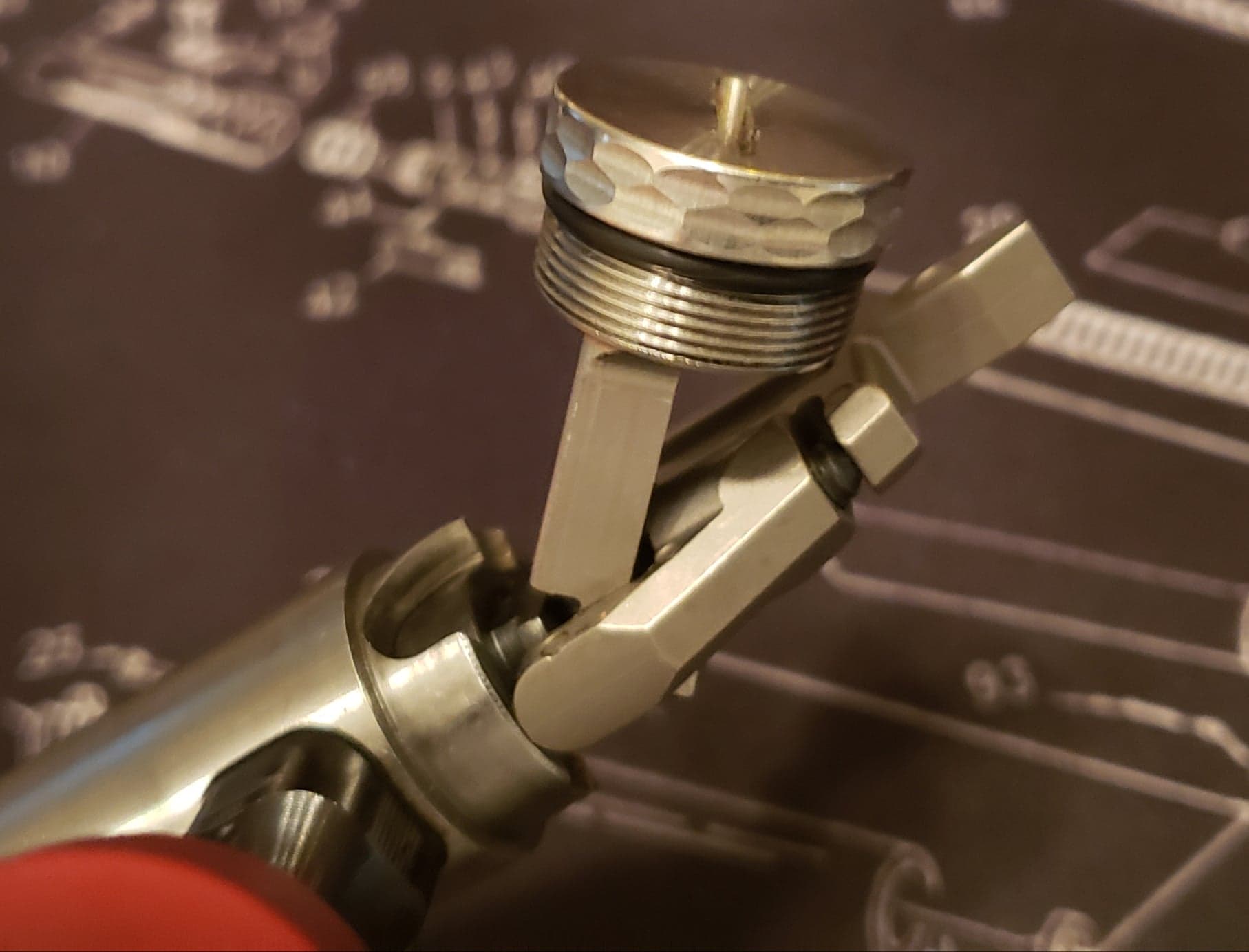

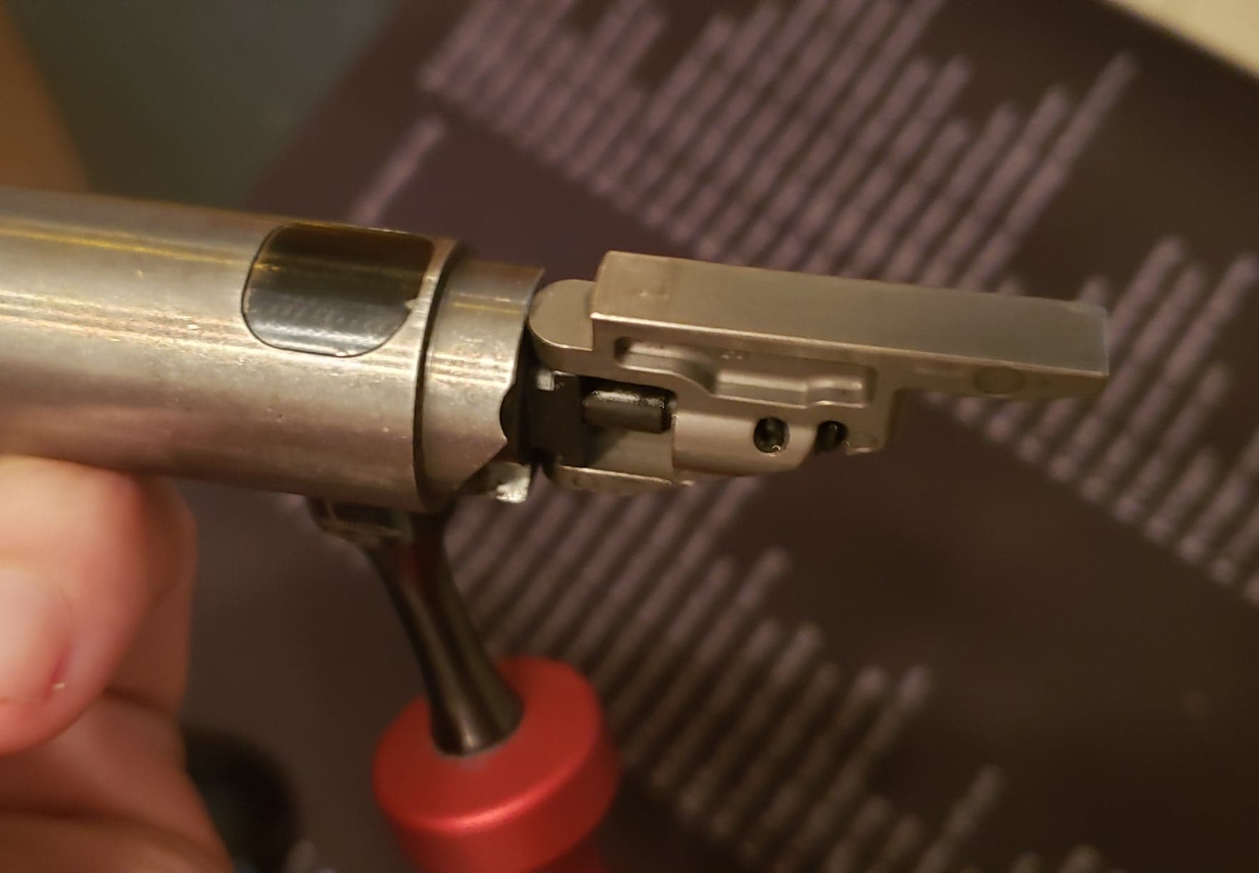

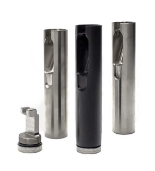

Following up to my RPR bolt tool breaking on me while trying to disassemble my bolt.
I got my titanium bolt shroud and bolt tool from Anarchy. It's a nice bit of kit.
But, now I know why the plastic tool broke. My bolt WILL NOT come apart. Even with the titanium tool. I insert it, and I can pivot the tool about 45-degrees, and THAT'S IT. It will not swing around to 90-degrees. Will. Not. I've tried and tried, using a fairly significant amount of force.
WTF is the problem??
Bolt rotated and aligned
This is as far as I can pivot the tool. I can put all my weight on it, and it will not budge any further.
Another view of the tool in place. It will not go past this position. It will not pivot to 90 degrees.
I've tried inserting the tool from both sides... It will not budge past 45-degrees. I've already suffered injuries from trying so hard to make this thing work!
In every video I've seen, the tool pivots EASILY. This is driving me crazy. I've tried inserting the tool from both sides. Same problem. I cannot get it to swing past 45-degrees. What is going on here? Thanks for any help! :)
Hello Racer88, I have the same Anarchy bolt shroud but had never used the take down tool until now. Slipped in and rotated just fine. From the photos it appears you might have inserted the tool too far and the tool is binding on the rear of the firing pin, that it is supposed to depress. Just a thought.

I don't believe it's the tool. It's the bolt or pin assembly. I tried using the OEM plastic tool, and it broke on the first try to pivot it into the slots.
In comparing mine to your pic, it appears it's different at the top of the bolt where the firing pin assembly makes contact with it. Now . . . mine is a Gen 2 RPR with over 5500 firings. I've not had any issues that you're having. But I don't know if this difference between yours and mine is the problem for you . . .???
What is different? Mine is also a Gen 2. Looks exactly the same to me, except mine has a "3" engraved, where yours has a "4."
The shadow on top makes it unclear, but it appears to me that that notched down part that is in contact with the bolt is lower than mine (the part just above the firing pin "T"). . . .??? The shadow appears to be level with where contact is made with the bolt???
straightshooter1

In this pic of your's, it definetly looks lower than mine as mine IS level with the bolt. Whether this is really related to your problem, I don't know. But it is a difference. Otherwise, there may be something inside the bolt that's binding. And I'd take it apart to see what it might be, even though it's a hassle getting back together.

^ With the rubber grips inserted, I put the pin in my vise and used a crescent wrench to compress the spring while I place the tool back in. Was pretty simple

I have a question for all of you out there that have an RPR but also have higher dollar custom guns. I am trying to figure out a way to ask this without sounding like an A-hole, but I am not having much luck.
When comparing an RPR against a custom or higher quality rifle, do you feel like it's missing out on anything other than fit and finish?
I like my RPR a lot, it has served me well, but I keep dreaming of something better. But if I spend a few thousand dollars on a new rifle, am I going to get that much more out of it, or is my vanity just getting the best of me?
I don't own any custom rifles, but I've shot many different ones at club matches, people that have them love to let you shoot them! I shoot my RPR in matches, and I love it. The biggest differences that I notice in the high end rifles is how smooth the actions are. It is definitely is a world of difference compared to mine. If I had the money to spare I probably would have one, but I'm very happy with my RPR though.

I have one of these in titanium and they will engrave whatever you want on them.
What I like about this model is the titanium (or aluminum) bolt disassembly tool which is so much more durable than the plastic one from Ruger.
View attachment 7128606View attachment 7128606
I got one of these and the fit to the bolt is awful. Called anarchy up and all they did is make excuses. Since mine was custom engraved by their engraver they wouldnt do anything about it(wont do business with them anymore)The aluminum tool is great but the shroud itself sounds like a rattle trap once installed. Go with an LRI and dont look back
If I'm not mistaken there are lugs on the bushing that holds the bolt handle in.
You need to rotate until the lugs on that bushing are aligned with the slots in the bolt handle.
Since you are doing this blind, you can only feel your way around, but if it is binding, you are clearly not in the right spot, just rotate the firing pin assembly a little one way or the other and try again.
From your pictures you look to be 90 degrees out of rotation.
I'm working from memory here, so please forgive me if this is not correct.

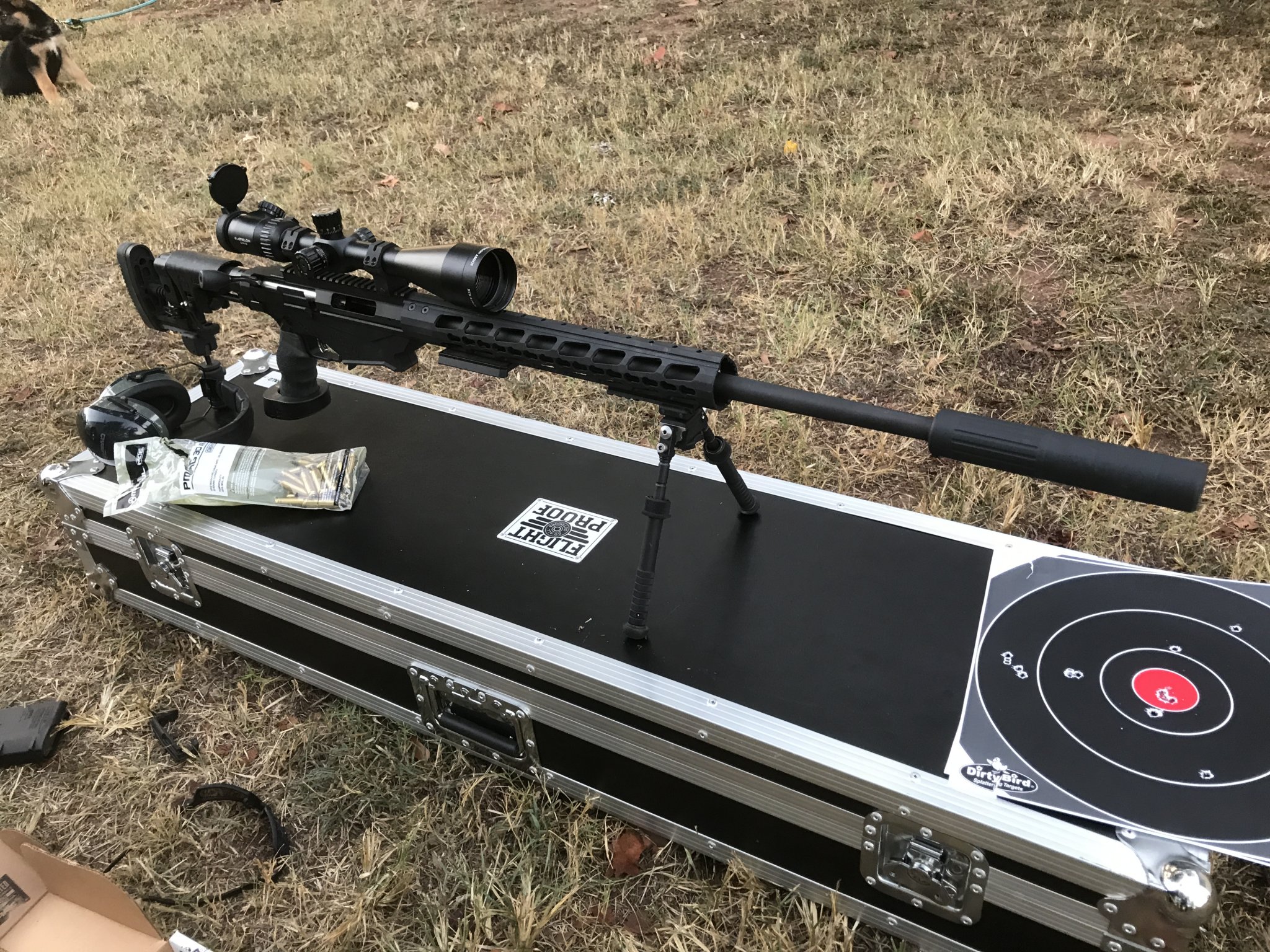

Finally got a chance to do a decent zero on my Gen II 6.5CM. Been working really long hours lately, so trigger time has been on the back burner except for just barrel break in shooting (also to generate reload brass). But this weekend, I finally made some time.
Can’t say how pleased I am with the results. I was shooting short range at about 80 yds paced. First group was bug eyes. Second group was same hole, and third group was bug eye and on target. (The flier you see was mine shooting an AR to confirm on paper for some one from a standing position.). Nothing done to the rifle in functionality, it’s factory stock. I attribute the bug eyes from poor shooting position/body mechanics
I am running an Athlon Argos, Atlas bipod, and Accushot monopod. Was firing factory 124gr hollow tip Winchester. The can is borrowed, but it’s an AAC 7.62 (love how it settles it down even more)
Can’t wait to get the reload gear together so I can tweak my loads even better.
I'll try again with that perspective. Thanks!
On another note... I've got over 2800 rounds through my original RPR 6.5CM barrel. Theoretically, it should be nearly "shot out." But, then I pulled this off this weekend at 300 yards. We had a wind from 5 - 15 mph from about 7 o'clock. Temp was about 90 degrees. Factory Hornady ELD-M 140-gr ammo.
1st target of the day. Minus the "sighters" on the right, I kept the other 18 shots within 1-MOA.
I ran another 20 rounds through a 2nd target. I screwed around with windage switching from holdover to dialing. So, screwing around opened up the group a bit.

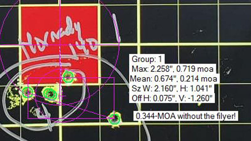

Then I switched to a gridded "precision" target. I was surprised that all five groups were sub-MOA. I had one honest-to-goodness sub-1/2-MOA group. And, two of the groups were about 1/3-MOA, if I subtracted the "flyers."
Close-up of Group 1 from that target.

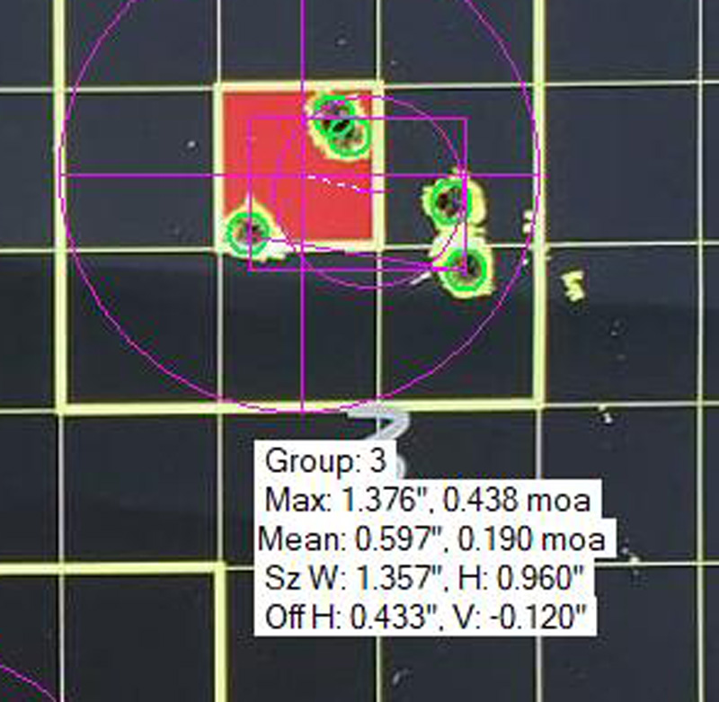

Close-up of Group 3... sub-1/2-MOA. No flyers! :)
Close-up of Group 4. Even with the "flyer," a nearly 1/2-MOA group!
It was a good day at the range... at least for me! Probably the best I've ever shot.

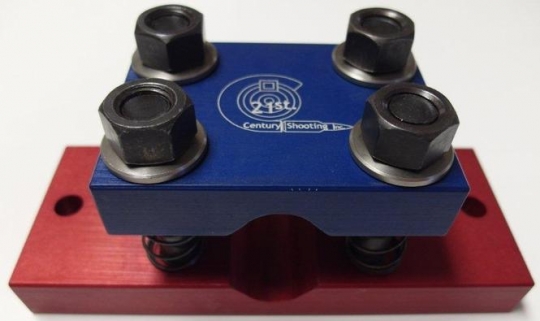

What is everyone using for a barrel vise to swap out the barrel? I was thinking about grabbing a Viper, but I heard they are not that good.
RPR300WM
Dec 20, 2018
42
23
12
