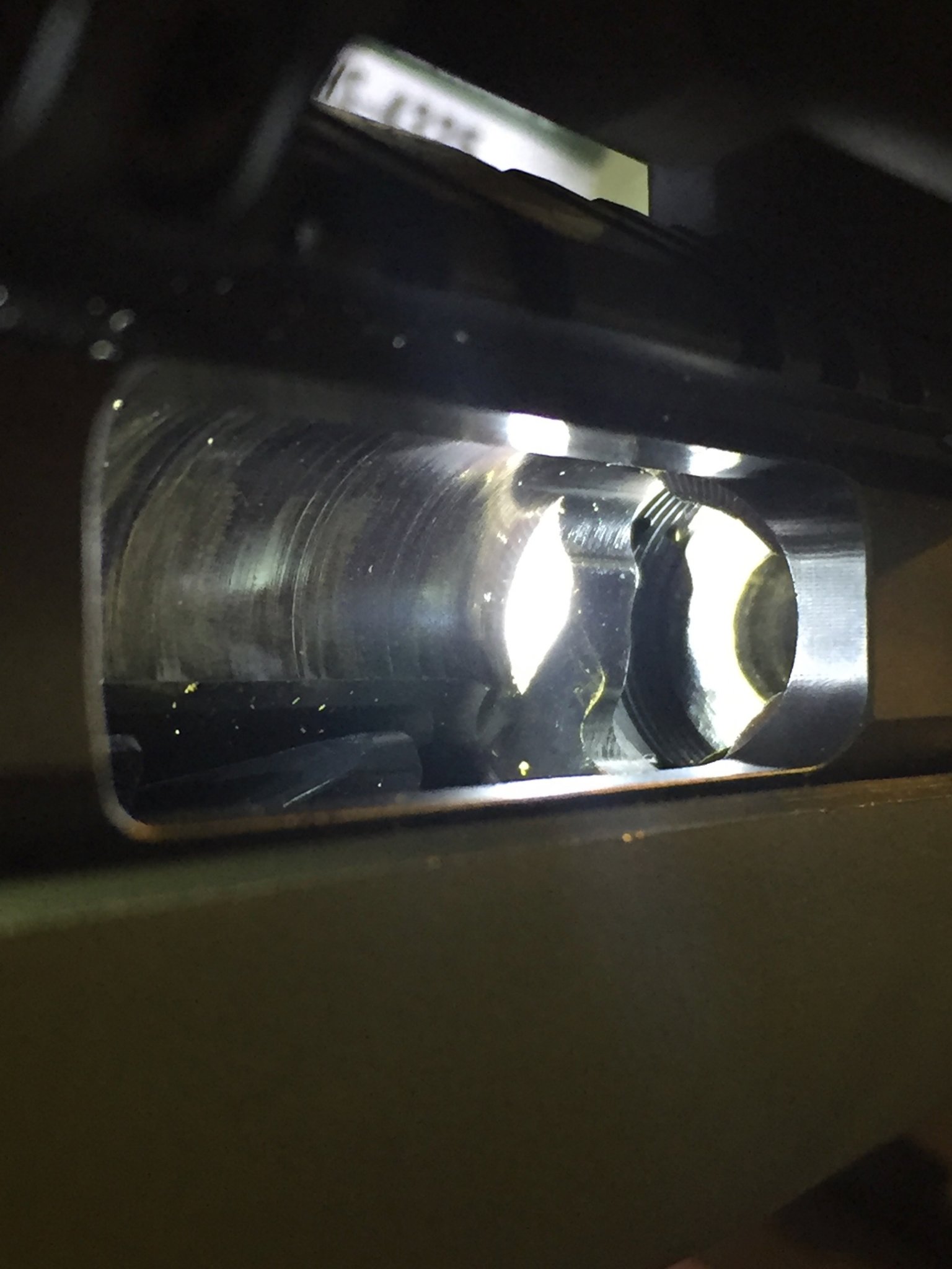

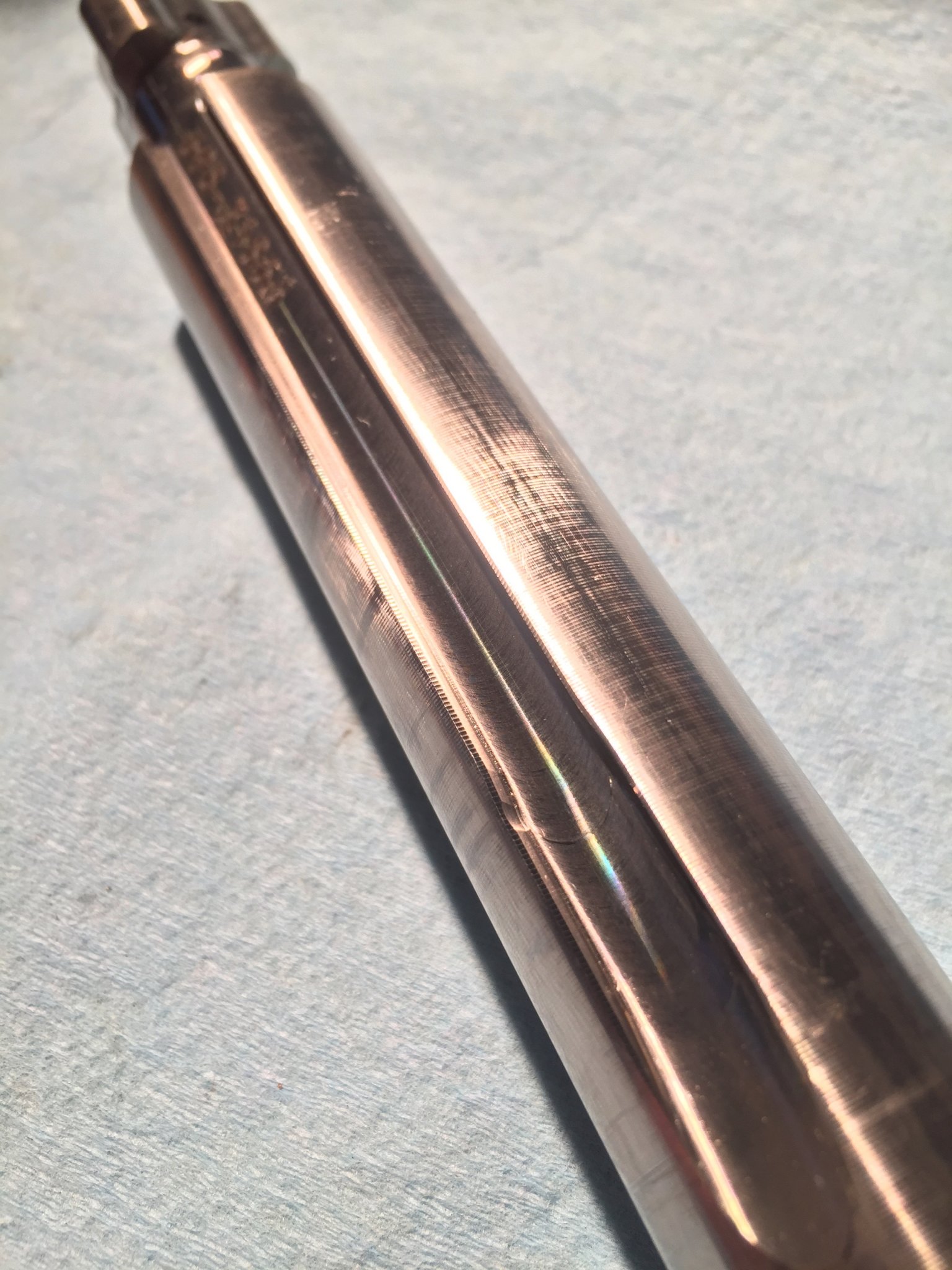

I took my new, and cleaned, RAP 6.5 creedmoor to the range yesterday for the fist time and experienced a handful of issues when cycling the bolt. First of which, with the bolt closed and the mag full, the bolt would get stuck when pulling back to put a round into the chamber, scaring the brass. To relieve the issue I usually had to slam the bolt back after pushing it forward again. Second, when chambering the round, it would not feed properly aligned 25% of the time, not allowing the bolt to close. Lastly, after firing one of the last of 40 rounds, the bolt jammed, not allowing me to cycle the fired round out. I was finally able to break it free with a substantial amount of force on the bolt.---My immediate thought was a headspace issue but after measuring the Hornady Black factory rounds, this was not the case. In addition the extractor would only work properly about 50-75% of the time. I have uploaded videos yo youtube trying to capture these issues the best I could (links below). Also I have a picture of the all the brass shavings in the chamber and a picture of the bolt included, there is a small divot where the tapper on the bolt groove begins to increase. Has anyone else experienced this issue? Do your all's bolts look the same? Any opinions about the issues? I plan on calling Ruger on Monday, but looking to see what everyone else thinks. Thanks.

I just had my Ruger American Predator 6.5 Creedmoor AI at the range yesterday and had a few feeding issues. I just looked at my rifle to see if the scope base or action screws were causing the problem. Mine were fine. Cycling the bolt I did notice that if I was applying pressure upward when moving the bolt forward it would hang. If I let the handle drop or had a slight downward pressure it would close fine. I think the problem lies with the upper clearance cuts for the bolt face. With the bolt held with upward pressure it runs into the edge of where those recesses are cut and the bolt stops.
I also had magazine feeding issues where I had to pull the bolt back slightly then the round would drop and align with the chamber and I could close the bolt on it. With the info I just discovered about the bolt hitting the edge of the top cutouts I tried chambering rounds out of magazine with no upward pressure on the bolt handle. To my surprise every round chambered just fine.

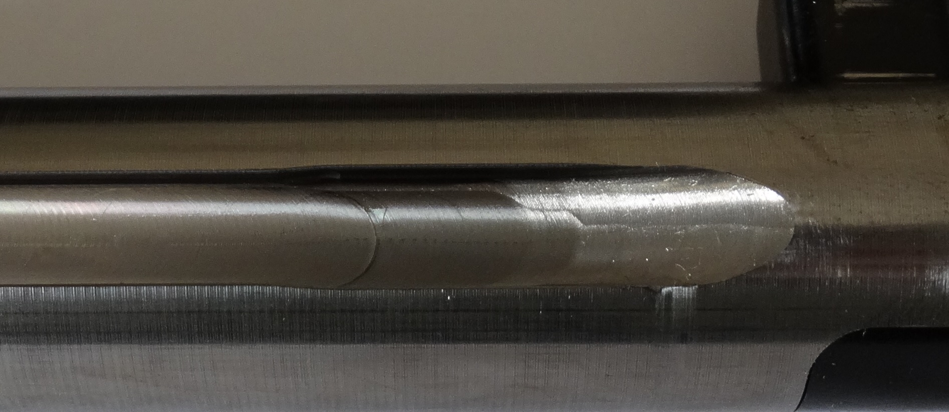

It may be hard to see in the photo but where the bolt release slot transitions the slot widens. Were you see a circular cut at the bottom of the slot just left of center, that slot lines up perfectly with the bolt lugs. The area to the right which is tapered is wider than the main slot. As the bolt is closing it runs fine along the main slot until it reaches this transition. When the bolt release moves into this area it lets the bolt handle and body move upward. In doing this it causes the bolt face to hit the edge of the bolt face recess cuts in the receiver and brings everything to an abrupt hault!

I followed up and taped a shim (about 0.010" including the double sided tape) in the recess closest to the bolt knob. When I cycled the bolt it no longer would jamb and closed fully without interference. I sent this information to Ruger so now waiting to hear back.
