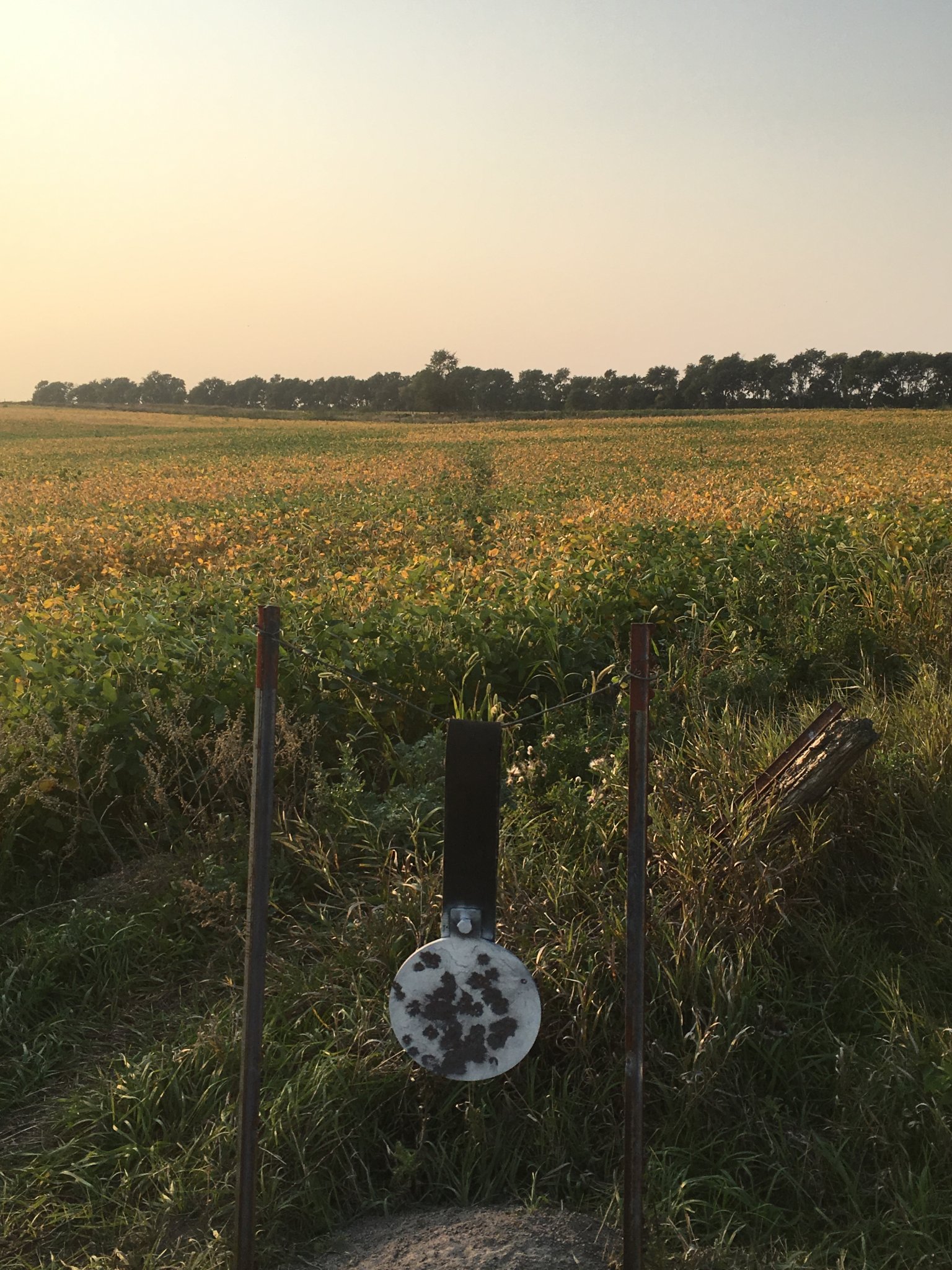

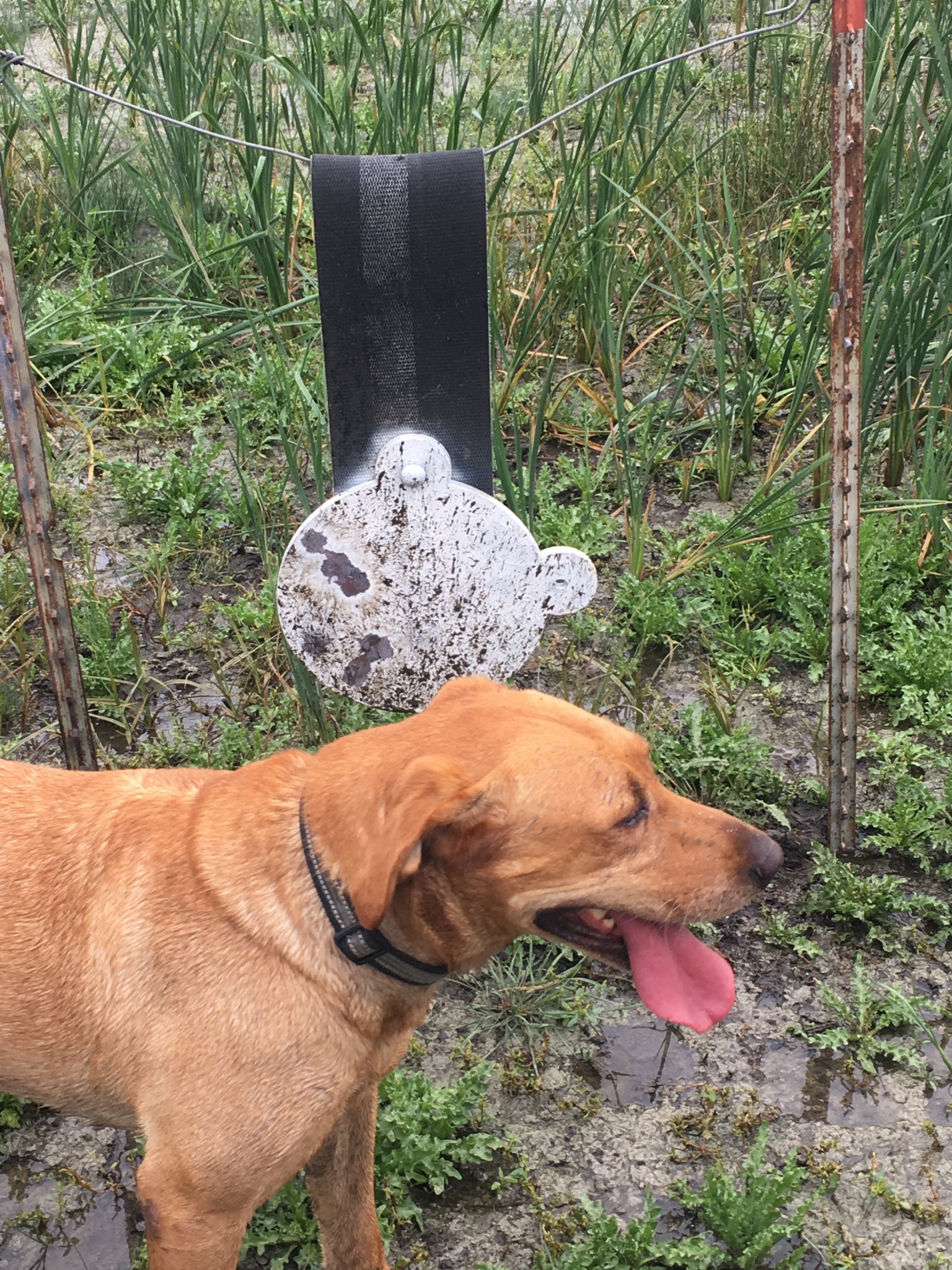

Two t posts with wire tied from one to the other. Then sling some baler belting over it. Sure if the wire takes a round it will snap but it’s a cheap easy fix. Go to any ag implement repair shop and they should be able to find you some old used baler belting for free.

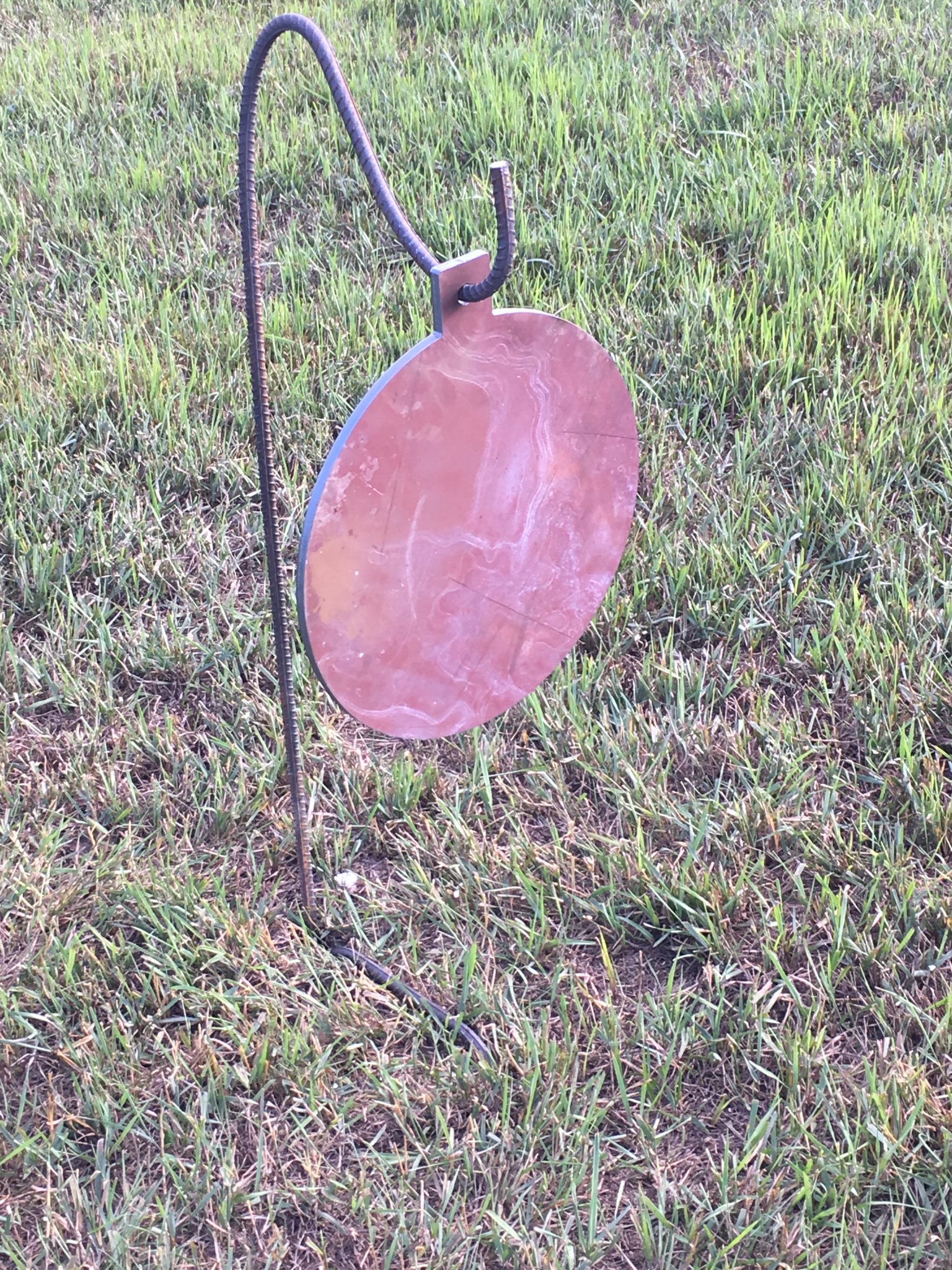

I’ve had really good luck with the Shepard’s hook rebar hangers. Easy to make and the rebar holds up to rifle rounds pretty good.
My local steel shop made the ar 500 plates for cheap. Way cheaper than I’ve seen them anywhere else. Just have to bring in your dimensions and they’ll water jet them for you

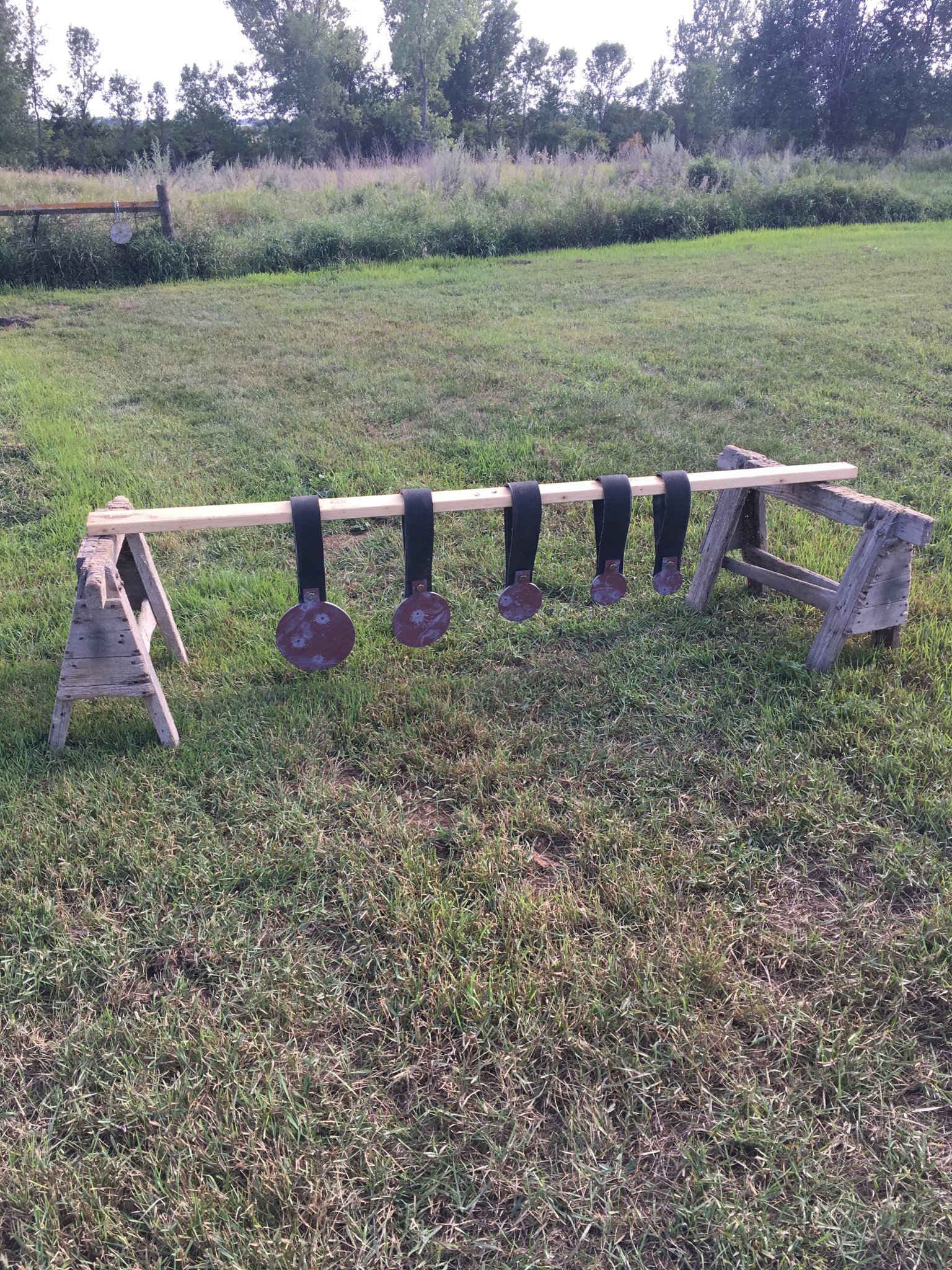

you know the rubber bumpers on loading docks? it's a bunch of rubber straps with two holes with a rod through them.
My buddy was able to get about 100 of the the individual straps from his work. they make FANTASTIC target hanging straps. they hold up to impacts and already holes in them for hanging. the wooden saw horse lasted us a few months. then only took <$20 to rebuild. depends how many stray bullets it takes. We use a 12x20 plate at 1,000 yards. we also shoot off the ground because the terrain allows for it. Let know if you want a handful of straps, I'll send you some. we have a ton

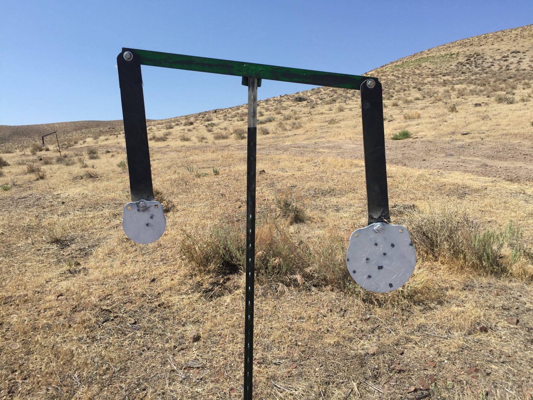

Renewing the thread: has anyone made a DIY swinger spinner target? Idea is pretty simple (steel plate, rubber strap, rebar/similar across the top), but is there an ideal distance/size/strap length/weight? Basically trying to make sure I don't make it too far/long/heavy to swing.

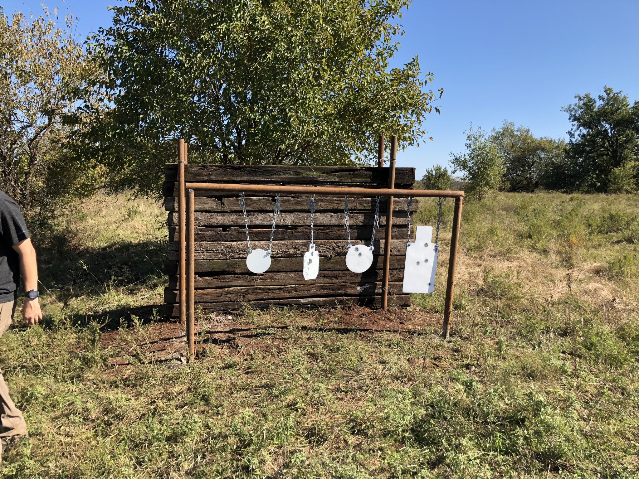

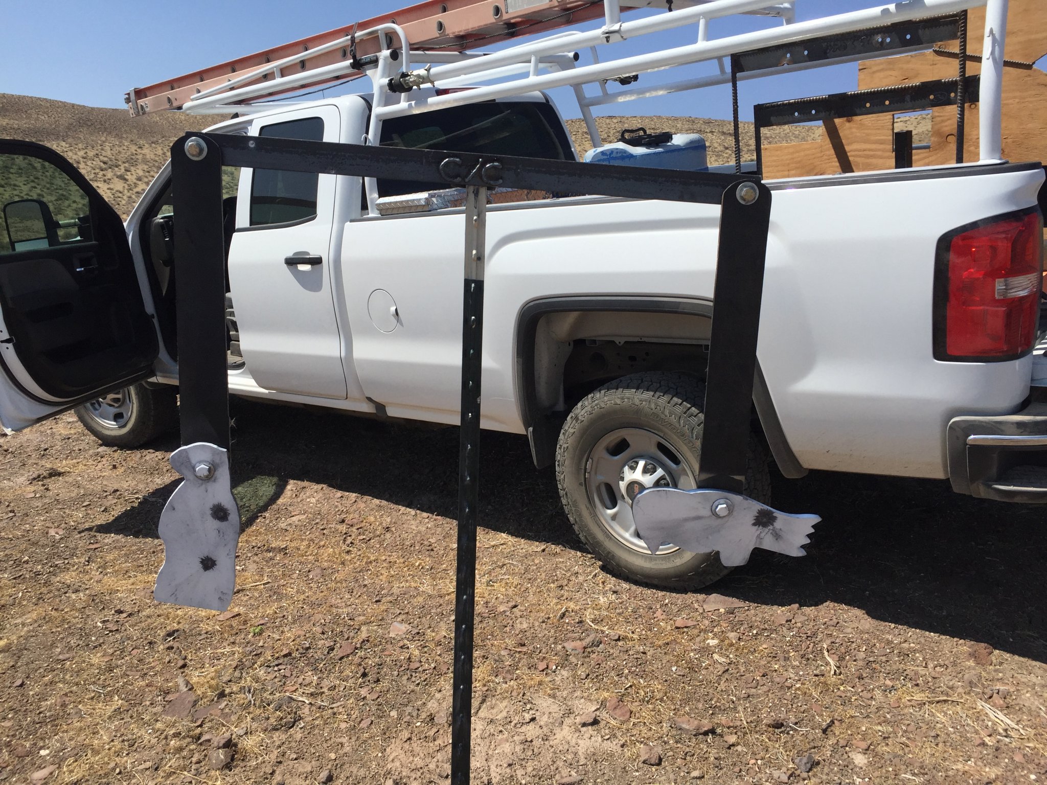

We make our targets and hangers separate. For hangers we use 1/2” rebar, then 5/16” chain and 1/2” bolts on the plates and it’s all removable and so you can move the plates between the different hangers. Just weld about 6” piece of rebar straight up off the hanger and it will never fall off

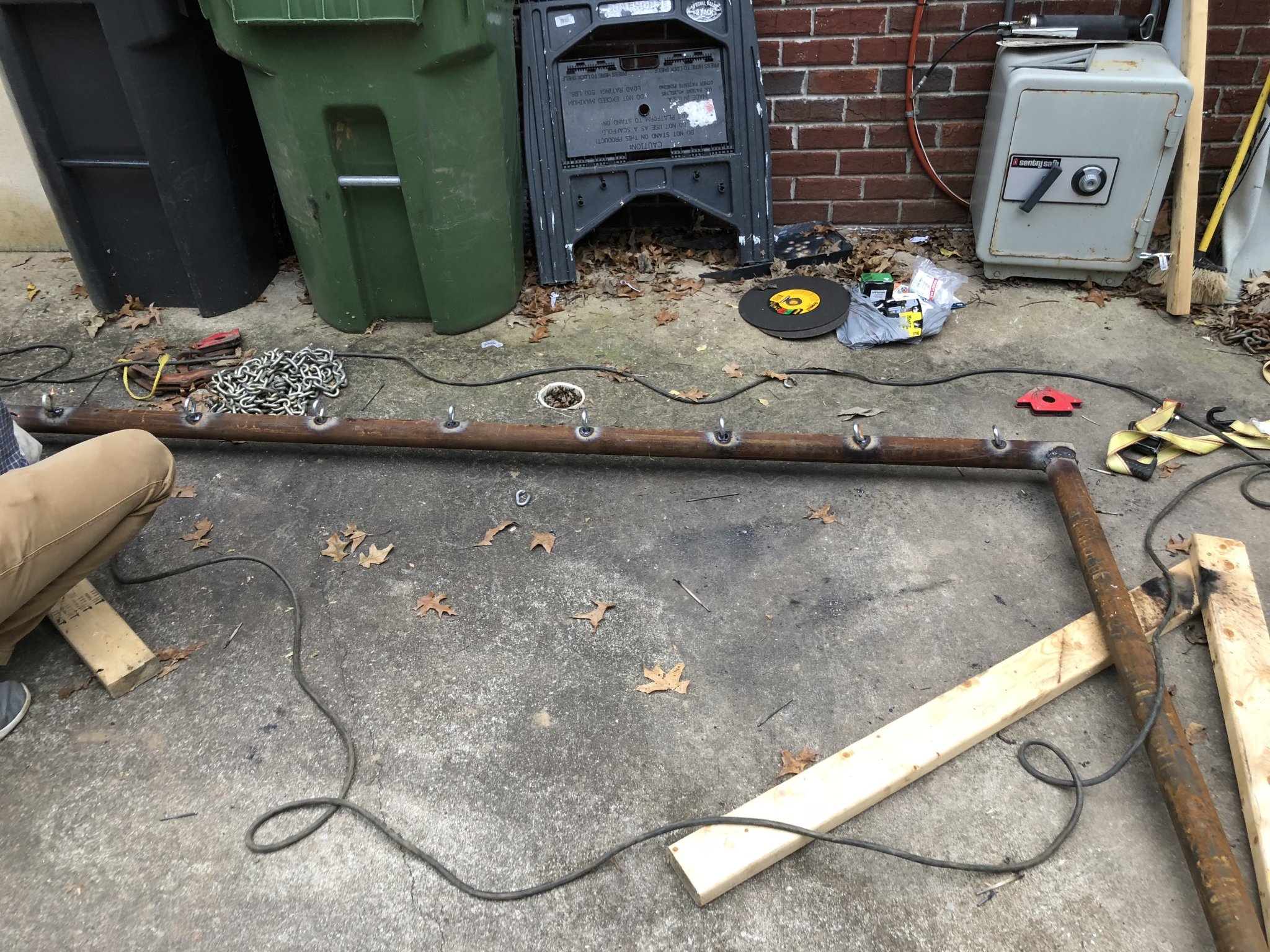

I made a more permanent solution for hanging steel targets. 2-3/8” used steel pipe welded together and i-bolts put through the top bar. Dig a hole about 1.5-2’ down and filled with concrete.

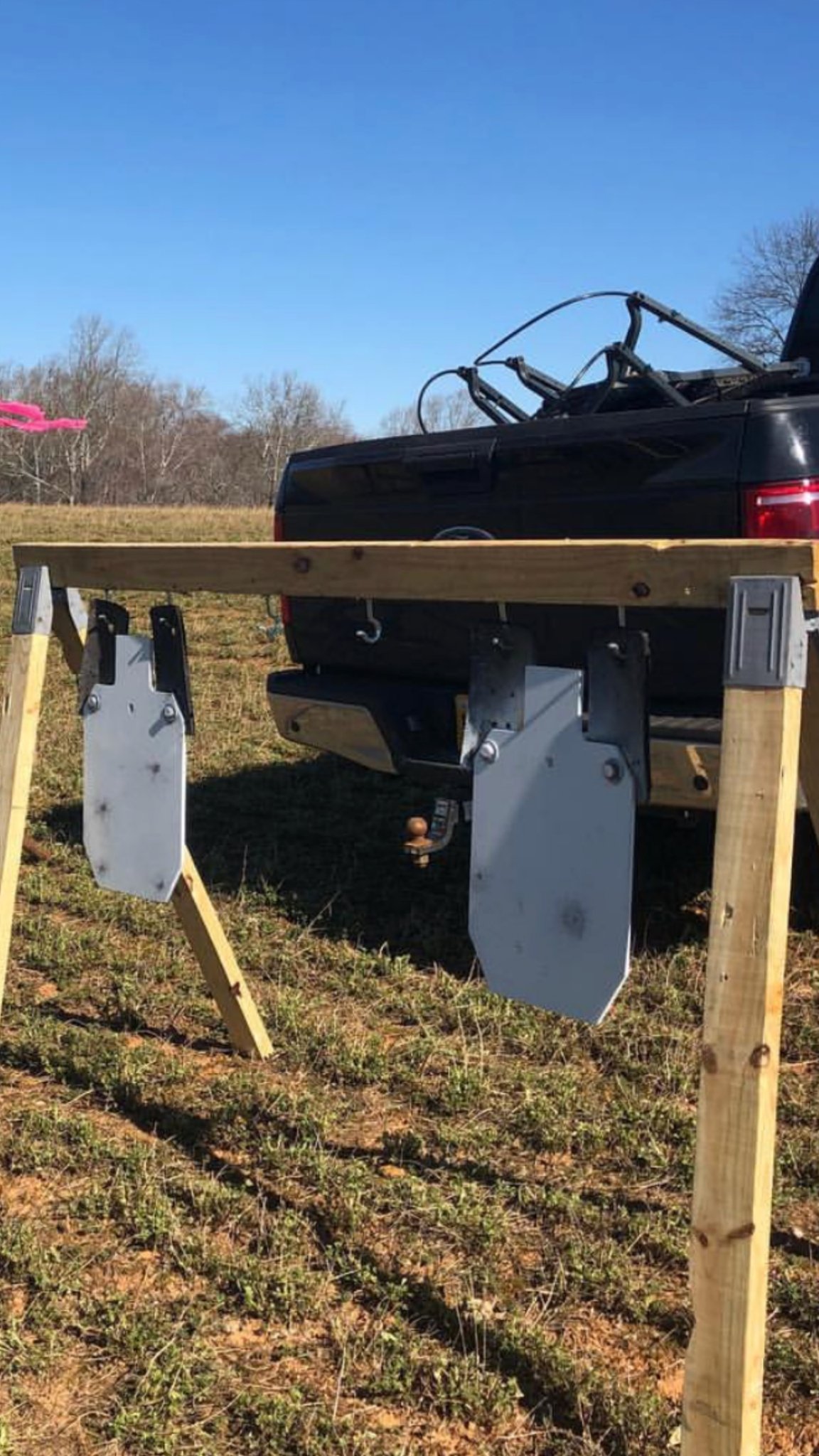

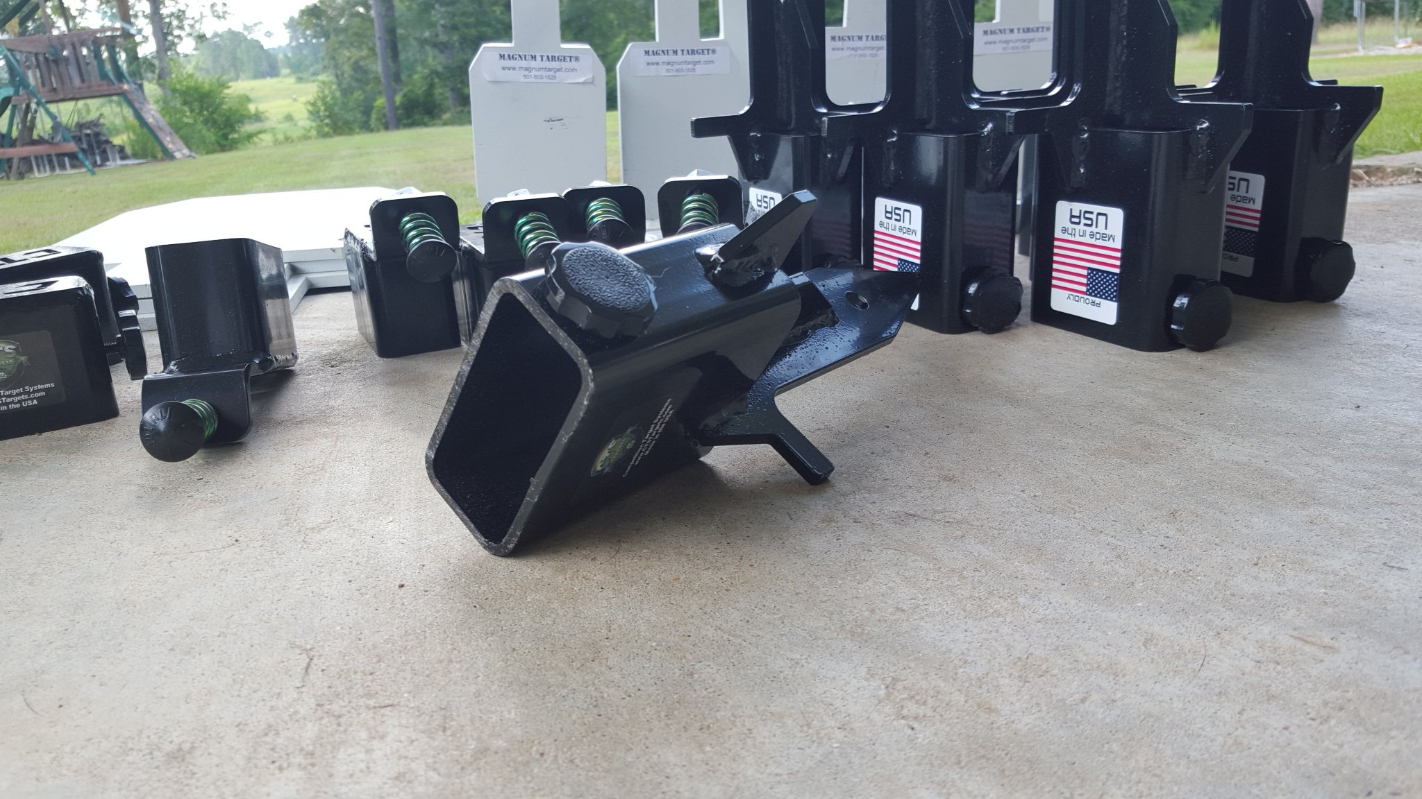

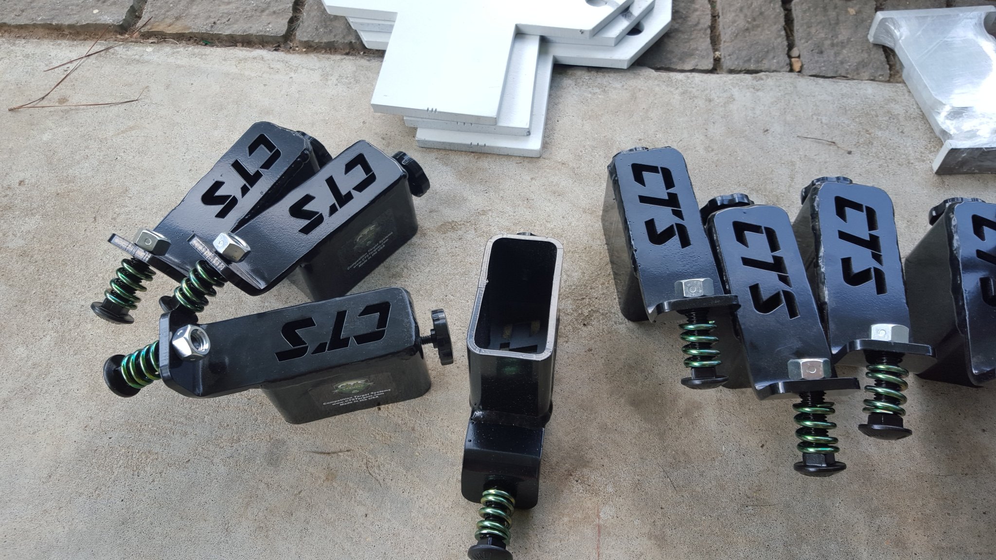

I have a 1500yd range and use these for my silhouettes. I use AR500 out to 800 then mild steel from there to 1500. The mounts are for 2x4 posts and I got them on Amazon.
70655847065588

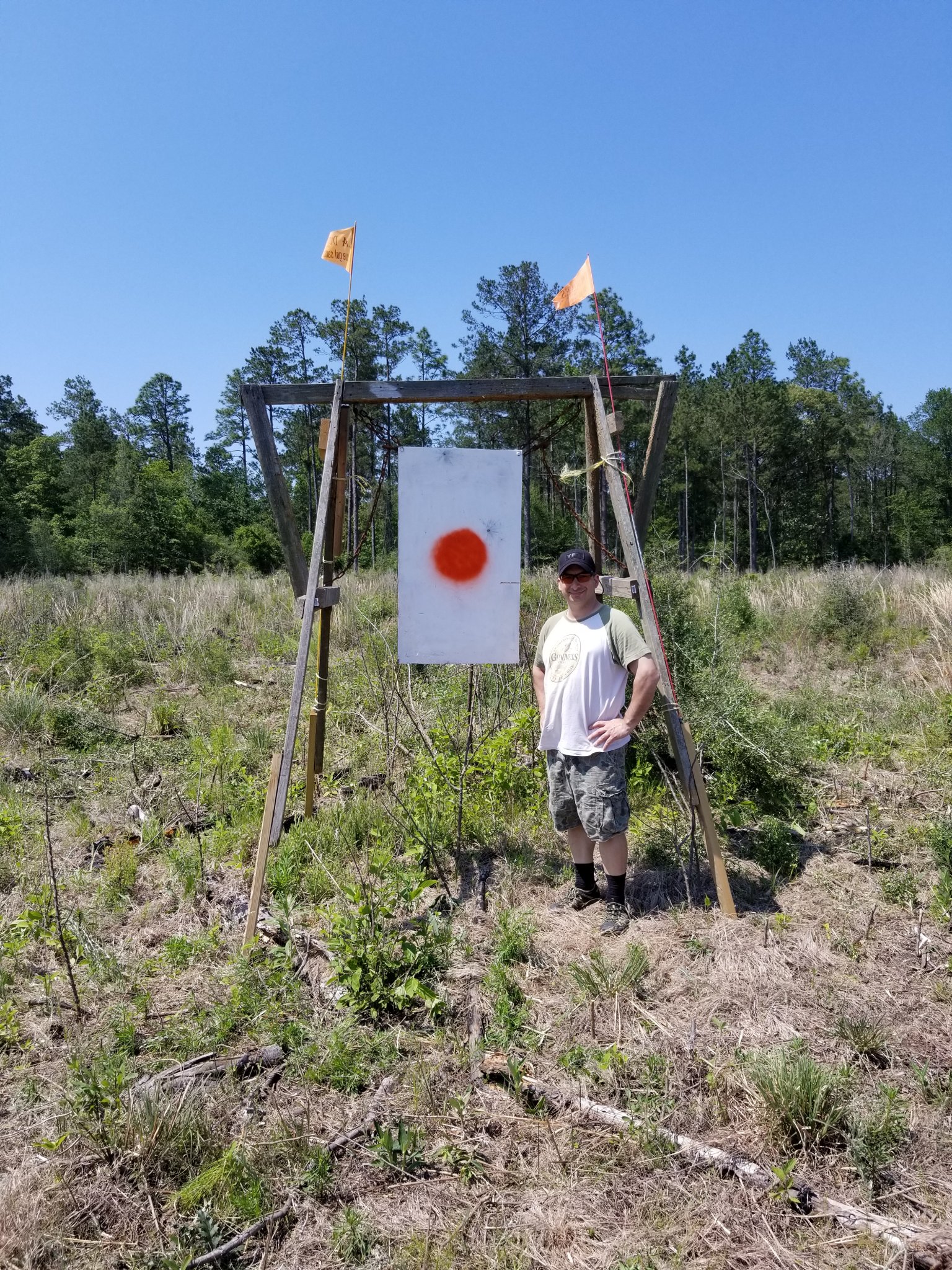

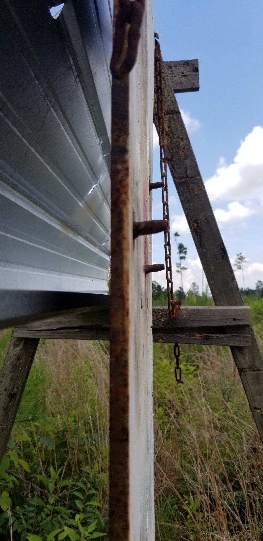

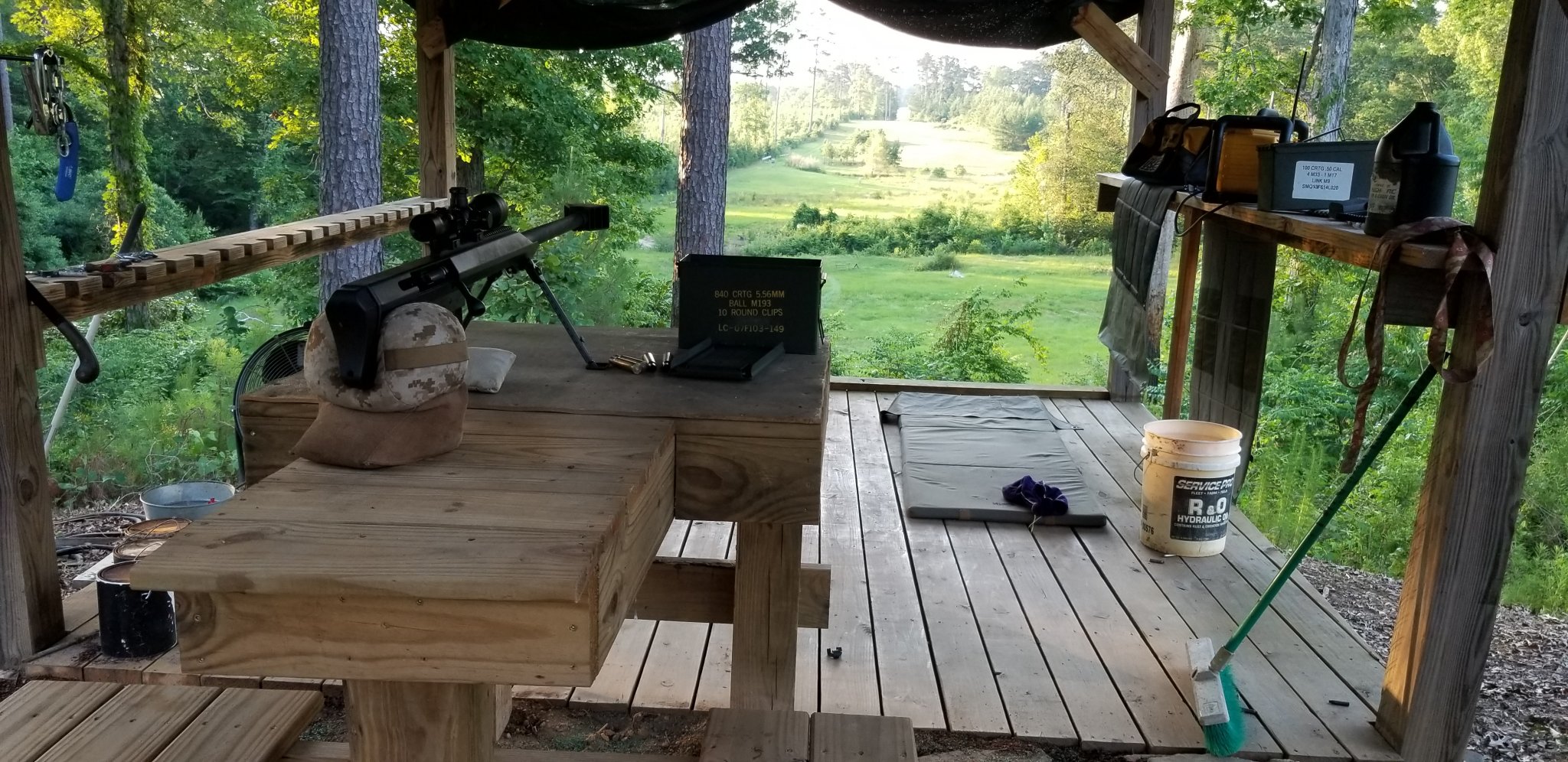

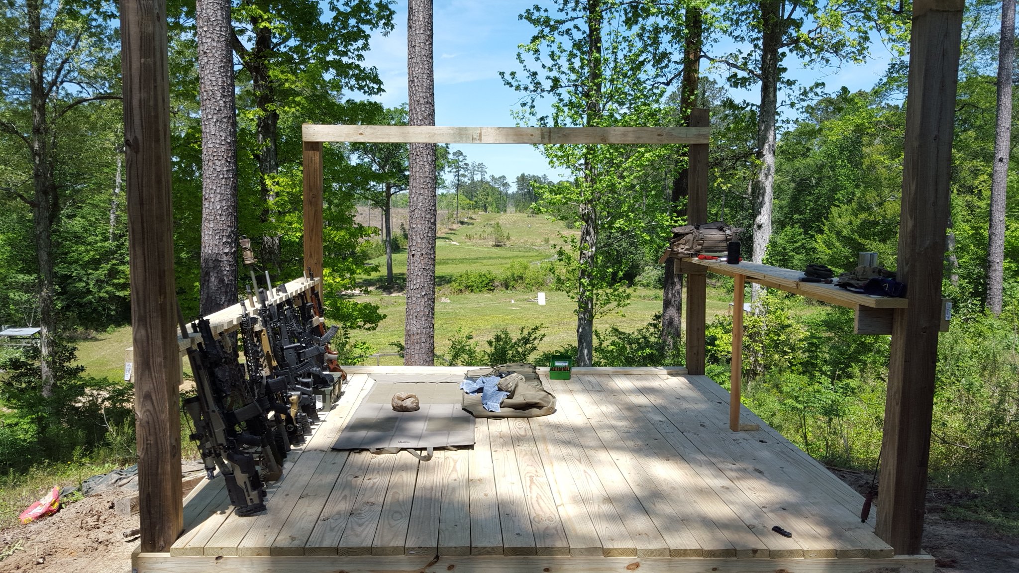

I built a shooting deck also
7065596706560870656257065629
Dialing in the 300wm at 1500 is a challenge. But the 50BMG punishes at this distance. Those projectiles sticking out of the 1/2" plate are Armor Piercing Incendiary Tracers. (APIT)

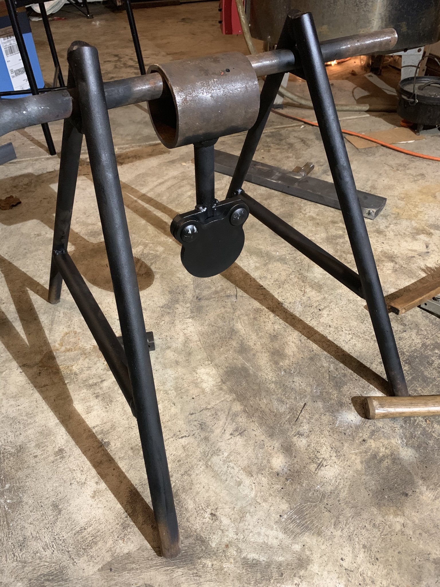

I use sucker rod and oilfield pipe.
7065635

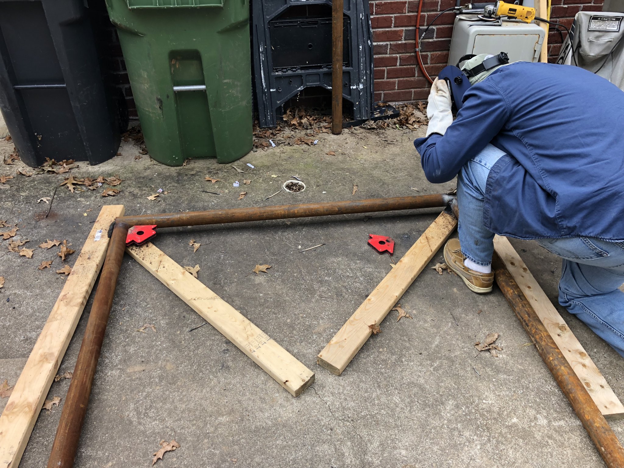

4140 takes a beating. The pipe is schedule something, I use it for making vise stands and anvil stands and whatnot. Lay in 3 or 4 root passes then a hot cap over. Flux core, it does the job.
The attachment method relies on one centrally located hole on the plates/silhouettes, I didn’t have them on hand to measure for wider mounting but a single hole and some carriage bolts will do the trick, if it doesn’t it’ll get made again.
7065636
Sucker rod is cheap. Didn’t have time to make the hangers when we shot it in the following pics, but the leather and paracord don’t last very long.
7065638
Really cool seeing all the other permanent setups, thanks for posting. These ones are portable, we packed them in about a mile and a half.
