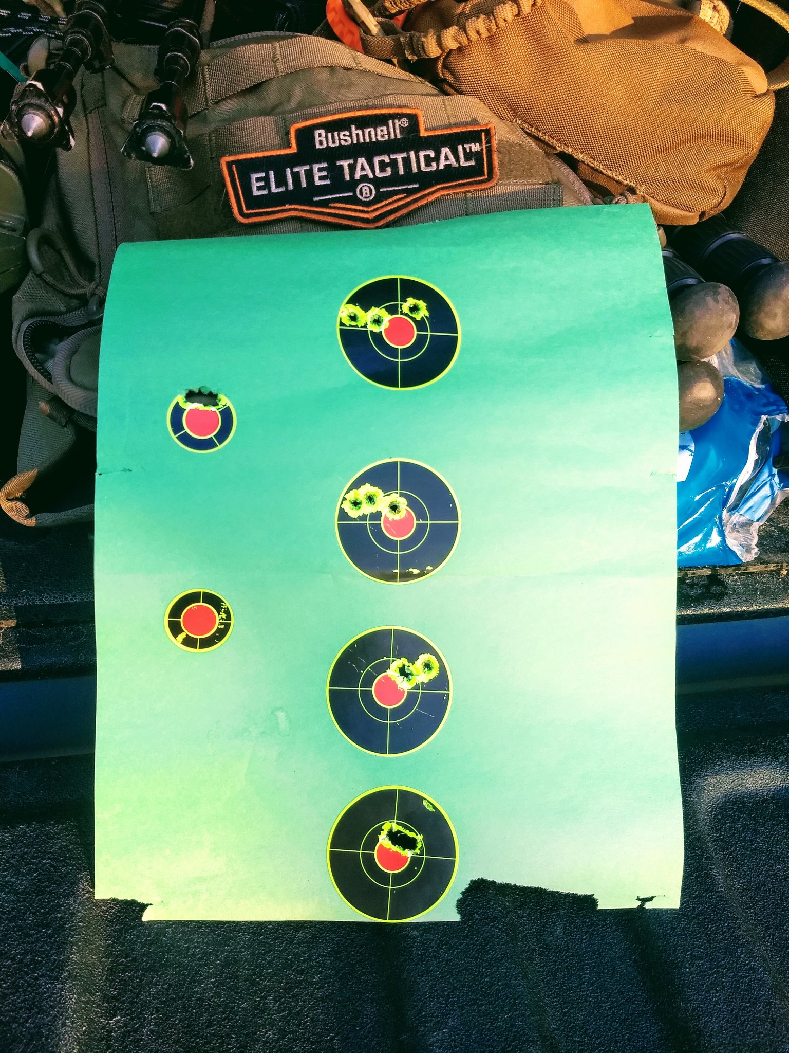

#13
This is the adjustment I have made off barricades which has taken my shooting to another level compared to it being in the soft shoulder pocket. Really has worked for me.
