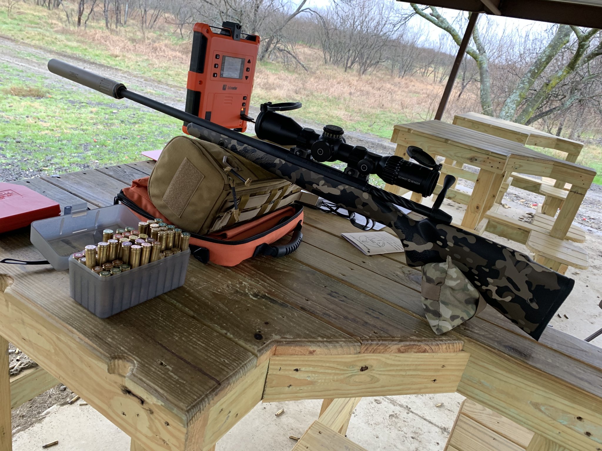

Rifle pic:
Forgot my front bag. The Spotter45 case worked in a pinch.

Very nice rifle and set up you have there @SkyScrapin!
