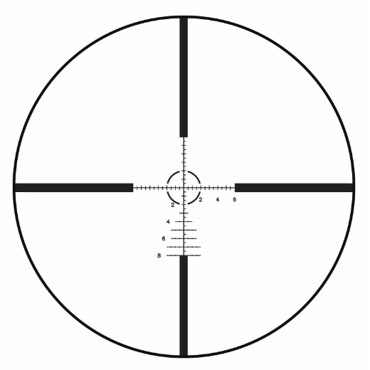

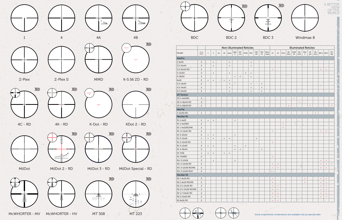

Which of Meoptas own reticles? Or anyones reticles in general? If theirs I have attached a clip from their 2018 material.
If not theirs then I would say something along the lines of the G3 in the 3-18 and the kahles skmr or the athlon APRS in the 4.5-27 and 5-20.
I dont really have a preference with the .2 vs .5 mil lines overall, but I do like that the .5 look better with lower zoom levels and the .2s look less cluttered to me With more magnification (as fa as FFP goes).
Zoomed out and I start to get dyslexic with the .2s as they get small and close for me and my decade old glasses. But most people have better vision than me so... I would be happy with either.
Just so long as its not a dumb BDC or boring whole mil dot/dash

I have been to the Meopta site and find I don't care for any of their retile's so for me they unfortunately are not a scope I want to have.

I have the McWhorter in FFP, BDC2 and BDC3. I prefer the BDC3 and the McWhorter of current options. It should be noted that the .223 and .308 reticles shown are NOT the reticles that will be in the Optika6 line. Those are not out yet, there will also be a 6.5CM reticle. Meopta will be updating reticles for the US Market, so if you want something, I would put it here for @koshkin
