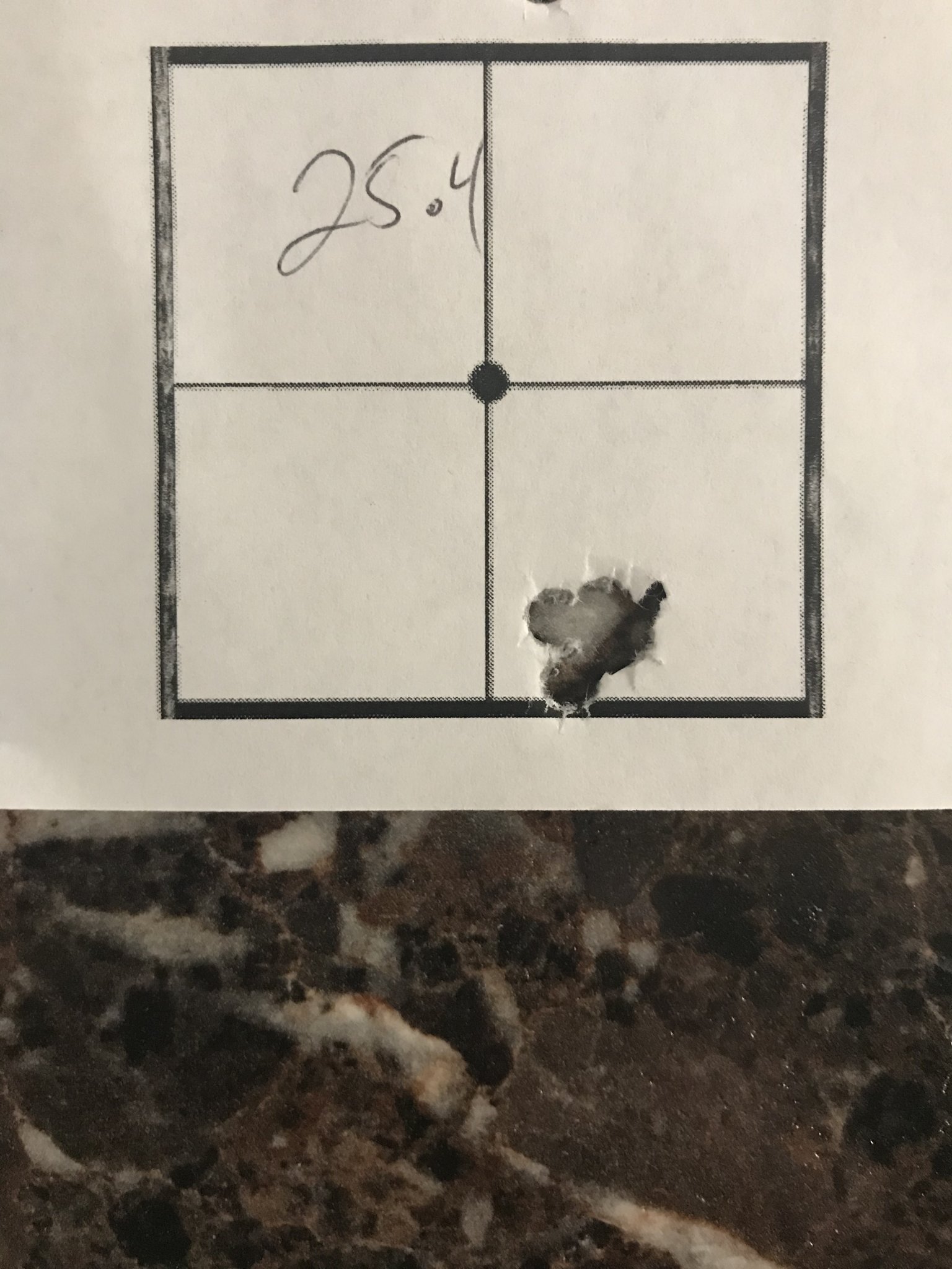

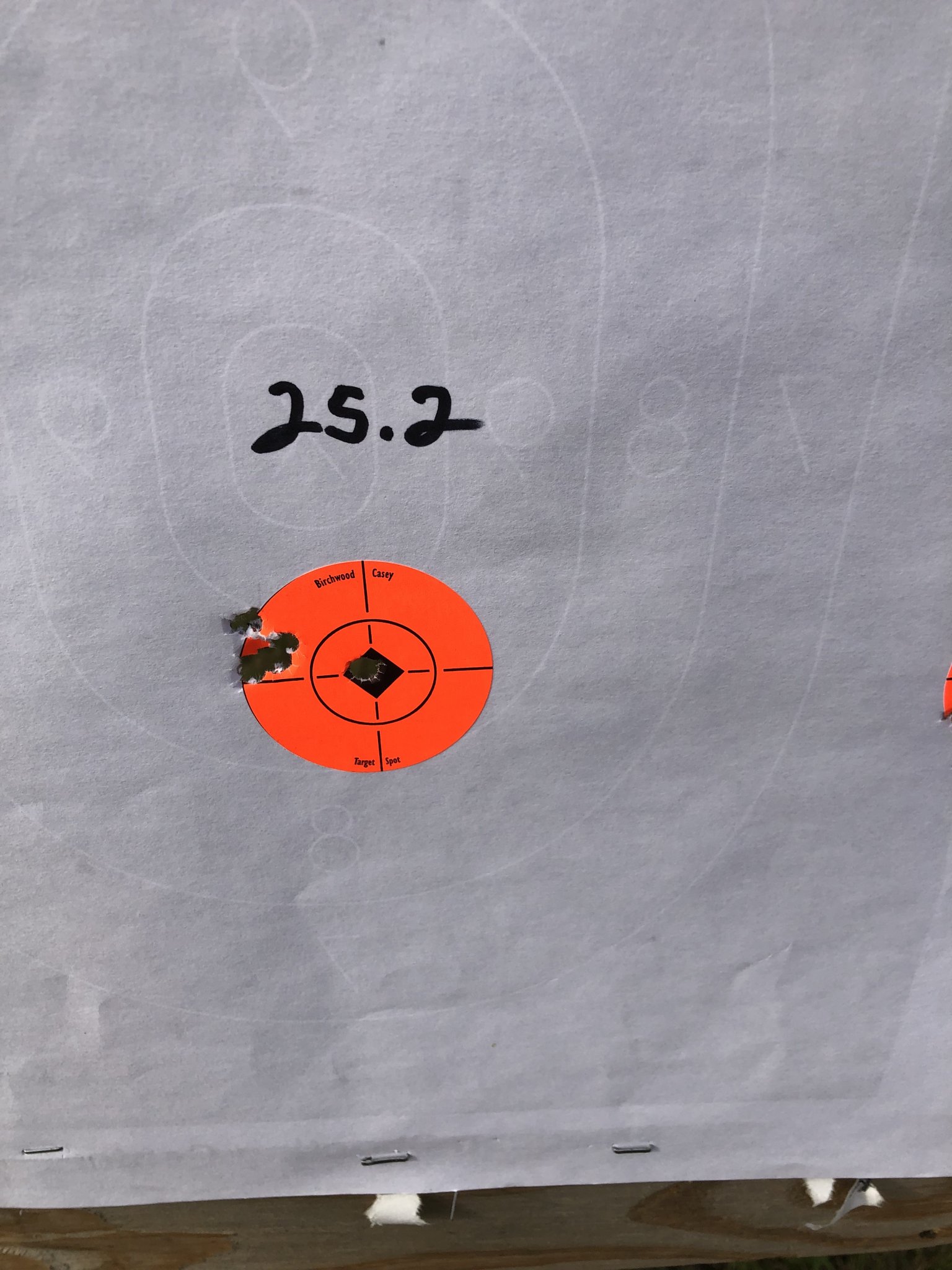

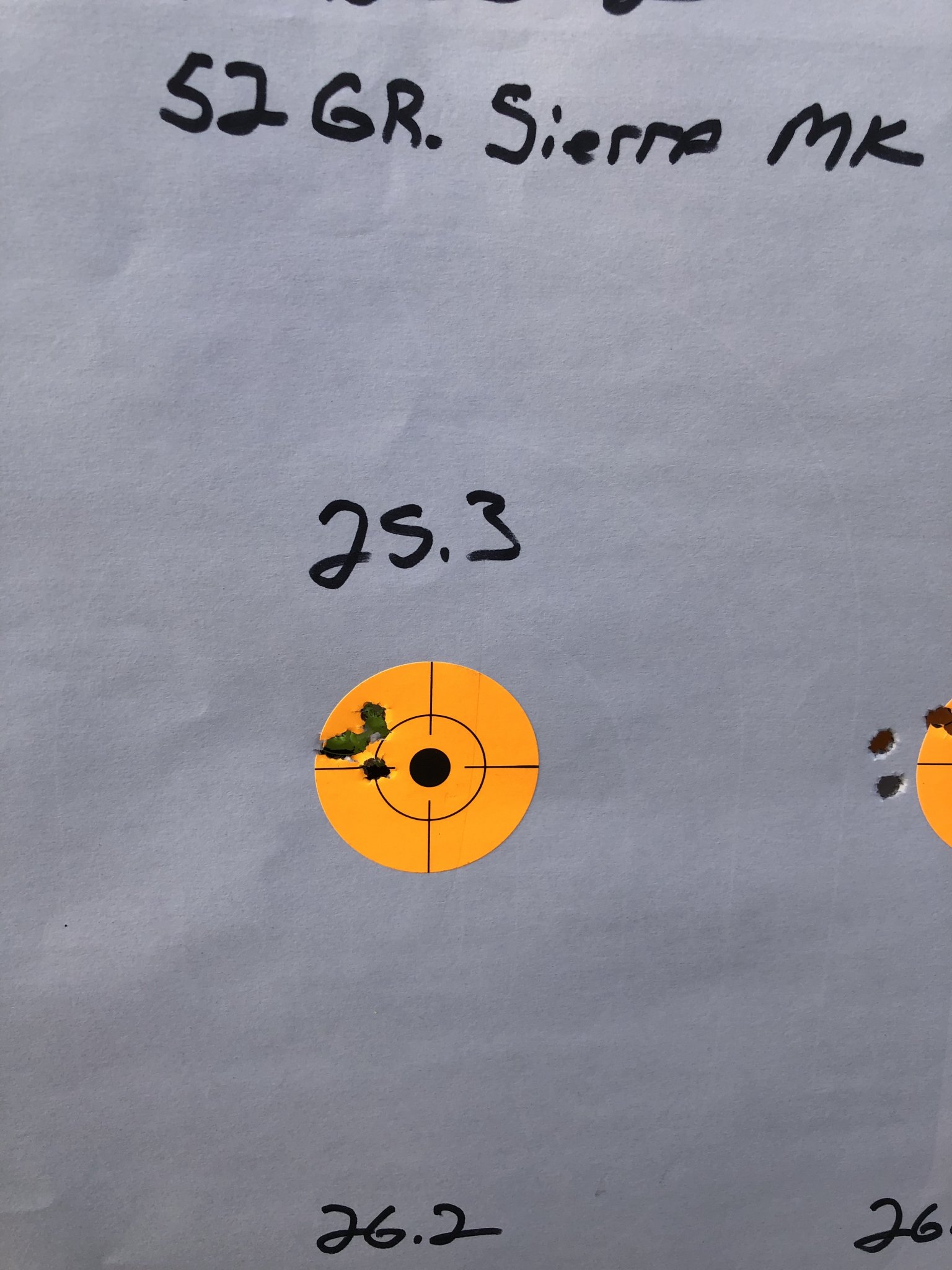

So an update: The gun shoots lights out! Worked up a couple of loads, and it shoots them both well. Problem.....put a geissele trigger in it. Feels awesome. Is wasn’t this way, so I haven’t effed anything up with my ass scratchers. But, the button by the trigger to release the bolt now has zero spring tension. You can pull the bolt out without pushing the button.
Bought it at Primary Arms, they are local.
Gonnna drop by this week. To guys got any ideas?
I’m performance time. First is a 50 grain v max with IMR 3031
The second is BLC-2 with a 52 grain baby match king.

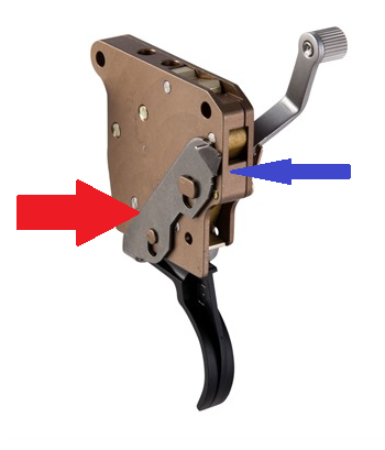

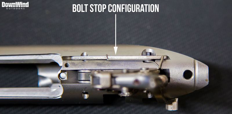

So I installed my Geissele trigger last night and did not have the issue you describe with the bolt release. I did check the bolt release button/bar (red arrow) and it does NOT have a spring installed. It just kinda rattles on the two nubs on the left side of the trigger. I believe the spring tension comes from the Remington factory parts that interface with the piece that sticks out perpendicular (blue arrow).
70473457047348
It's supposed to look like this:
View attachment 7047345View attachment 7047348
Thanks Bunsen. Gonna tear it down and see if I can see anything. I hear people rave about geissele. I’ve needed them twice and they’ve sucked both times. Maybe it is just luck of the draw.
