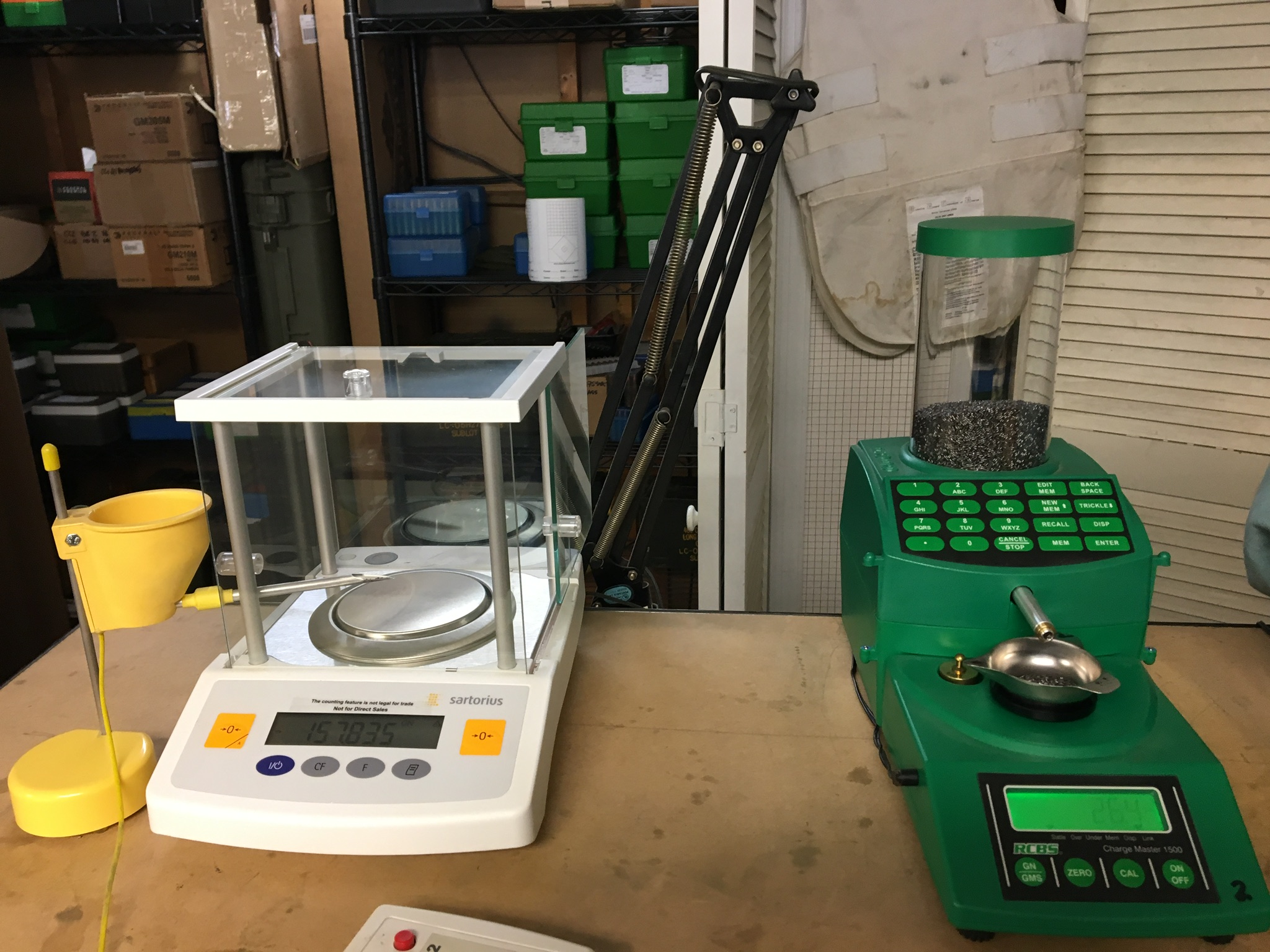

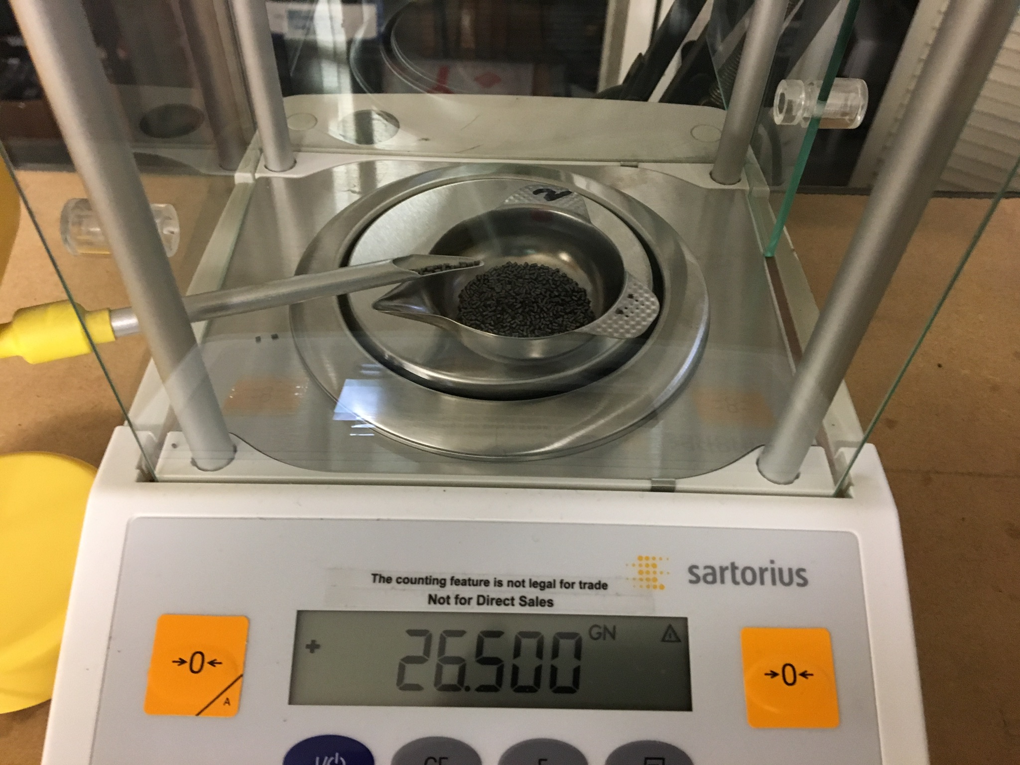

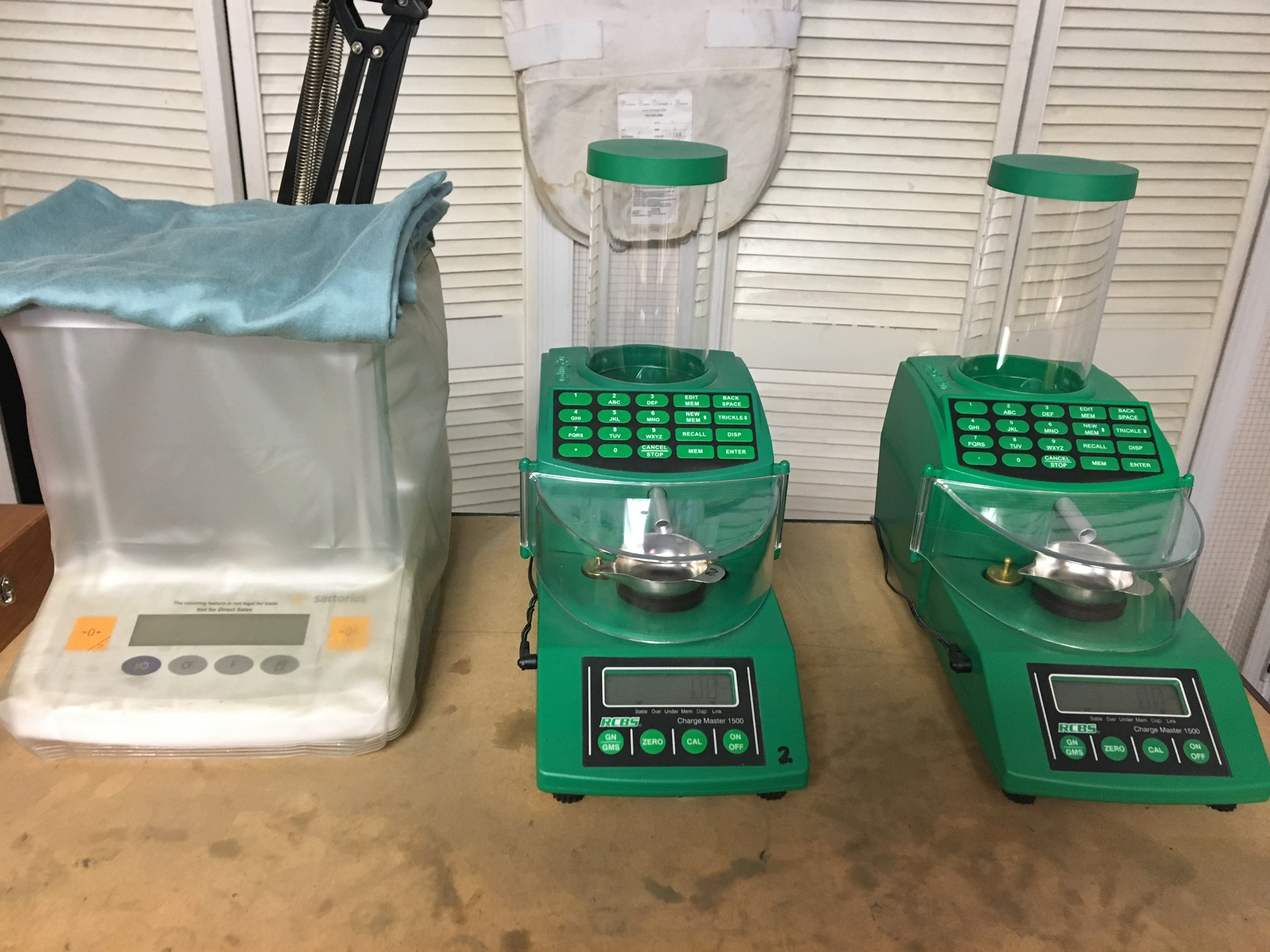

I’ve got two Chargemasters, both with reducing inserts that I bought here in the FS forum.
It’s helped a lot with overthrows, I have almost none with Varget, RL15, RL17, 4895, etc.
They have always made a mess with ball and flake powders, throwing them everywhere. The reducers haven’t changed that.
But that’s not really the problem with these things, it’s the software for the scale.
Both of mine are grossly inaccurate when it comes to weighing charges, and the charges they do throw vary by as much as .9 of a grain and still show the correct target weight when the charges are completed.
They’ve both been reduced to automatic powder measures, for lack of Better terminology.
RL17:
I throw charges below target weight on the CM and trickle up on my Sartorius GD305.
Once I get into the swing of it, it’s not much slower.

I’ve had both of the above CMs for 10 plus years. Well, almost, both have gone back to RCBS for refurbishment. I think it was $95.00 last time I sent one in, including return shipping.
All three of these scales are never turned off, unless there’s a power failure. The Sartorius and the CM on the left are both plugged into a line normalizer thing. The CM on the right isn’t. Doesn’t seem to make much difference between the two as far as function goes. The CMs live under old pillow cases. The GD305 has its own fitted cover.
Because the Sartorius can weigh one stick of powder, I have to decide how close I want to be to my target weight on it. Most powders can only go within one hundredth of a grain (.010) over or under. Ball and flake powder is more forgiving. I can get within 5 thousandths (.005) of a grain.

Both of mine were that bad before I added the bushings. Now they throw .1 grains over about 50% of the time, occasionally they will throw .2 grains over.
Reactions: OzzyO20
