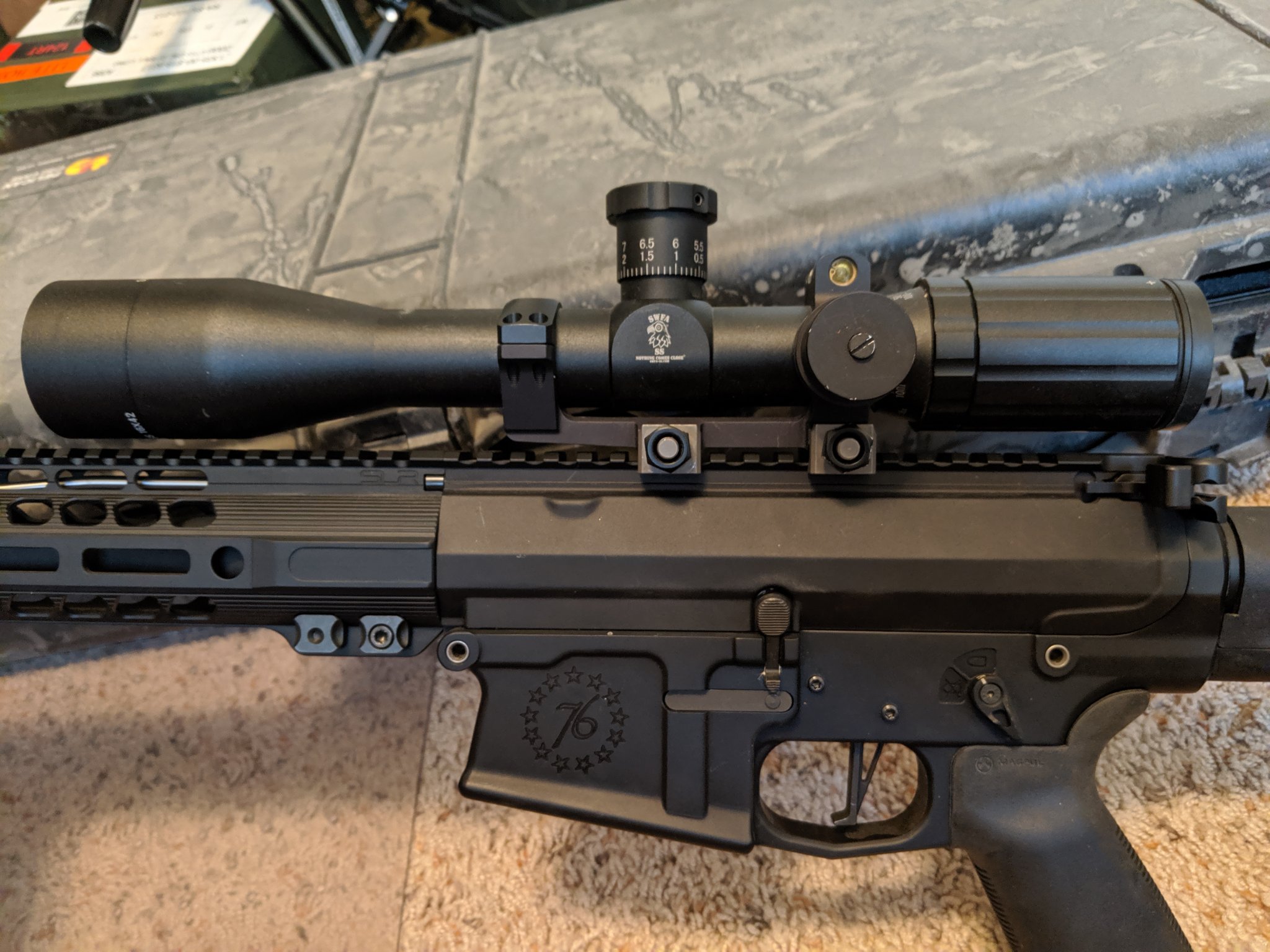

I have an SWFA SS 16x42 mounted on a Nightforce Unimount 1.125 with 20 MOA taper. The optic has 40 Mils of elevation and the base adds about 5 Mils, so I should have 45 Mils of total adjustment.
I went to shoot today and push my limits. I setup at 1667 Yards which called for 32.47 Mils. I could only get 14 Mils of adjustment before it was topped out. I checked Nightforces website to ensure my mount was installed the correct way, and measured the distance from the optic to the rail in back and front of the optic, so it's mounted correctly. Just looking at the adjustment post when it's at zero, it's already adjusted way up, over 20 Mils.
I have no idea what's going on. I should be able to push this setup beyond the rifles capabilities.

I would remove everything and reinstall it. Makings sure all surfaces are clean and smooth. Maybe center the scope a little more in the rings, it looks like it might be touching the bell in the back.

So I looked into it once again per some of the comments here. It looks like SLR Rifleworks gas block has a screw on the side that allows the gas block to "click" to different positions. This screw is contacting the rail, which is also from SLR Rifleworks. The barrel is also not centered in the rail itself. It's low, and off to one side. I'm assuming this can make a huge difference although I don't know if it's the barrel, or the barrel and the rail.

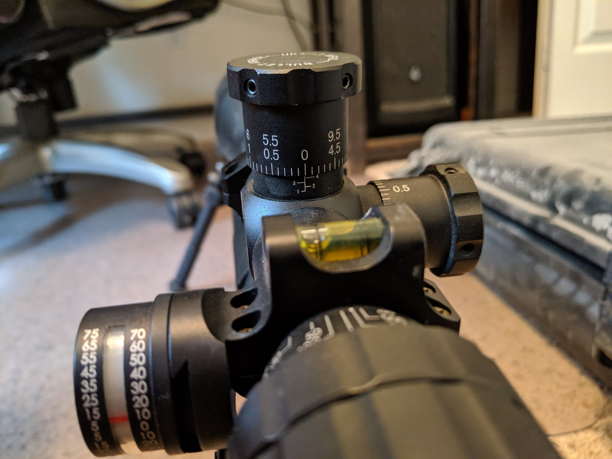

Are the rings overtightened?
In the picture it looks like there is minimal, if any, gap between rign halves.
ILya
Do you have an inch pounds torque driver? Did you torque your rings to factory spec. Listen to Ilya. I also suspect your erector is binding because you cranked those rings down.
