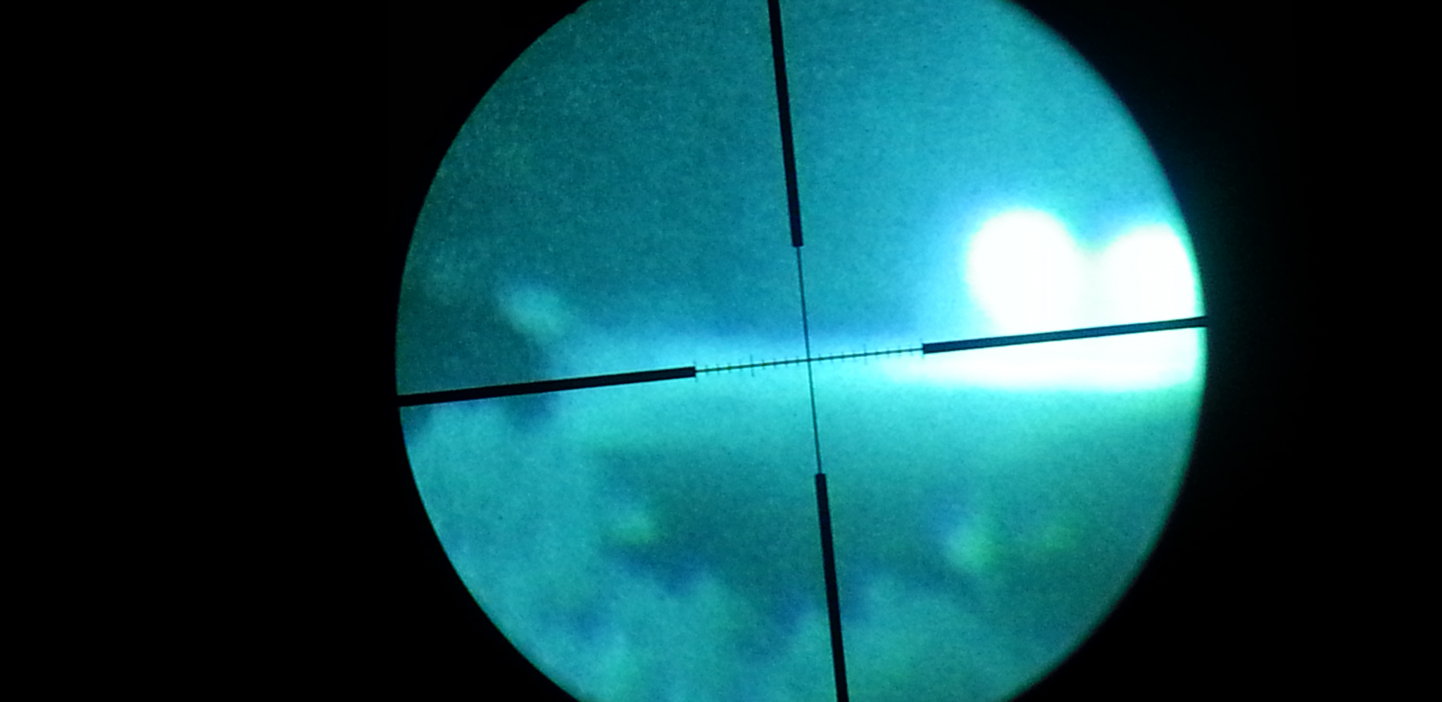

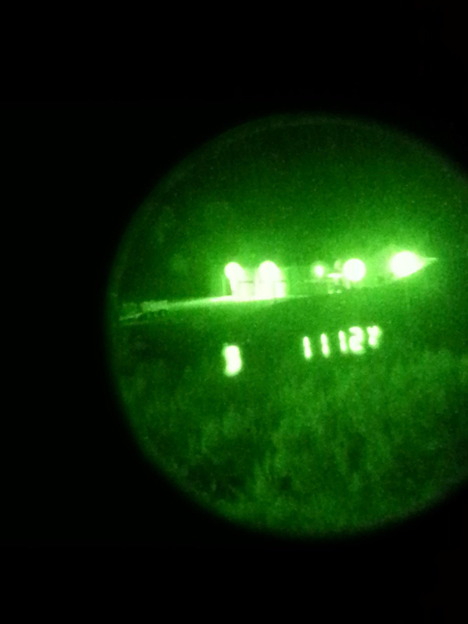

Here's a pic though the scope of the CO-LR Flag with the WP gen3 L3 unfilmed tube I did a handpick on. Pretty sweet huh? The lights are coming off a building in the background at 1112 yards. The image quality on that thing was terrible there was no way I could have taken it on to the public lands I shoot on where other people have a right to be and sent live fire downrange into a blur. IIRC I payed $5,500 and thank god I was able to return it to Armasight minus a restocking fee. Can't blame the tube the specs were smokin Res 72, PC 2722, SN 33.1, Halo 0.7, EBI 1.0.
Does anyone have though the scope pics at long range on the refurb pvs30's they can share? I'm still looking for replacement.
Edit;
Some additional images added for transparency.
One image with the PVS14 looking though a PLR25C ranging the building at 1112yrds.
And another image of the PVS14 behind the scope looking at the building at higher magnification. This image is significantly cleaner than the image of the CO-LR looking at the same scene. Of course both devices are mounted on a rail and are not on a rifle. 20160624_235625.jpg 20160625_001239.jpg

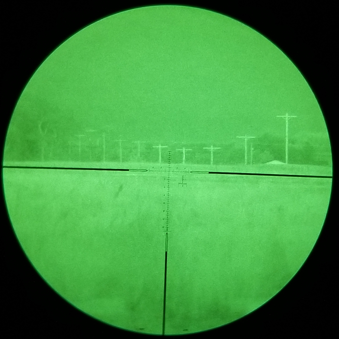

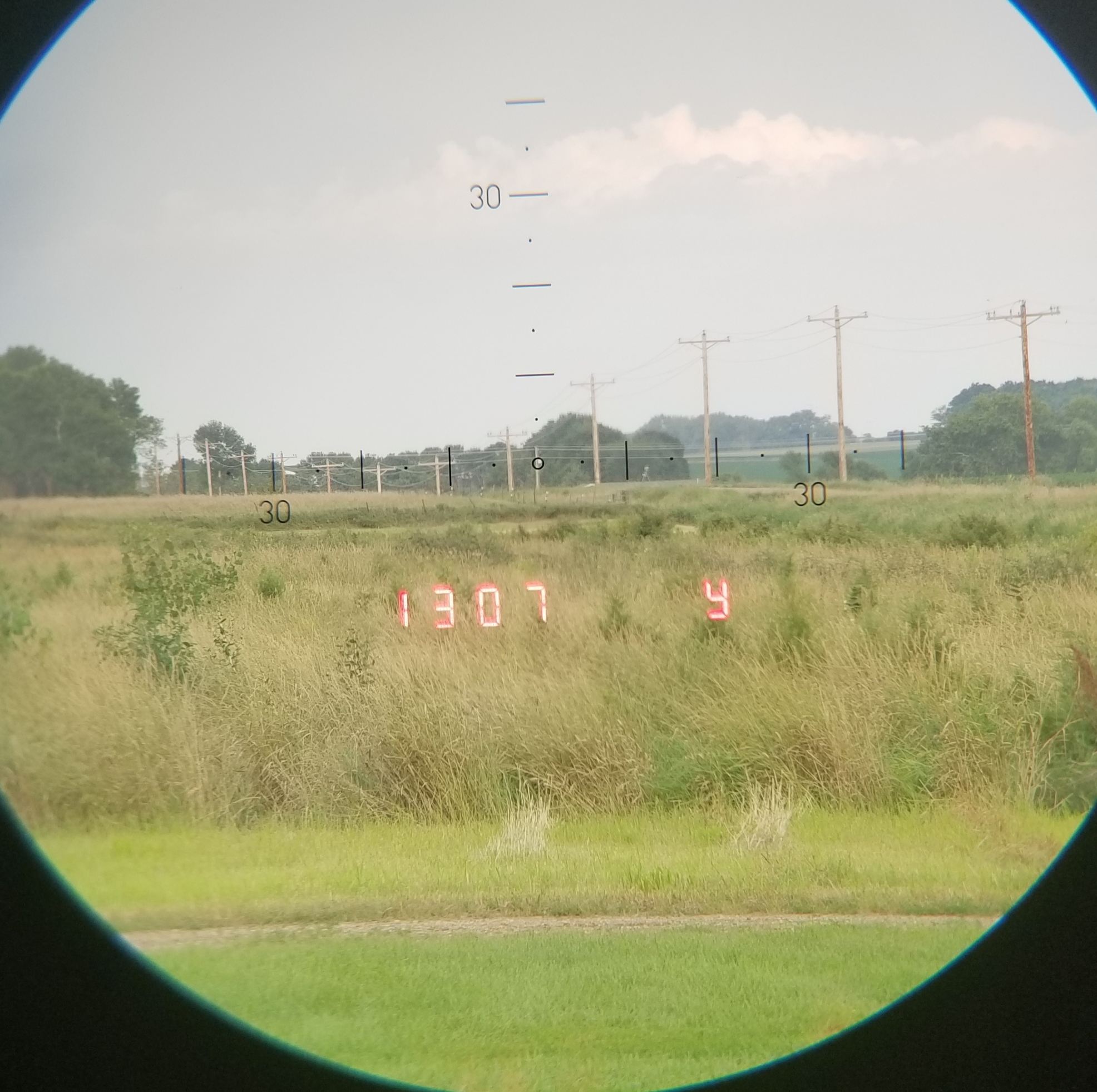

Atacr was on 4 or 5x I think. That small transformer hanging on the pole to the right is at at about 1150 yds if I remember correctly.
Thank you. Still hard to get an idea of a device from just one image does anyone have else anyothers.

Thank you. Still hard to get an idea of a device from just one image do anyone else anyothers.
There are way too many variables to judge performance with through the scope pictures. To have any indication the units would both need to be tested in front of the same exact optic, in the same ambient light and/or illumination (really on the same clear night minutes apart), and looking at the same target area.
Even if you can make all of that happen, then you have to get consistent through the scope pictures which can be very hard to do. If that isn't all the same you could make a gen 2+ Armasight look somewhat decent in flawless lighting conditions and you could make a PVS-30 look like absolute dog shit in crappy conditions. All things being equal though, that PVS-30 will beat up the Armasight and steal its lunch money.
If you're on instagram look up team_pitch_black_precision they have quite a few good through the scope videos night hunting with PVS-30's and also some with Simrads. The page actually belongs to a guy that posted in this thread.

Well, my PVS 30 arrived today Andy it looks really good! I’ve played around with it in the front yard and messed with ranges from 30 yards out to 300. Looks great. No moon, only starlight. Easily useable up to about 15x. Dialed magnification higher and with external illumination I can easily go higher. This is with my Bushnell elite 3.5-21 G2 hdmr. I’m trying to get just the right angle to view a house that is ranged at 2, 978 yards. I need external illumination. So I grab my MAWL and try it. The problem I’m running into is that the Mawl has the controls on the top. I didn’t account for the length of the PVS 30 in my set up. The front lense literally stops at the very end of my rail. I’m going to have to figure something out or pick up a different external illumination. Im not expecting to illuminate 3000 yards, I’m just playing around to see what’s possible with this set up.
Next up is my RPR with Vortex Razor Gen 2, 4.5-27. I had to modify a rail section that was suppose to be for mlok, and then drill and tap my rail so I could attach my PVS 30. That worked out well and is very sturdy, but the 30 definitely could sit about 0.3” lower. I’m not changing rings out but may look into grinding this short rail section down later to thin it down and bring the center down closer to where it should be height wise. Anyways, it still works besides not being lined up just perfect. Now, the disclaimer isn’t that I haven’t shot it yet to see if it does anything to them zero with it not sitting lower. Range time will let me know that later. I planned on taking a bunch of pictures and I will do that as I have more time. For now I just wanted to update everyone. Pictures will follow on this page and I will also add them to the pvs30 pqge.
Now, back to the dark side!
