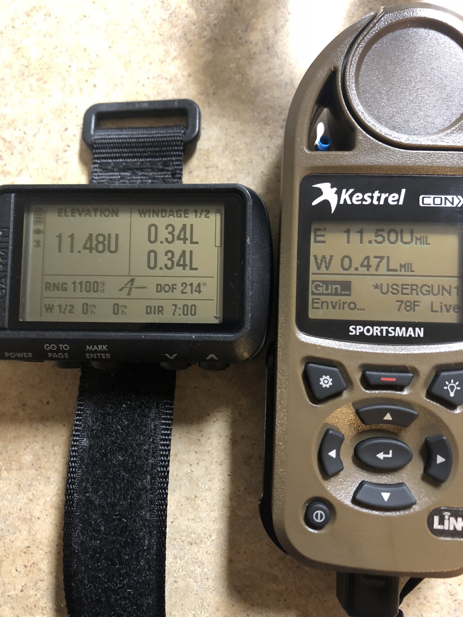

I purchased a kestrel sportsman/Bushnell Conx 1 mile range finder and was checking the ballistic calculator along side my Garmin 701. My 701 is 100% dialed in so I was really happy that my new sportsman matched it perfectly. Then I updated the firmware and now I can’t adjust bullet length. Did kestrel remove bullet legnth to make people upgrade to elite? Is there anyway to delete a firmware upgrade?

The windage is a click or two off at 1100 yards but elevation is ok. I should have never updated it because it was perfect before. If its not broke don’t fix it🤬

They got me. I just bought the elite upgrade. Now I just have to wait for the dongle to ship.
