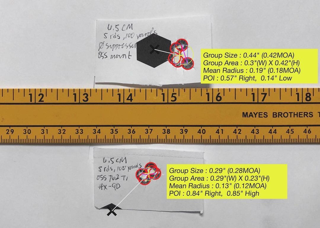

I’m currently using one on my .300 BLK SBR (HX-QD 762 Ti). I put it on an 18” 6.5 CM bolt gun and was impressed with host rifle accuracy and their QD mount. I agree that the can is better suited for semi-auto rifles.

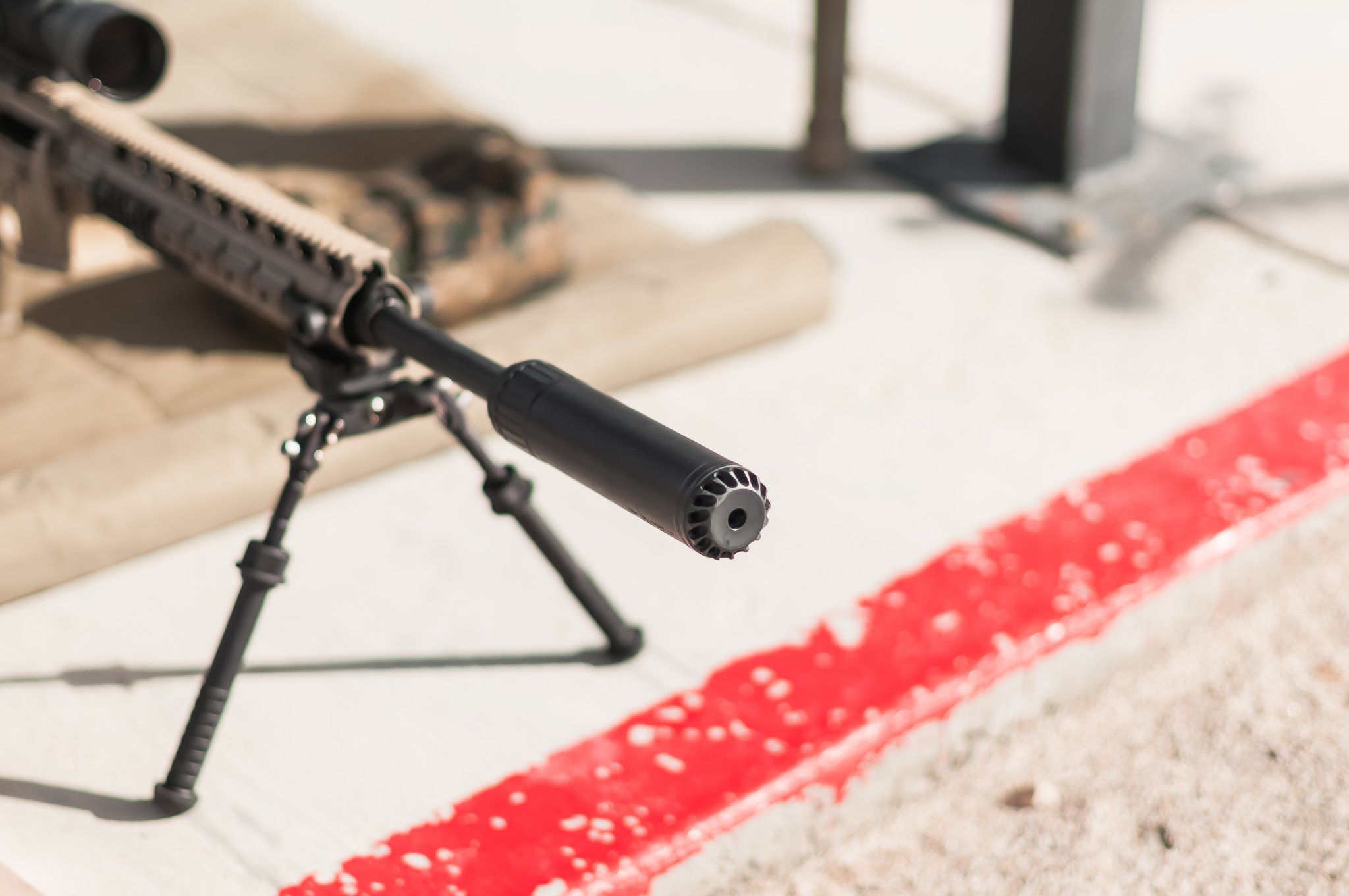

On the line shooting the OSS with my AX, I don' t notice it being overly "loud"
Loud without numbers is usually a tone thing, how thick the wrappers are, etc. We are shooting full-power loads with a bolt action and frankly speaking I can careless how loud a can is. At 140db you still want some kind of ear pro, shit, even at 136db you want something
My concern is accuracy, and when cans try to increase the quiet they usually wreck the accuracy the thing. Who wants a rifle that shoots 3/8th of an inch with factory ammo only to have the suppressor turn it into a 5/8th rifle. So accuracy is a bigger concern than sound.
Distance gives you time and opportunity, and that helps mask a lot.
The OSS can be 10db off and as long as it's accurate, who cares, but we all know it's not 10db off the average. 3 is pretty common among brands, a couple of db here and there is lost in the noise.
