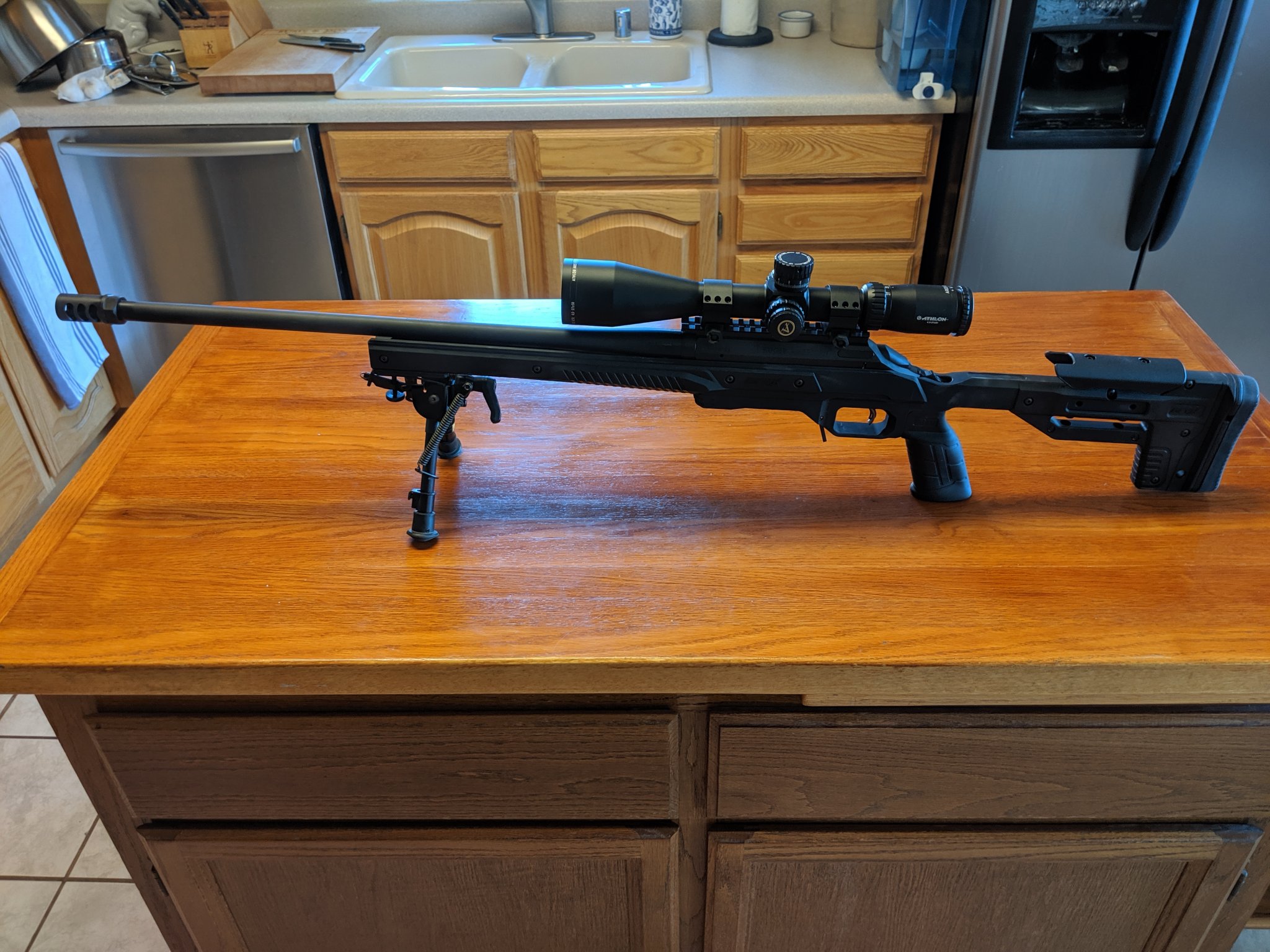

This is the RAP I was talking about earlier.
This is a 6cm but no biggy. I had my LGS get one in - 450. Oryx was 400 - I added the black skins - not needed. Then swapped out the scope base for a 20 moa - 40. Ares btr scope I had laying around. Is it an aiax, no. Is it fun to shoot, damm right.
