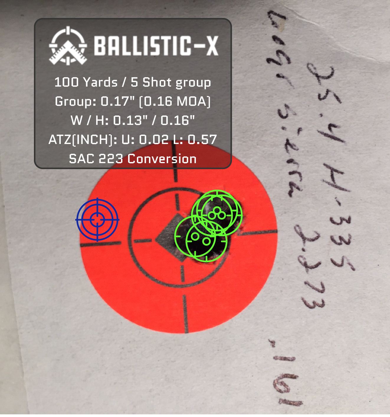

I didn't chronograph that load, but Quickload (which I have found to usually be pretty accurate) has it at 3279 fps from a 26" barrel. Also, please note that this is an above listed maximum load. It shows no pressure signs in my rifle, but that might not be the case in yours, so approach with caution.
What I can say for certain is that it's an awesome varmint load!
