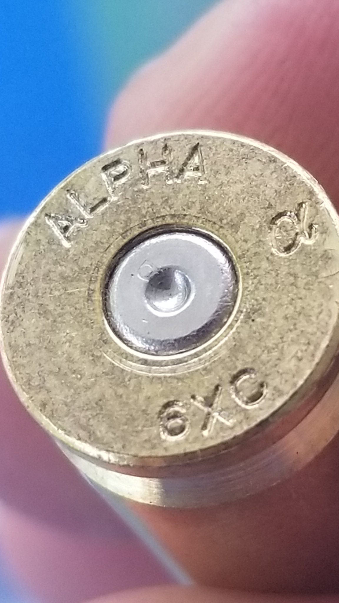

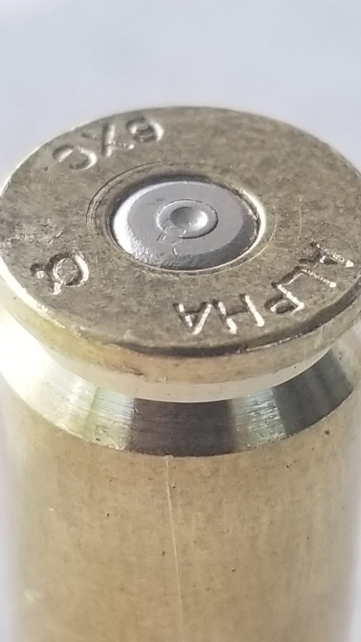

Took my new 6XC build to the range for the first time. Lefty Impact action, TriggerTech Diamond (factory set pull weight), Altus barrel XLR Envy Chassis are the major components. I got it zeroed and starting shooting my handloads over the Magnetospeed V3. Components of the loads: Alpha brass, CCI BR4 primer, H4350, and 115gr DTAC seated .020 off the lands. My sighters for zeroing were 36grs of powder and pretty mild. Only issue was two primers that did not go off. Started chronoing at 36.5gr, 37gr, and 37.5 gr went fine. Shot two rounds of 38gr into one hole. Brass looked great. I got on target, ran my bolt forward, and just as I was starting to lock the bolt down the round went off. Scared the ever living shit out of me. Took the bolt out and inspected it and it looked fine. Action and barrel all intact with no signs of cracking. The only casualty, or so I thought, was the Triggertech Diamond. It would no longer drop the firing pin and had the very slightest slop in it. I didn't have my Fix It Sticks with me so I couldn't tear it down fully. I got home and pulled the barreled action out of the chassis. The rear screw for the trigger hanger had loosened quite a bit. Tightened it up and everything worked as it should. I've never had this happen. Any ideas about what could have caused it? Worried it may happen again and I happen to like my fingers, face, and gear.
Good piece of brass from same load:
Out of battery detonation brass:
Steel head

My guess is the trigger didn’t catch and firing pin protruding in bolt fade set off primer or it released as soon as you tried camming the bolt.
I’d really investigate your trigger to striker sear relationship.

Pull the rear screw from the trigger hanger that you found loose and check it over very carefully for any signs of damage due to cross threading or the peaks of the threads being flat from yielding and slipping from being over tightened.
They are tiny machine screws and could be easily damaged, if you find any damage I would then carefully inspect the female threads in the action.

Hopefullu the screw was the culprit. If not you probably need more sear. Unload the rifle, close the bolt and smack the side of the stock with your hand and tap the handle sharply with your finger. If it drops, readjust the trigger. I have had a couple light M700s and a Timney loose the sear adjustment and fire on bolt closure.
Does the trigger have a trigger mounted safety? If so, does it still work?

Beat the stock and the handle pretty good and nothing happened. It does have a trigger mounted safety and it still functions as it should.

You may have gotten lucky with finding the rear screw loose. I would follow XLR308s advice and inspect the screw and both sets of threads closely. If it's all good, maybe use a light thread locker on reassembly.

Given the fact its a Triggertech, sear engagement is most likely good (pre-set by the OEM). Also, I have NEVER seen a round go off from letting the firing pin forward from closing the bolt, the slow act of closing and the internal drag absorbs a LARGE portion of the firing pin impact energy.
THE PROBLEM IS: the rear trigger hanger screw was lose and, although the front was tight, it allowed the aluminum trigger hanger to flex enough letting the firing pin drop via the cocking piece riding over the trigger. The maximum load on the trigger is upon full closing on the bolt, so I don't think your "running the bolt fast" had anything to do with it...….just a coincidence of max loading at that time.
This is a drawback of trigger hanger setups. How many of you actually lock-tite those screws??? Nobody does......because you want to be able to take the trigger out and clean it or swap it for the latest trigger. I would like to see action makers put in a second layer of safety on trigger hanger actions by designing a tab/screw system on the rear of the hanger (like on the tempest action but in reverse) that allows the rear of the hanger (the most important part) to maintain its engagement/height with the firing pin cocking piece even if the front hanger screw shoots lose.
To be clear, this is not a "fault" of the action design, just something that needs to be pointed out to the kitchen table assembler. The unintended results can be VERY bad.
