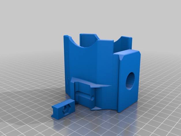

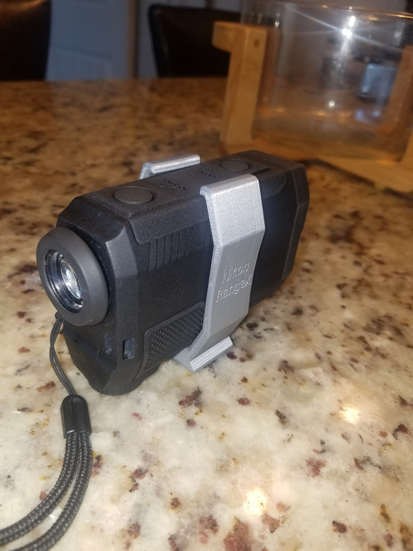

I'll 3d print a couple before and make any dimensional adjustments needed, before making the files available on www.thingiverse.com.
I have a version with a 7/16x1/2 hole in the bottom. This will allow the user to epoxy in a 1/4-20 threaded insert.
A version with a Picatinny mount on the bottom:
A version with a rail mount on the R/H side, for mounting to spotters with rails such as the Bushnell T Series and LMSS
And a Tri-Mount version for those who really like to accessorize their gear!!
If printed using PLA it should be strong enough to allow the open area on top to flex out enough for the RangeX to snap securely inside the mount, without interfering with the buttons or obscuring the button labels.
The bottom of the RangeX, just in front of the battery compartment has a little taper, so for a secure fit it can only fit into the mount in one orientation, as marked.
This taper also makes a fully enclosed design impossible. If the opening were big enough to fit over the front of the RangeX, it would be a poor fit once centered.
It will require a 10-32 screw, and a nut, in addition to one additional part which i will design later, after ive tested the viability of the design.

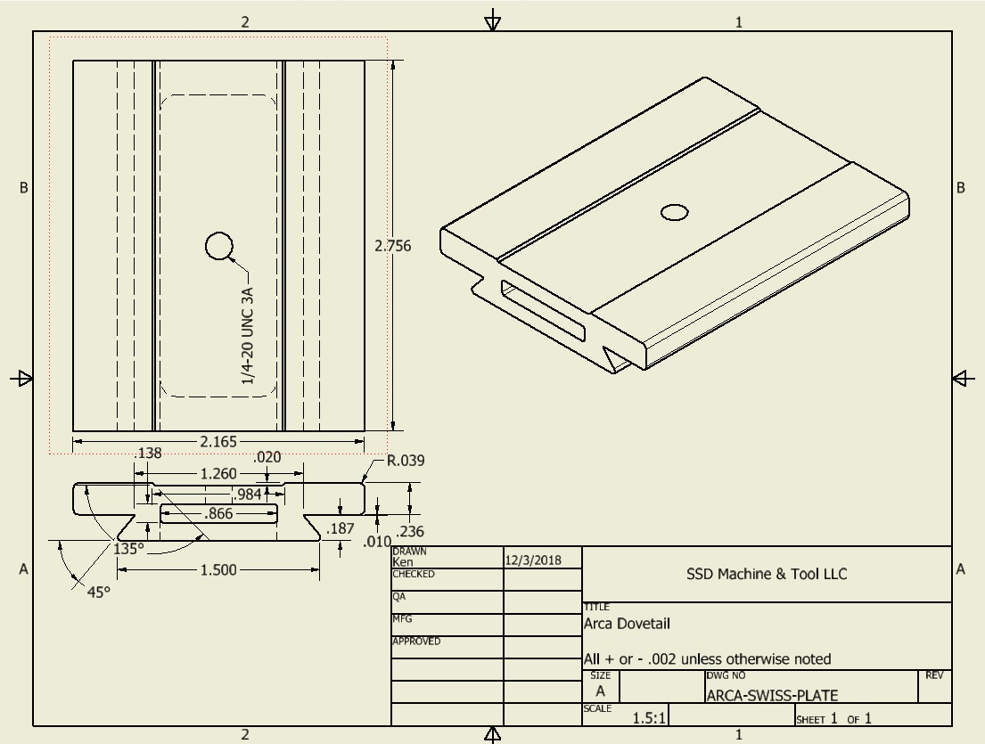

#12

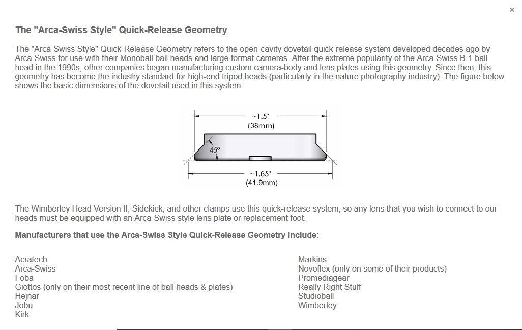

Because i have no idea what its dimesions are, nor do i have one to measure.
Since i dont have, nor use an arca mount, and i have no intention of making these for resale, i would never recover the cost of buying an arca mount.
But, if someone wanted to provide me with an arca mount or accurately dimensioned drawing, id be happy to design a version so equipped.

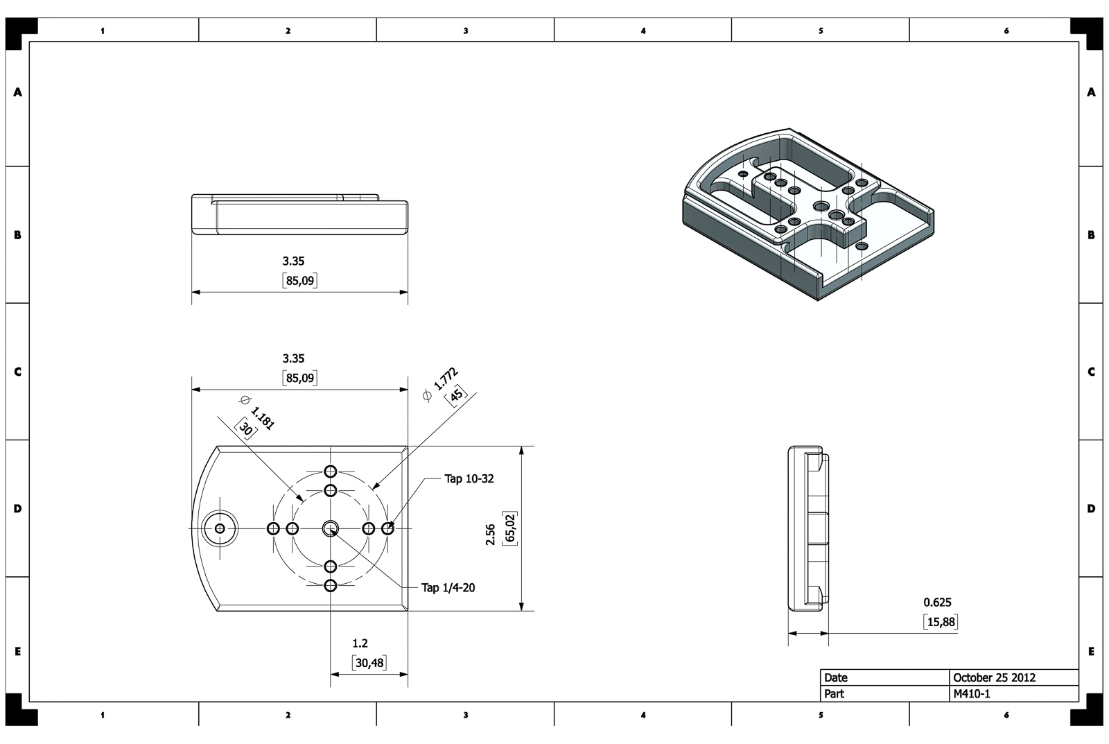

#15
I've found that drawing and many similar, but im having trouble finding one that shows all 3 dimensions.
assuming that drawing shows all the x and y dimensions, as in length and height, are the z dimensions (depth) nor relevant?
im needing one that shows the chamfers, radii, height of the truncated portion, depth, with an accuracy to at least a couple thousandths of an inch.
something like this:
http://www.hejnarphoto.com/ebay/pictures/M410/M410_drawing.jpg
but, obviously, for the Arca

#17
How critical is the length dimension of the plate?
I don't have an Arca Swiss head. Will the head accept a dovetail that is 1 inch long rather than the 2.756 length in the drawing?
Is the image visible?

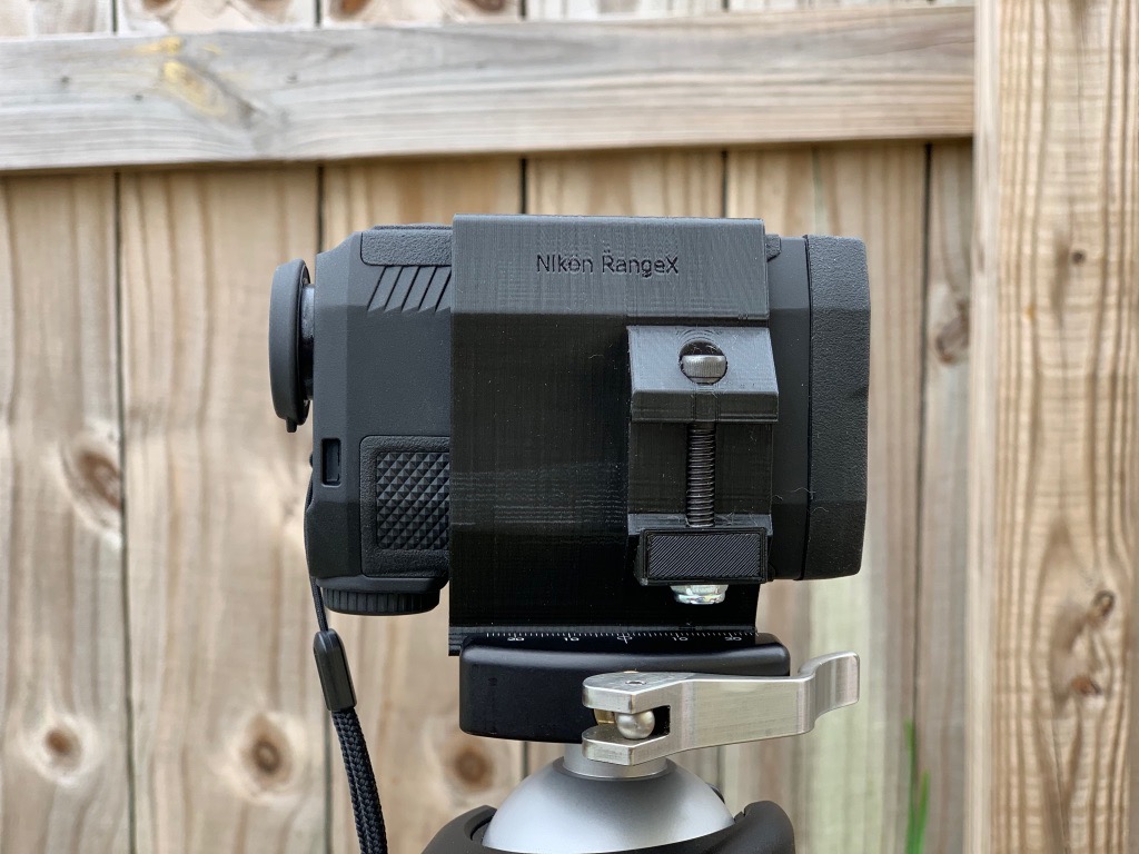

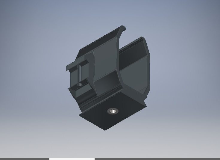

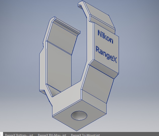

After playing with the previous versions for a couple days and deciding what i did and didn't like about it, I designed a more heavy duty version.
I think i'm going to manufacture a small, limited run of this version to sell on Ebay. The body will be 3d printed from PLA polmer. It will be a typical 3d printed design, with a hollow outer shell reinforced with a honeycomb pattern infill.
It has a Picatinny rail mount on either side, an Arca mount on the bottom, and will have a steel 1/4-20 threaded insert in the bottom.
Thoughts?
Does this have the features most would find useful?
I'll 3d print one this evening to test, and if it goes well I will manufacture several dozen to test for demand on ebay.

#29
Scocobeach and 021411;
This new version seems to fit the RangeX much more solidly. The picatinny mounts are better as well, but i have no way of testing the Arca mount.
It you two are willing to do some test fitting, and willing to post up a small review, with pics, ill send you each an example of this version at no cost to you.
Ill even cover the shipping.
Ill post pics this evening.
It will be a couple days before they are ready to go. I still need to manufacture and install some hardware.
Send me a pm.

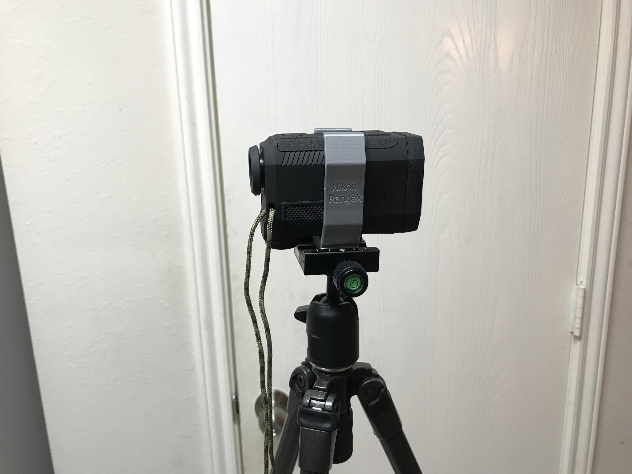

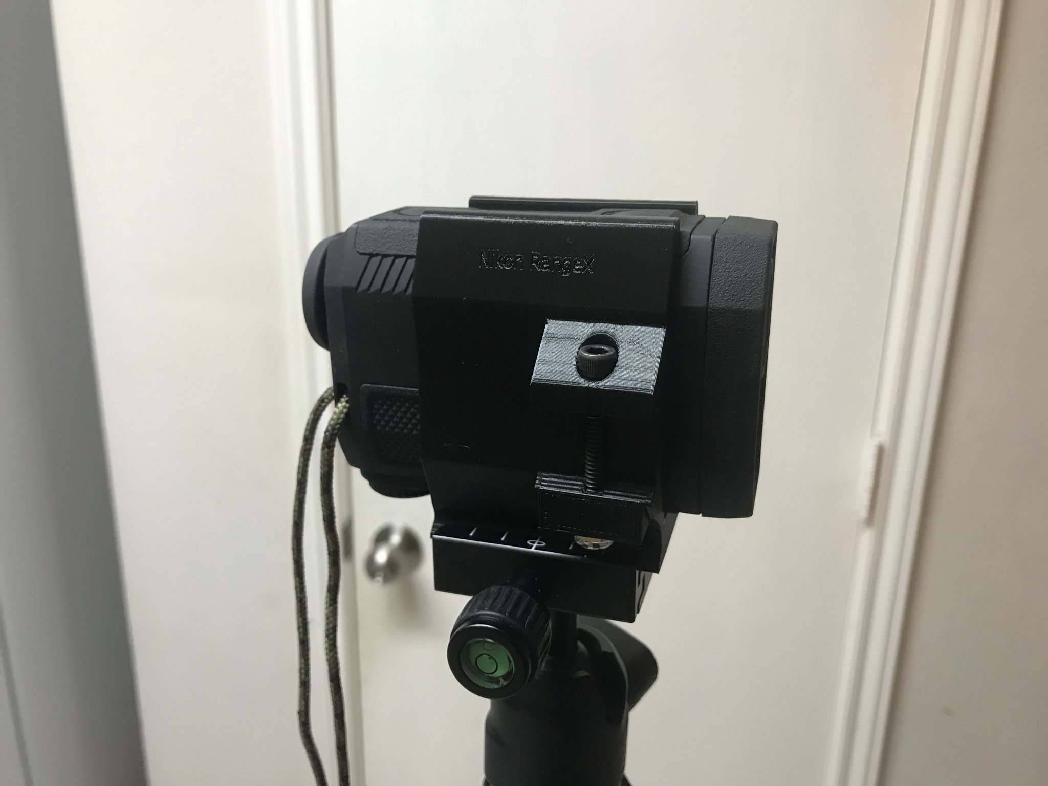

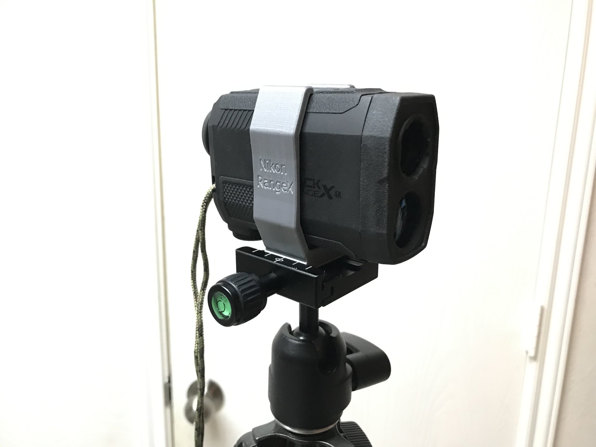

#41

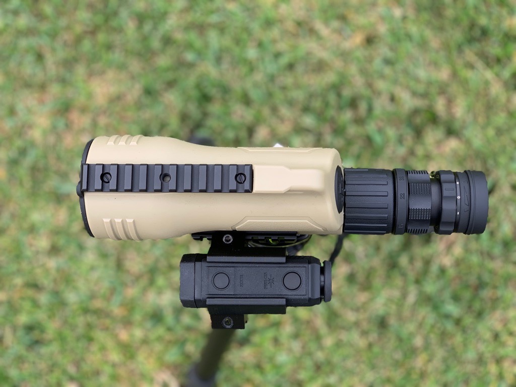

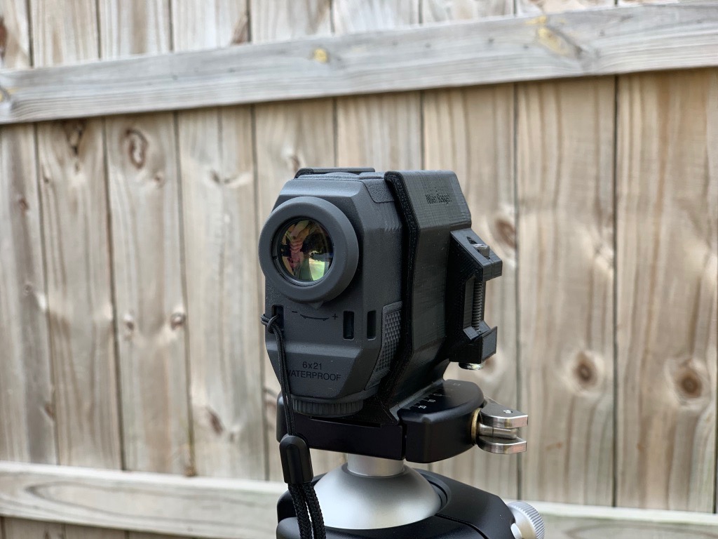

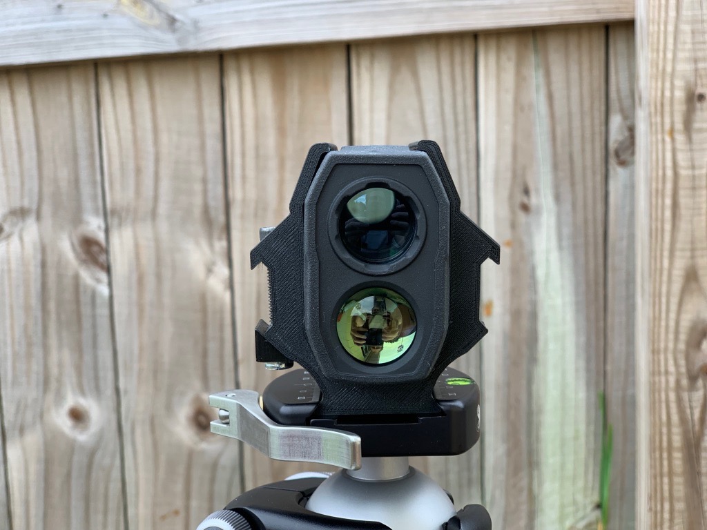

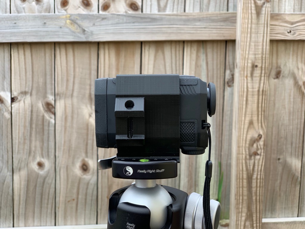

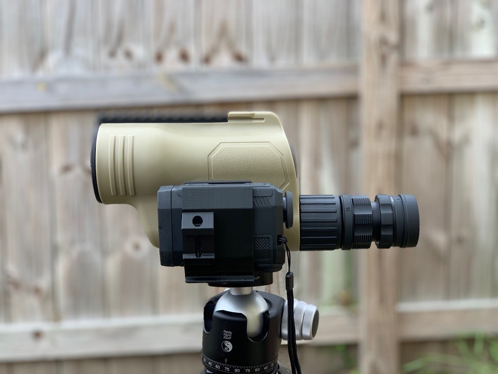

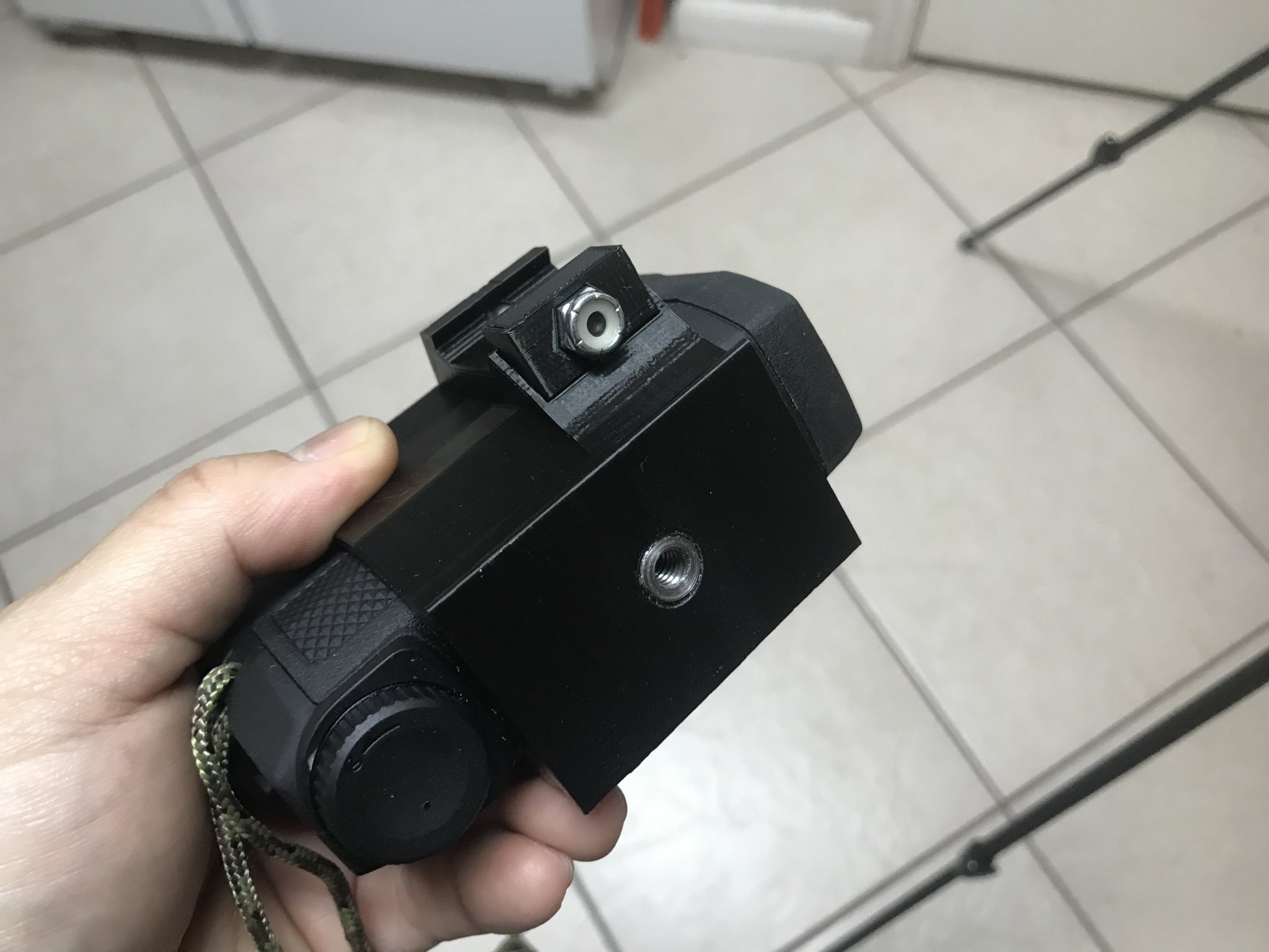

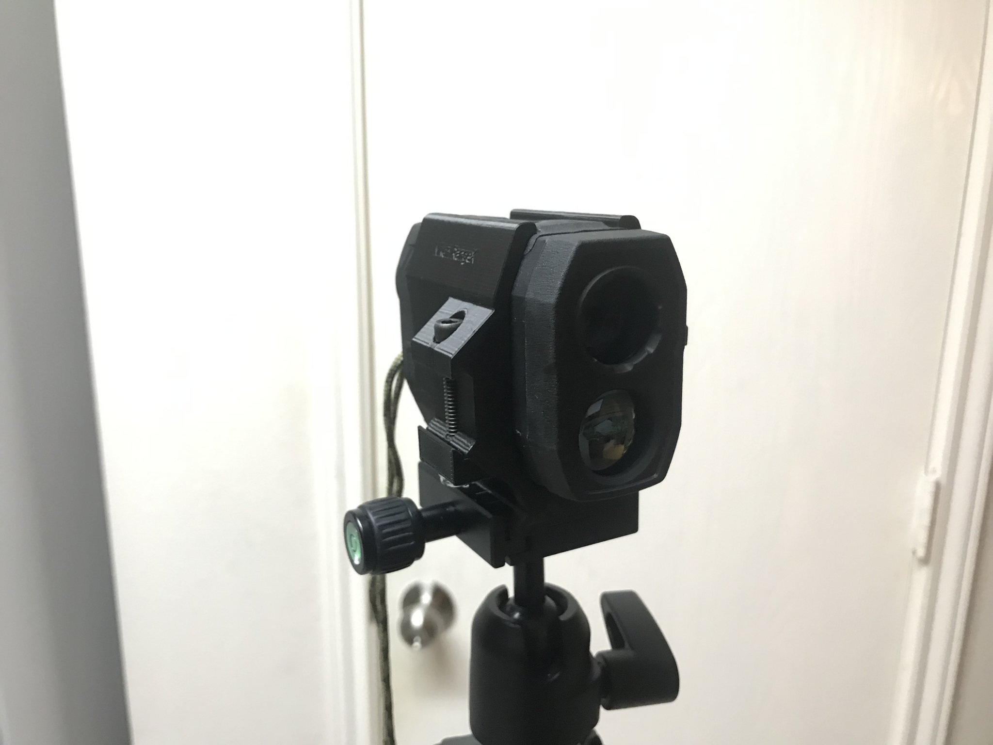

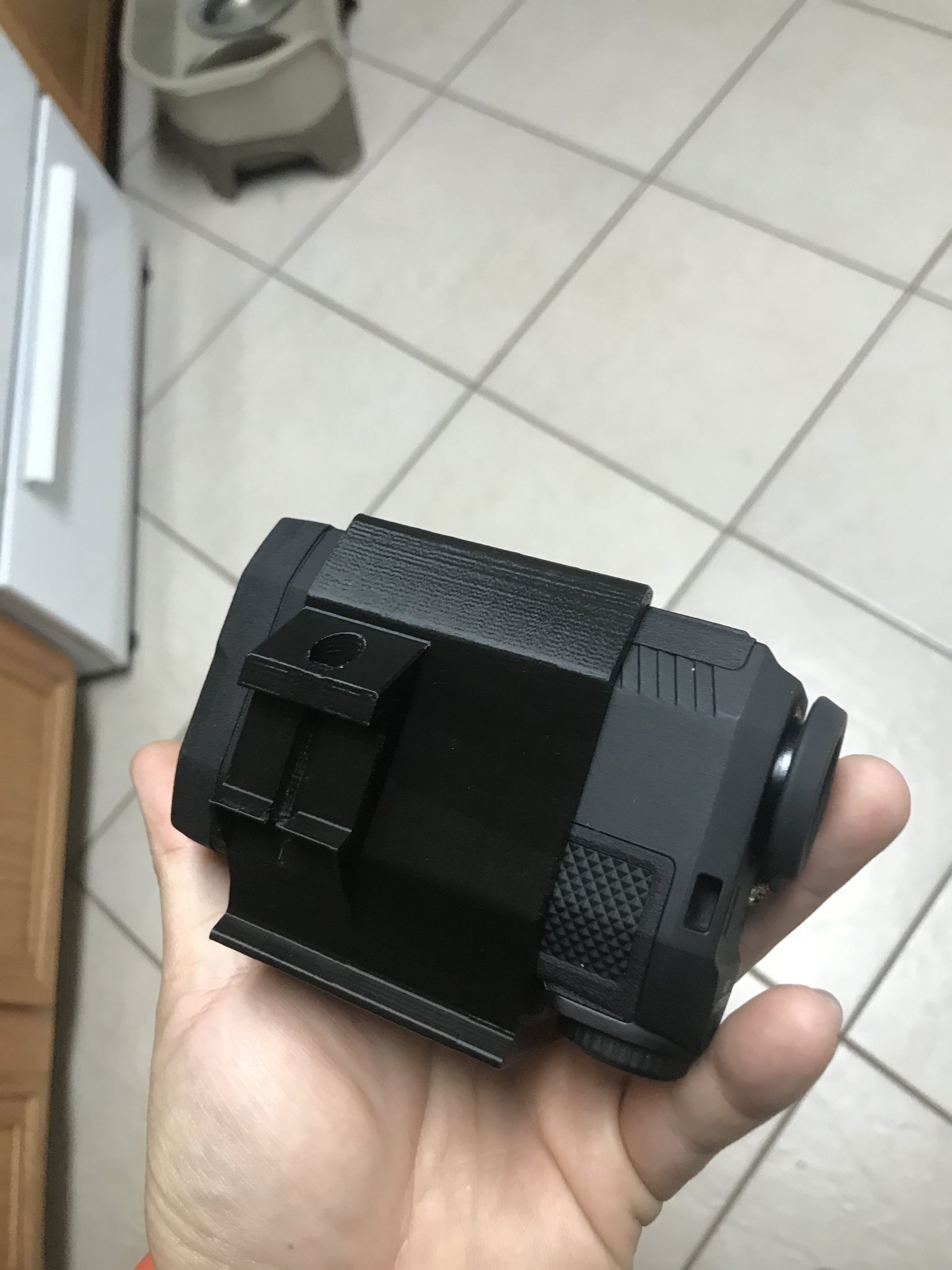

Ken did a great job with these. Mine arrived today and I got a chance to test it out. I was ranging a sign in the river consistently from a tripod at 1530 yards (+/- 1 yard) in very hazy conditions. Works great with the Really Right Stuff clamp. I also mounted it to the Bushnell spotter. It can be mounted on the left or right. Since I'm right eye dominant I went with the left side. These are really nice with excellent attention to detail.
IMG_5768.jpg IMG_5769.jpg IMG_5770.jpg IMG_5771.jpg IMG_5774.jpg IMG_5775.jpg

Out of curiousity, how close does the center of the RangeX view match up to the spotters center?
Is it close enough to let the Rangefinder work as a quick sighting tool to get the spotter on target?
My favorite eyepiece for my Optolyth spotter is the fixed 30x with the L shaped reticle. But sometimes its a bitch to find the target without any coarse sights. I can see the target plain as day with the naked eye, but through the spotter im hunting through a sea of tree leaves.
Ive thought about making a rail mounting point for my Optolyth, and using the RangeX as a coarse sight to get the spotter on target.

I think it would get you in the ballpark but the alignment was a bit off both vertically and horizontally. I doubt anything could be done about the horizontal as it’s similar to a laser in that it could only line up at a certain distance or run parallel all the way but will be slightly off due to the distance between them. Perhaps if I had my Allen wrench when testing I could have tried to adjust the vertical a bit more to get them closer. I’ll have to play around with it a bit more. I think it can get you pretty close and then you will just need to adjust a bit to get the spotter on the target.
I actually thought about there being some type of swivel for up/down adjustment but I think it would needlessly add complexity and bulk to the design. I like it the way it is. Could be interesting to try and top mount it on the spotter. I would need something to attach to the pic rail and extend back and then use the tripod mount on the rangefinder mount you made. That would allow some left to right adjustment and then you would only have to adjust the spotter up or down a bit.
I’m really impressed with how much thought you put into the design. Thanks for sending it to me!

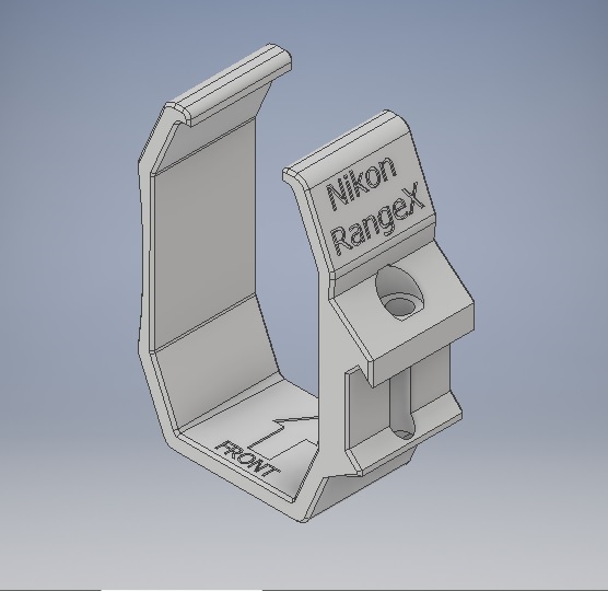

I made a couple small modifications to the solid model before uploading it to thingiverse.
I added some contours to the rear surface of the mount for aesthetics, and increased to bottom hole diameter to 3/4" to allow for a bigger and stronger mounting screw insert. None of the models I currently have printed for resale have these 2 new features, and I likely won't print any more of these unless there is a significant demand when I list them on Ebay.
Anyone who wants one with the new features, will need to print one themselves, or perhaps download the file and have it printed by staples or something.
The file is up on Thingiverse.com
https://www.thingiverse.com/thing:3288149
