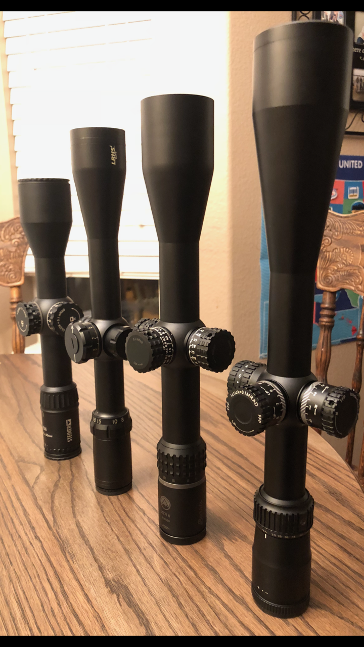

Havnt got a chance to shoot with the Nikon yet, but had to take a couple others off rifles to get a photo opp.
Initial impressions are decent. Knobs are the easiest to turn of the bunch. Only 19 mils ele (18 advertised) 30mm tube. sunshade. mild CA. rect is basic but very usable. long scope for sure.

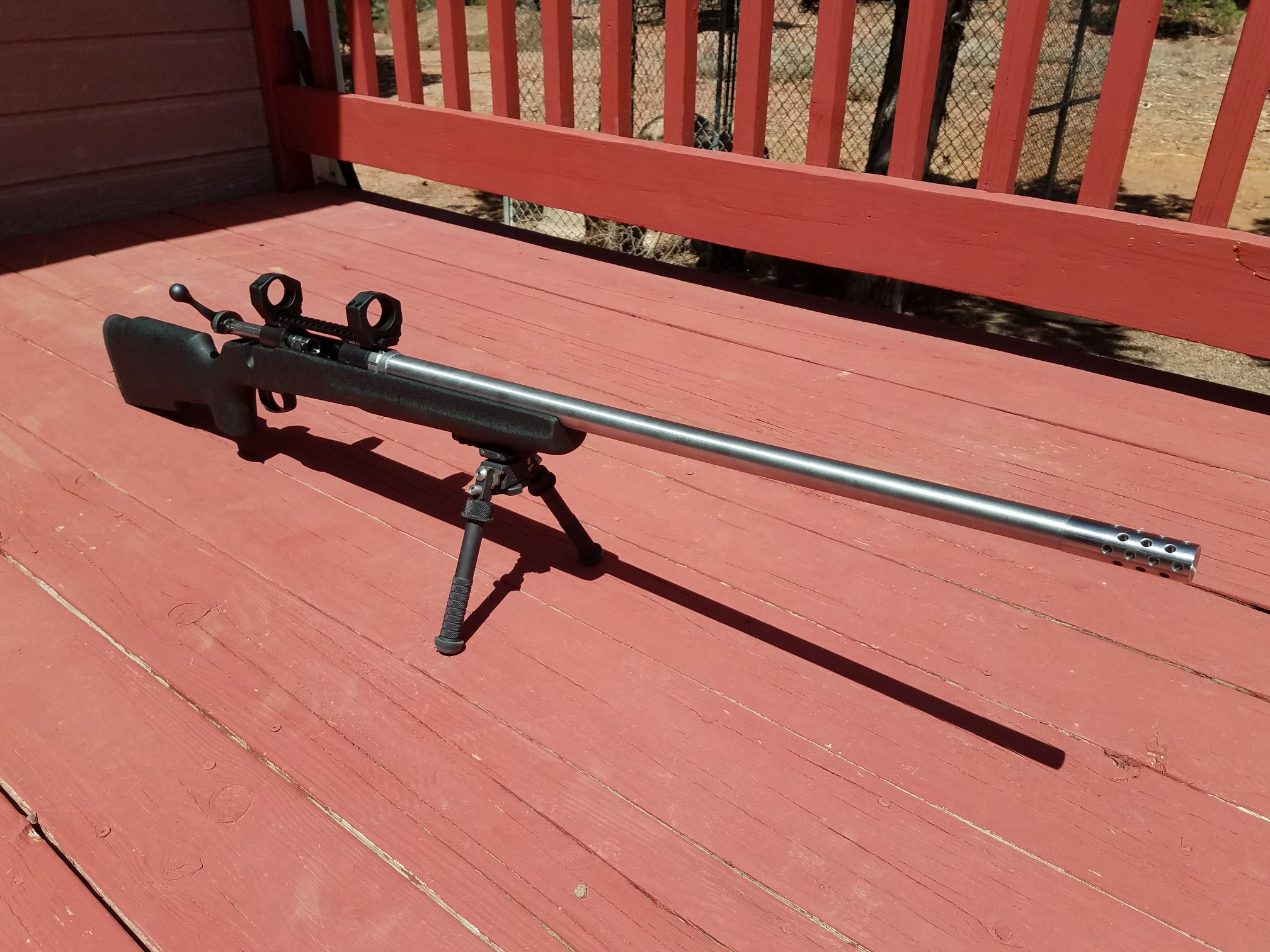

I've really been eye balling the Nikons since the release of the X1000. Now that they have it available in the FFP, I'm really having a hard time not picking one up. I own a Gen 2 Vortex Viper PST 5-25x50 FFP scope, and really really like it. I'm really torn between spending $799 for an FX1000 vs $1099 for the PST for a new rifle project I have. I really don't need the illuminated reticle of the PST, as I have never needed it. Does anyone by chance own both the new Nikon 6-24x50 FX1000, and also a Gen 2 PST, that could maybe do a couple of picture comparisons for me? I'd really like to see both side by side, and maybe a picture through the glass of each. I'd really appreciate it.
Here's a pic of the rifle it will be going on. Plus here is a pic of the Gen 2 PST on my 7 saum.

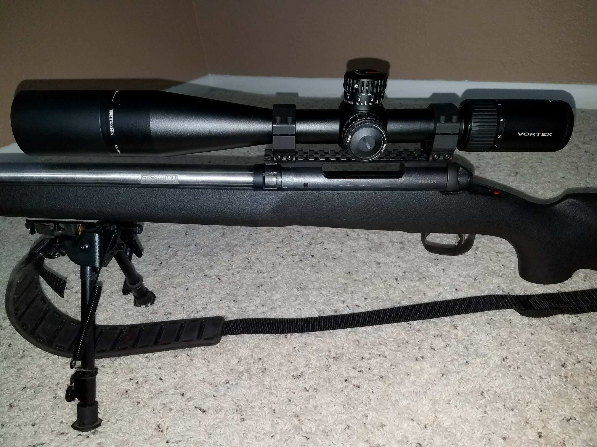

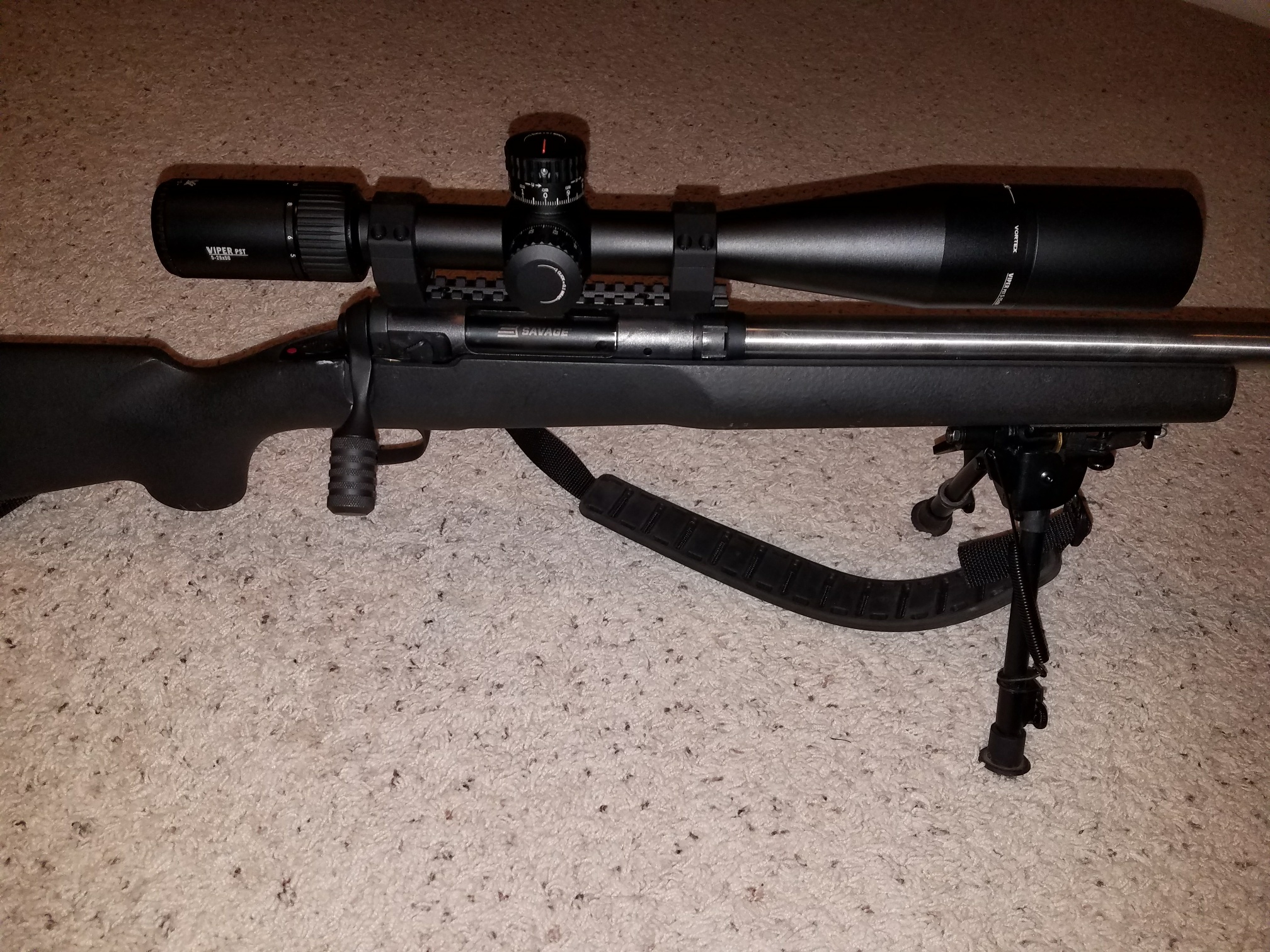

Here is my unscientific two cents. While some may consider these a low or mid tier scope any scope purchase like this is a "big" purchase for me so I have to spend a lot of time comparing and determining best value for the buck. I was able to compare the FX1000 and a Vipers PST gen 2 side by side.
The Nikon FX1000 was the 4-16 mil and the Vortex Viper PST gen II was 3-15 Mrad. Unfortunately Sportsmans Warehouse does not carry the illuminated 4-16 so I couldn't compare illumination. The windage and elevation turrets of the Nikon were nice. Easy to read and I could easily feel the detents as turning and hear the clicks. They were by no means mushy. They reminded me of the feel of the Vortex Viper PST gen I turrets. The Vortex windage and elevation was "crisper" and louder. They were more distinct but I would have no issue using either turrets. Parralax, and power rings both had nice resistance and turned smoothly.
The glass comparison was done in store on a fake rifle with rubber mount that let you clip the scopes in. I set the Nikon at 4x and the Vortex 3-15 at 4x and compared them. The Nikon was brighter at 4x with nicer color than the Vortex but both were very clear. I set both at 15x (Nikon was 4-16). The Nikon was noticeably dimmer at 15 than the Vortex and had a more sensitive eyebox.
Overall at lower power I preferred the Nikon but at higher power the Vortex was the clear winner. Unfortunately Sportsmans Warehouse doesn't carry the illuminated version of the Nikon 4-16 so I ended up purchasing the Vortex 3-15. I find I have to have illumination on a FFP reticle so the lack of illumination on the Nikon prevented me from purchasing it. (They do offer an illuminated 4-16 but it wasn't in the store). If they had the Nikon illuminated 4-16 I would have walked out of there with it instead and used the $250 ($999 for Vortex 3-15 Mrad, $749 for Nikon illuminated 4-16)saved on ammo, rings, and all the other stuff required. The Vortex is a slightly better scope in my opinion, but not a $250 scope better. The Nikon gave up very little to the Vortex. Its biggest con was the dimness and sensitive eyebox at high power.
Hopefully, the unscientific comparison helps someone else debating the PST gen 2 vs Nikon FX1000

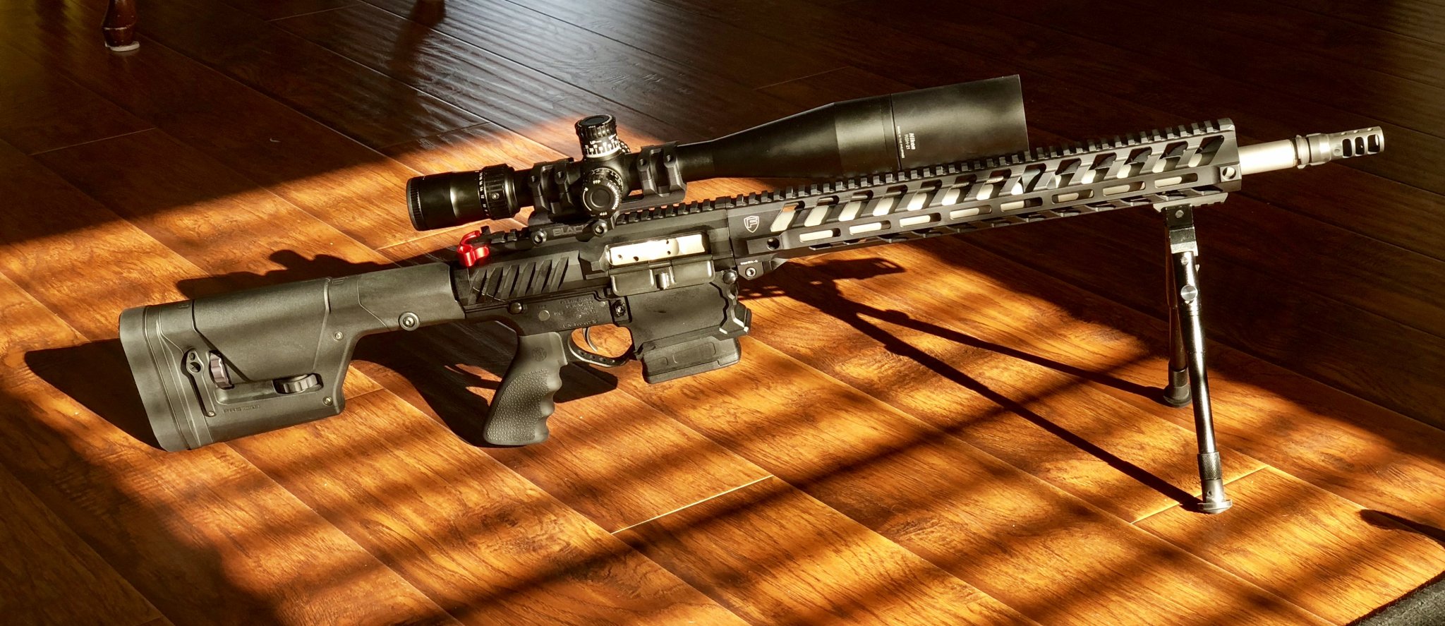

I dont have a photo of the reticle, but here is the scope on my AR-10 build. So far it has been a great scope. I'm not a competition shooter, I just like getting out and enjoying myself with friends and family.
