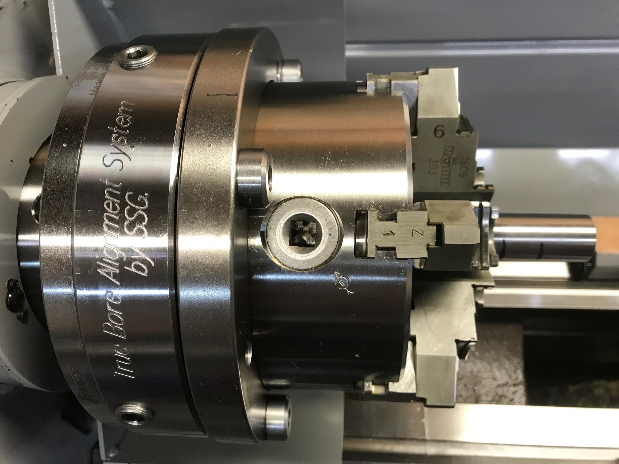

TBAS?
I know you're not referring to the aptitude test my son recently took before just getting his pilot training slot with the USAF...
So what is it?

True bore alignment system. Pretty cool by design. Let’s you indicate in a barrel when the headstock is too long for an outboard spider.
