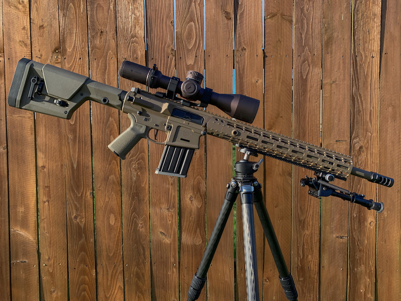

Been wanting to build an AR10 for a while, but kept putting it off given what I'd read about the sub-par accuracy and finicky nature of them. Given some changes in WA state law surrounding buying AR platform rifles I bit the bullet and bought a stripped upper and lower and decided to start piecing one together - 6 months later and a robbed scope from my bolt gun and it's finally done 😂

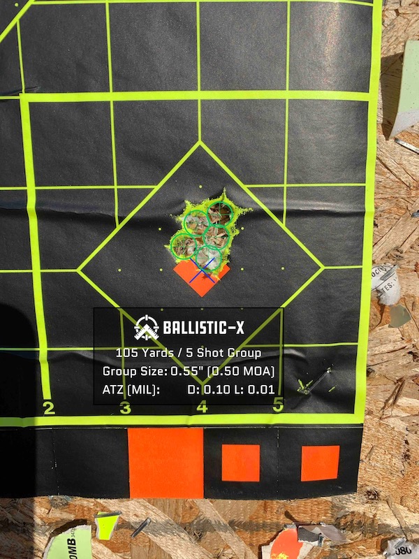

I've gotta say, this build surpassed my expectation as to what I thought I could reasonably attain accuracy wise. To say I'm happy with it is putting it mildly! I was a little hesitant going with an X-Caliber based on some of the mixed reviews I've read, but it seems like the poor ones were from a while ago. I did send them my JP bolt to headspace the chamber off of. They guarantee 1moa accuracy if you do this.
Build details:
Aero M5 308 upper and lower
Aero M5 enhanced Gen 2 M-Lok handguard
Aero parts kits for the upper and lower
Magpul PRS stock
CMC 2-stage trigger
Area 419 Arca Rail
JP Enterprises HP bolt
JP Enterprises full mass BCG
JP Enterprises silent capture H2 buffer
X-Caliber 416R stainless 18" 10 twist 5R socom heavy profile
Rifle length gas system with Superlative adjustable gas block

Great group. I still want to see a 5x x 5x group on same page. All filmed in one consecutive take with todays newspaper in view the whole time. Otherwise its just 1 MOA so far.
LOL

Goes to show that you don't have to spend 4k on an AR-10 to achieve excellent accuracy.
It will probably group even better with handloads
LOL
Left the crop bigger and the dime for scale off the picture so no one would claim any funny business! 😂
