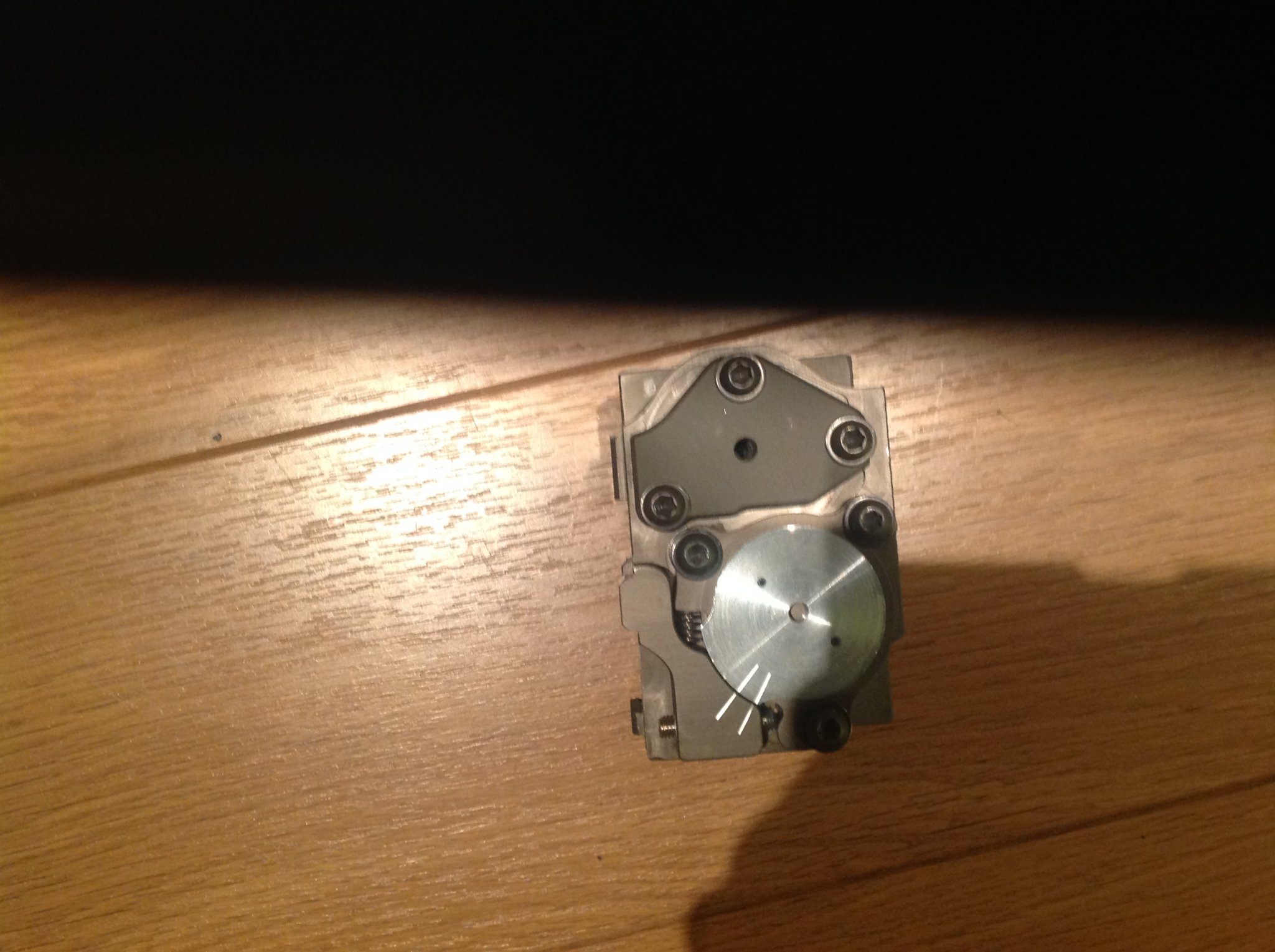

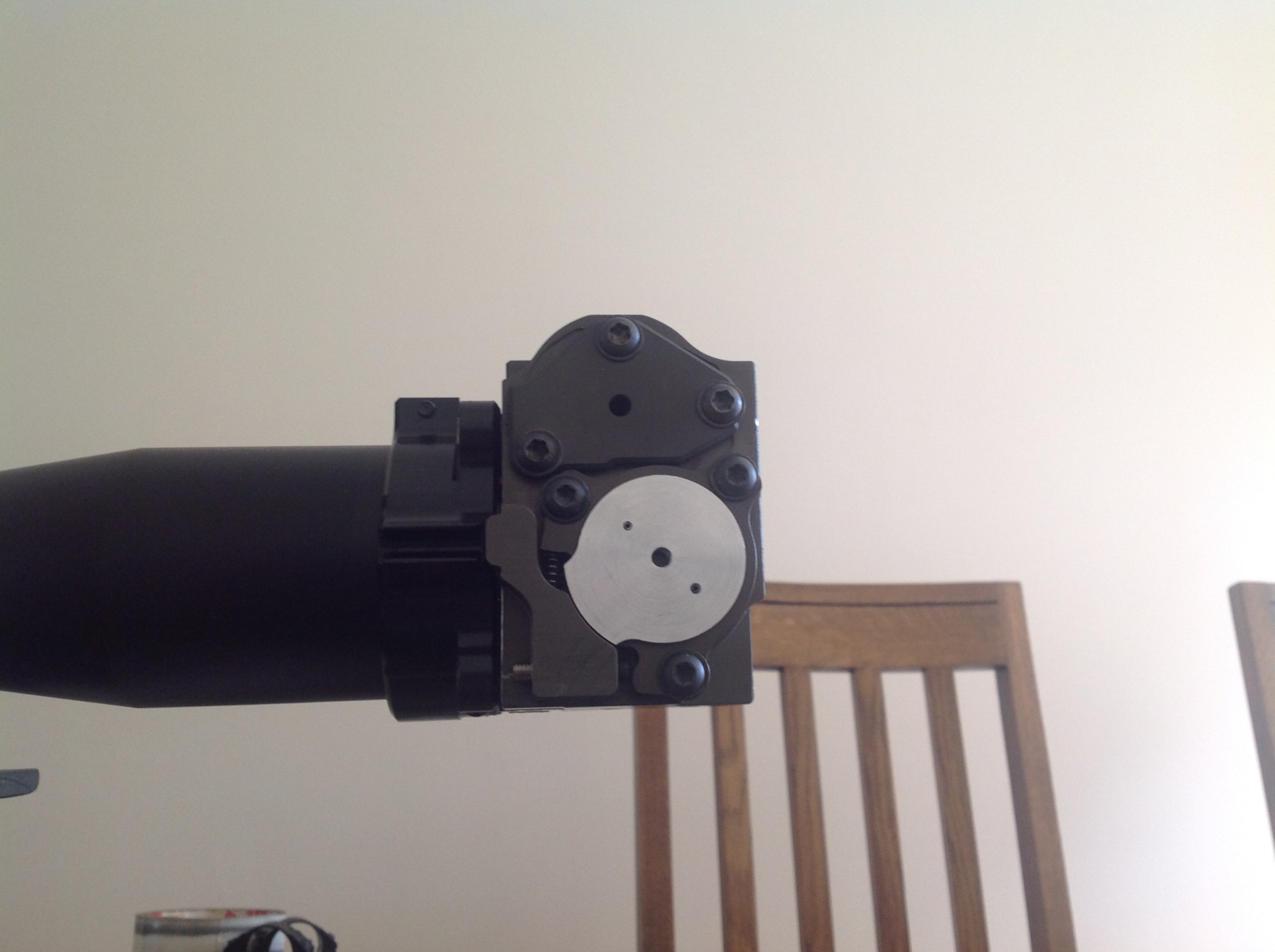

I have decided to do a very simple modification to my Charlie to allow on the fly adjustments ,in my case upto 125 mil ,but you can set it to anything really. I have made a fill in piece as seen in the picture which will be engraved with five lines for the different elevations. No more faffing about for me ! It will be very precise to adjust as it uses the existing adjustment screw and the engraved lines will work exactly as on a vernier so will be very repeatable 🙂 I will post more pics when it's finished as I can only engrave one line per day at work

I use the the retical in the scope to do the measuring. Look through the scope with your turrets set on my zero ,note the measurement down , dial in 25 mil , note the measurement down off surveying staff. Once you have the 25 mil measurement, return turrets back to zero. All I do then is attach the charlie,adjust its screw until it reaches the exact same measurement on the staff, check a few times to verify.
When I am happy with the dialled range, I will then in my case ,use an engraving tool in the mil and mark the first position off. It's just a simple case of using the measurements off the staff to engrave the other positions.

We machined the 25 and 50 mil lines in tonight, I'm quite pleased, even without painting the lines in for contrast I still managed to get the adjustment repeatable to two clicks on the scope 0.2 mils🙂 A bit of paint and a magnifying glass for my eyes and we should really be in business

As the one who sets and calibrates about 99% of the optics we make, I can believe your device would be repeatable to within about .2 or .3 mil.
If you want your offset perfect, I'd recommend dialing to your mark, tightening the 3 bolts to finger tight, checking zero, then repeating the process until it's perfect. At that point torque the bolts to 60 inch lbs and smack some steel!
