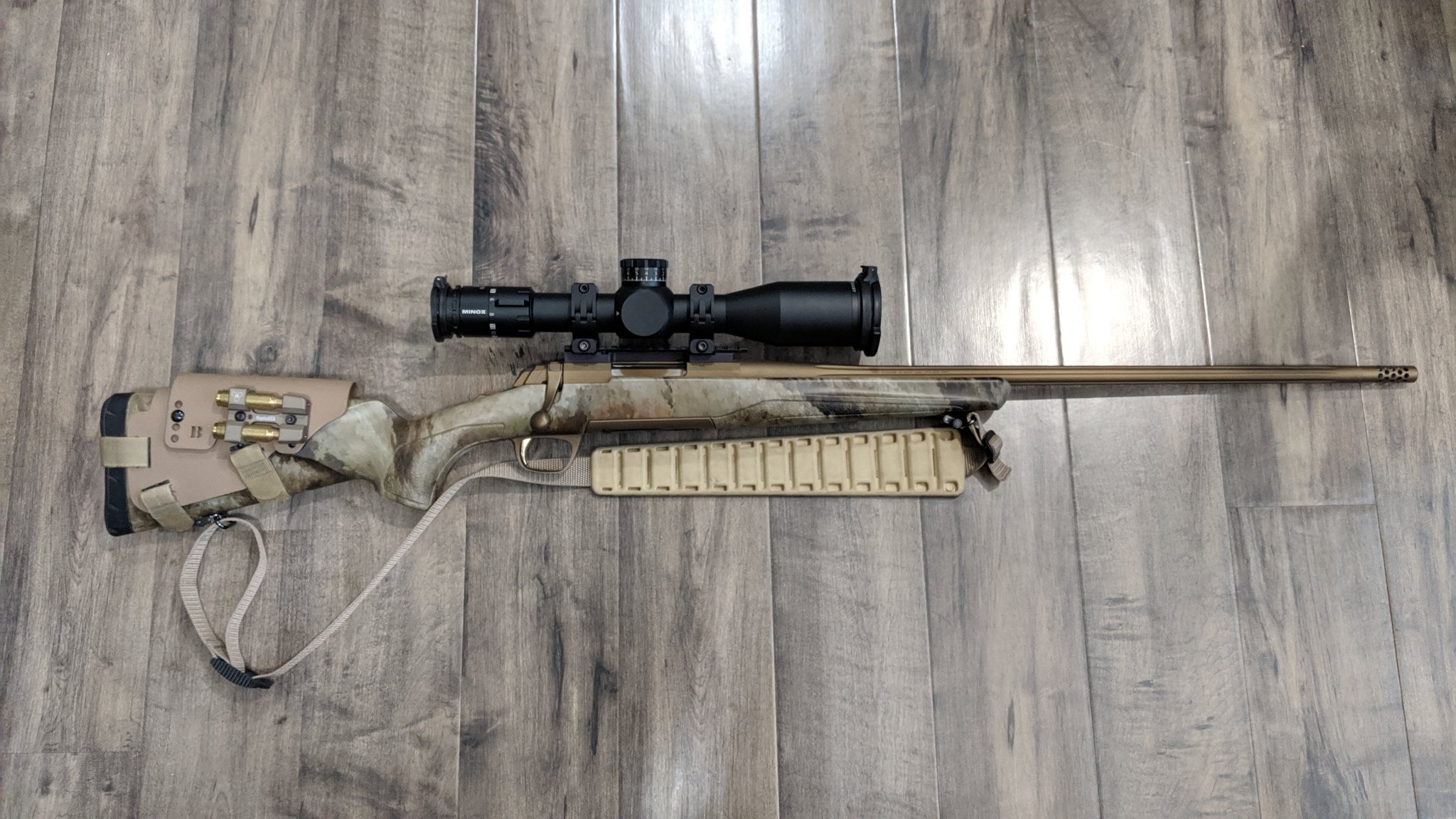

Here is a pic of one, on one of my high country (hike a lot, light weight) 300 short mags. This is just a factory Browning x bolt, but it still hammers 10 inch plate at 1k yards.
