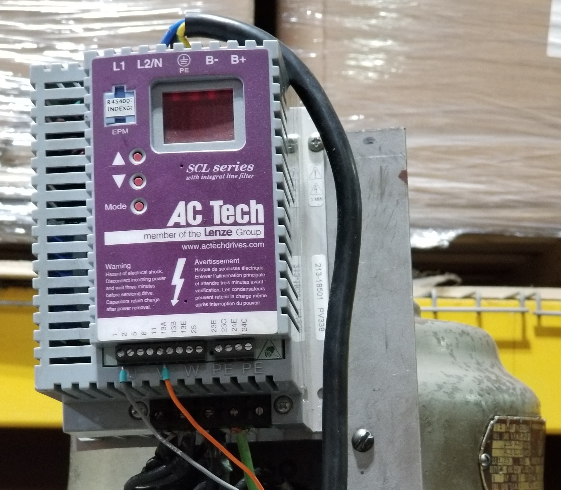

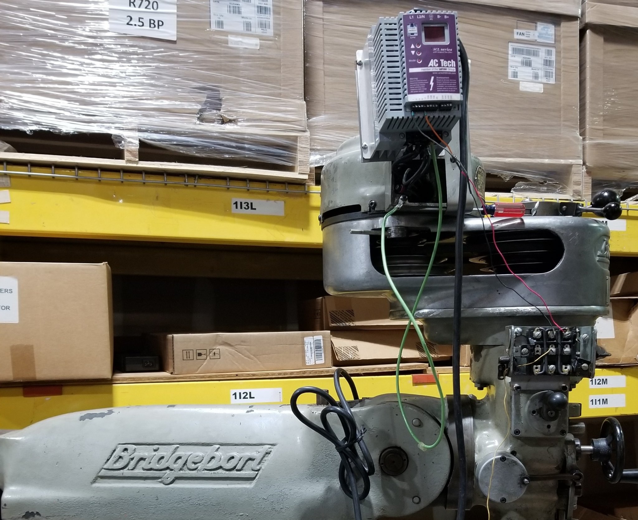

Yeah, I was looking at those VFD's so that's maybe not so much of an issue...
