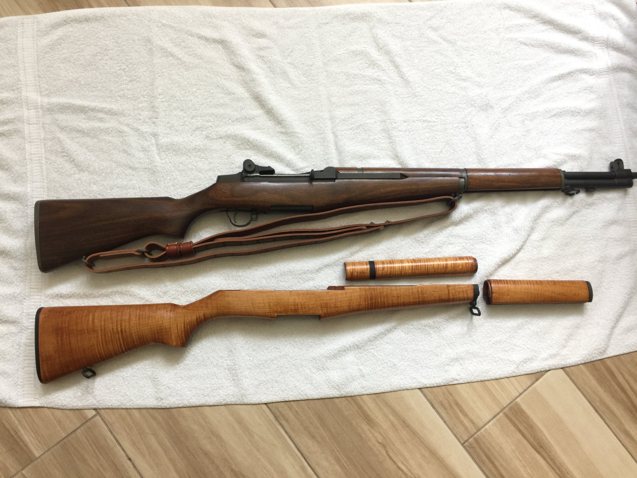

Here's a rather poor picture of my 30-06 m1 garand in its CMP walnut stock, sitting next to the curly maple stock from dupage. The CMP stock was DRY when the gun arrived and I'm not sure how many- many- coats of 50/50 tung oil it got, nor how many- a bunch more- coats of pure tung oil went on top of that. It may have been me, but I think the stock is noticeably heavier.
The new stock arrived with a slathering of finish on it- not a carefully applied hand-rubbed tung oil finish that I probably should not have expected. It would s also much blonder in person than it appeared on the website. Since this pic, it has received enough 320 grit sand paper to remove the sloppy finish, and 3 coats of 50/50 tung oil. The figure no longer looks painted on, shimmers and moves depending on the light angle, and is starting to pop. It needs a lot more oil. Oh well, I love the smell of tung oil.
