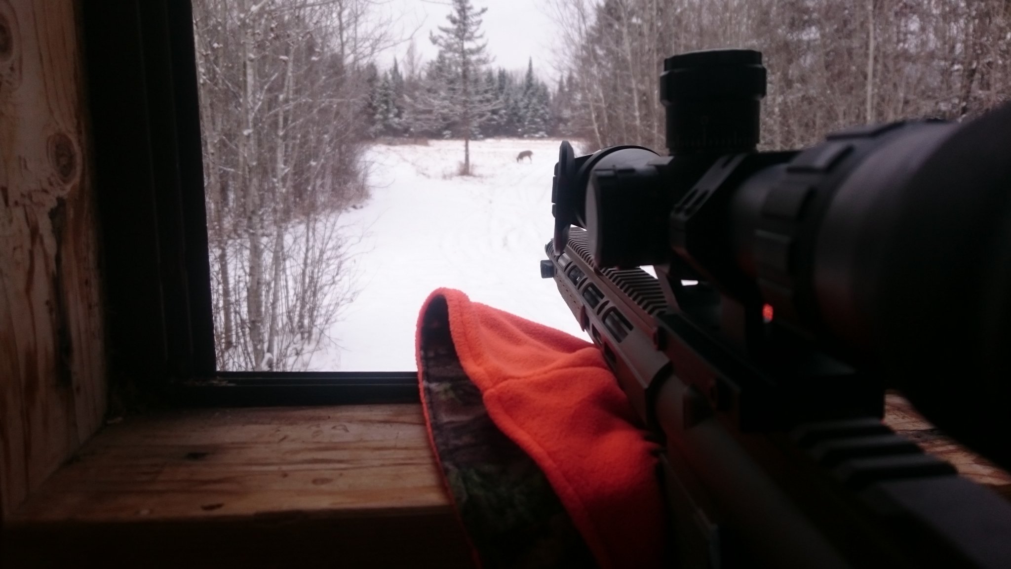

There's so many options. I myself am like you and use my fun rifle for hunting so whenever I'm shopping for optics I keep that in mind.
Tract toric 4-20
Tango6 3-18 or 4-20 (I have the 4-20 with MRAD milling reticle)
Weaver tactical 3-15 ( I had this & regret selling)
Vortex AMG
viper PST 2nd Gen 3-15
Leupold Mark 5 3-18
Bushnell LRHS or LRTS (I have lrhs in 4.5-18)
And there's a million more. I usually pick a clean reticle that isn't too cluttered cuz I go for pigs at night time and when I light up my illumination, I don't want a lot of light to be picked up by my eye and I don't want a for example a Christmas tree blocking the pigs silhouette.

Thanks, it’s quite a list to read up on. Great photo, by the way. Is that a Grendel as well? I’m new to the cartridge, but my 6.5 Creed has served me well on deer, so I’m hoping that the baby Creed will also do fairly well on our small deer. Do you recommend any particular projectile for hunting use?
Mine's actually a creedmoor. I wish I could give you a solid recommendation on the projectile but truth is, I haven't shot many living things with many different projectiles. I know 140 grain hollow point boat tail by hornady has worked really really well for me. I've been very curious to try the extreme point by Winchester but have not been able to. It's is a 125 grain bullet with an advertiser BC around . 540 if I'm not mistaken. A cousin of mine uses that ammo and claims to have very good success with it.

I was in this exact situation when I built my Grendel upper for hunting and long range target shooting. I went with a Weaver Tactical 2-10, which is a nice affordable FFP optic made by LOW. I wanted the 2x bottom end as most hunting here in MN is fairly close range, but beyond 500 yds it's hard to see targets. If I had to do it again I would go with the 3-15 range. The PST G2 would be a great option especially with the deals lately on 2D reticle recently. If your budget allows it, one of those LRHSi would be great.
Edit: just saw you went with the PST. Very good call.
As far as projectiles, I got two deer last year with the Nosler 129gr ABLR. One at 175 yds (end of the field pictured, not the doe shown) dropped right there. Bullet went all the way through and I never found any part of it, the bonding works apparently. MV was only 2345 fps from my 18“ but that did fine.
