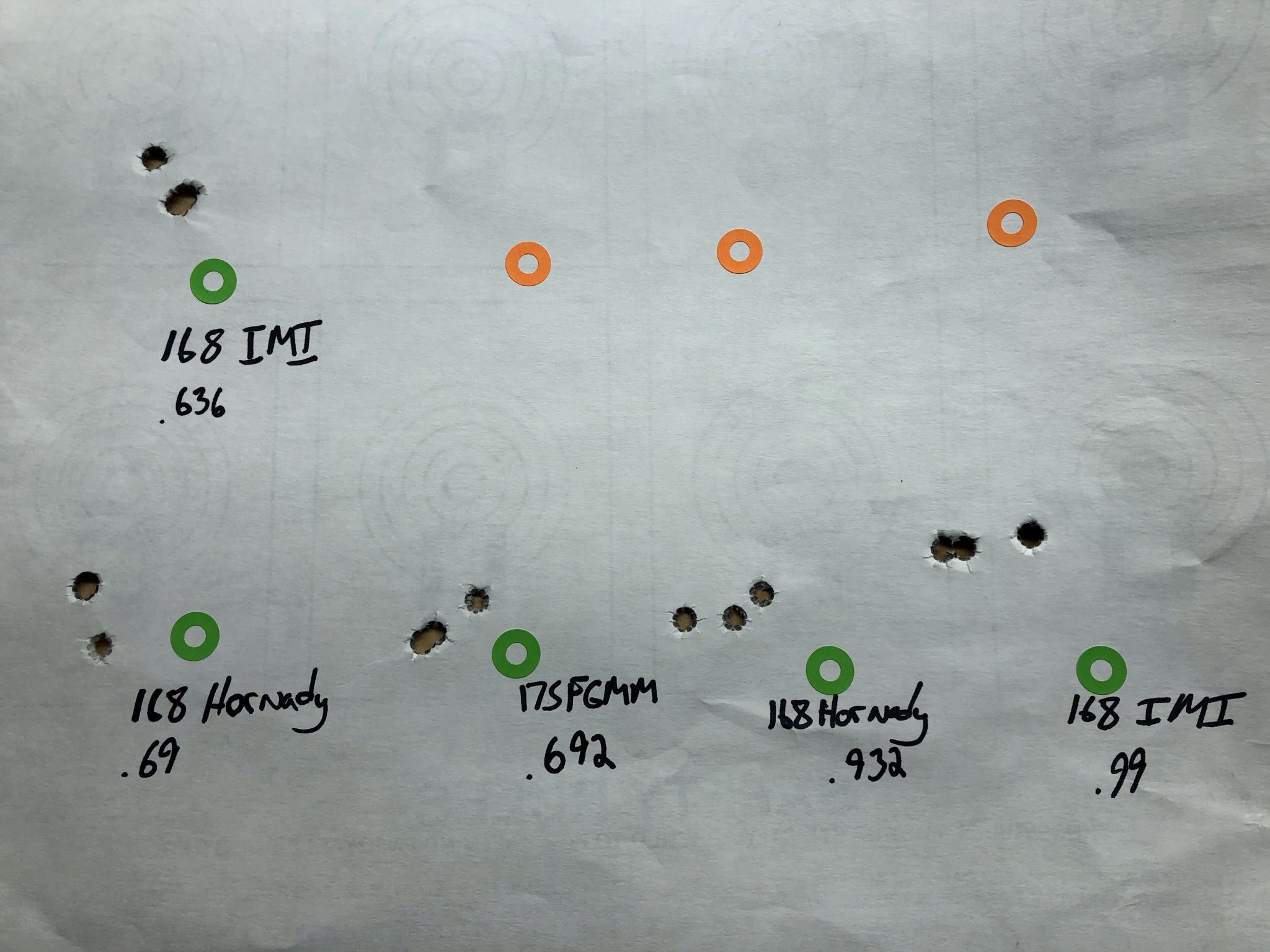

My SS Barrel says "MP 7.62 NATO 1/11.25 SS"
Realistically, either barrel should be sub-MOA with decent ammo, and sub 0.5 MOA with good ammo. Is 1:10 better at stabilizing heavier projectiles than the 1:11.25? I've read that 1:11.25 is better with M80 ball (~150gr) than the 1:10, while both are good with the MR118 (~173gr) and 1:10 is significantly better with sub-sonics
If sub-half-MOA ARs were as common as people claim, they would dominate PRS. As it is I don’t see a lot of 6x5 targets for these things.
There was a thread in this forum about Savage MSRs not that long ago and the term "1/2 moa all day" was thrown around quite liberally. Then near the end a dude posted a 3 (I think) shot group at ~1/3 moa lol. It was a nice target. I'm a decent shooter and shoot KAC and LMT ss barrels all the time, bipod and rear bag, concrete bench, many perfect non windy days etc, and I'm still 1moa-a little better occasionally and a little worse usually.
I shoot with a lot of good shooters with high end equipment and I see the same thing for the most part. You get into bolt actions and they're consistently below 1" but they still have to work hard to get it.

I was shooting today and with ammo it likes (Hornady 155 AMAX over Varget), it was an honest 1" gun, with other ammo I took for comparison, it was 1-1/2" to 2"
I can live with 1-1/2" out of a semiauto battle rifle all day long. If I'm doing my math right, that's a center of chest hit to 600 everytime.

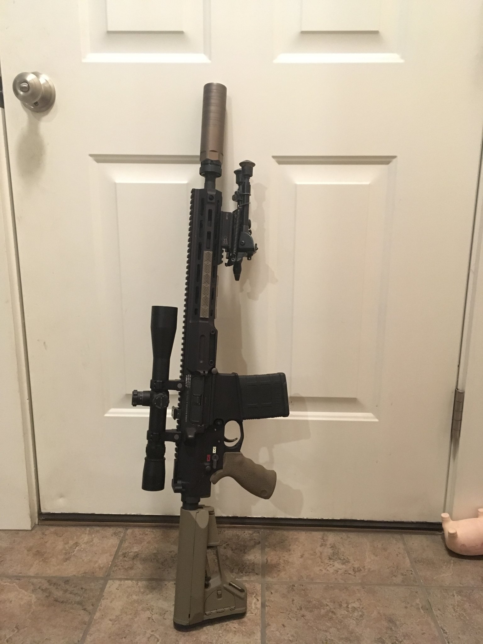

Hello all. I'm a new LMT 308 owner. I joined this forum specifically because it's just about the Only place I've found where people are keeping alive a discussion about this gun. Almost anywhere else I looked, I couldn't find any current topics about the LMT MWS 308. All my googling just turned up years old threads.
I'm glad to have joined the club. The club of LMT owners, that is. This is actually my first 308. I was kind of surprised because I expect a 308 to be heavier than AR-15s, and everybody always says the LMTs are heavier compared to other AR-10s, but this gun really doesn't feel that heavy in my hands. Of course, it could be due to the mlok rail and lightweight CL 16" barrel.
I've only shot it once, and it was at >25yrds. I was waiting for my Nightforce NXS to come. Now that I have it, I need to get out to the 100yrd range. Unfortunately there's no range anywhere near me with longer than a hundred.
I'm sure I'll be asking you guys questions and opinions in the future. I'm glad to have found a place where people still talk about these guns. It's weird to me that it was difficult to find anything recent.
One thing I'm wondering; what's a good "battle zero" with 308s. I used to do the 50/200 with AR-15s, I kind of go for the 36yrd lately. But I've never known anything about what's good for a gun like this one. Or do people just zero at 100?

Anyway, here's a quick picture to say hello.
Welcome to the LMT 308 MWS club!
Since I use a scope on mine, I've zeroed the rifle for 100 yards. I sure that there are people who have used some other yardage...

Anyway, here's a quick picture to say hello. View attachment 7242679
Nice setup. I do 100yd zero as well. My club has steel at 200-400 so that works for me.
great looking stick, welcome.
m4carbine.net has 300 pages of lmt mws talk:) you got a great brake on her.
100yd zero is fine

Does everyone who has a factory 13.5 inch model or 16 inch cut down barrel to 13.5 still like it? I was dead set on a 16 inch barrel until I read a number of older posts here and m4carbine about how it only loses negligible feet per second inside 600 yards or so and how much handier and lighter it is, so that is what I ended up ordering from v1 tactical.
NFAJohn
Hessian
Belligerents
May 7, 2018
110
54
34
Richmond, Texas
16” stainless 308 I bought used from the PX. The more time I spend running this thing the more I learn to appreciate just how different shooting a gas gun is. I was going to go down the rabbit hole and hand load for it, but with factory fodder shooting like this I think I’ll stock up imi and just shoot it.
Reactions: SOCAL and Tono
smead45
Online Training Access
Belligerents
Dec 28, 2010
144
7
22
37
Illinois
I have a 16" SS lm8. It is a good designated marksman rifle for sure. If I load the bipod and apply all the fundamentals I can keep it around 1 inch at my desired POA. If I don't load the bipod the groups open up and are consistently high about 1.25" @ 100. I want a longer barrel but would like something other than factory. Was thinking about having Marvin Pitts spin one up on a Bartlein blank. Maybe oversize the barrel sleeve a couple thousandths of an inch and tighten it up a bit? I'm open to suggestions.
Starman_Dan
Feb 6, 2020
2
0
2
I just pieced together an LMT MWS with 8.5oz buffer over the past couple of weeks as my first .308 rifle. I have had a couple 5.56 ARs and wanted a "Battle Rifle" so I went with the light weight chrome lined 13.5" barrel and had it pinned/welded with a KAC 5-Slot QDC flash hider to get it to 16".
I don't have a frame of reference for the weight of one with a 16" barrel, but I have been loving it so far and don't see myself going for a longer barrel unless I wanted to turn it into more of a bench gun. I stick so much shit on it as is (LPVO, WML, DBAL) and the weight it's sitting at right now is a little on the heavy side, but still within the limits of what I'm comfortable with.
Only have a few hundred rounds through it so far, but it handles really well and shoots great. It is significantly more comfortable to shoot than I thought it would be, honestly. The only issue I've seen with it so far is that I've been experiencing scope slip with my Accupoint 1-8 (Quite a bit in my ADM Recon mount and only a little in my Scalarworks LEAP, both properly torqued to spec) but I have some powdered rosin on the way which should remedy that!
