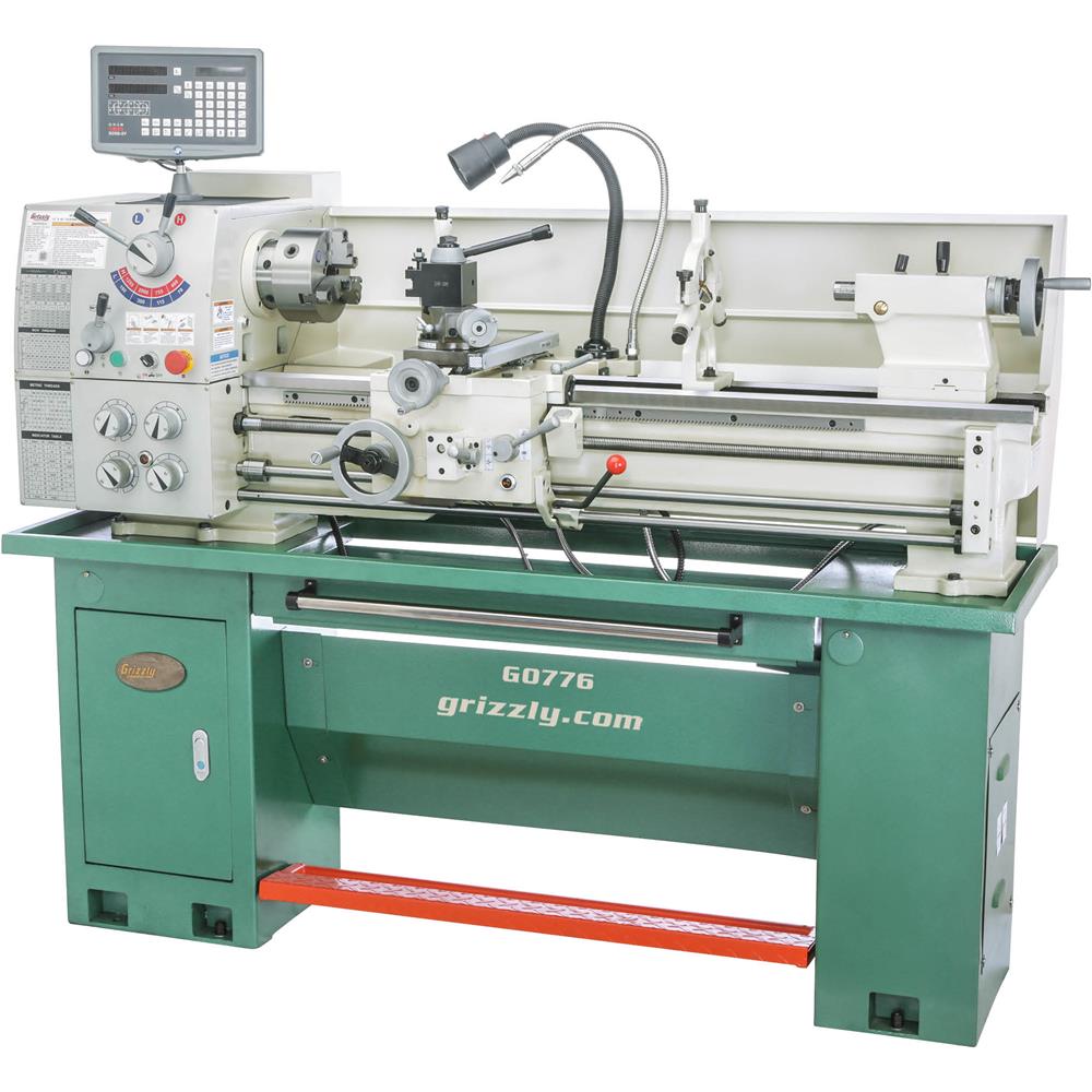

I purchased the G4003G and love it! I've had to upgrade it with DRO and flood coolant and a time or two I wished that I had a little longer bed. The G0776 would have solved all that up front.

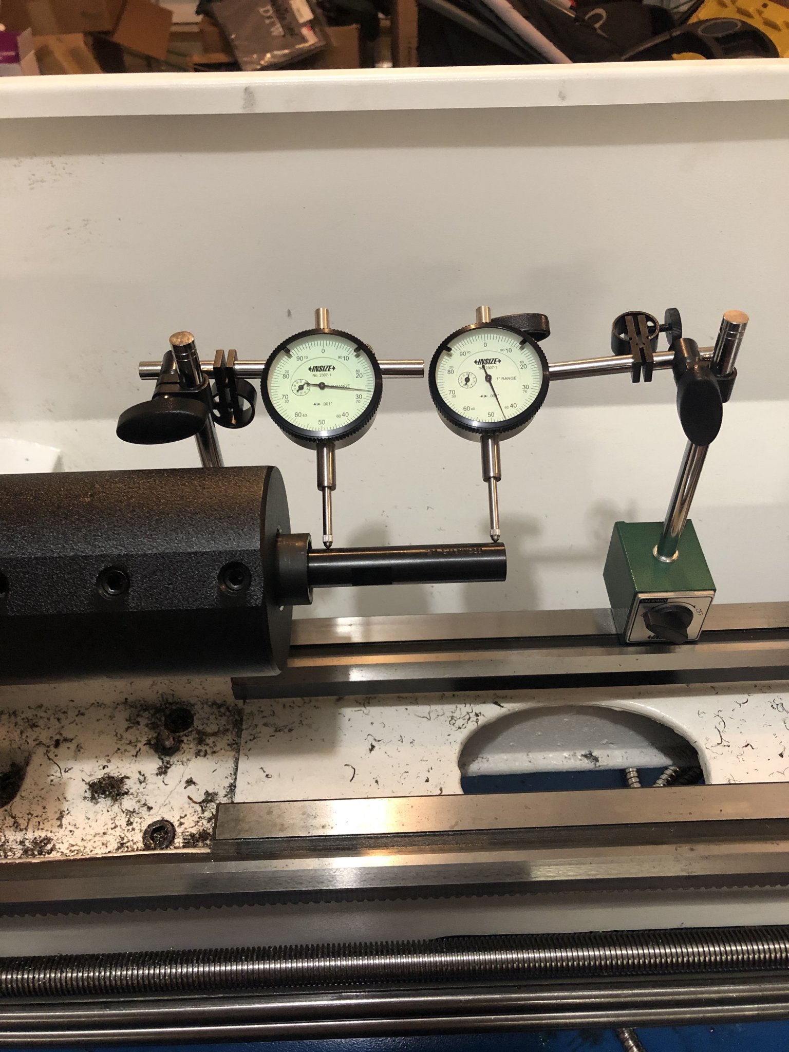

How long have you been running your grizzly? How much tuning what needed to true it up? Lining the head up with the bed and tail to the head etc?
Your budget can handle this machine fully loaded with all the bells and whistles.
Im assuming you have this machine? How much tuning did it take to get the head straight with the bed an tail?

I've been running the Grizzly for nearly 3 years now. When I installed the lathe, I bolted it down and shimmed as necessary to get it spot on. Then I adjusted the tailstock to zero on the headstock. I made several indicating tools so that I could check straightness of the ways and location of the tailstock at any position along the ways. It was straight from the get go. The tailstock has ability to be torqued so it can be repeatably locked down. I've had zero issues with it being able to dial in barrel/receivers to ZERO to blue print/thread.
