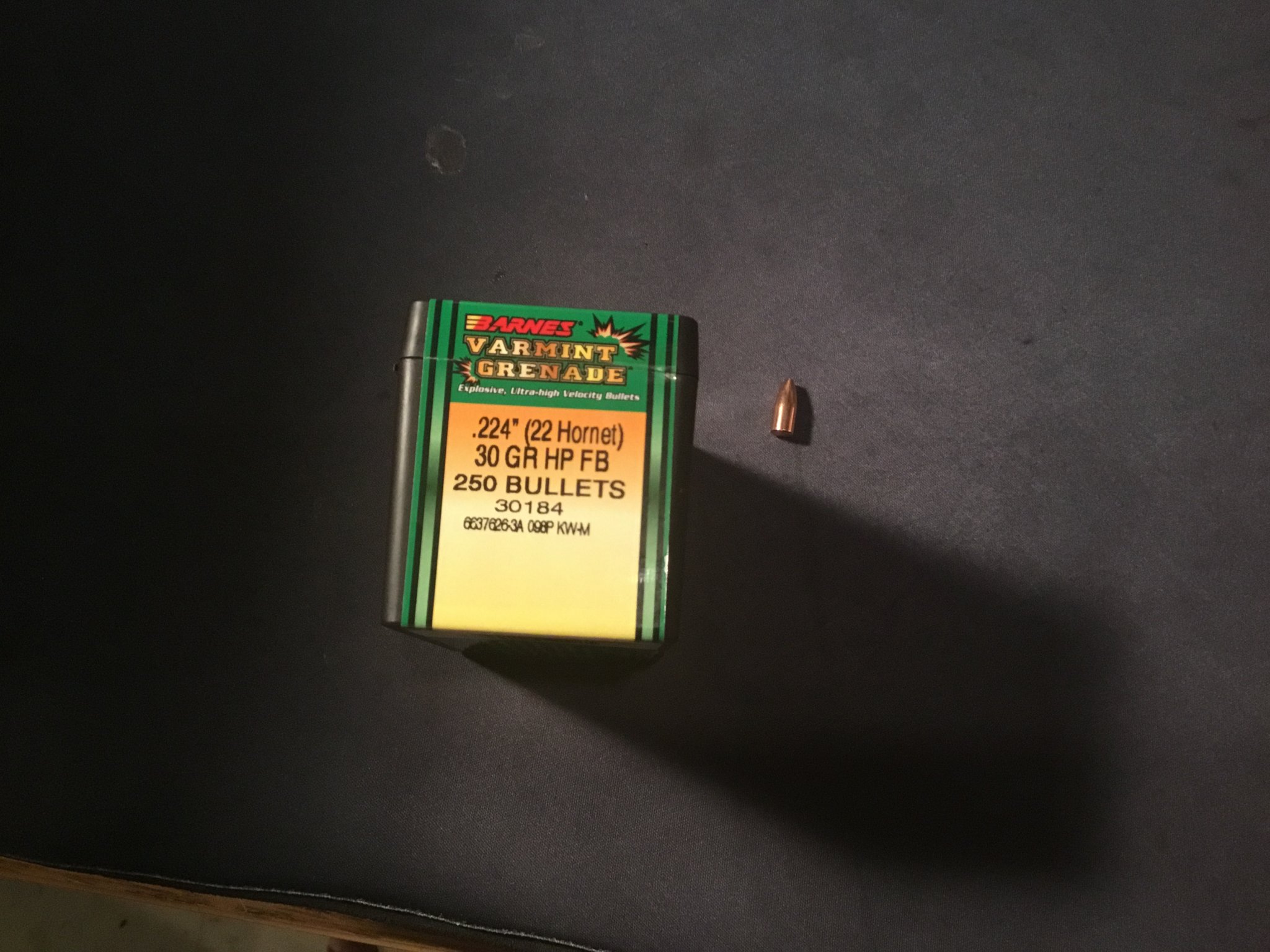

I'm going to mess with a 17 remington with 30grn nagels.
Ive heard some good things from others. They say it just stuns them to death.
Xdeano
I used to use the 30 grain Golds in mine. I shot 6 yotes, all less than 200Y, and they were the perfect bullet for an almost undetectable entrance hole and no exit hole most of the time, which were small.
DRT most of the time too, sept when the shot went where it wasn't supposed to go.
The 30 golds aren't being made anymore, it was sold to another guy who is in Texas, he's making them, not sure if he's got the same quality. I ended up buying some 30grn Nagel and some 32grn RBBT from Reed's. I'm pushing the 30 Nagels at 3920 right now.

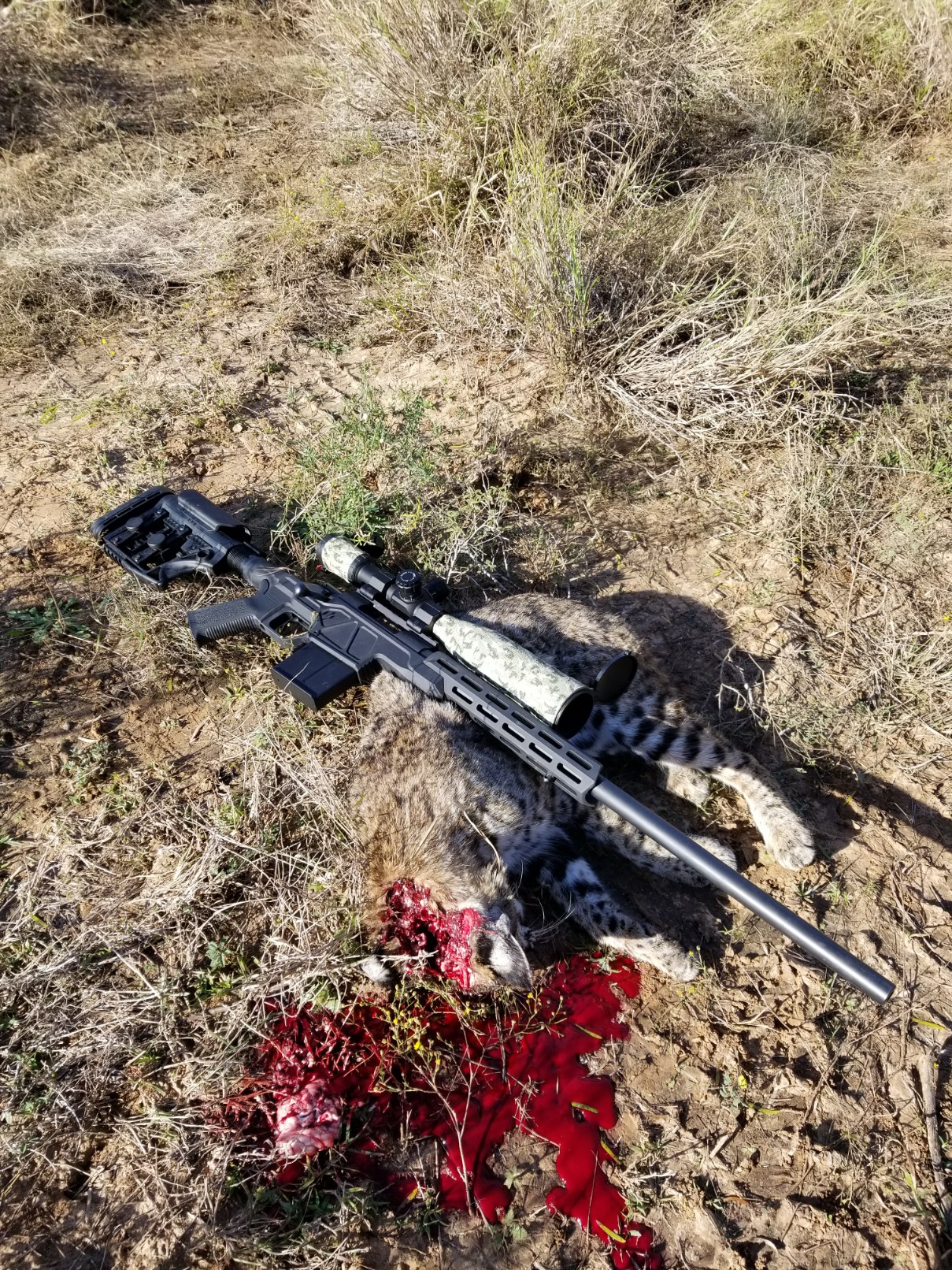

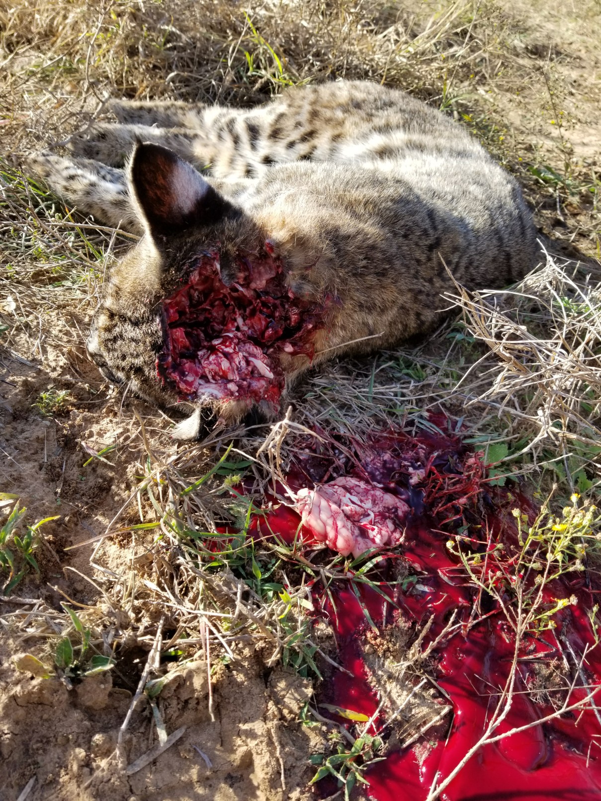

140 grain ELD-M works great on bobcats. If you do headshots, you don't risk ruining any of the fur, unless you require the head be intact as well lol!
View attachment 6947363 View attachment 6947364
What amazes me is how tough those bastards are. Perfect shot behind the shoulder with a 69g Sierra and still made it 50 yards. 6.5CM is in the bull pen waiting for it to cool off down here for coyotes and occasional cats.🤙
