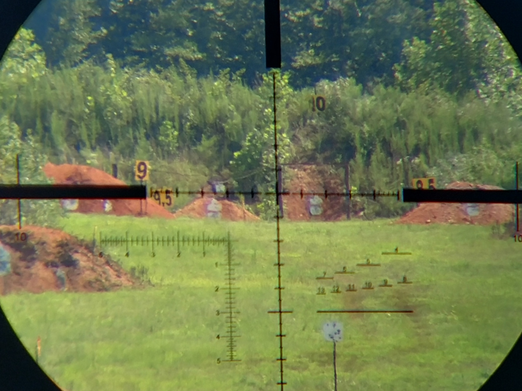

If you are trying to have one gun for hunting and shooting steel keep FOV in mind
Lower magnification usually has a larger field of view making it easier to get the cross on what you want to shoot
I believe 3-15 to be plenty to shoot steel with
Example below at 15x (forgive image quality but I'm using a cell phone trying to take the picture) about 1.5mil right is a sihoullete Target at 1k yards and about 2mil left on top side of the line is a 10 or 12 inch plate at 1k yards Right above the sihoullete Target that's at 950
If I miss it's prolly my fault, not my lack of magnification... 3x on bottom end with a decent FOV still does well for hunting

A few things mentioned in the previous several posts sort of mix up an evaluation of a scope.
(not picking on anyone)
Tracking, adjustment stability have no effect on clarity or field of view.
Fantastic optics and crappy mechanicals won't work.
Fantastic mechanicals and crappy optics might.
Fantastic everything is best, but costs.
The Steiner M5Xi shown is a little out of your stated budget (mine also :) )
Low power will always be clearer than high power.
A 10X fixed will be clearer than a 6-24X @ 24.
@ 10x the fixed will be clearer because of glass surface count.
@ 24X the 10X will- - oh wait, the 10X can't go there :)
Field of view is power dependent and usually listed in scope specs.
For example, the 3 to 15 image shown earlier will have a wider field of view at 3 than the 10X fixed, and less @ 15.
For 1000yds count the mils left and right in that image @ 15X.
Even a 6-24X at max power will still be able to view both the Ford parked in front of the Chevy @ 1000YDS.
The magnified view @15X through the phone is also a little misleading if you are looking at it on a computer screen.
The image shown is a little larger than what you will see with your eye at the range.
If you were shooting only fixed paper targets at long range, I'd say switch to 40+ magnification and don't look back though.
I'll add again you will be impressed how much clearer a Target is through a high end scope on low magnification vs a cheaper scope with higher magnification... It's just a bigger blur
