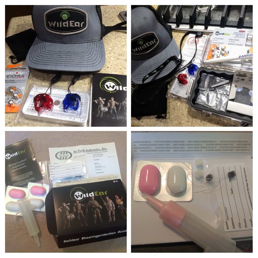

I had the etymotics, good ear pro for the price. But this year upgraded, in considerable way, to Wild Ear. Best I have used by far. Comfortable all day at a match, I can hear everything.
